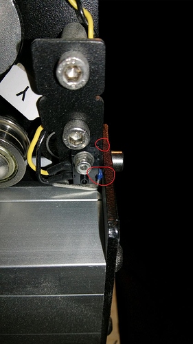

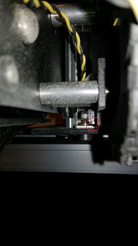

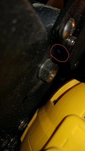

All three of my homing switches can NOT be damaged by the machine. They are all mounted as per instruction and are recessed enough that they can NOT be depressed too far by the machine. The machine would go metal to metal and “collide” forcing the stop of physical motion before it could damage a switch.
Actually, my machine does not completely compress the switch dust boot, just enough to get proper contact action.
Below are some (poor) pictures. These are with the machine power off and I am holding the machine in a metal to metal collision state.
Note that NONE of the switches are overly depressed.
This one shows metal to metal and the Y axis switch properly depressed
This is a top-down view of the X axis switch, fully depressed and the machine metal to metal,
no damage
This is a view of the Z axis switch. Again, I am holding the machine metal to metal and no over depress nor damage to the switch.
No, none of the three bad switches were damaged. The plunger still worked fine on all of them. And I did put a meter on them and they were all shorted (closed) regardless of plunger position.
Any visible damage (if any) would probably be around the mounting screw hole, or the alignment tab.
