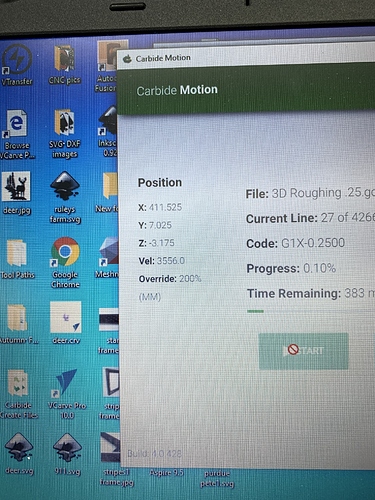

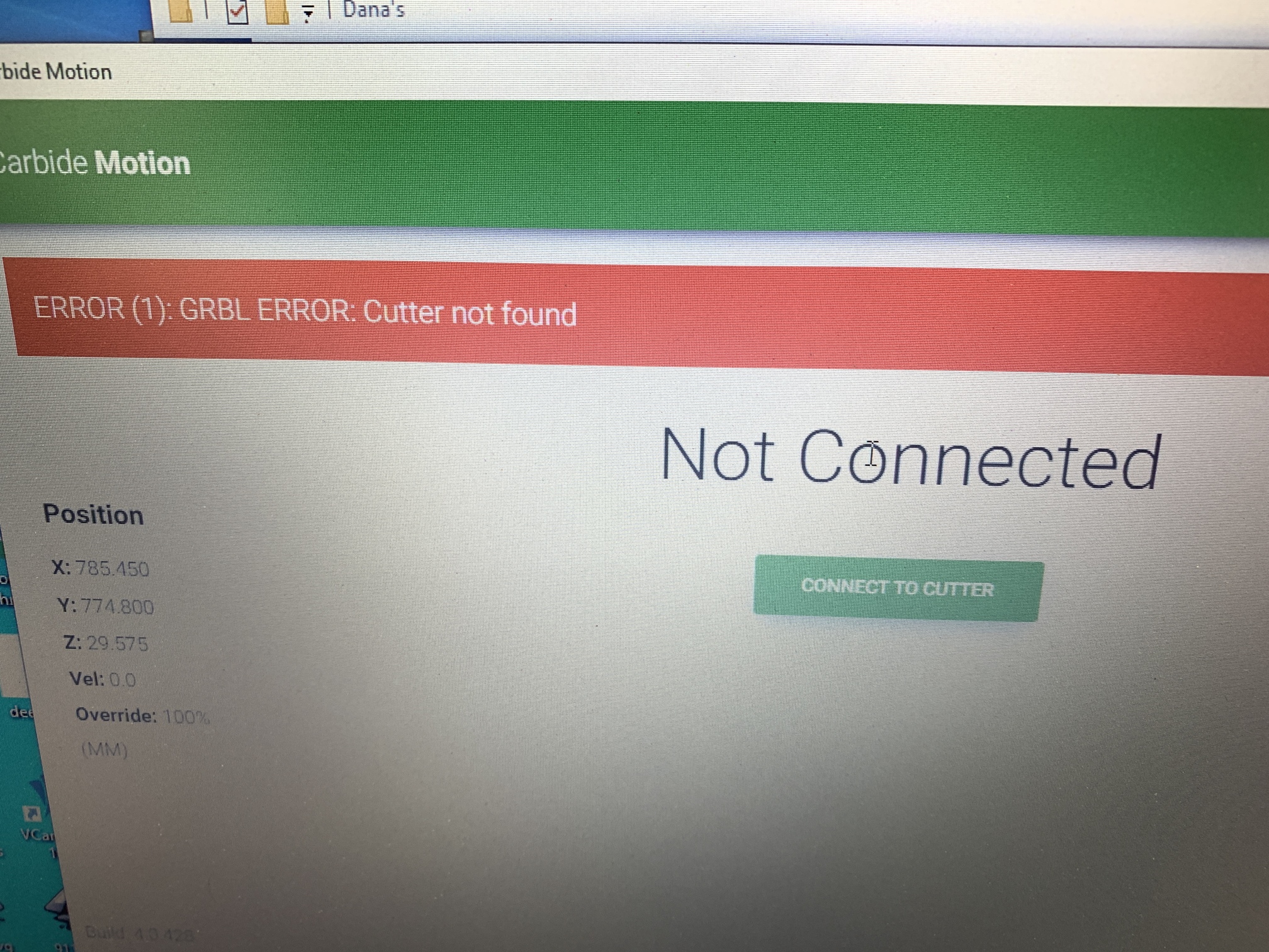

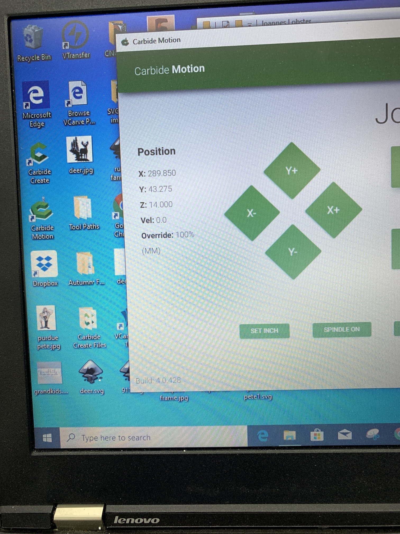

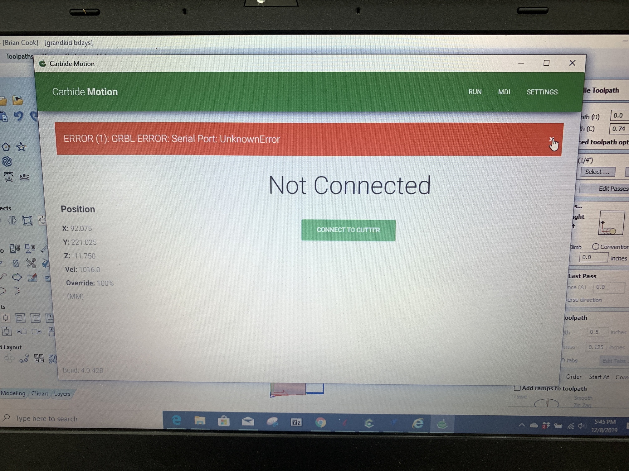

Why does my Z raise up and over travel and stutter/skip every time I start gcode program. After I zero Z, I jog up a little to remove my paper I used for zeroing and than press “start” and Z raises and over travels and I lose my zero. When I initialize/home machine it works as it should. I have doubled and tripled checked everything on Z and can’t find anything lose. I was 3 hours into program, when I got Grbl socket error, cutter not found, and couldn’t recover so I had to shut everything down and attempt to restart from beginning. XY axis kept zero but Z I can’t get to stay zero and start without over traveling up.
Any ideas, I’m running out of time on this project.
This is usually cased by setting safety/retract height to a dimension greater than there is to travel from where you have Z zero set relative to the stock.

Program started fine with no issues until I got the Grbl error 3 hours into program. nothing program wise had changed. All I did after recovering from error was re-load same gcode. Re-zero z only. I started off with 1.5” piece of pvc board 14.375”T x 22”W x 1.5” thick. It had cut up to .5-.6” before the disconnect error. I’m using blue tape and CA glue. I was on a 3D roughing pass, using aspire and carbide motion.

For the Grbl error, was it software or an EMI disconnect? Check to see if it was the former by running the file in check mode (send $C, then send the file — it will process but the machine won’t move), then send $C again to get out of check mode).
For EMI disconnects see: https://wiki.shapeoko.com/index.php/Electronics#Recommendations

The error is most likely EMI.
Unable to connect can probably be solved by closing CM, unplugging USB, then reconnecting.
The Z crash is probably because you’re retracing 0.8in and don’t have that much room?
What’s a good “Safe Z” setting. I’m cutting 3D file that is 1.5” thick
No clamps to avoid, no reason to go more than an eighth.
