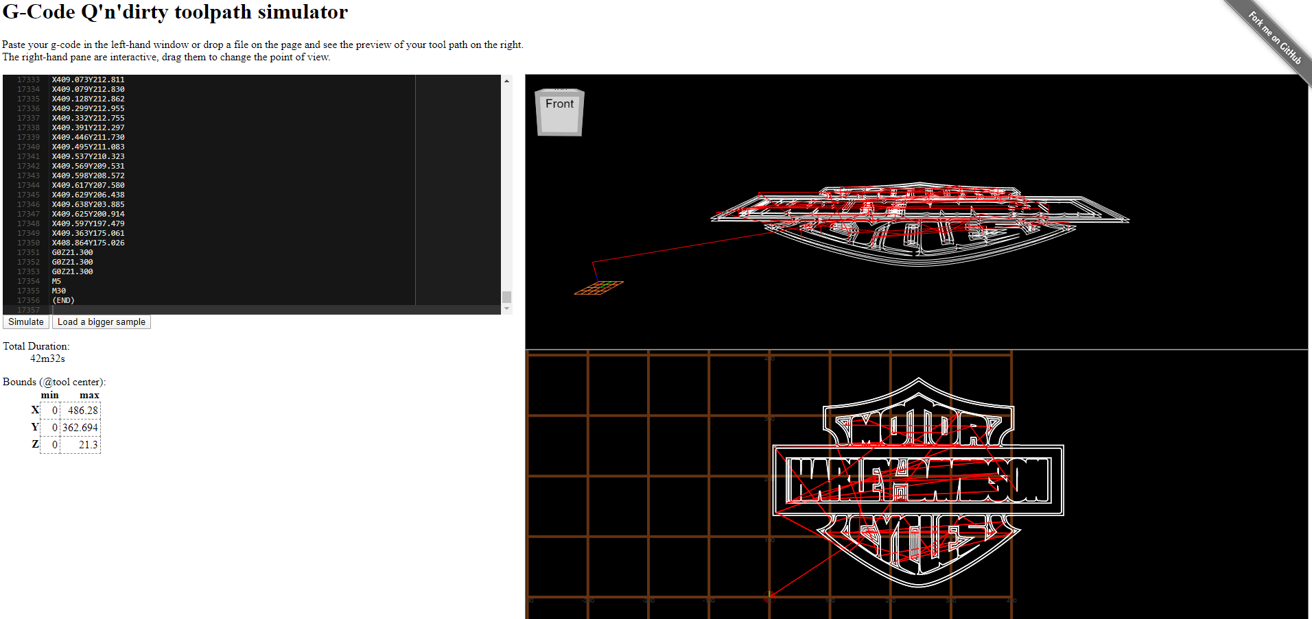

Hello all.
When i make a z zero every things looks fine, but when i after that press run.
The Z jumps up and starts at Z 21,000 mm as zero and is just cutting in the air.

Does CM show Z=0.00 just before you press run ?
Can you post your design file and G-code for a quick check ?
Did you set zero at the bottom of your stock in your software?

Hello Julien.
Yes the Z=0 before i press run.
And no i did not set set zero to the bottom but to the top of my stok.Harley loge grov 250 pocket.c2d (1.2 MB) Harley loge grov 250 pocket.nc (280.4 KB)
Neil meant, in Carbide Create, and you did
Itās an easy mistake. You need to set Z zero at the same place you declared you would set Z zero in the design file in CC
EDIT: by the way, itās a good habit to preview your generated G-code, I often catch my mistakes that way. Hereās an example of an online viewer, thatās where I saw you had a problem in the Z-zero setting even before opening the CC file:
The free CAMotics tool is an offline G-code viewer that is pretty popular too.

I feel stupid. It ofcorse solved the problem.
