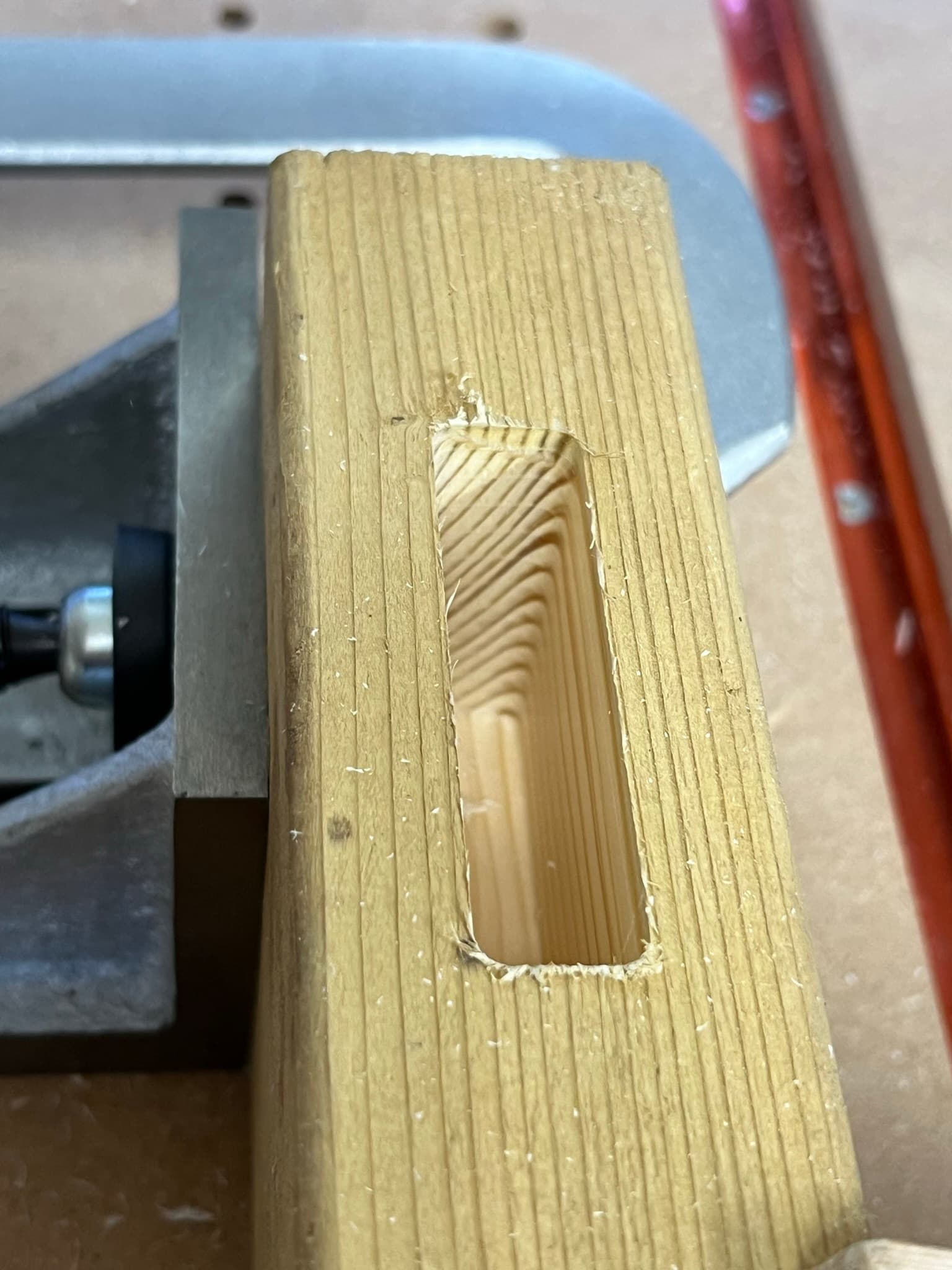

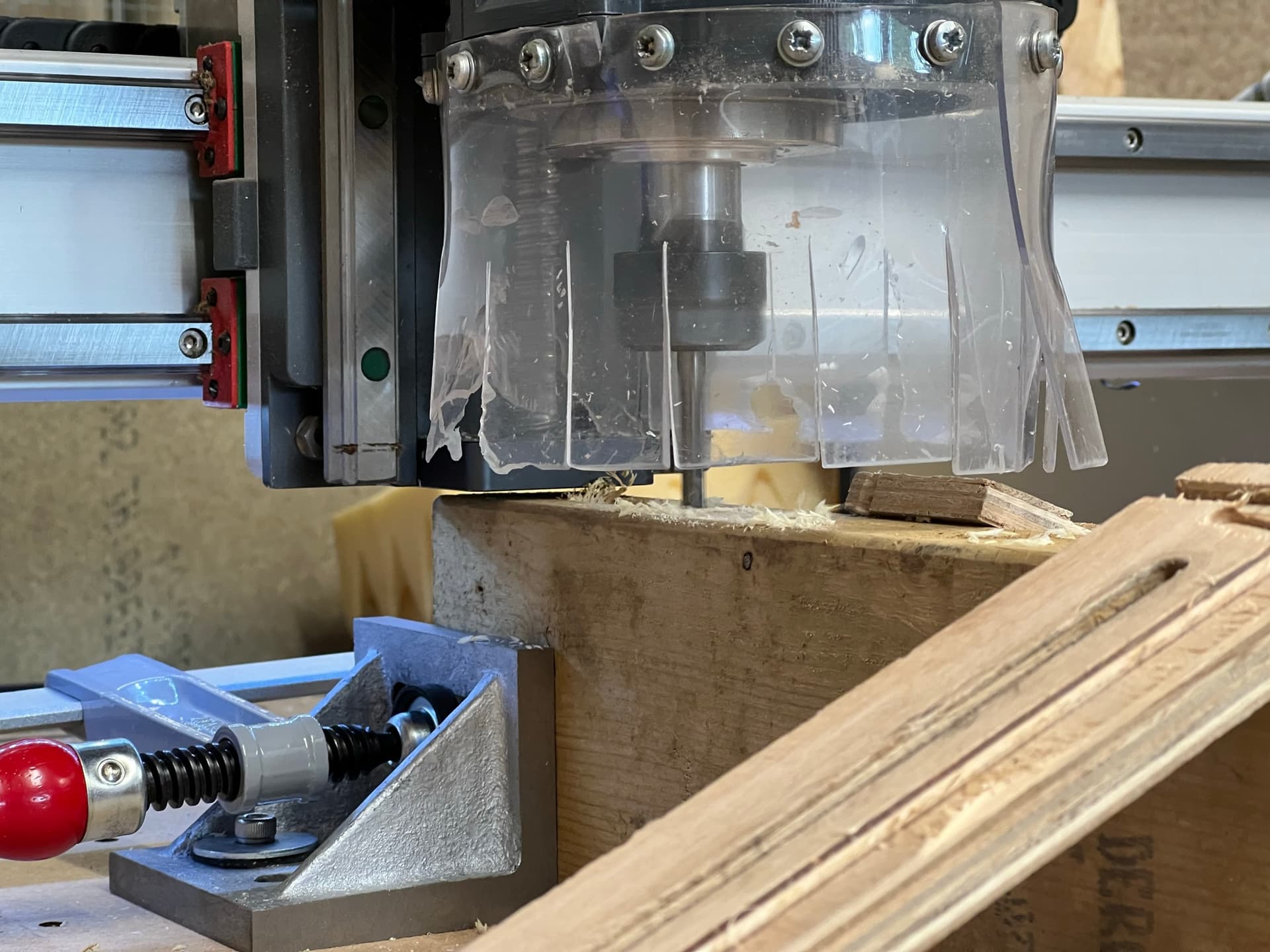

When the job makes more sense to zero off the top, I do that too, for example, I was making some mortices in some 2x4 for a shed door, and figured that was a job for the Shapeoko (any excuse).
Clearance is clearance…
But seriously, with the very limited Z clearance I had to set the retract height to 3mm above the stock, which was inconsistent thickness by a couple of mm and I wanted consistent depth mortices. I zeroed X and Y off the angle plate and a dowel you can’t see behind the 2x4 and then Z off the top of each piece of stock I fed in.
