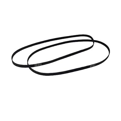

@biluagd If you has an older version of SO3 check your belt. If it is 524GT2 then you need a shorter belt like 520GT2
Anyone know why SDP-SI doesn’t carry 520mm endless GT2?
Robotdigg has it of course — also found this listing on Amazon:
but not finding anything else.
