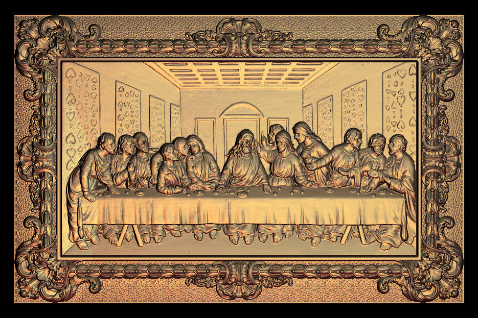

I am seeking for someone to help me to produce gcodes from stl files to run on my SO3 XXL
and I am going to pay for your help. I will supply you with the original stl files.
Pls help - I am new with CNC and completely lost - I do not know where and how to start, even though I am trying to learn online the basic but not successful to do this task. The Stl files which I bought from ebay.

So if some one can produce the gcodes from one of my stl file.
I can read the gcodes and will be able to understand and maybe able to produce the gcodes for my other stl files using your gcode as sample and guide line and instructions
I am attaching the stl file here ( The Last Supper ) my CNC is a SO3 XXL
I am trying to attatch the stl file here but unable to do so, perhaps the file is too big - is there any other way to attach the stl file here?
If you’ve purchased the file, the license probably doesn’t allow publicly posting it — I’d suggest trying one of the free programs, or a demo, or waiting until someone offers and e-mailing it.
If you’d like to you could send the file in to support@carbide3d.com and let us know what material you’d like to cut it out of, and what endmills you have to use and we’ll see if we can work up a file for you.

I am going to use wood for this
I do not know how thick or how height and how width my stock should be.
I do not know what size of end mills do I need.
The artist who sell the stl art works is not an CNC exprts, I contact him and ask what is my stock sizes and end mills I need and he is unable to help me, he is an artist not cnc geek
so base on what i just wrote here, do you still want me to send you the stl file, i have SO3 XXL
Thanks in Advance.
Hi WillAdams - will this software will read the original stl file and give me tool-path or gcode to run om my SO# XXL - do I use CM4 or GRBL to run it? I am just a bit old to learn and afraid not be able to understand the software
MeshCAM is really the easiest CAM tool.
It will make G-Code which either Carbide Motion 3 or 4 can send to Grbl.
To understand the software, the community has a basic page on this at: https://www.shapeoko.com/wiki/index.php/Software — if any of the terminology is confusing please see: https://www.shapeoko.com/wiki/index.php/Glossary
