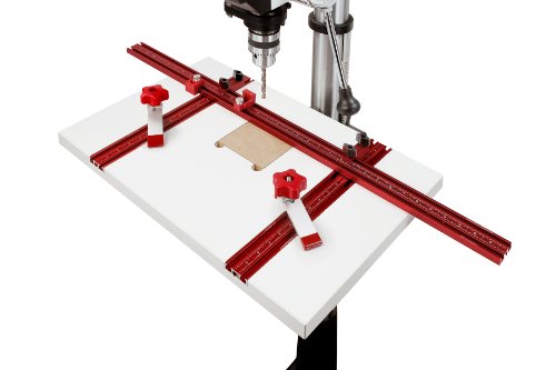

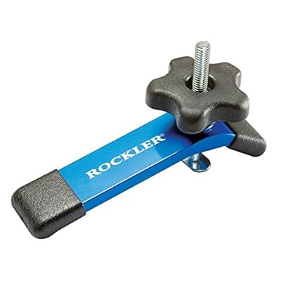

What clamps are those?
Looks like a mix of
http://incra.com/jig_fixture-build-it_system-clamp.html
and some other company which uses red — we have similar ones (in black) listed from Peachtree at: http://www.shapeoko.com/wiki/index.php/Workholding#Commercial_Clamps
The Incra’s are from the build-it system like Will says, the “plain red ones” came with a Woodpecker’s drill press table. Either variety costs about $10 give or take. The back track is far enough back that the spindle can’t hit the knobs.
The t-track is “Orange” brand, and has clearance in the bottom for screws to mount it. Used 48" lengths cut down.
Plenty of makers of the generic looking clamp, like this all in that $10 range (with shipping):

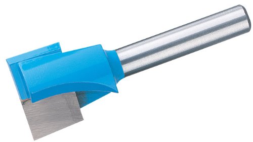

what bit did you use @mikep i have the xxl but id like to make a 16x16 spoilboard for small stuff.
I used this bit:
Thanks for sharing @mikep
i have the same one.
Do you guys think one of these straight bits in this kit would do it? I already own one of these kits. https://www.amazon.com/Stalwart-Multi-purpose-24-piece-Router-Bit/dp/B000X47YDE/ref=lp_686957011_1_1?s=power-hand-tools&ie=UTF8&qid=1487732230&sr=1-1
Yes, one of the straight bits should be fine (in general, router bits with appropriate paths, feeds, speeds, and depth of cut, are fine so long as they don’t have bearings) — just take a really light pass / skim cut so that you don’t overtax the machine or cause things to not be plumb and square.
