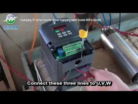

I got an email from my spindle supplier with a wiring diagram and video guide. I will have a look through and put that up here when I get home.

Here is some of the information in my email, this is for a Huanyang original inverter:
If you don’t know how to make the proper electrical connections, the following will help you:
Connect “R” and “T” (at the inverter) to the single phase power supply. You could also connect “R” and “S” or “S” and “T”. Both ways are ok.
If you use it with three phase input, then connect the three phase power supply to “R, S T”, and then connect the "U, V, W " to the motor 1, 2, 3(U to 1, V to 2, W to 3). Number 4 is for earth. You can either connect earth or not. Usually, we don’t connect earth
If you use this VFD for this spindle motor 0-400HZ , Please set the parameters of the VFD as our following suggestion step by step, and don’t change the sequence:
Step 1: Set PD005 =400
Step 2: Set PD004 =400
Step 3: Set PD003 =400
Step 4: Set PD072 =400
PD144=3000
As the orginal factory value setting is for a normal 50HZ motor, so please change the the above parameters according to your motor. If there have any other questions please feel free to contact with us.
And the inverter need connect with the motor directly, cannot connect breaker or switch between the inverter and motor.
Video Link:
