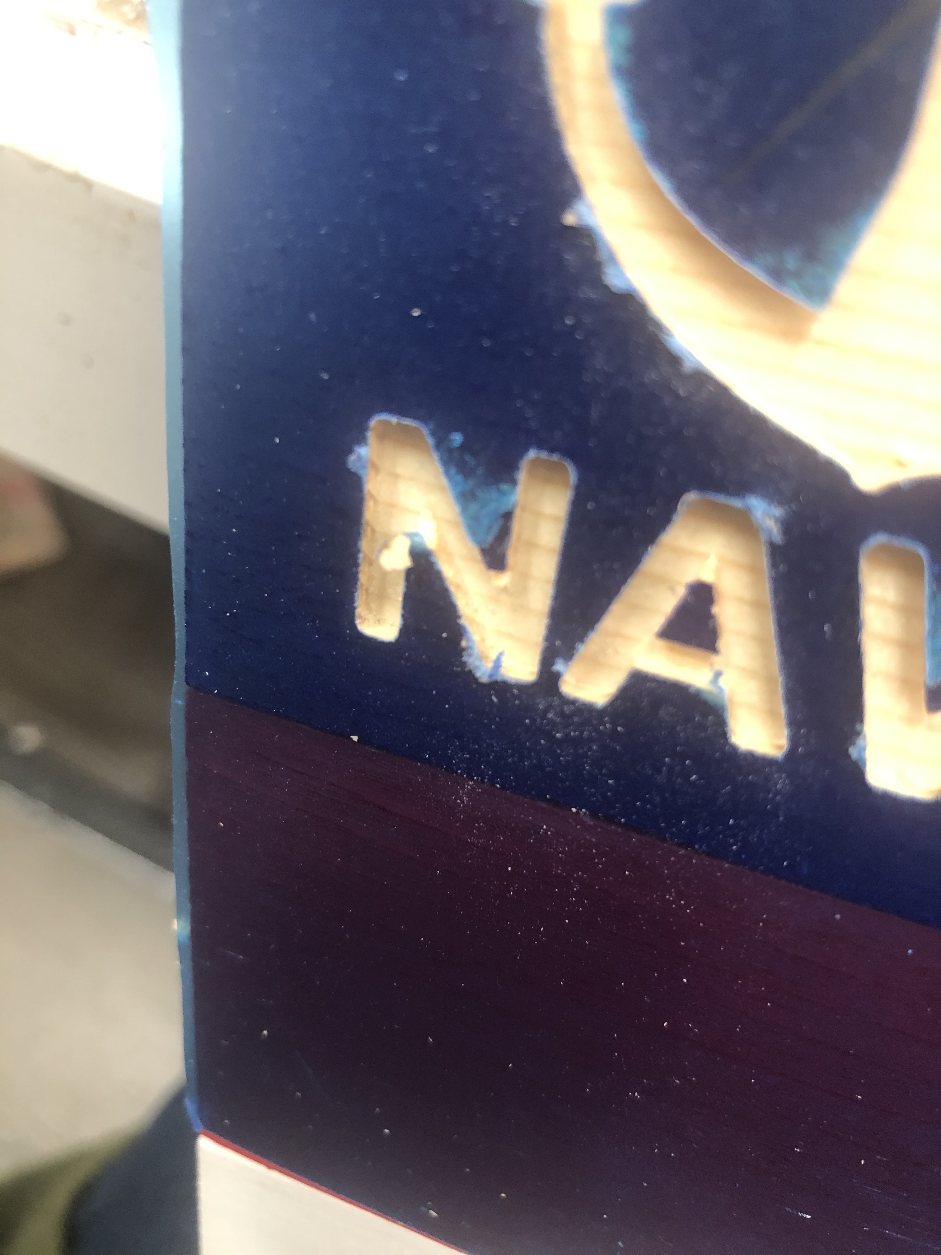

1/16” bit causing tear our and chipping
Here is my dilemma. I’m cutting into pine with paint and blue oramask 813 on top. I’m using the Nomad 1/16” upcut bit to cut out small detail. Should I be using a downcut bit instead?
I would recommend using a downcut bit with a finishing pass.
Before giving up on this use a stiff nylon brush on the project to try and save it. Leave the mask on and see if you can save it.
