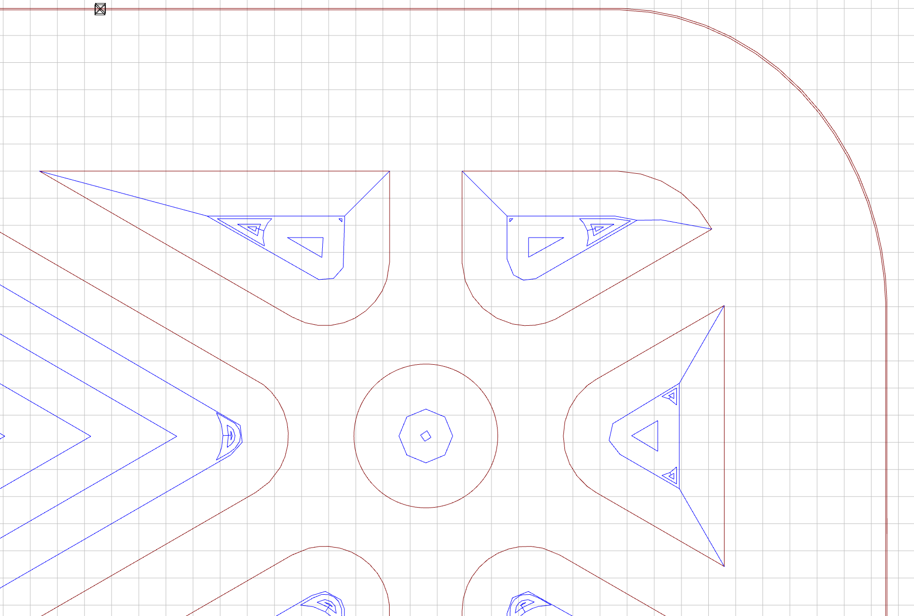

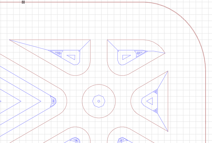

Features when I use a 1/8" endmill (not 1/16")
Causes these features to be roughed out with v-bit instead, which is not ideal (as in image below)

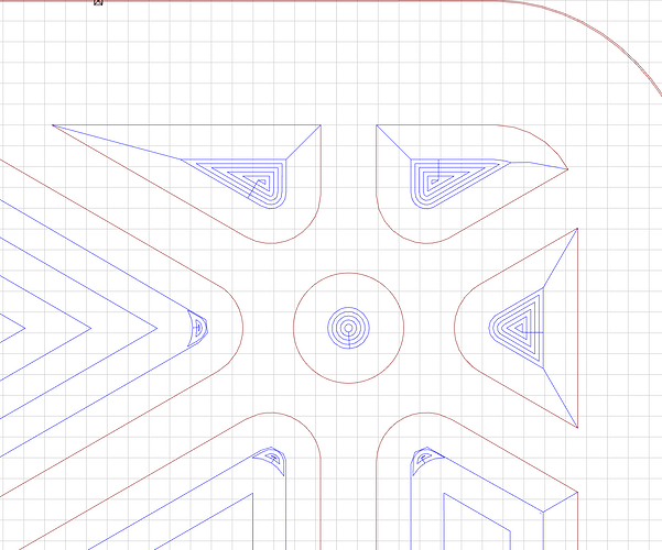

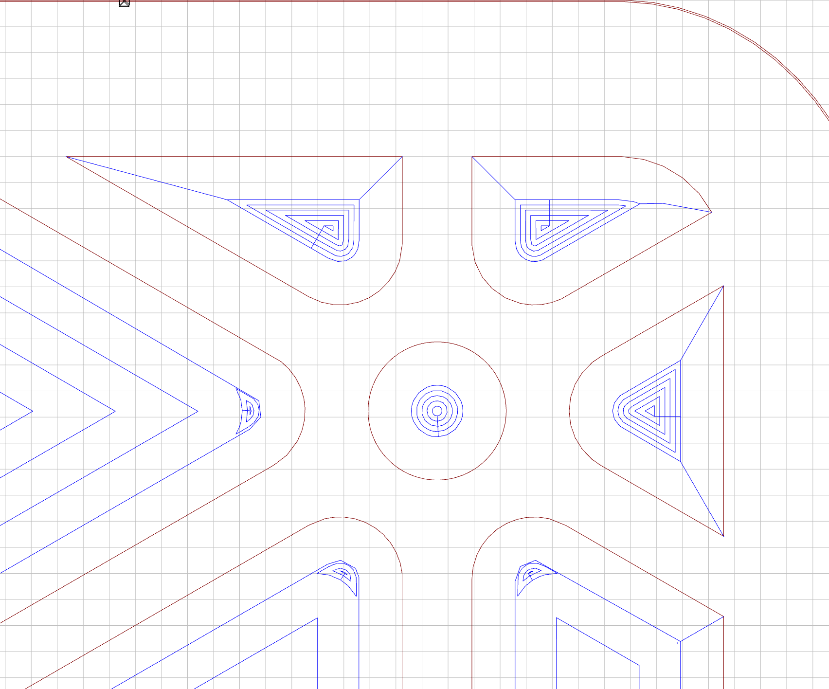

Features when I use a 1/16" endmill:
Great because it breaks the surface so the vbit isn’t plunged into 100% tool diameter wood
