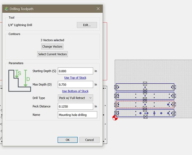

1/4" Lightning Drill
After Downloading “AmericanRevival” file from "https://cutrocket.com/p/651c7dfd9e119 and reviewing the tool paths I came across a bit I am unfamiliar with, Could anyone please direct me to the exact endmill that is being refereed to in the attached picture…

Most likely it is this:
IDC calls this series of bits Lightning.

CNC machines make poor drills. So if you have a 1/4" or smaller router bit that will cut .75" then you could increase the pocket size to .26" and use a regular end mill.
Drilling with a CNC is hard to do because drilling requires speeds of the router slower than most can go. It is possible but takes specialized cnc drill bits which are more expensive than what you likely already have. You just increase the 1/4" holes slightly and a regular 1/4" bit will cut the pockets just fine. Use an upcut if you have one because a down cut pushes the chips deeper into the hole you are creating.
basically anything over 3/32 shouldn’t be done on our machines if i remember the math, in aluminum that is, using a vfd.
