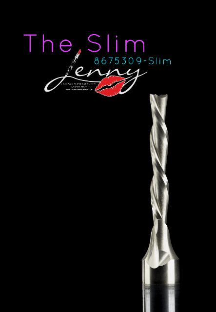

1/8 end mill with longer cutting length?
Any recommendations for a 1/8 end mill with a cutting length longer that .5”? 3/4 would do.
I pretty much use these exclusively for doing cutouts.
HOZLY Woodwork Milling Cutter,DLC Coating,UP & Down Cut 2 Flutes Spiral Carbide Milling Tool CNC Router Compression Wood End Mill Cutter Bits,1/8Inch Shank,1/8Inch Cutting Dia,22mm CEL Pack of 10 Amazon.com
I run them in a S5P with spindle at 200 IPM at .2 DOC.
I’ve had good luck with tooling from
This one has a cutting length of .8 and is on a .25 shank
Some great recommendations. Thanks all.
