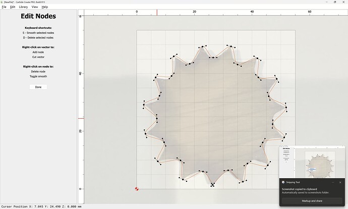

Import a background image:
and adjust as desired:
Assuming that this is an organic/decorative shape (rather than a regular gear) use the polyline tool to draw the basic geometry:
Go into Node Editing mode:
select all nodes:
and smooth them:
Zoom in select and and reposition nodes until the desired shape is arrived at:
Where appropriate hold alt/option and drag to make a “Sharp” node:
panning around as necessary to address each section:
iterating until one arrives at:
Done
