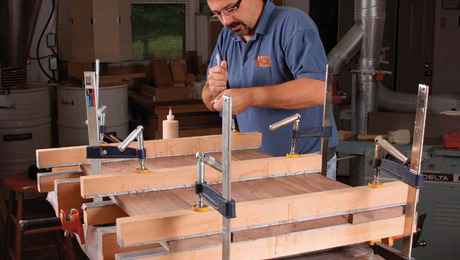

See picture below - how else would you have clamped such a large piece (or do I have to buy a hydraulic press)

The problem with the “clamping from the sides” (which is unavoidable when doing large inlays and using side clamps) is that it will tend to bow the male inlay, especially if you have a large saw gap, and the middle of the inlay might not be pushed into the female pocket so well. I don’t have a hydraulic press either, but you can mitigate this risk by adding a thick/rigid piece of [anything] on top of the male inlay, and clamp onto that.

For clamping larger pieces, you could look at cauls - clamp boards across the piece to put pressure in the middle.
https://www.highlandwoodworking.com/woodnews/2010april/cauls.html

For clamping, out another piece of hardwood on top of the inlay and add as many clamps as you have plus a few more. More force helps.
I found an oversized book press for when i need one. They work great put the pieces in and turn the wheel and apply preasure.
Lots of good advice here on tool and toolpath adjustments. My .02 on glue: Too many clamps is never enough! Firm, even clamping is needed with face grain glue-ups. As the wood gets wet with glue, it can swell and move. It will try to do so, until it gets comfortable in the space provided. Take away the opportunity for it to move much… or at all.
