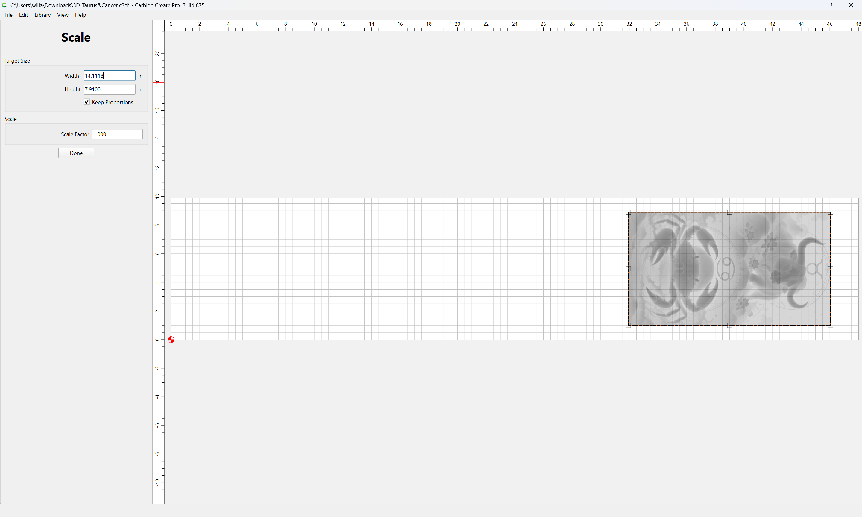

3D carve, bit is plunging on the right side

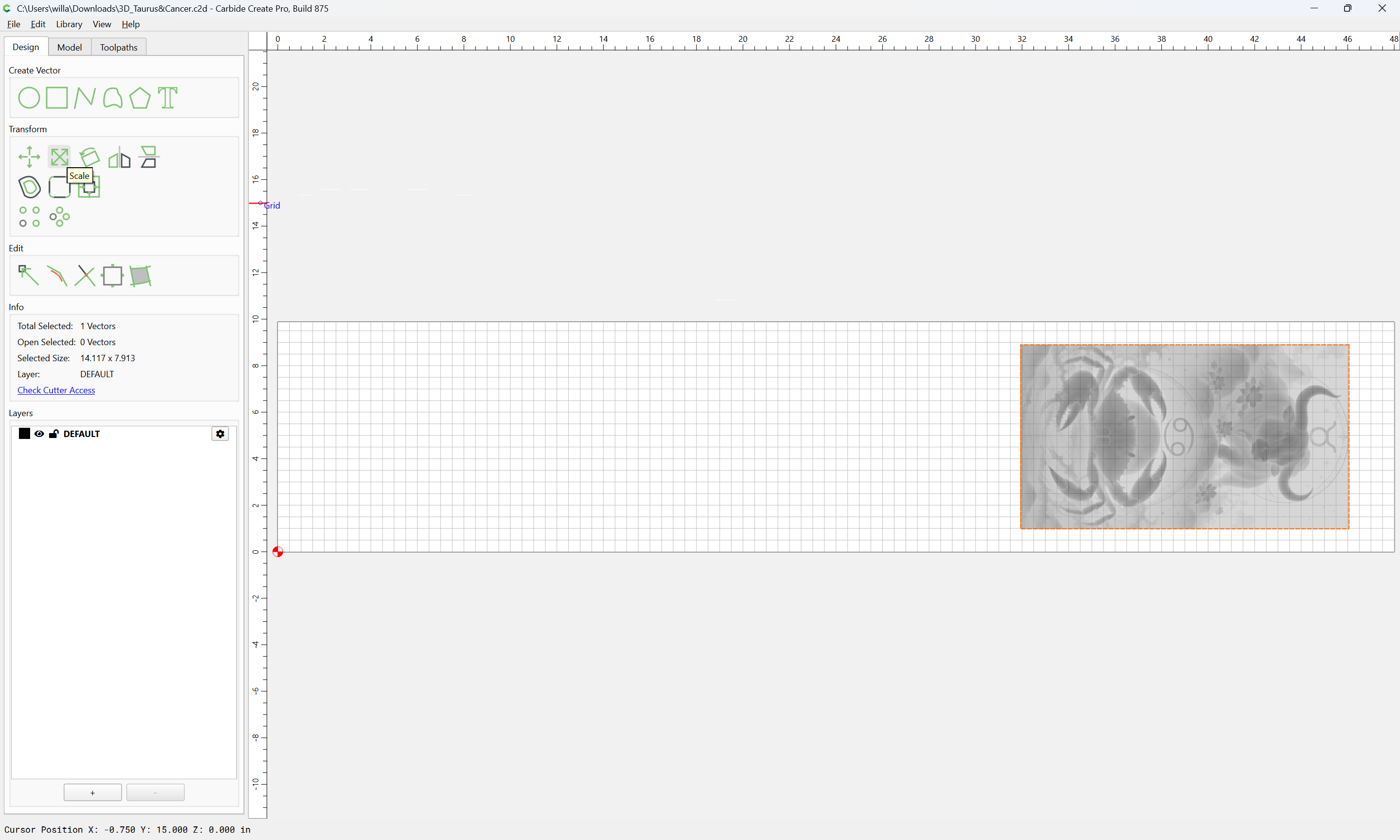

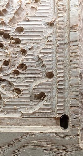

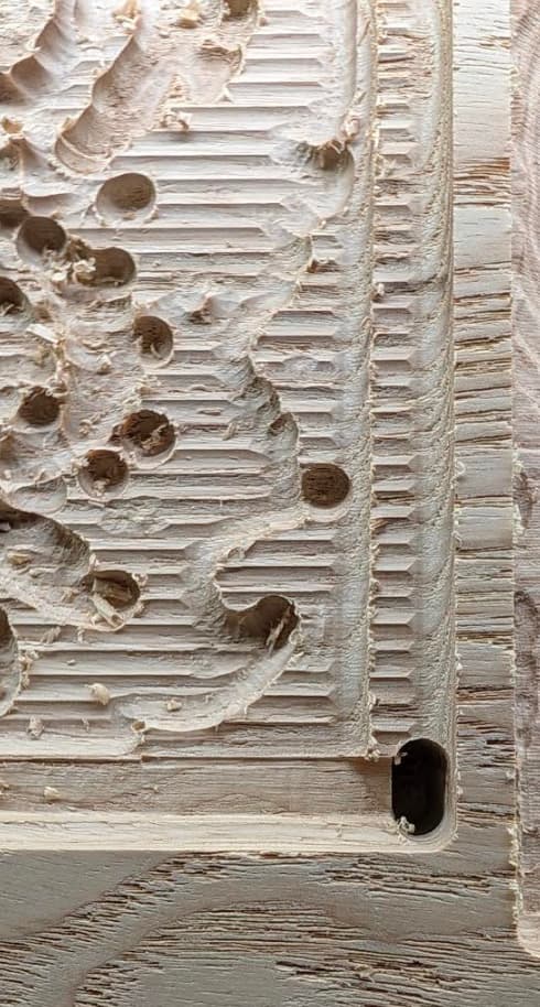

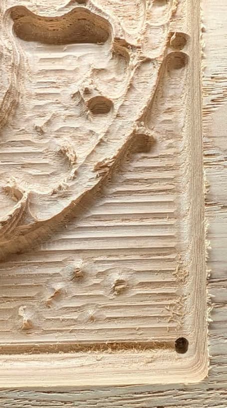

Hello all, so far I’ve been fortunate and haven’t had many issues with 3D carves, today I had two projects plunge the finishing cut down once it reaches the right side of the project. I have attached the .nc file hoping someone has the answer, the .c2d files exceeds the limits to upload. Thank you.

There’s not much to know from the .nc file. We’d need to see the C2D file to see what’s going on.
Here’s the .c2d file, haven’t shared anything from Google Drive so I hope this works, thanks.
Thanks!

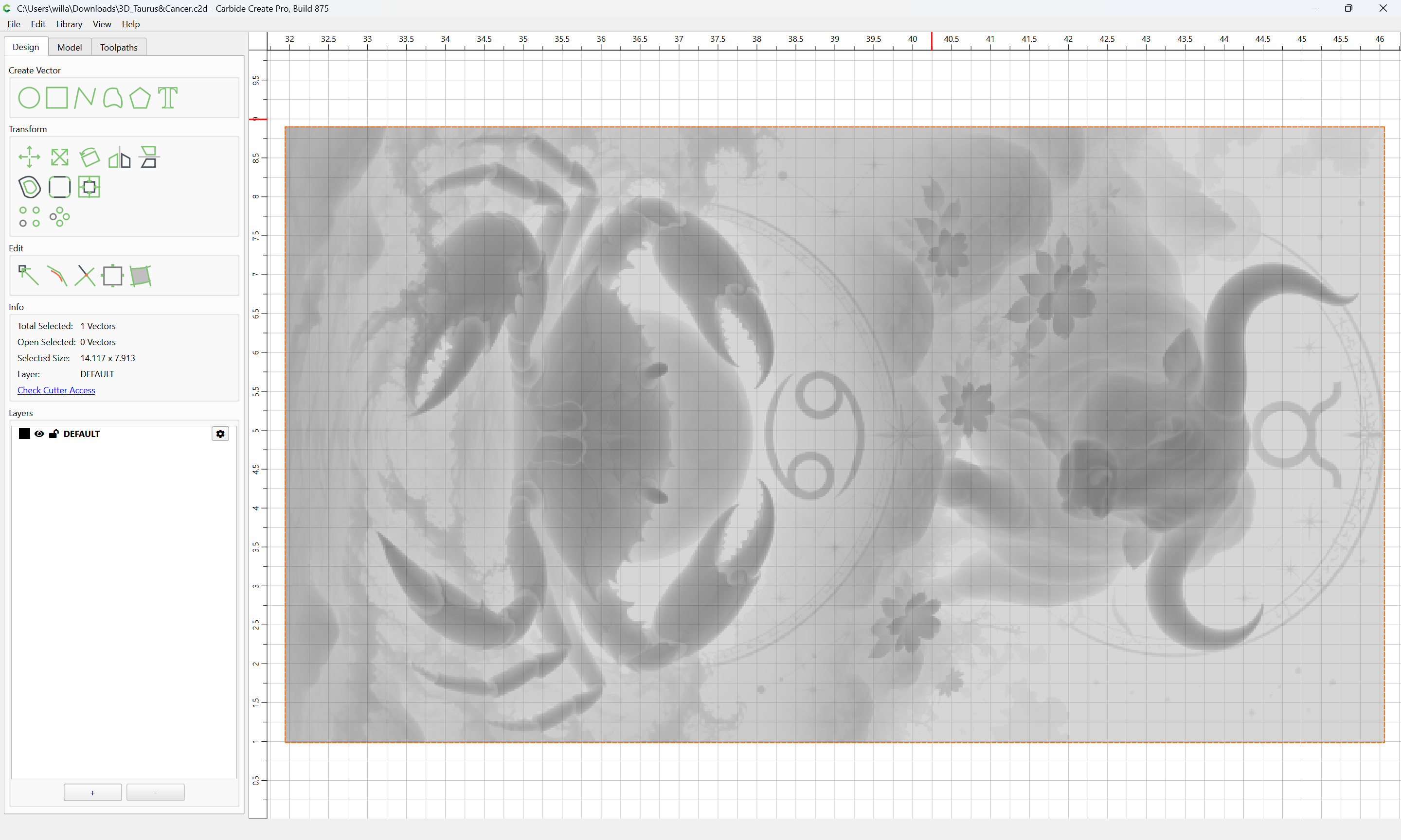

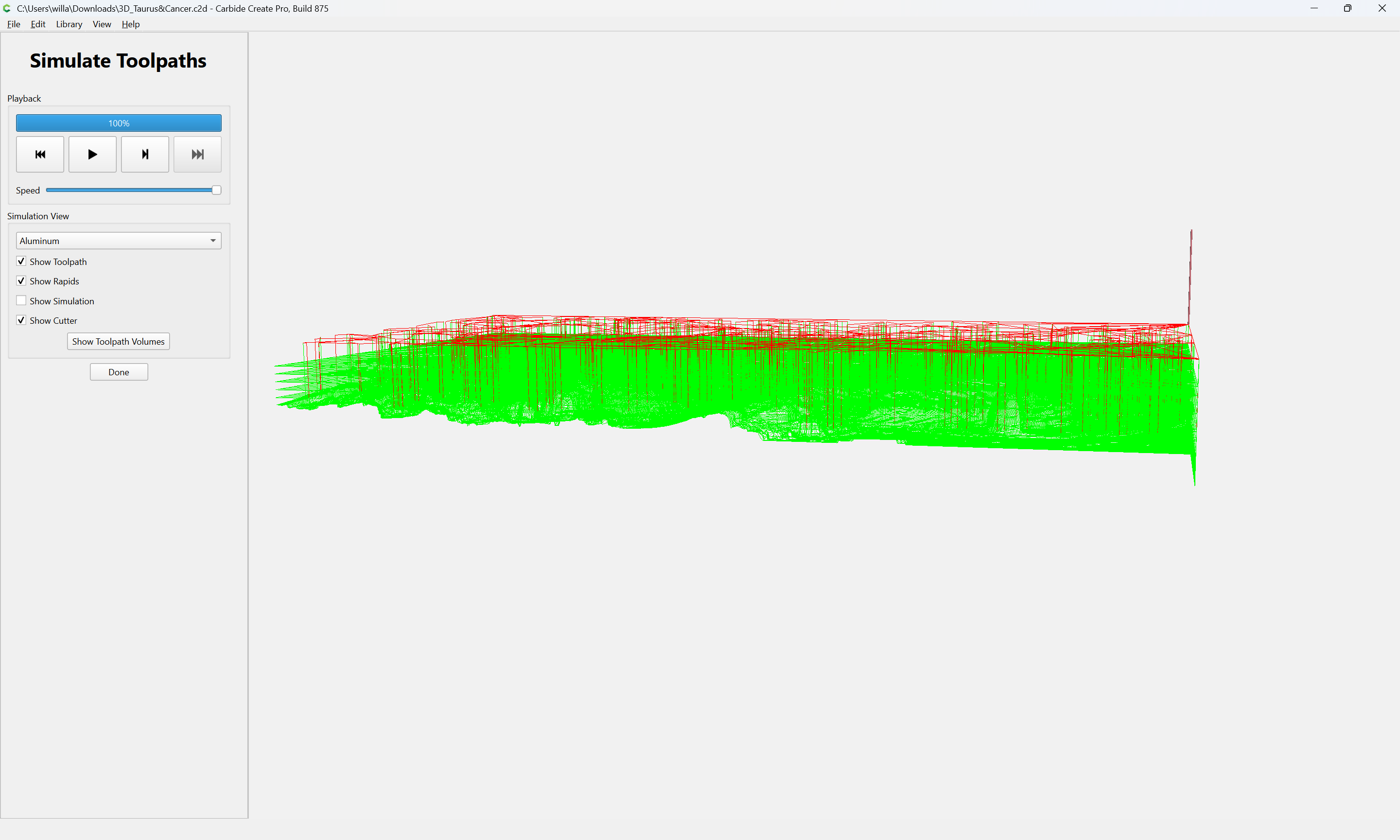

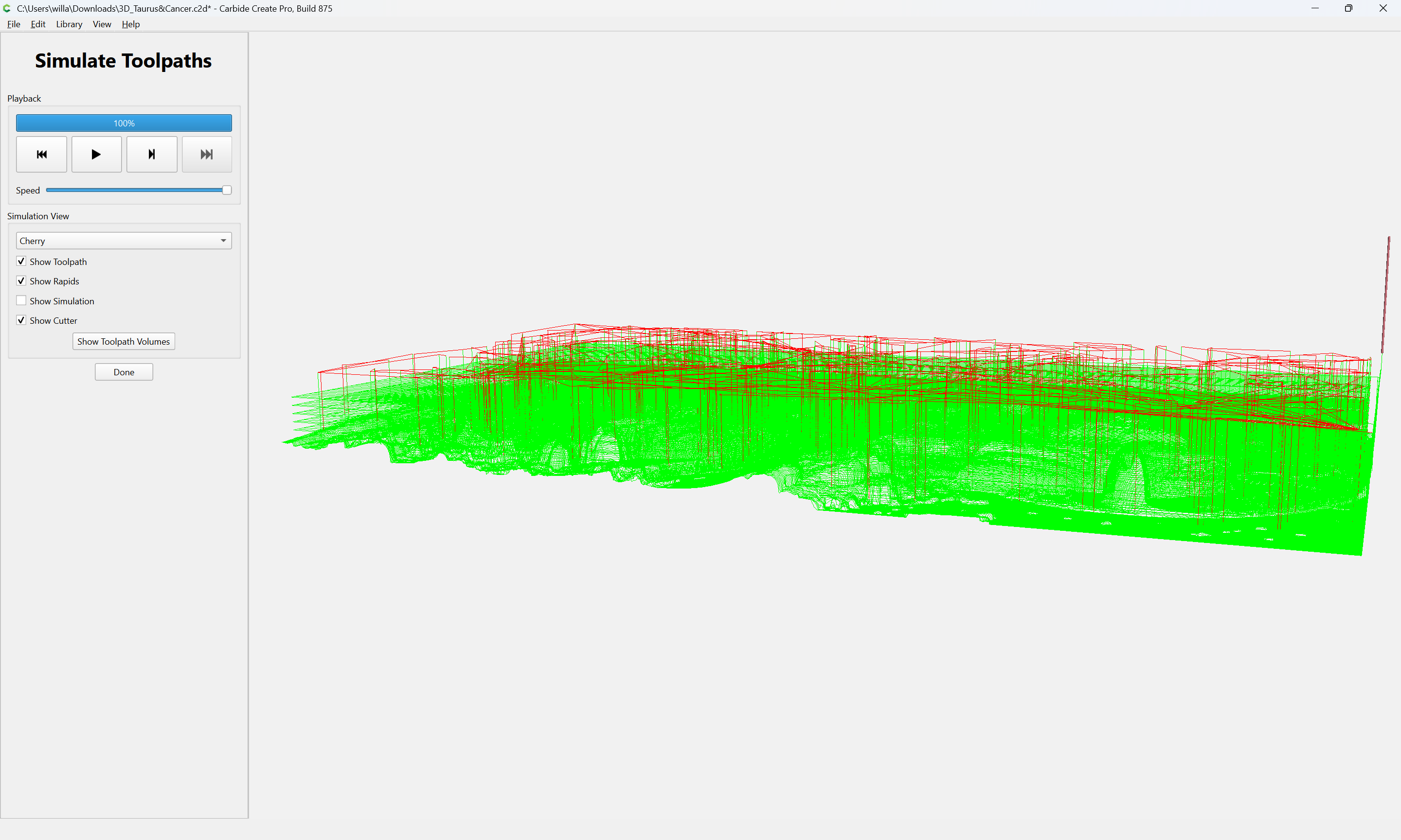

Hiding the Simulation we see the same plunging off the model in the 3D preview:

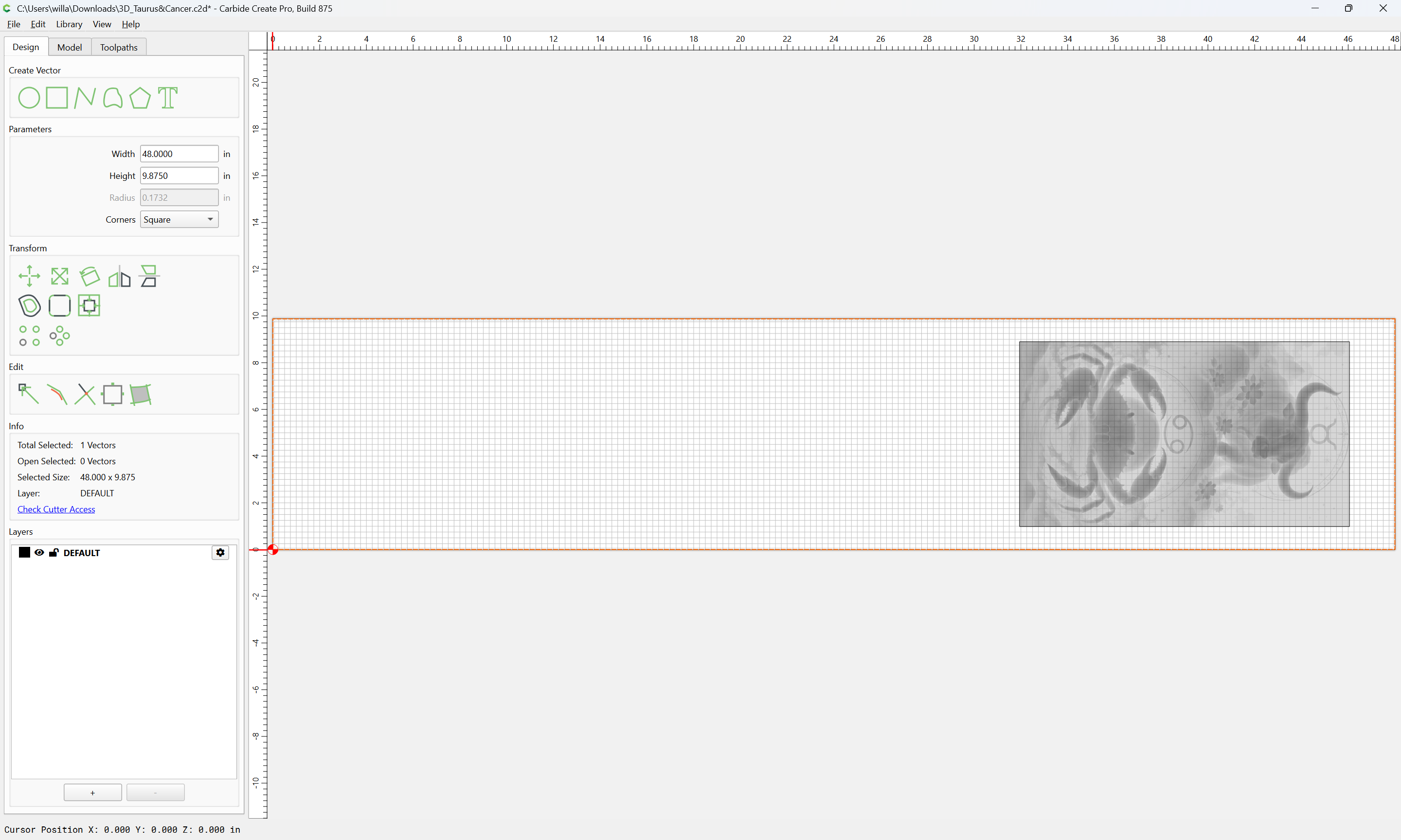

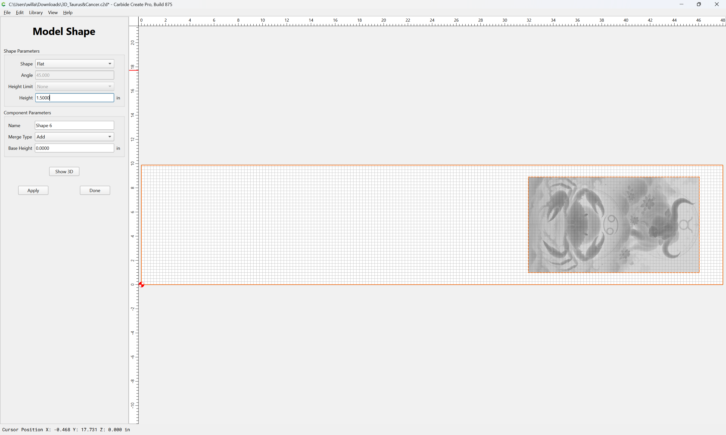

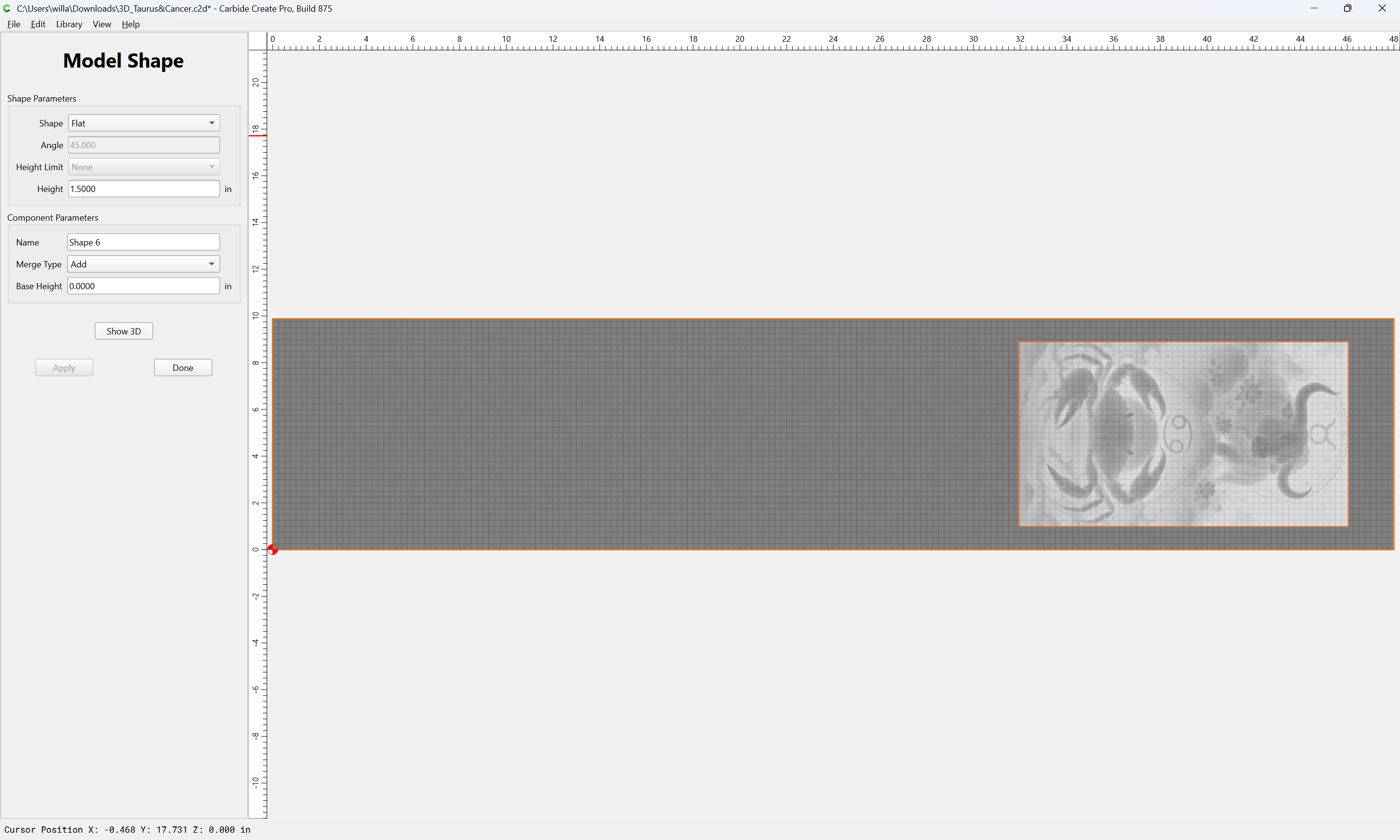

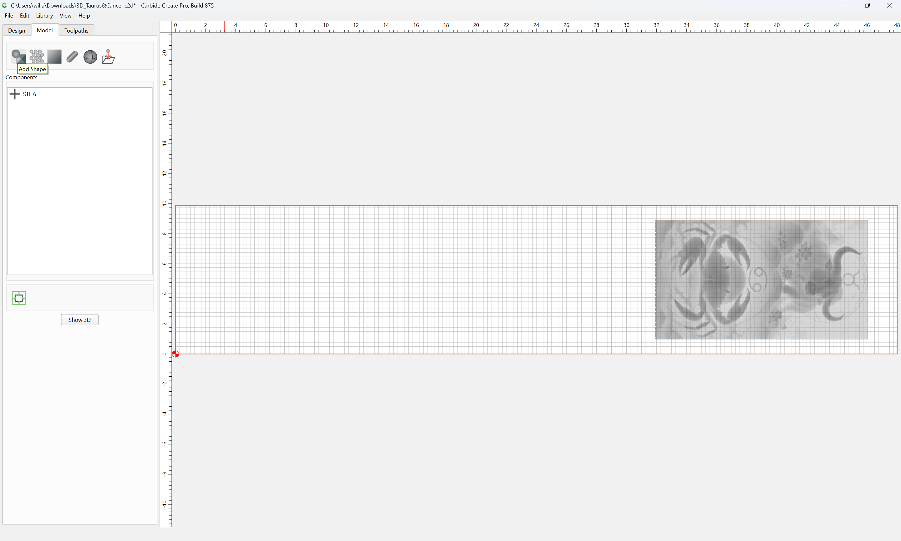

You can either model the balance of the stock:
Apply

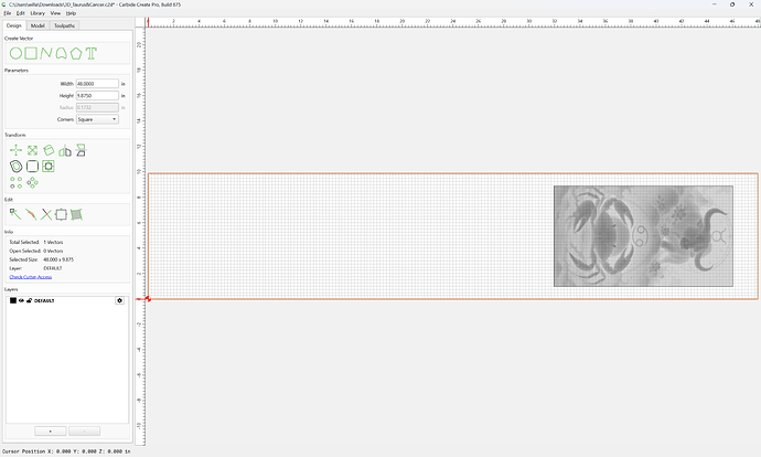

Or, slightly reduce the size of the geometry used for the 3D toolpath:
Awesome, thanks for the suggestion, I’m letting the file runout since that plunge isn’t too bad with this file but tomorrow I will try it again and see if that did the trick.
