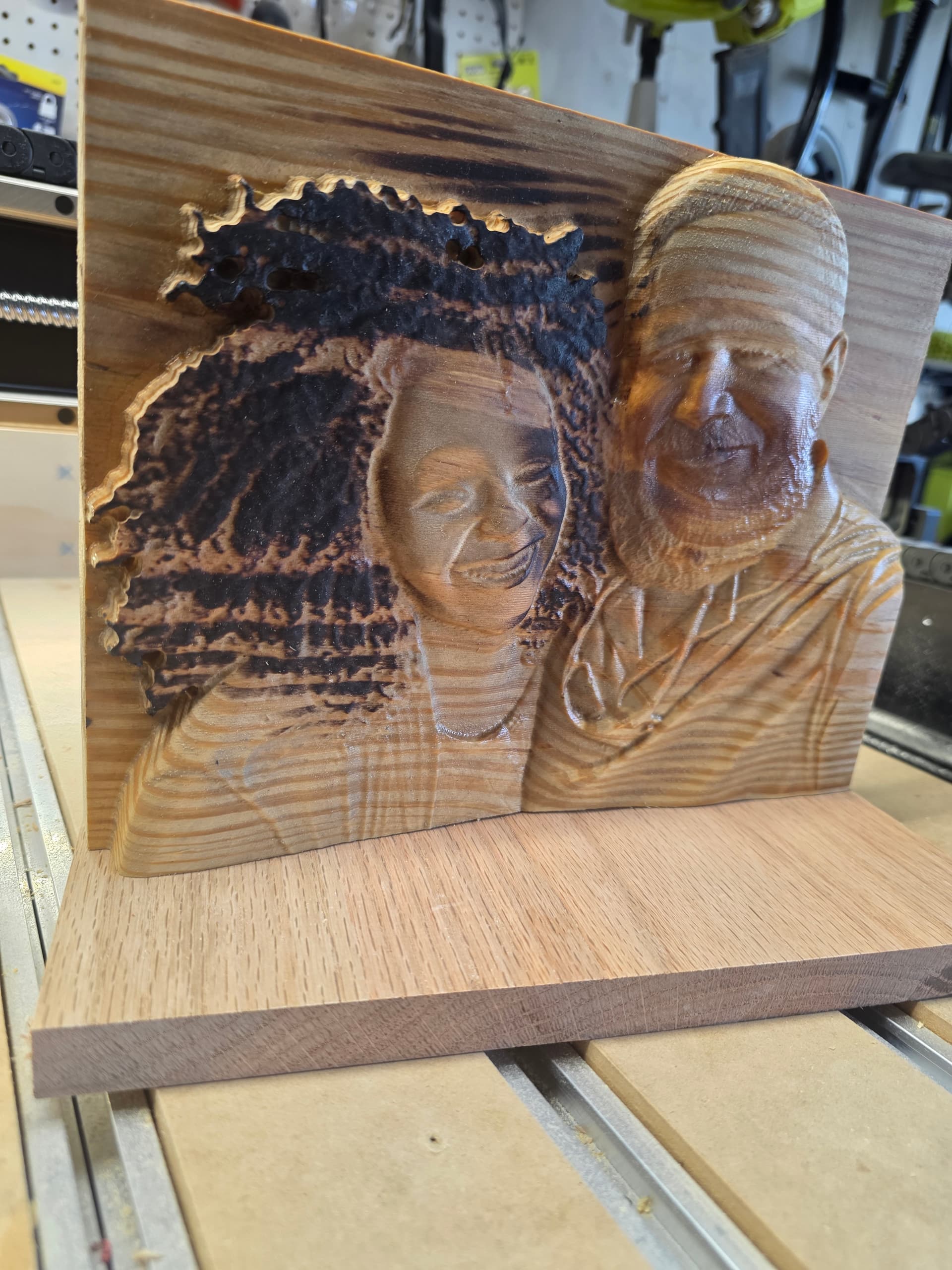

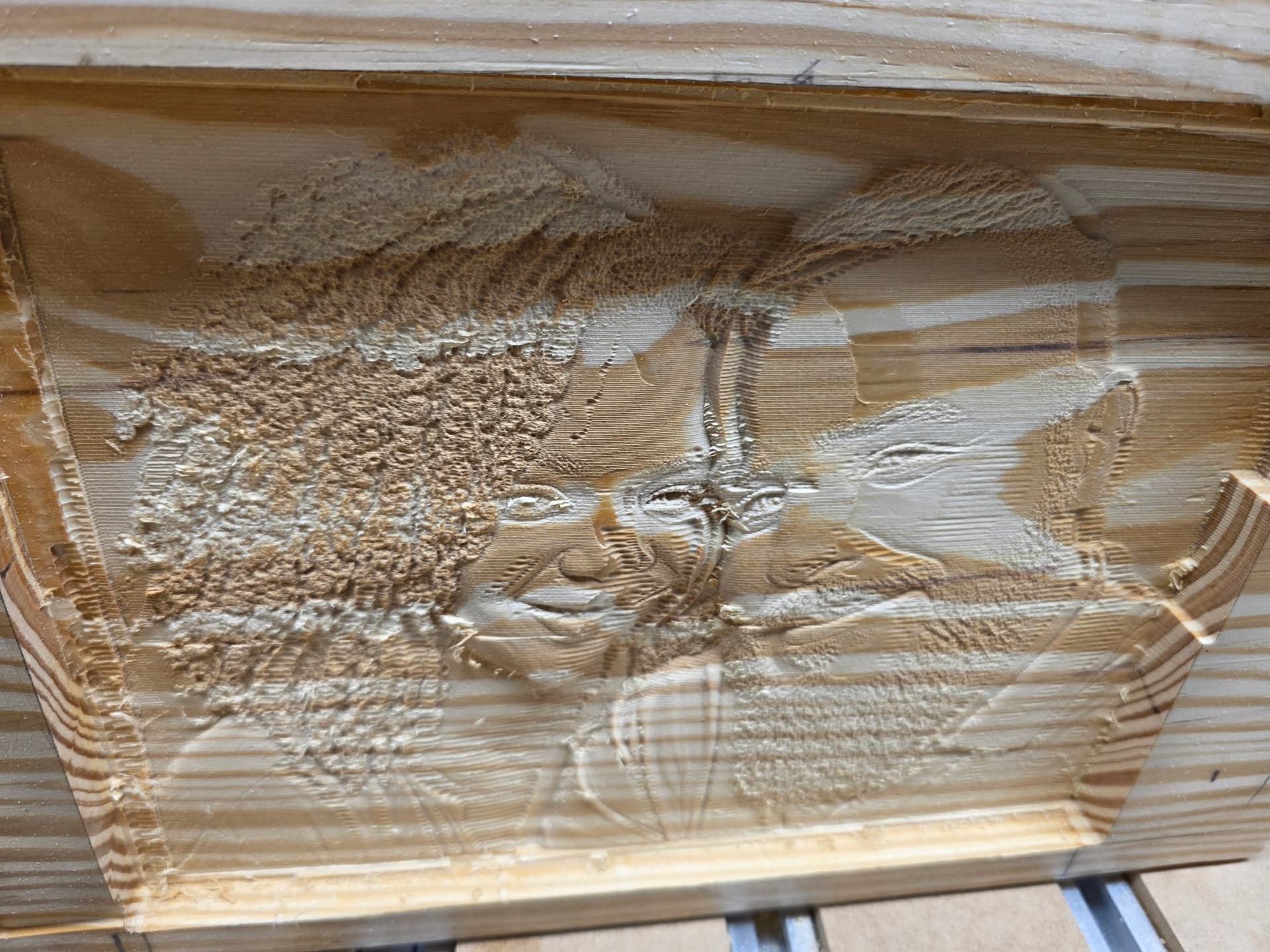

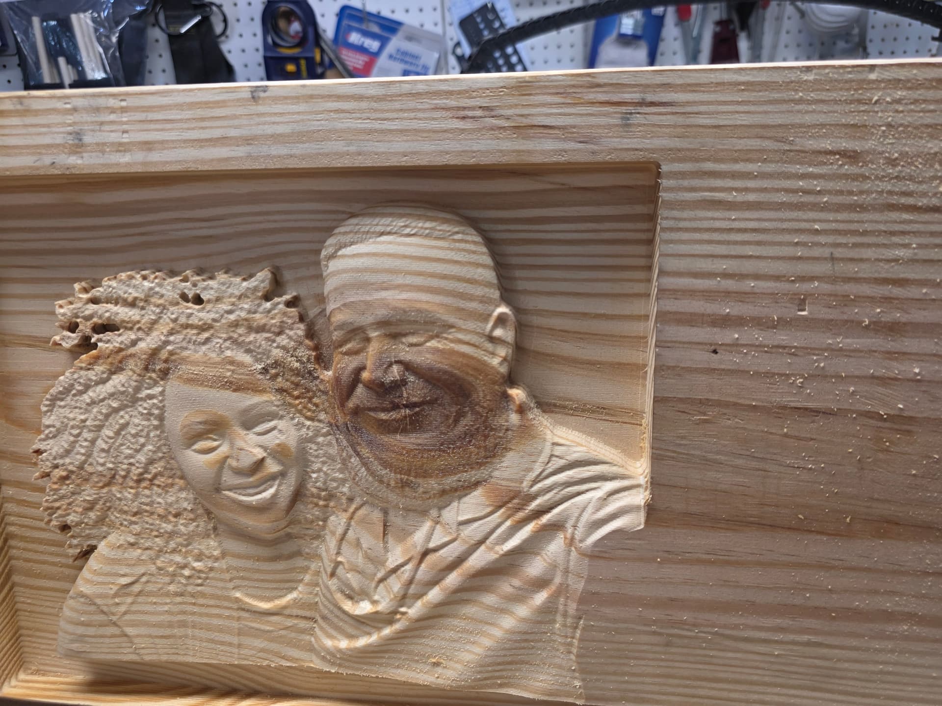

I think your material is one of your issues. Wide grained softwoods (with knots!) are just about the worst choice for detailed 3D carves.
I think you will have more success with straight grained hardwood. Your local Big Box hadrware store may have things like stair treads in hardwood.

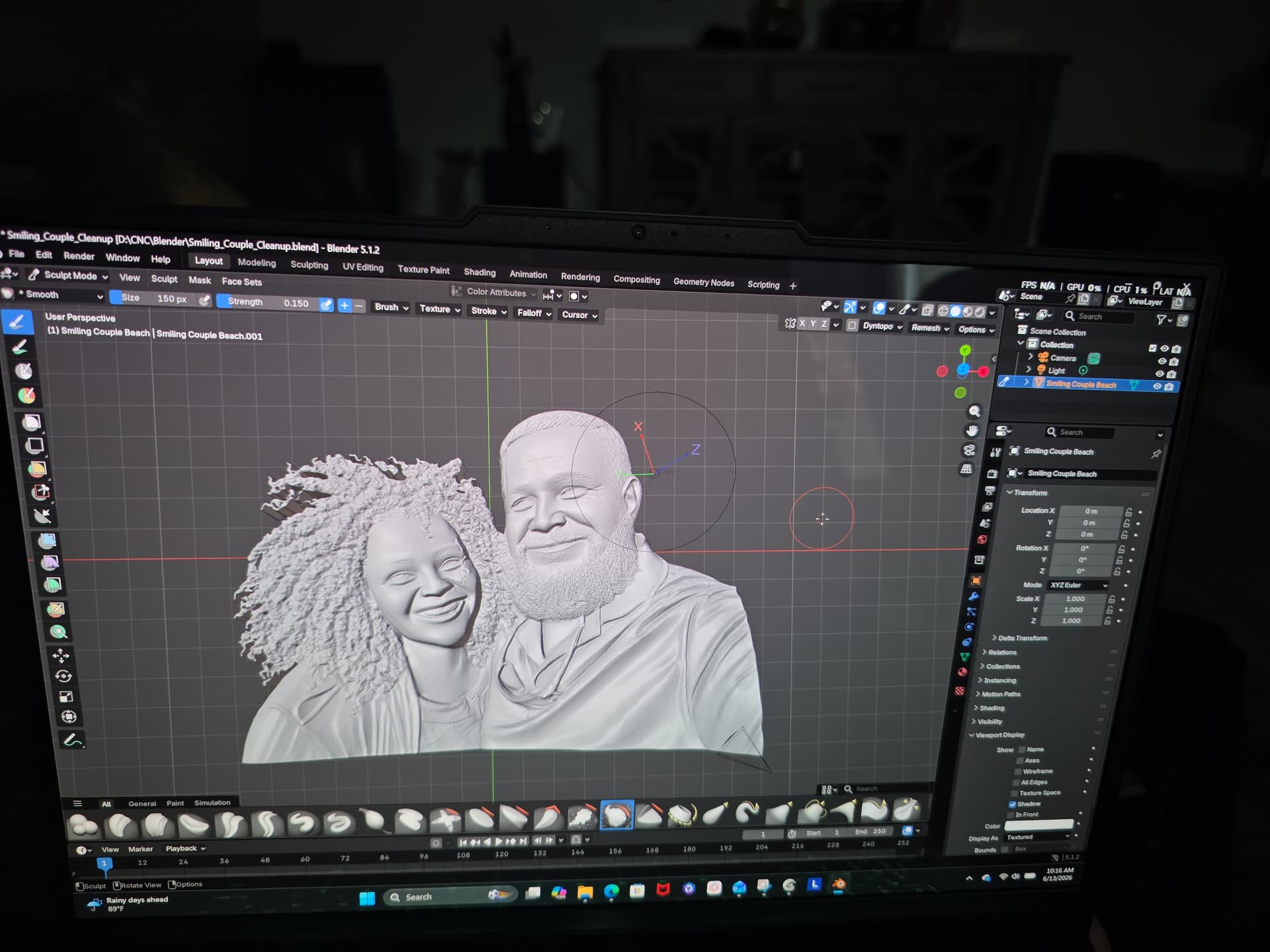

I agree with Michael Hotchin. Your Blender file looks pretty good and your carves show some pretty decent detail. The wood choice isn’t great. Where in SC are you? Do you mean South Carolina? Because that’s where I am and 3d design is what I do.

Just using cheap material until i get the hang of it. I made the mistake of thinking i knew what i was doing and ruined 150-200 in materials
Used oak and birch before and ate thtough it
