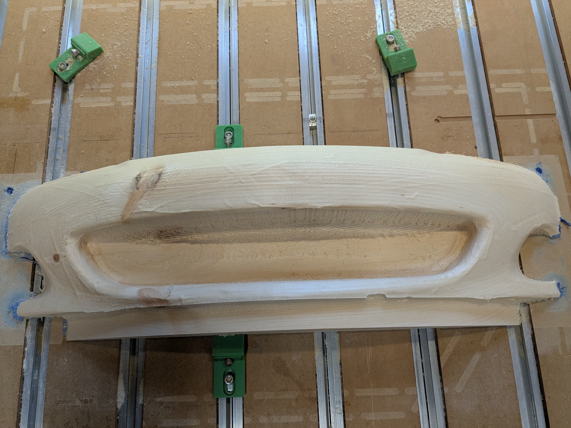

I stumbled upon a cache of cutoff Pine beams from a local company that makes Post and Beam barns. The material was big enough ( and small enough ) that I could give it a try.
I am also old enough now to laugh at myself when I screw up. I wish I had learned that much earlier in life, but I am here. All good.
The 3/4 round nose did the trick. The stepover was ,050 which made a .002 cusp.
The runtimes for 4 Scallop paths was under 90 mins.
The surface faithfully represents the “dirty mesh” . I will need to get better at cleaning results at the right time in the processing.
The area at the bottom of the mouth was not finish cut. It was time to stop.
I had to add geometry under the nose to have a platform and a clean edge.
