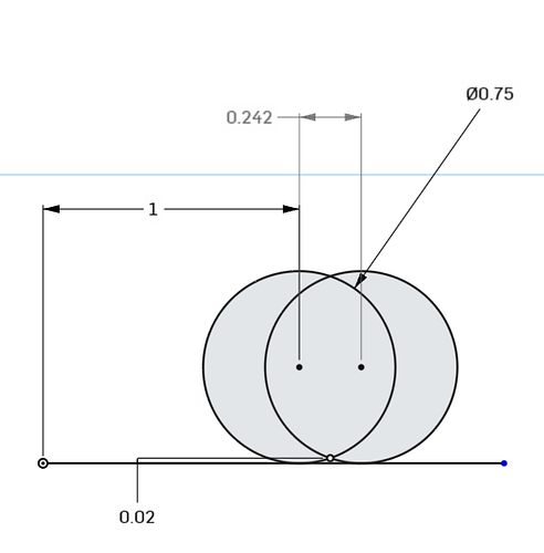

On the subject of Step over versus cusp height, it turns out to be which dimension is driving versus driven.
I am showing the cusp being the driving dimension.
I had to prove it to myself.
You can calculate either one from the other, the driving dimension is the one you enter in the CAM software. In NX, I can enter either one & it will calculate the other.
I was making the sketch thinking about your sketches.
Yep, in Fusion I found you could enter a value in one and it would set the other.
What I had more trouble working out was whether the cusp height was calculated on the angle of the surface being machined, and if so, was a single stepover or stepdown set for the whole toolpath to minimise the worst cusp or does the calculation assume something else?

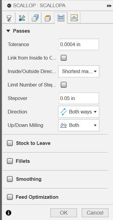

I don’t have Fusion, but if the top view of the toolpath is straight parallel lace/zig-zag/raster lines, then the scallop is calculated on a flat plane. If it’s following the contour, the lines will morph closer together on the steeper surfaces. If you have steeper contours, either set the direction so it’s going up & down the hill rather than across it, or reduce the stepover to accommodate it.
The Fusion Scallop path has these options for direction.
This produces a cusp of 0.002 inches. Good enough for this hack.
