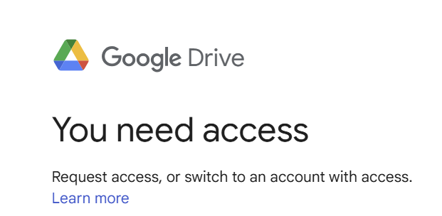

Please set the file to be accessible,
Please try it now? I changed accessibility to anyone having the link

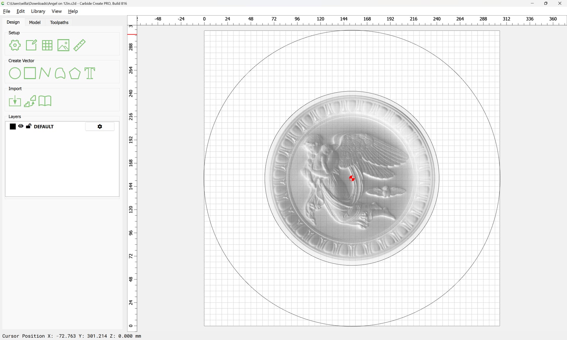

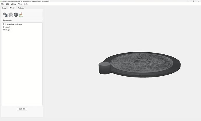

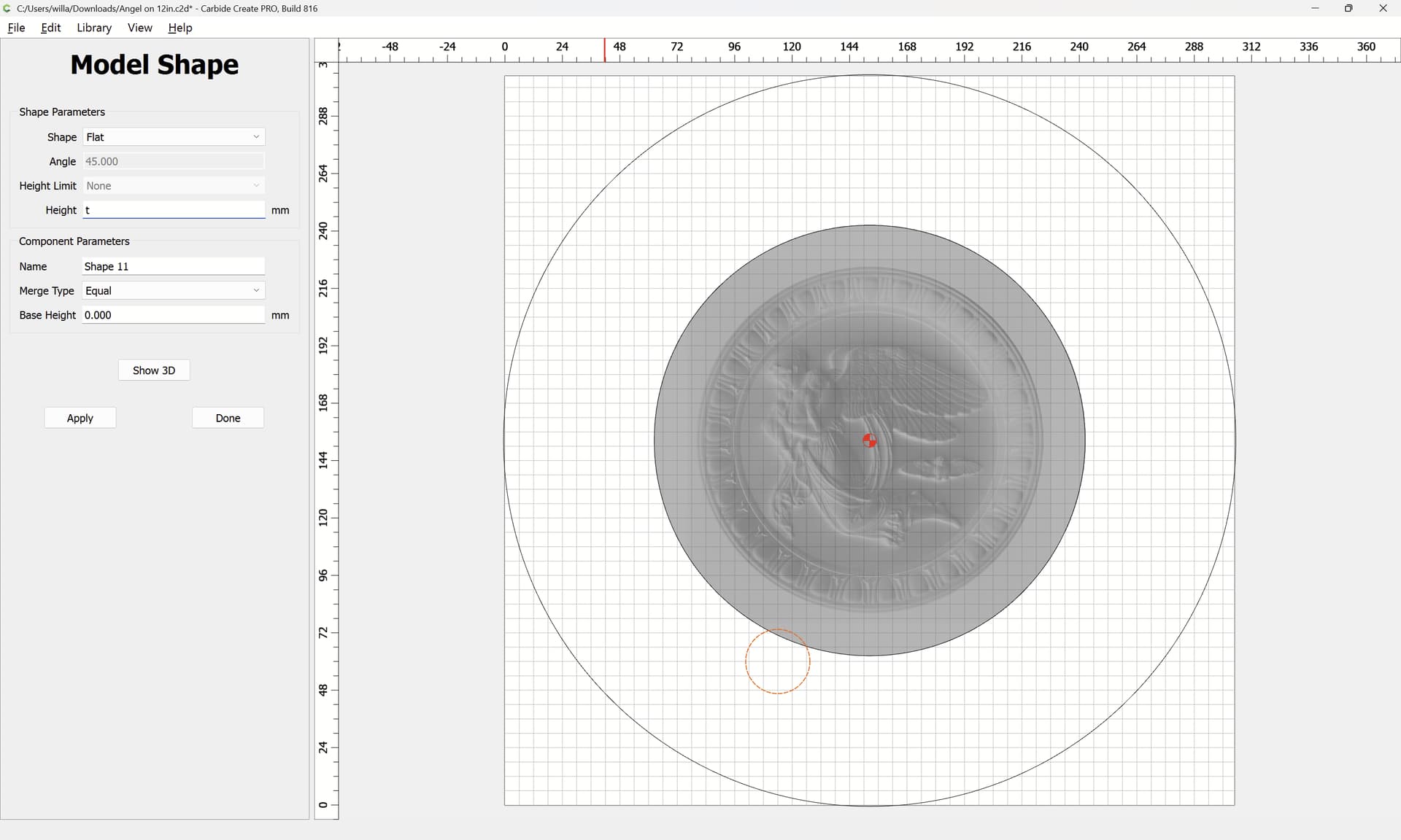

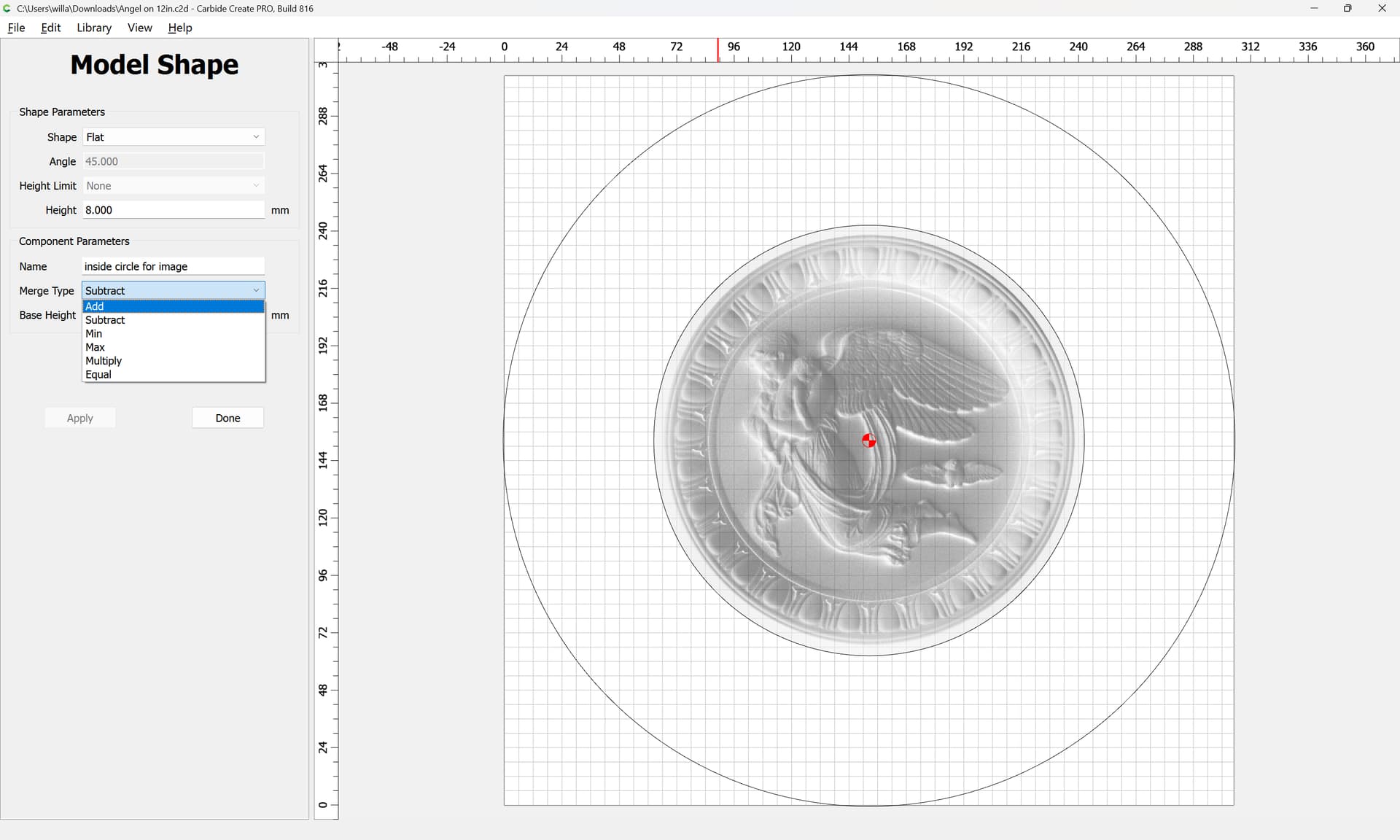

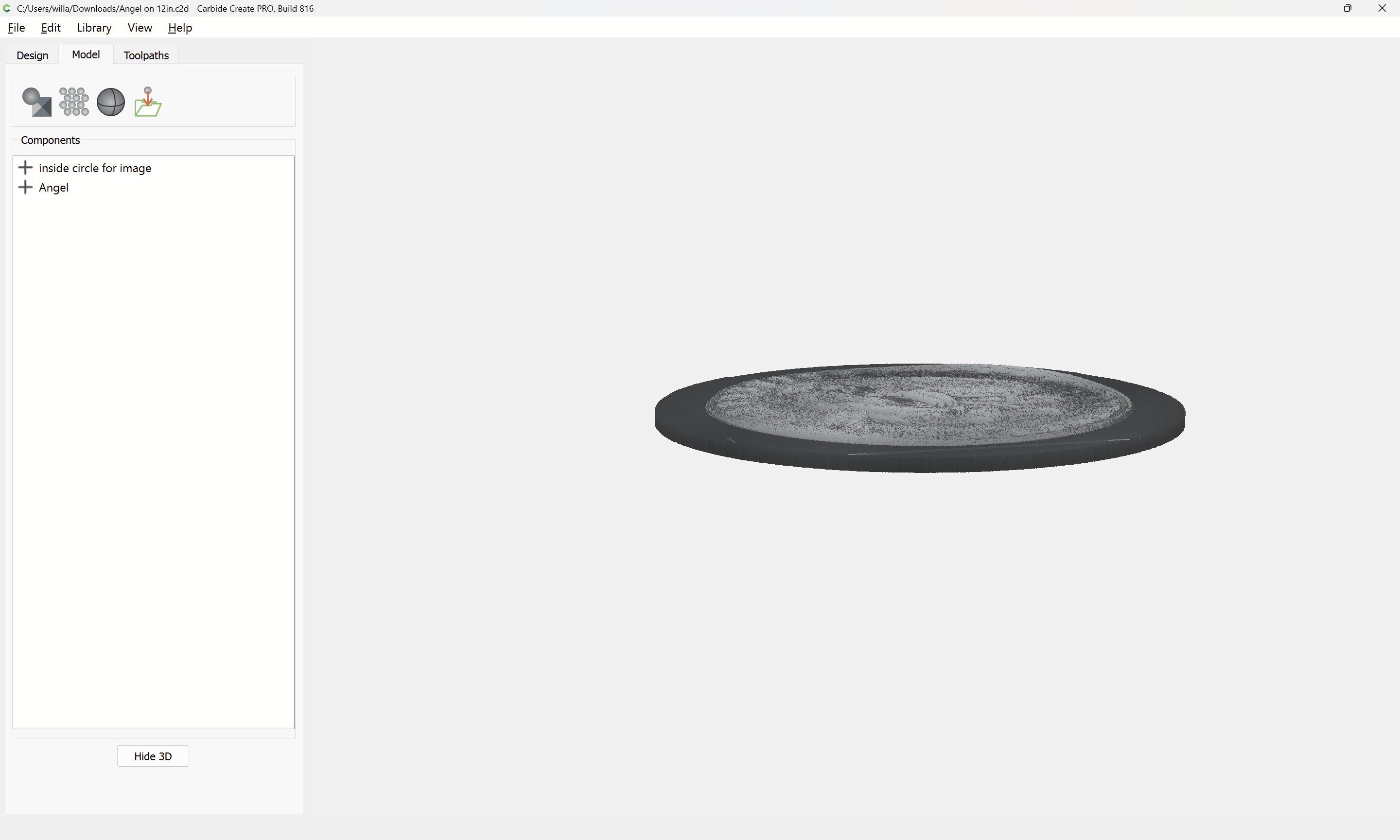

That worked, but all I got is the .c2d file:

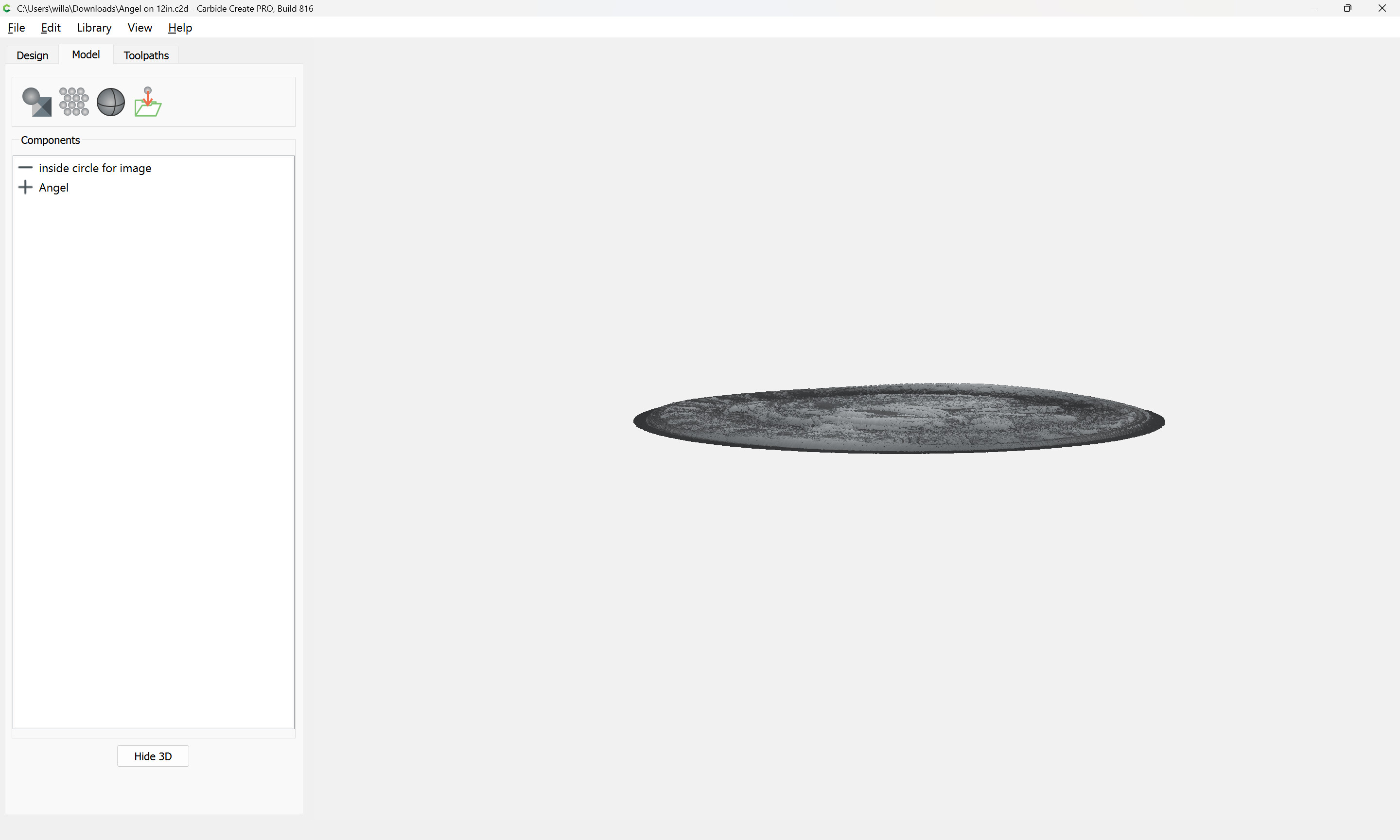

which is modeled to be quite thin:
but which is being cut out of the bottom of a relatively thick piece of stock:

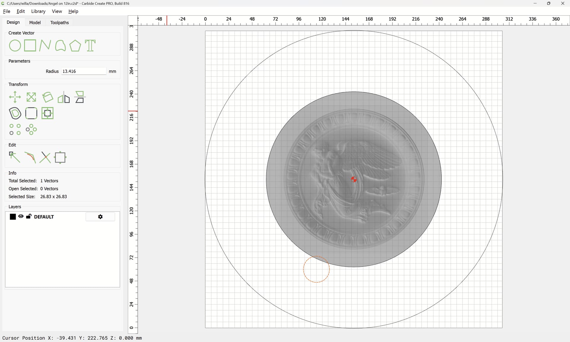

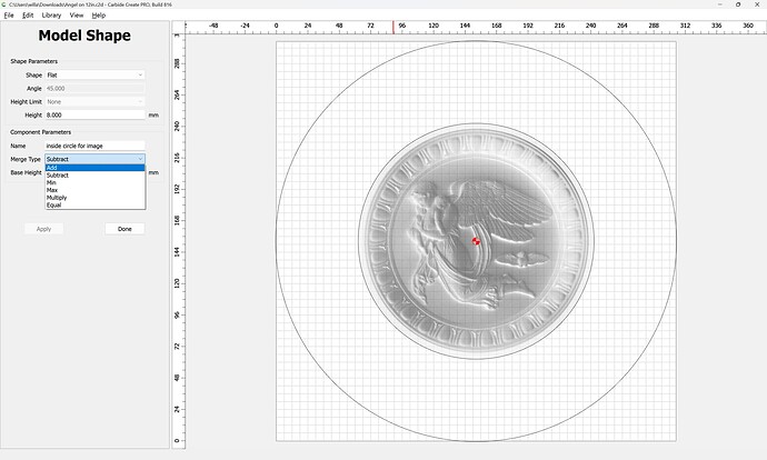

If you change the inside circle from Subtract:

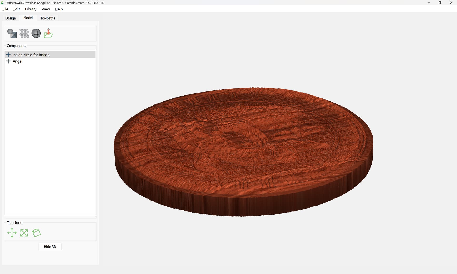

then you get:
which seems to be what is wanted:

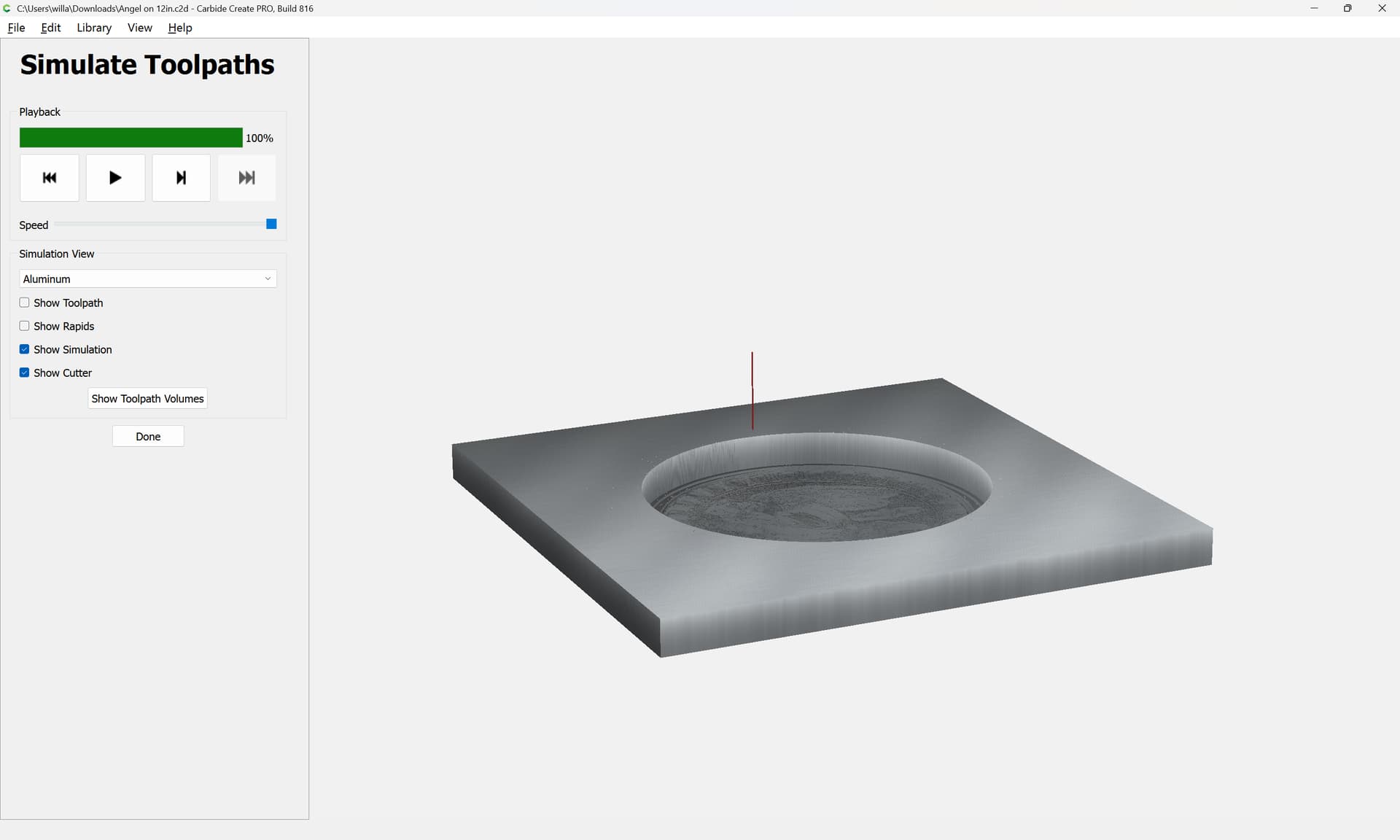

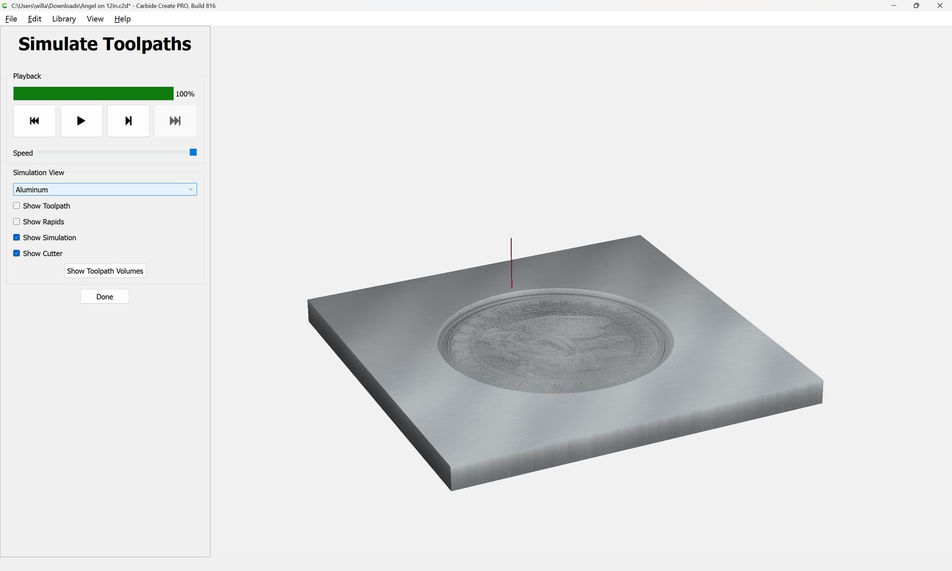

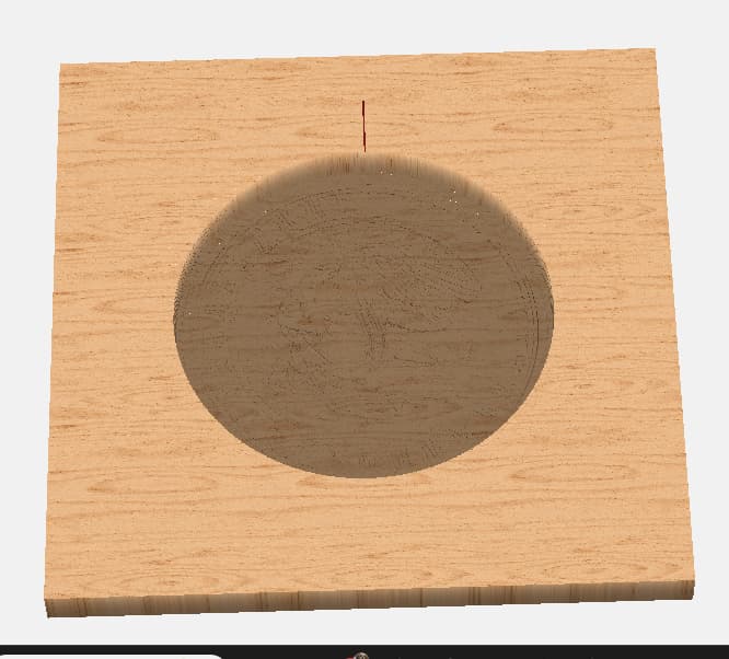

This is what I get in simulation. I must have something wrong in setup as it seems to sink way down in the wood
Did you try changing the modeling of the inner circle to add rather than subtract as suggested above?
Yes, and that makes a big difference in the 3d view in modeling, but not in toolpaths. here is a link with the file including toolpaths
I don’t see that that version is significantly thicker:

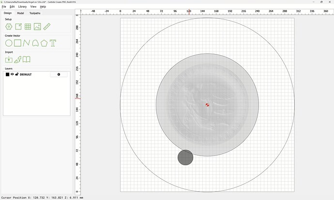

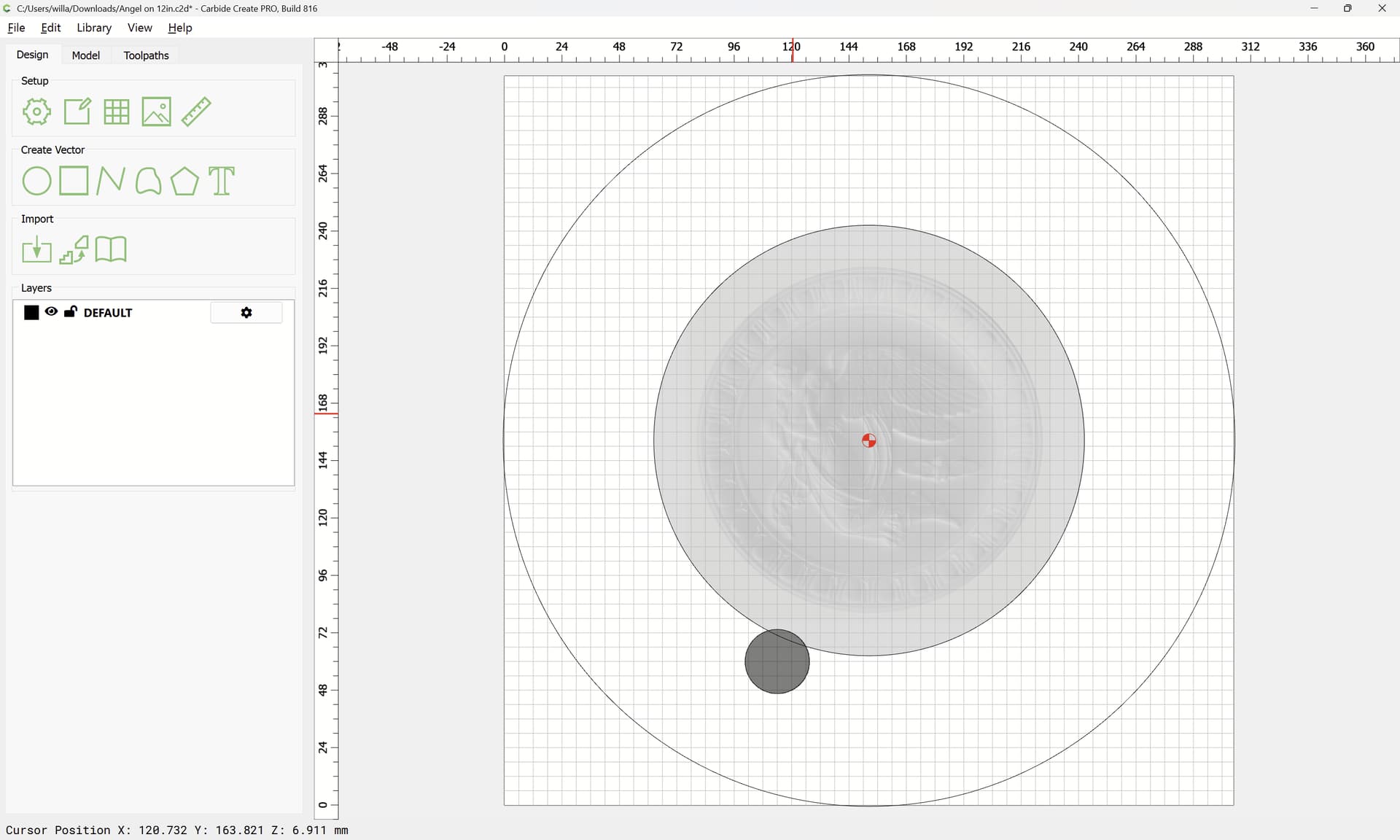

If we draw in a piece of geometry:
then model it to the thickness of the stock:
it is significantly thicker than the 3D model:
You need to make the model closer to the thickness of the stock to achieve what you want.
