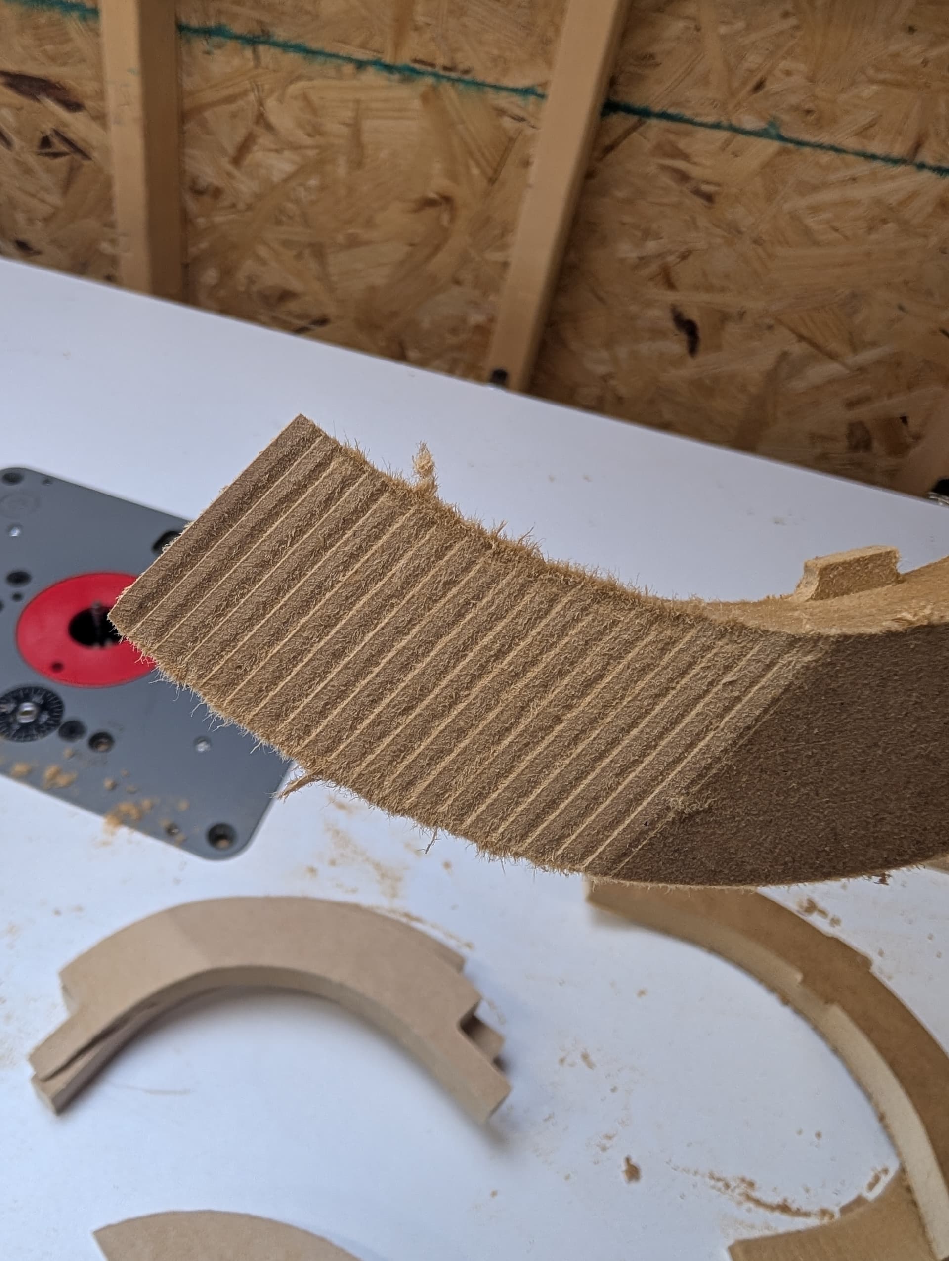

I am trying to cut some beveled curves, so I giving the Carbide Create Pro 14 day free trial a try.

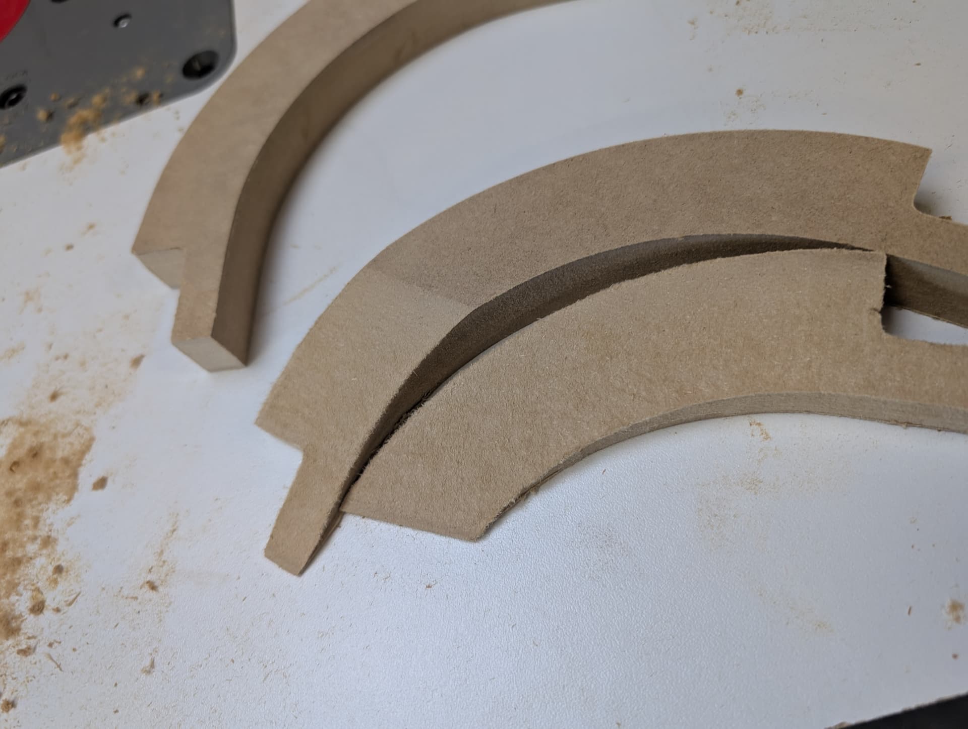

The fist attempt came out OK. The machine moved along the curve cutting deeper as it appeared to simultaneously move in all three axis at once. The only issue is that the machine did not cut all of the way to the bottom of the 3/4" MDF, but that may be an unrelated problem as I have had the same problem on some other projects.
I made another cut and on the second attempt the machine moved in a stair step pattern and left, well, stair steps.

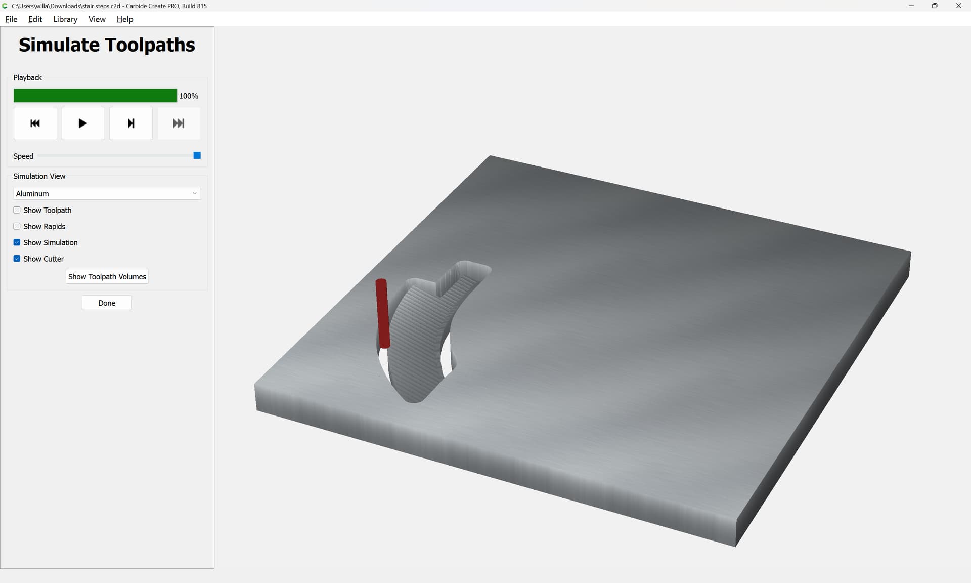

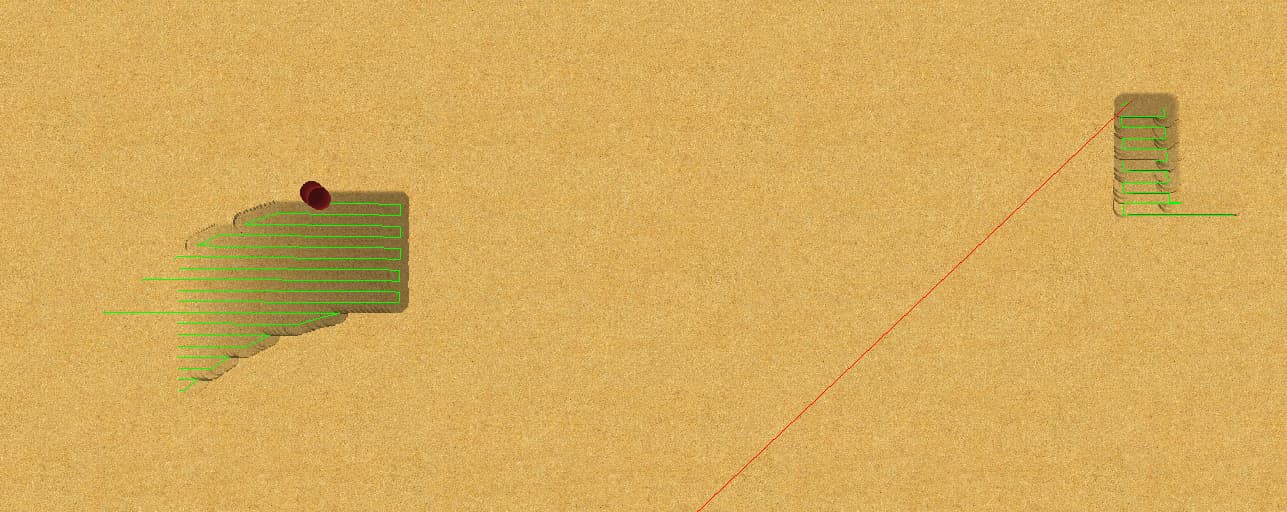

Playing around with the simulator it looks like the machine wants to cut left to right (the x axis) and I should be able to avoid the stair steps if I orient the piece so the bevel is left to right. But, these are curves so the bevel orientation could possibly be any direction.

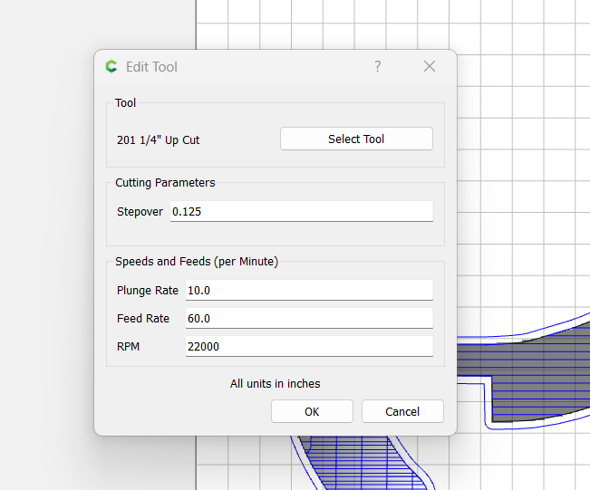

Both cuts were made with the #201 up cut bit with a 0.125 step over.
Why does the machine seem to want to cut left to right?
Is there a way to force the machine to to cut along the curve, all three axis moving at once?
I have a quarter inch ball nose I am assuming I will get a better stair-steps if I use that bit?
What about the step over, I try to avoid small step-overs to save time. Dropping it down to .0625 or even lower will still make stair-steps, they will just be smaller, so I don’t see the advantage to cutting slower to get a bad result.

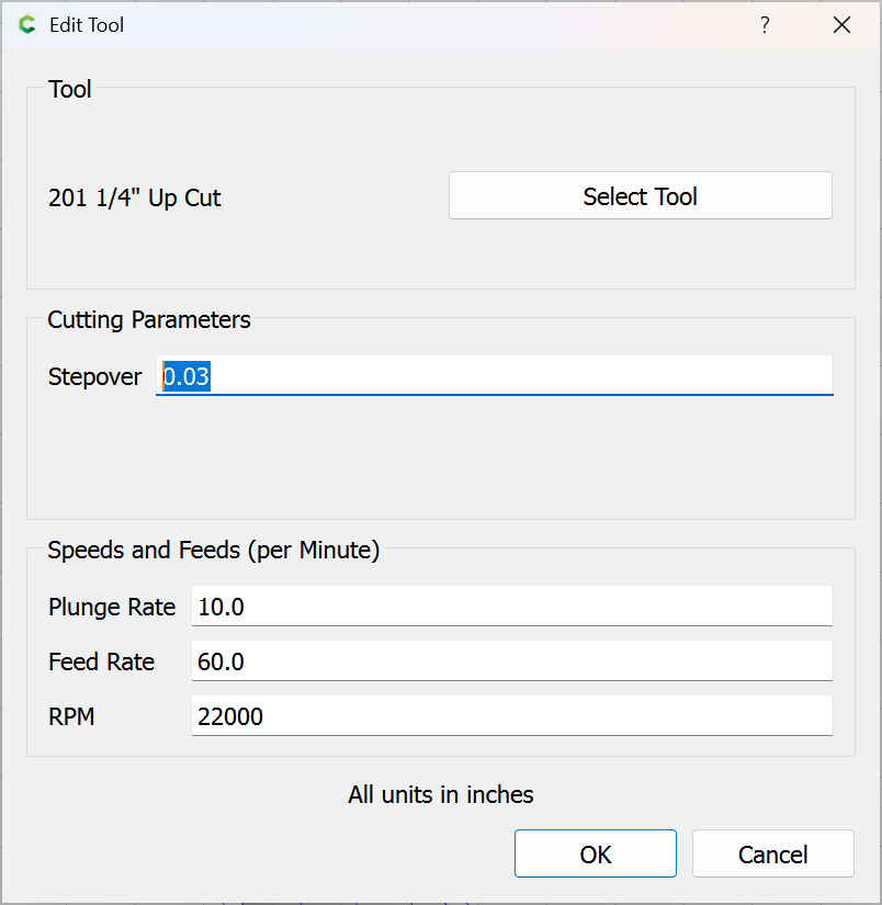

What settings did you use for the 3D Finishing?

The 3D finish settings were:
Nothing in there to control the direction of the cut.

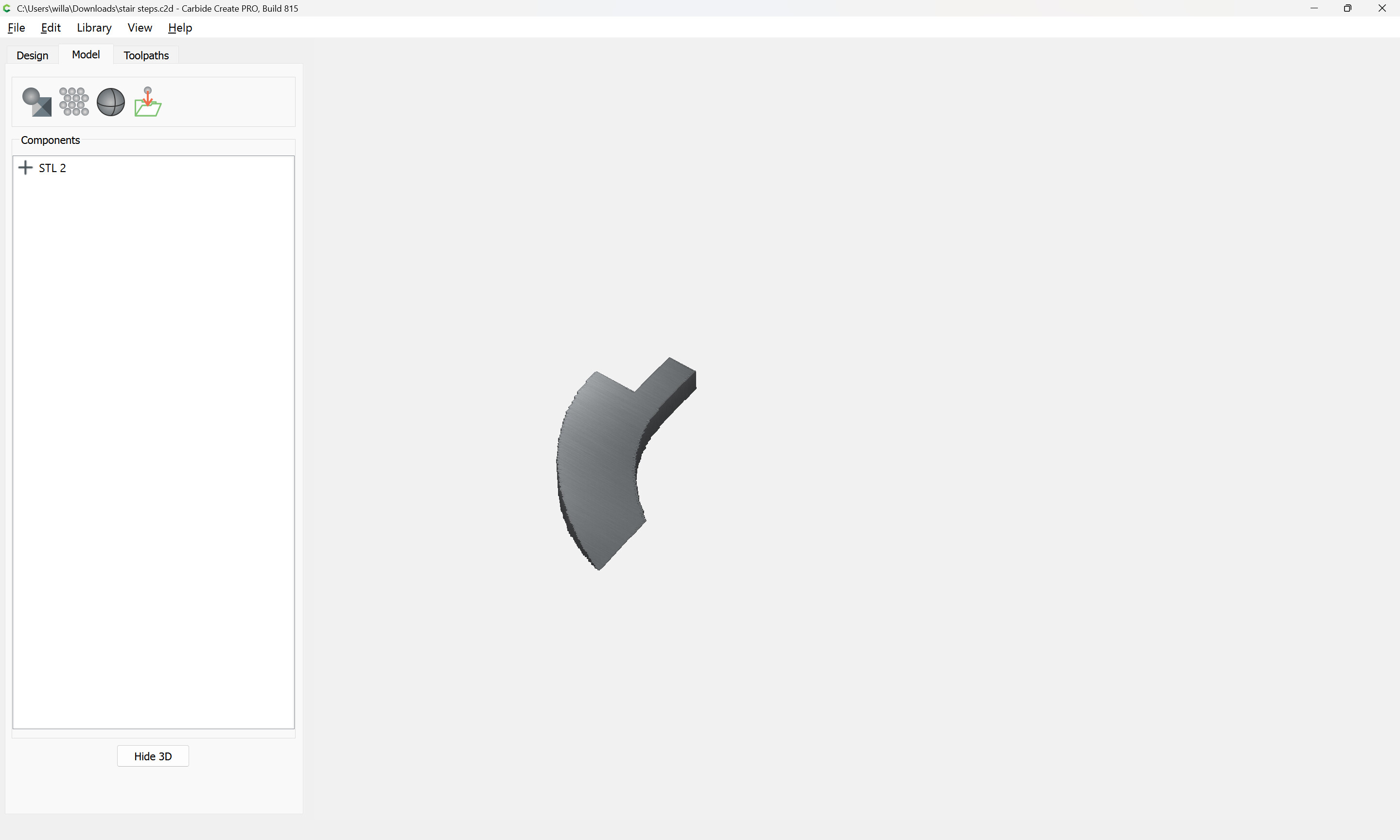

I do not understand what you mean. I right clicked the model in the model components list and Selected “Create Outline Vectors” and used that to make the toolpaths. Is there a different way to do it?

I had no problem at all with the shape of the cut, that was fine, the issue is the stair steps, I need a smooth surface. If I have to sand it smooth then why do I need this expensive CNC?

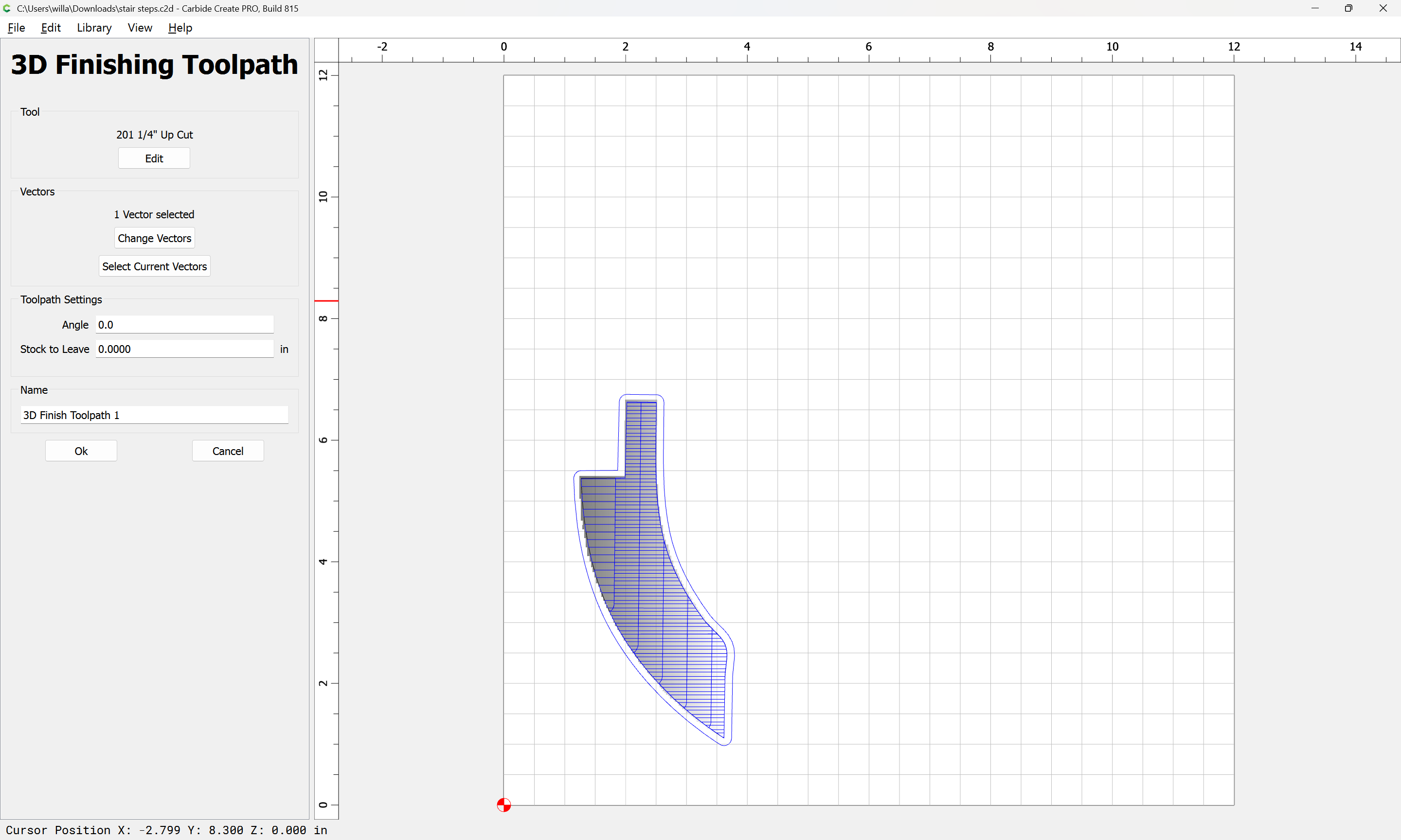

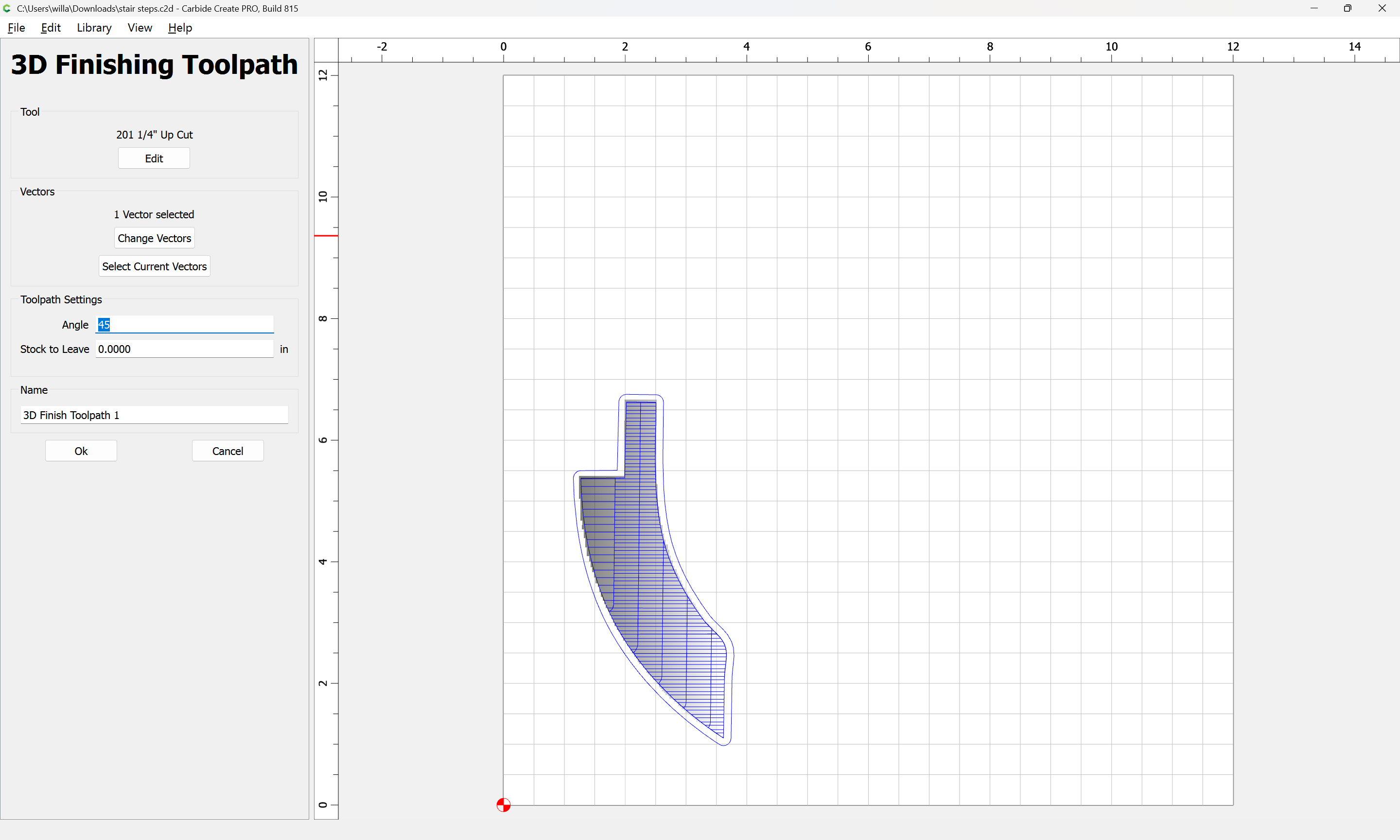

You have the model:
and it is cutting as:

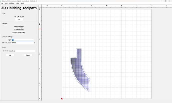

because the 3D Finishing toolpath is oriented left–right (0.0 degrees)
If one changes that to 45:
and reduces the stepover:
one instead gets:
Fiddling with those parameters should allow one to arrive at a suitable result.

If you’re cutting this with a flat endmill, I think 0.0° is the angle you want. As straight up/down hill as possible. Reduce the stepover to get smaller scallops.

While you were doing that I was tinkering with the model, and it seems that rotating the model itself seems to get the same result. PLUS this time the simulation seems to show that the machine will make a pass in both the X and the Y direction.
I had originally placed the pieces on the work surface to minimize waste, now I have them rotated to get a smooth cut.
Perhaps by adjusting the angle of the model I can do both at once.
The odd thing is that I used the exact same settings for two different cuts but one gave me stair steps and the other did not. My goal is to make something that I can reliably batch out and potentially sell (yes, I do think people will buy these little curved wedges). So I need to figure out why one method works and the other does not.
I have a ball nose quarter inch end mill, I can swap it out if that will give better results. But changing the bit takes time and I need to figure out a way to design projects that can be cut without changing bits.
