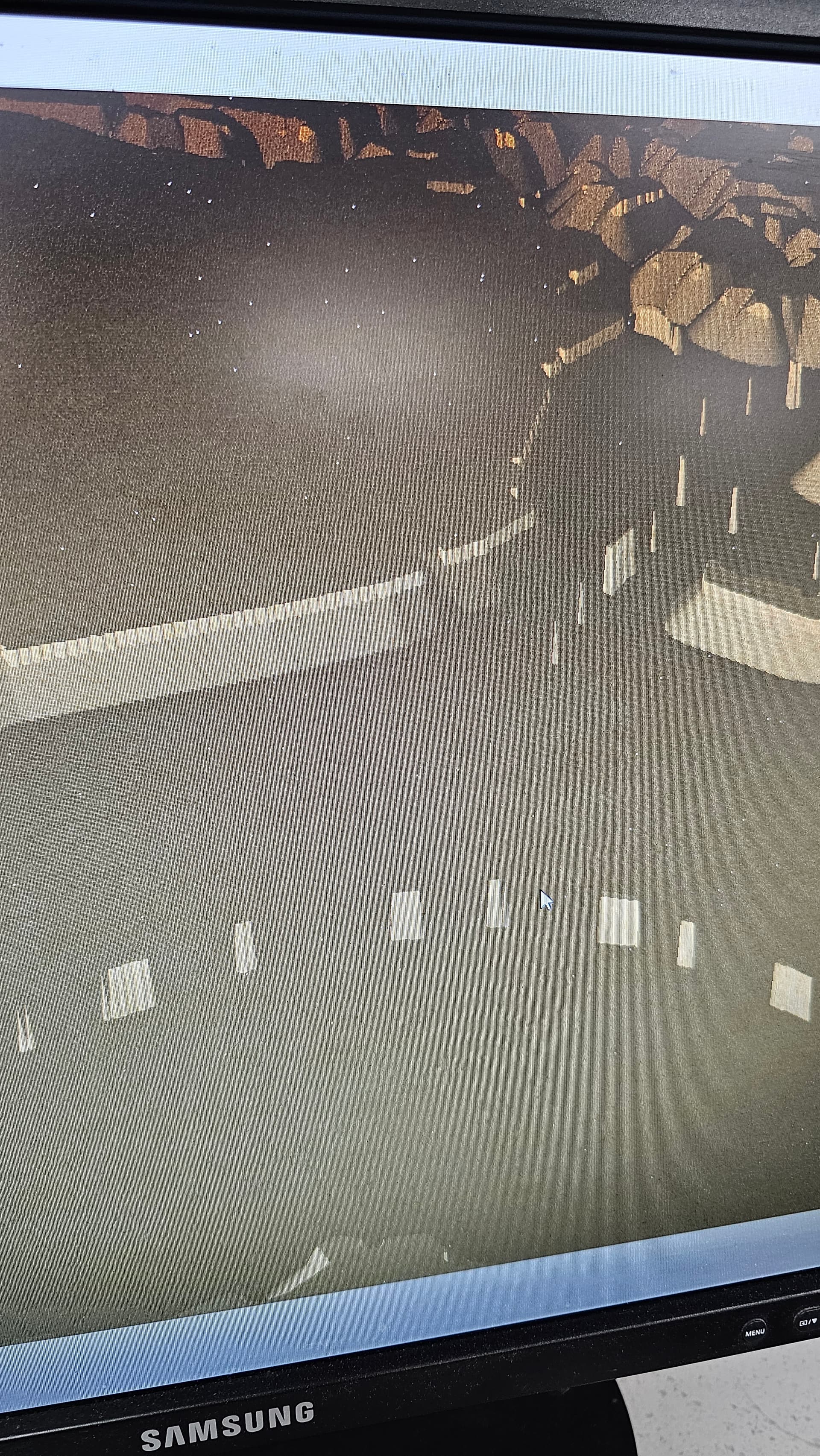

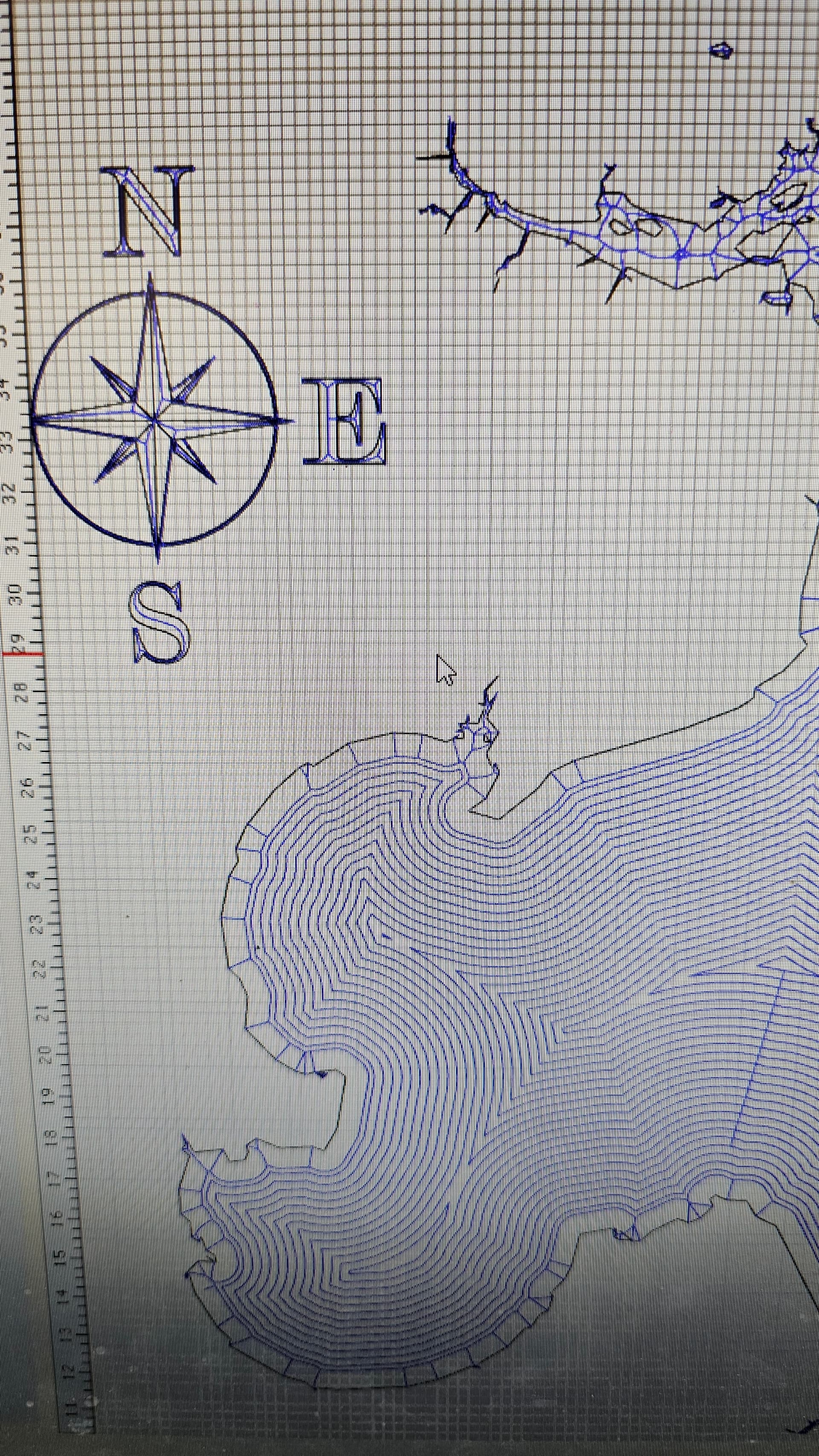

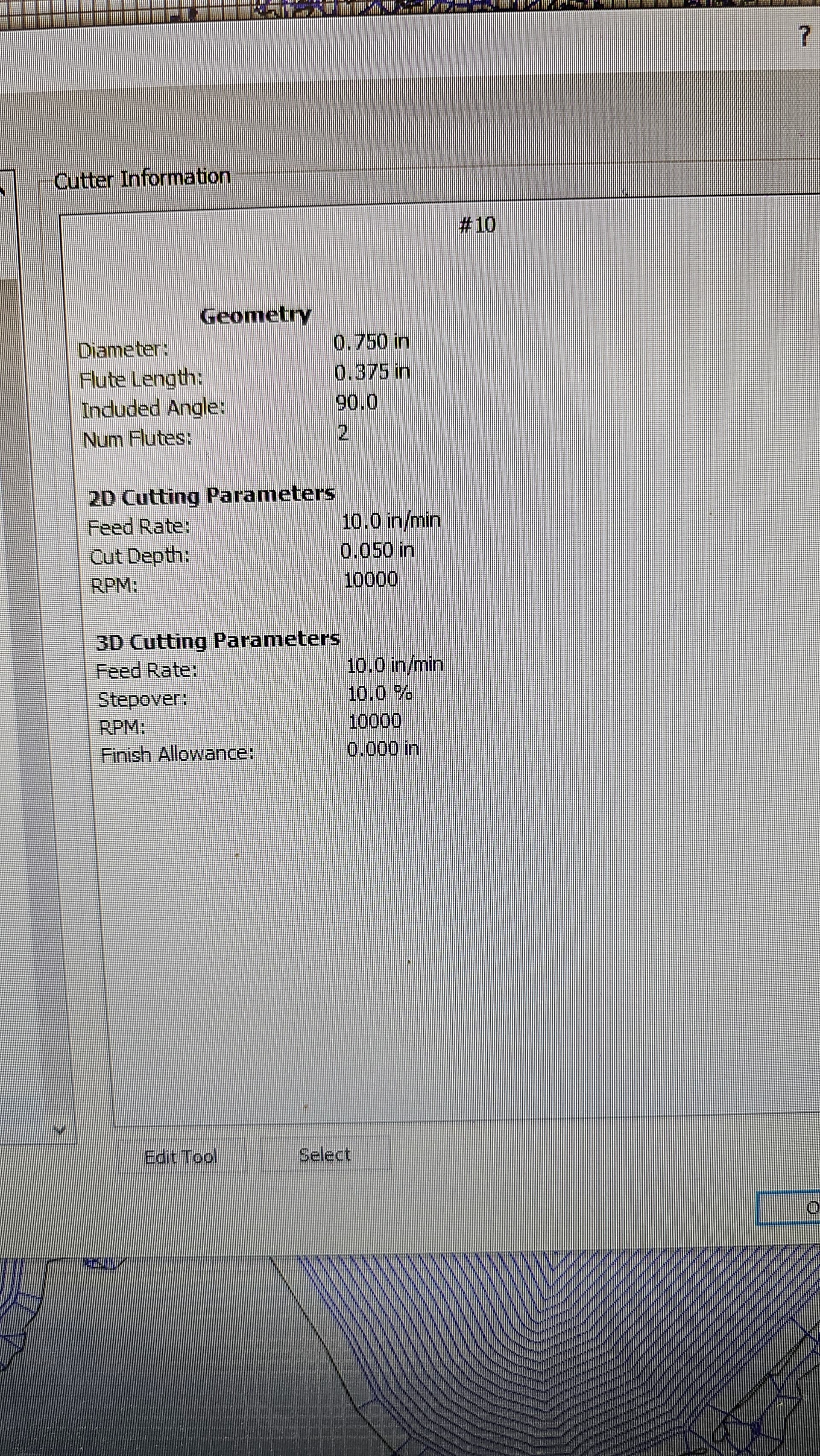

New to this program but got a good grasp on it already. 3D engraving a map onto a table top that goes 3/4" deep. I have the programming set for using an endmill bit to surface everything up to 3/4" deep, and the V Bit to do the fine details. Why am I getting left with this flat wall section on the 3/4" deep sections? My V Cutter is 3/4" wide, x 3/8" cutter shaft length. My interpretation is it would do the bevel in a few passes to get the consistent bevel for the entire thickness.
What is the cutting flute length for the tool in question?

Cutting flute length is 3/8", total depth is 1/2"
I would think the program would just do the 45 chamfer in stepped over passes to get the depth. Maybe I’m wrong
Unfortunately, you are wrong. CC does NOT account for V cutters shorter than the required depth, it always assumes that the V Cutter is sufficiently tall.
As a workaround, you could create a second Advanced VCarve path, NO clearing bit, but only as deep as the difference between the overall depth and the depth of your bit.
Thanks, that’s kind of what I figured after checking all my settings and parameters
No, Carbide Create does not take cutting flute length into account when creating toolpaths:
it just shows the result of the toolpath as assigned w/ that diameter tool.
