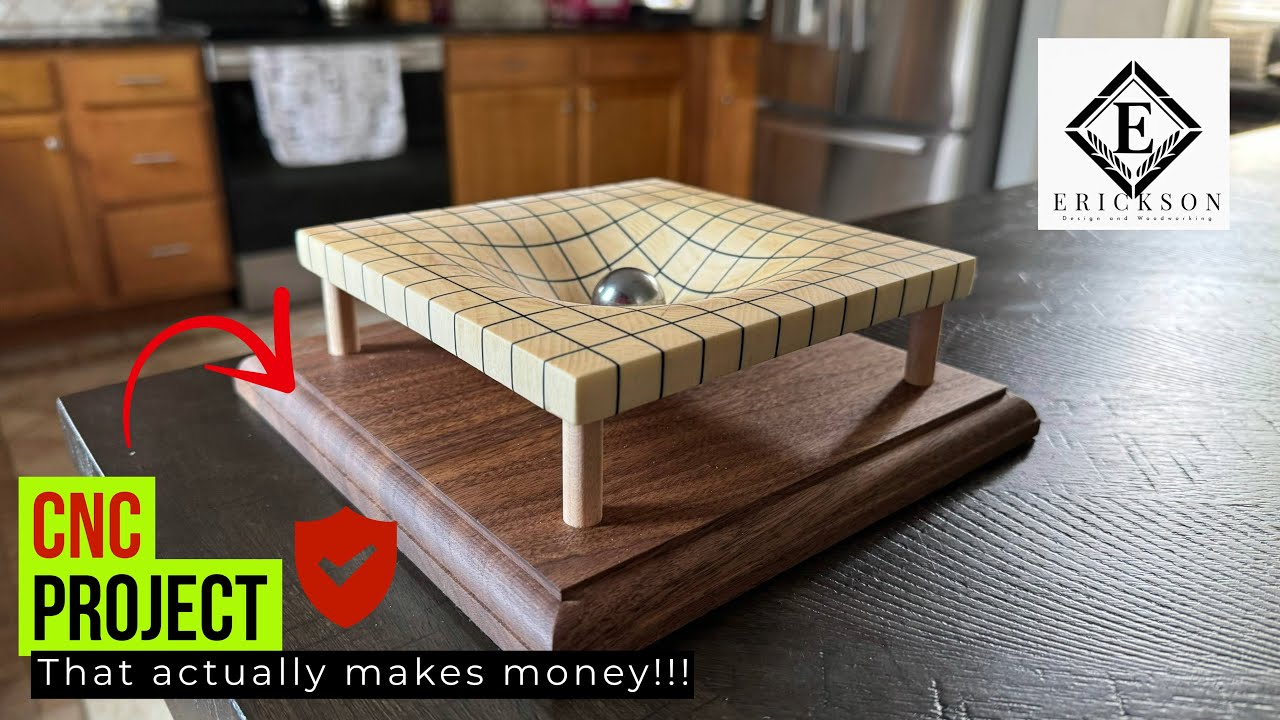

I do know the .STL files are at the final dimension of the model profile that was machined. The stl can be scaled.
If you imported the stl into CC Pro, you would need to manipulate it and position it correctly for the double sided machining and do your normal workflow inside CC Pro.
The file contains 2 STLs, one model with the top profile and a second STL for the bottom that’s flipped.
I can confirm that your file works perfectly in Carbide Create Pro. I imported it, scaled it down a smidge and tested it on some glued-up 2x4 scraps (my blank was 1/4" smaller than yours in all dimensions).

@Merick01, Found this illustration of warped spacetime. Looks exactly like your model. It would be cool to build one from blackish wood (to represent space) with light-colored lines. Not sure I want to plunk down $ for Wenge…
Right! Wedge is expensive, but I think Walnut could be a good substitute for a darker type of wood with white lines. Should be a good contrast. There’s a lot of possibilities here!
So much, that I’m going to make a puzzle out of it. There is some serious prep to pull it off though, to include surface jigs to hold the pieces together for the top/bottom carving.
I spent the morning doing the CAD/CAM work, this is getting built this week. Fingers Crossed on this one.
I’ll have 5 points of contact and it will be suspended on top of a walnut base, with the bottom curve cut into the base. I’m going to play with the tolerances more to get a little tighter fit to strengthen those joints for support.

Here’s my take on this project using end-grain walnut and maple veneer, the STL files from @Merick01 and Carbide Create Pro. I made my blank a little bigger - 9" x 9" x 2". The final diameter of the “warped spacetime” is 8.75". The base is made from baltic birch plywood, based on a logarithmic spiral and intended to represent a spiral galaxy. Finished with a few coats of shellac, followed by paste wax.
Using the .STL files in Carbide Create Pro was very easy. There are two files - “Top” and “Bottom”. The STL files will automagically scale to fit whatever stock dimensions you use (in my case 9"x9"x2"):
Click “Done” and head over to Toolpaths to set appropriate 3D Rough and 3D Finish Toolpaths.
When you’re done cutting the top, flip it over, and repeat the steps above to import and cut the “Bottom” STL file.
For those of you in the United States, you can get a 1" steel ball bearing from a local Harbor Freight for $1.99. They look like this - just gently tap the ball out of the housing and the whole thing will come apart:
Nailed it! Great choice of contrasting woods and great job getting the veneer lined up between glue ups! That base is super good with those metal pins!
