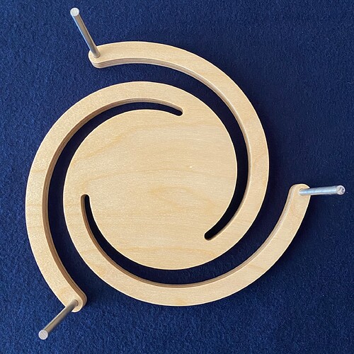

Here’s my take on this project using end-grain walnut and maple veneer, the STL files from @Merick01 and Carbide Create Pro. I made my blank a little bigger - 9" x 9" x 2". The final diameter of the “warped spacetime” is 8.75". The base is made from baltic birch plywood, based on a logarithmic spiral and intended to represent a spiral galaxy. Finished with a few coats of shellac, followed by paste wax.

When you’re done cutting the top, flip it over, and repeat the steps above to import and cut the “Bottom” STL file.
