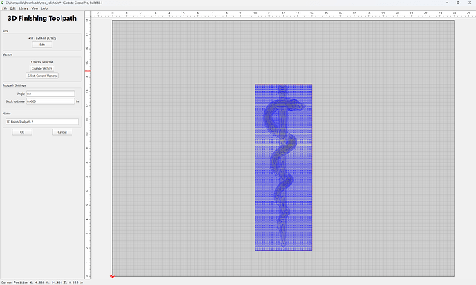

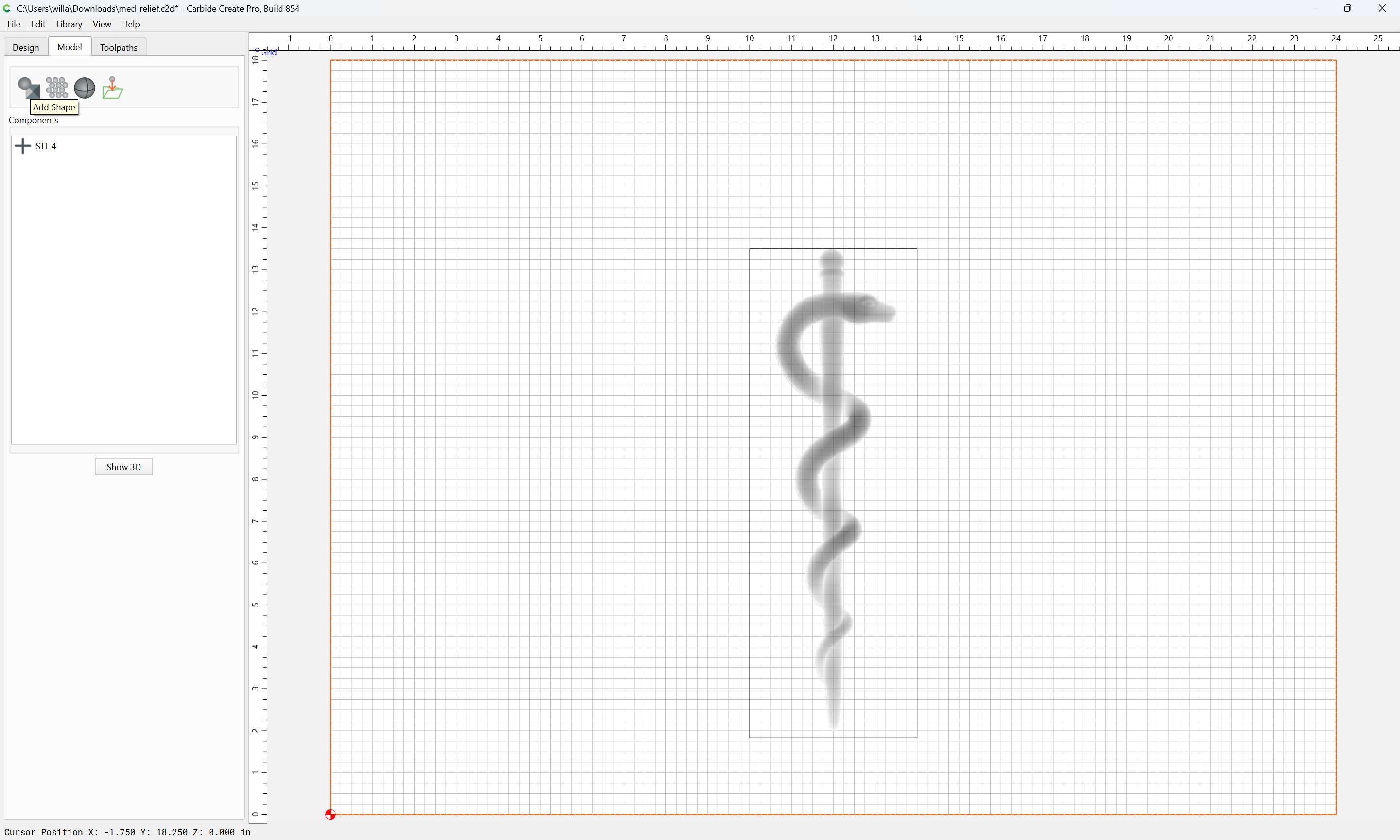

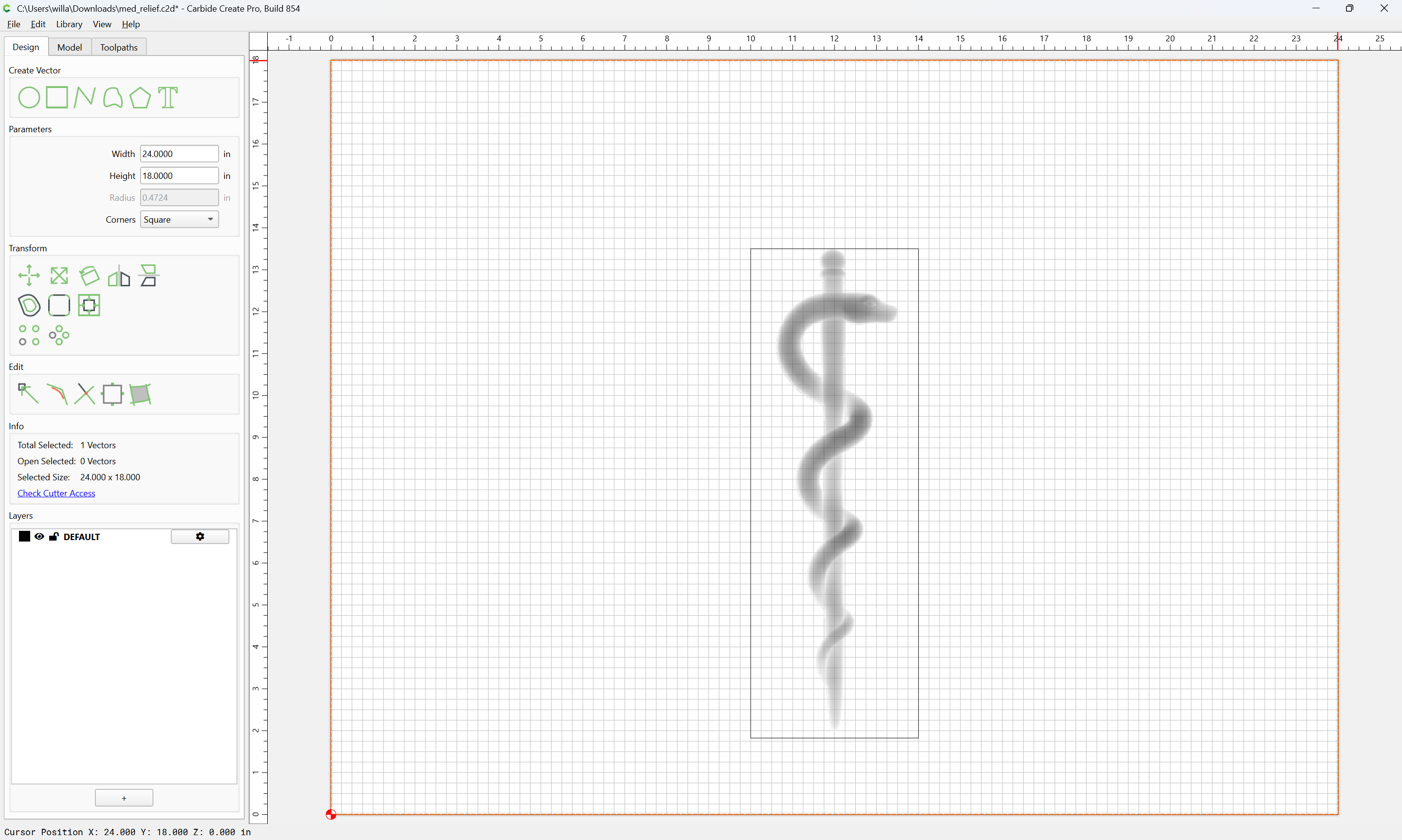

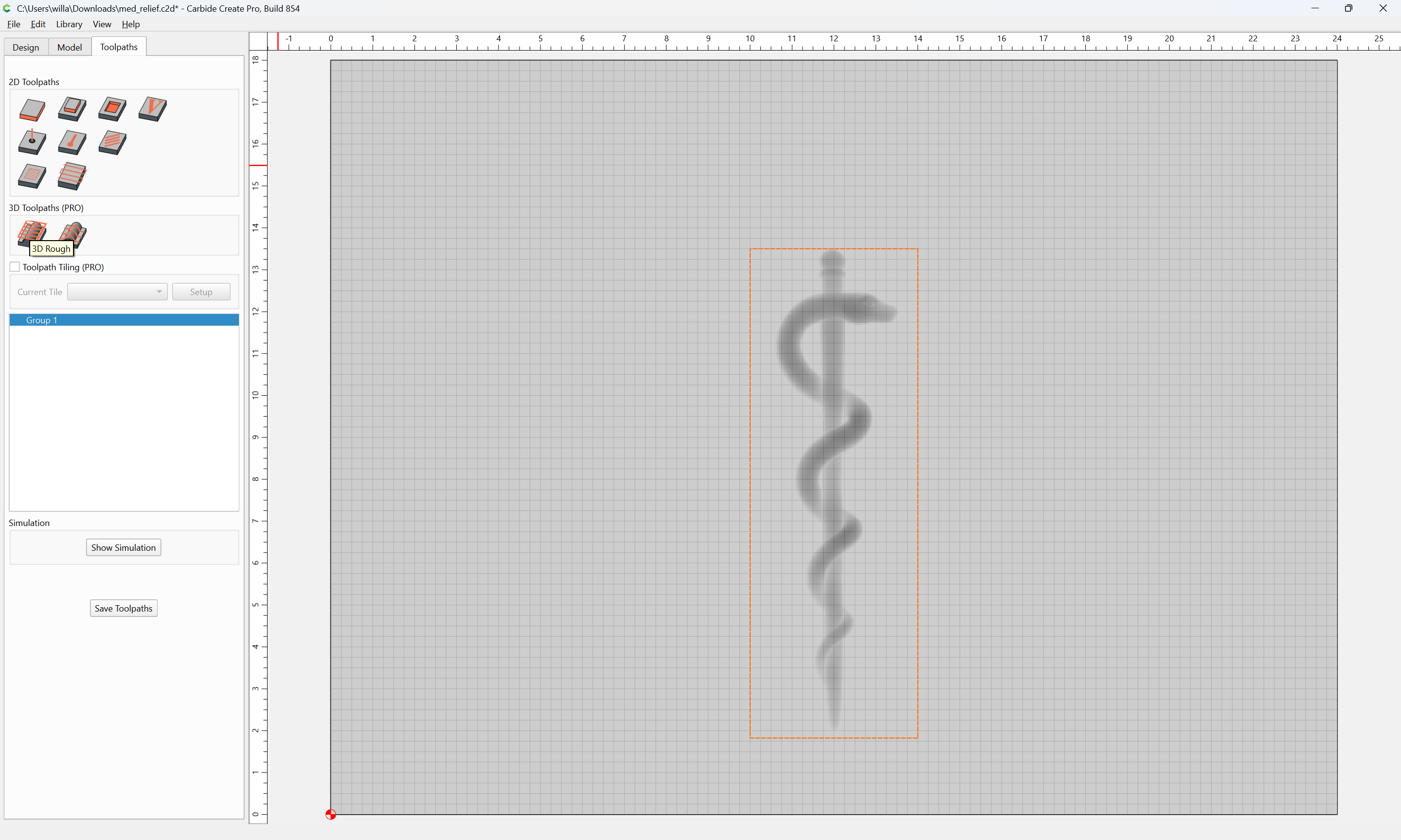

Not sure what we am doing wrong, can someone direct us to a good video?
Tried to send file but it would not allow us due to size.
What difficulty is it that you are having?

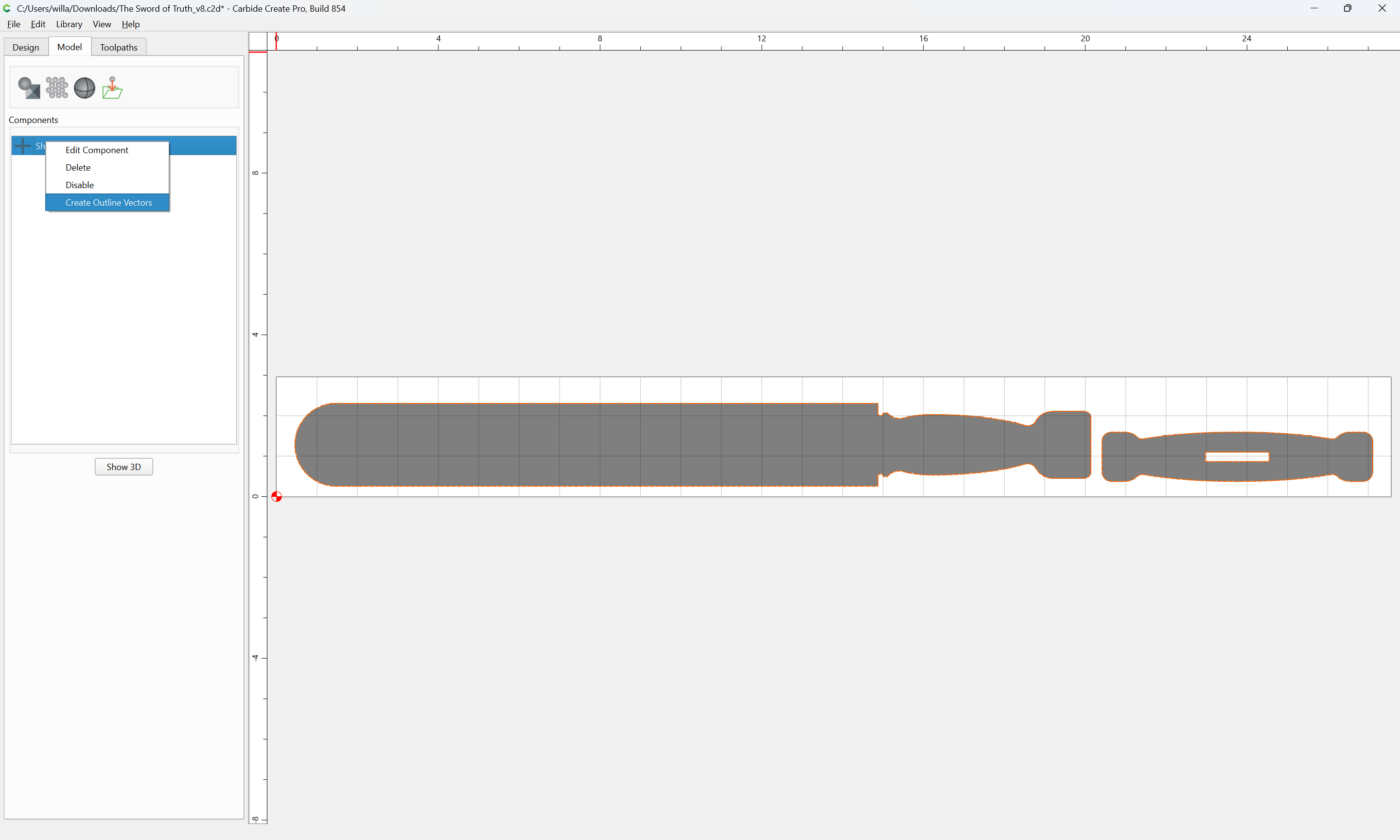

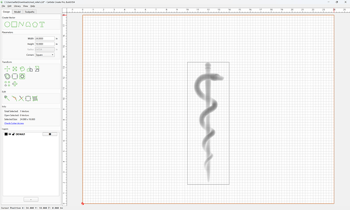

Usually folks make a 3D design, then trace the outline:
Then use the outline vector (or an offset from it).
Upload the file to a file sharing site such as Google Drive, make it public, then provide the link?

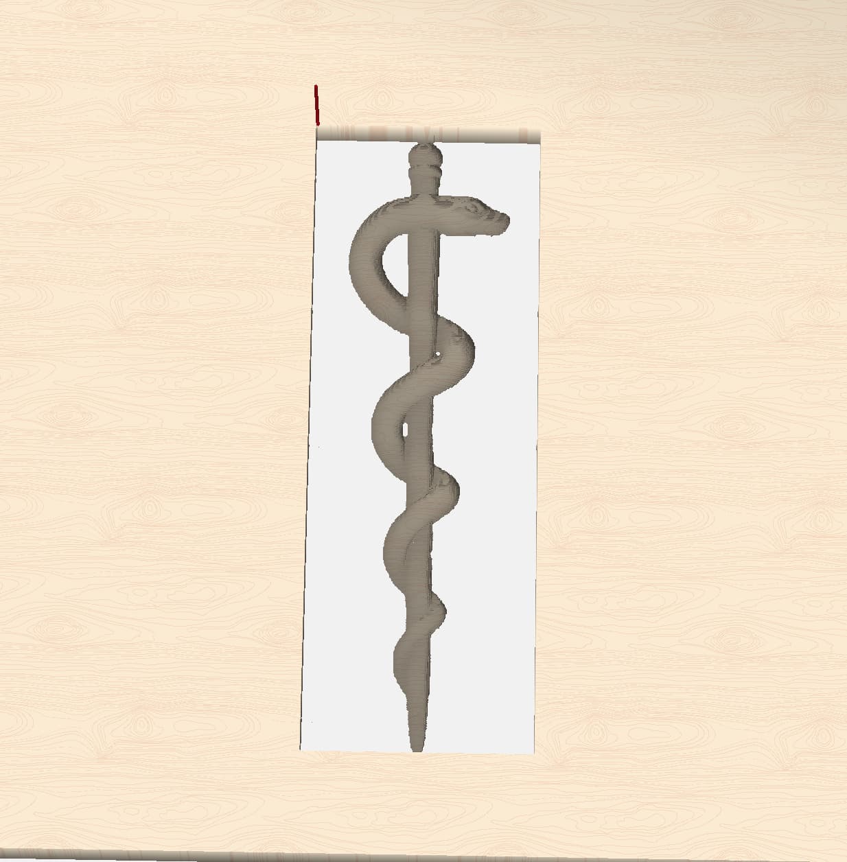

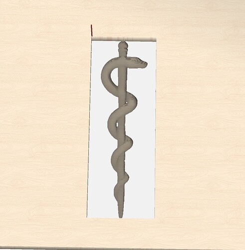

I don’t want it to cut all the way through. I want it at to be part of a 2 D design I plan on designing around it.

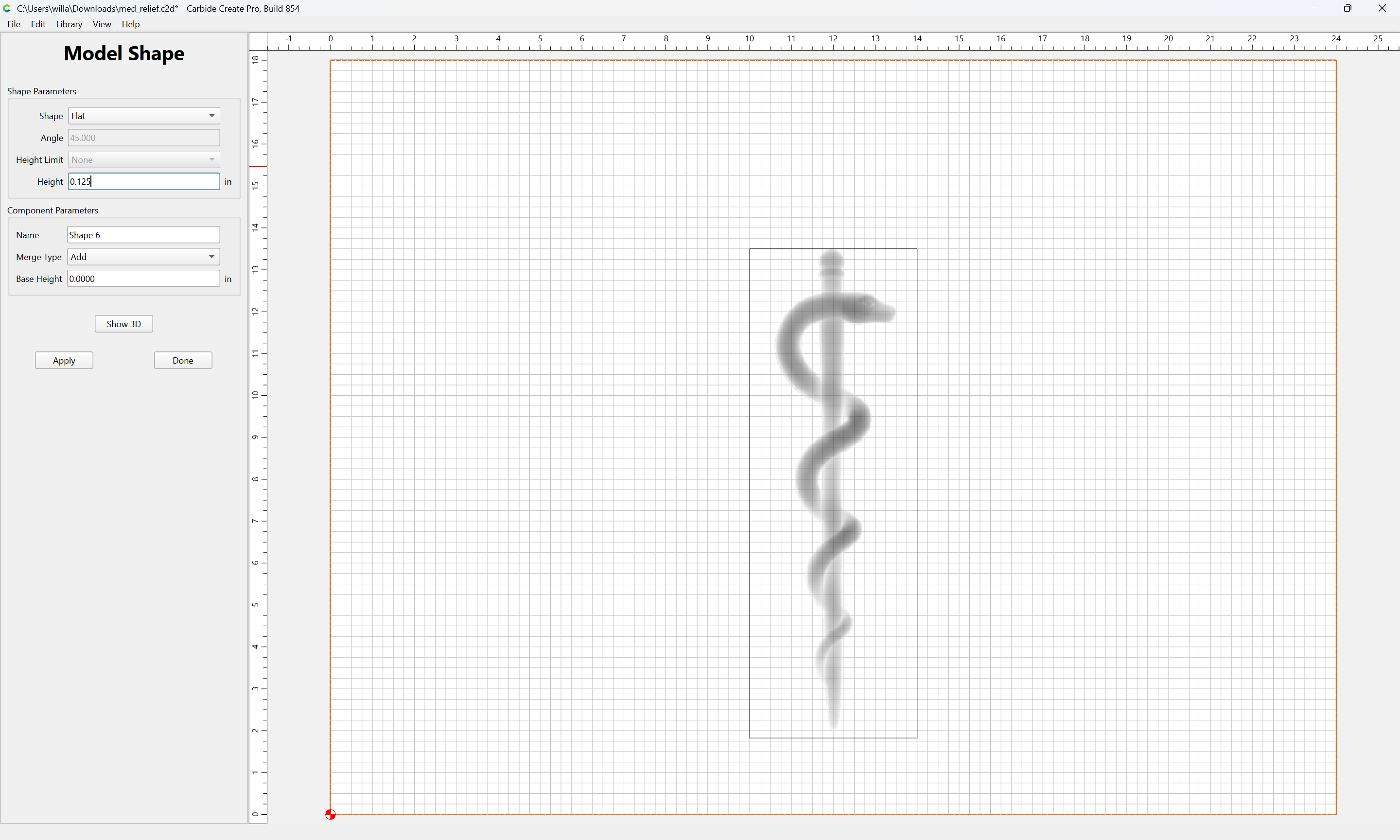

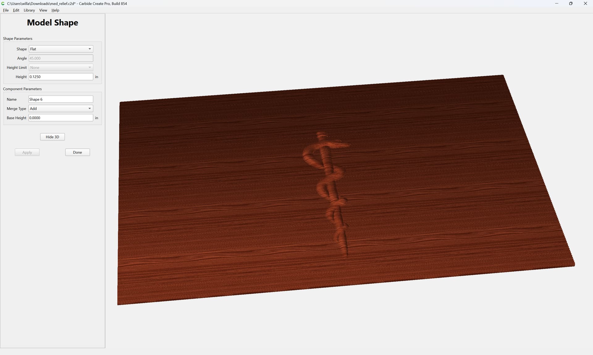

Then you should model a base to it.

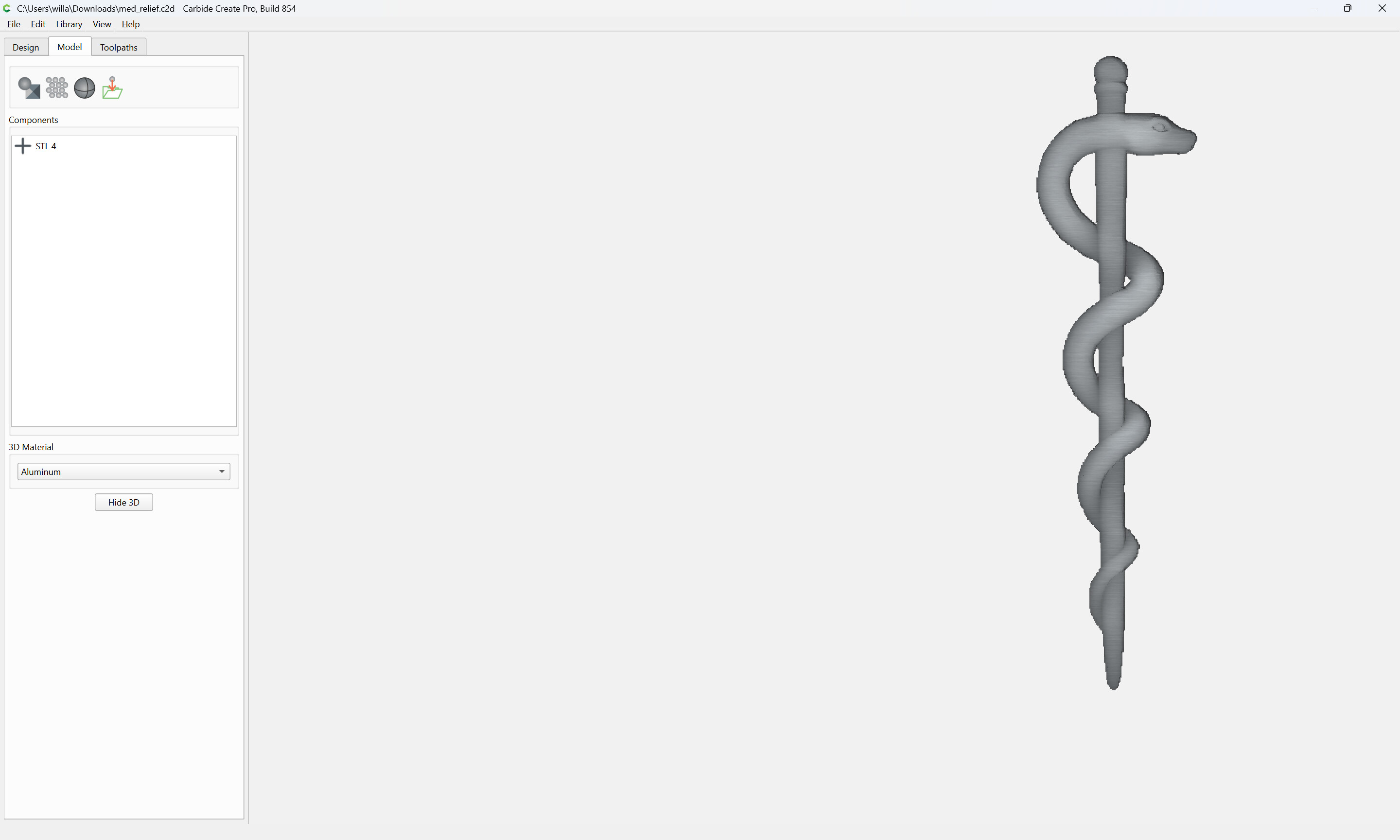

Your 3D model is nothing but an import of an STL which does not have a base:

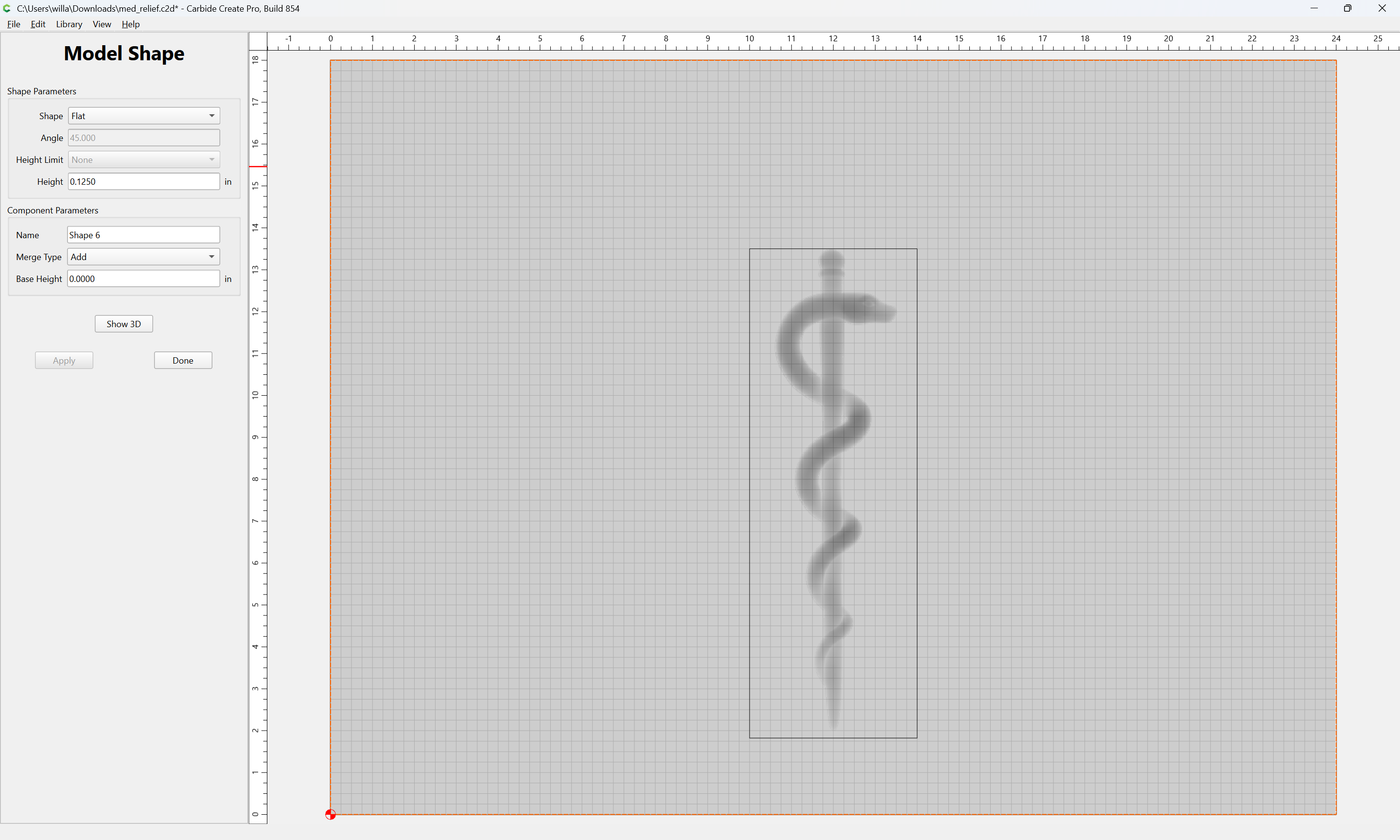

If for example you want an 0.125" thickness behind the design, draw that region:
and model it:

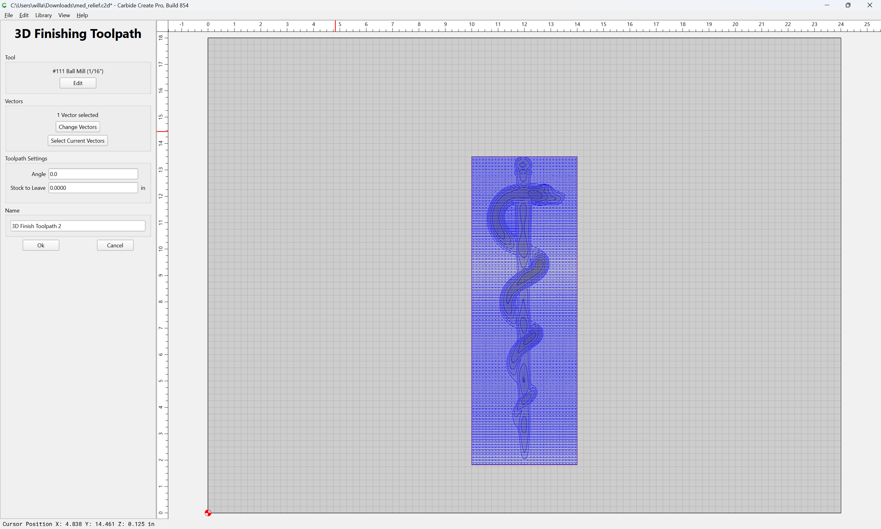

Apply

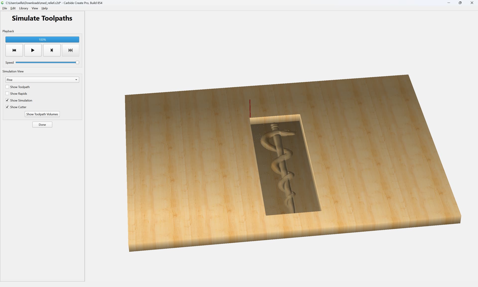

Show 3D:

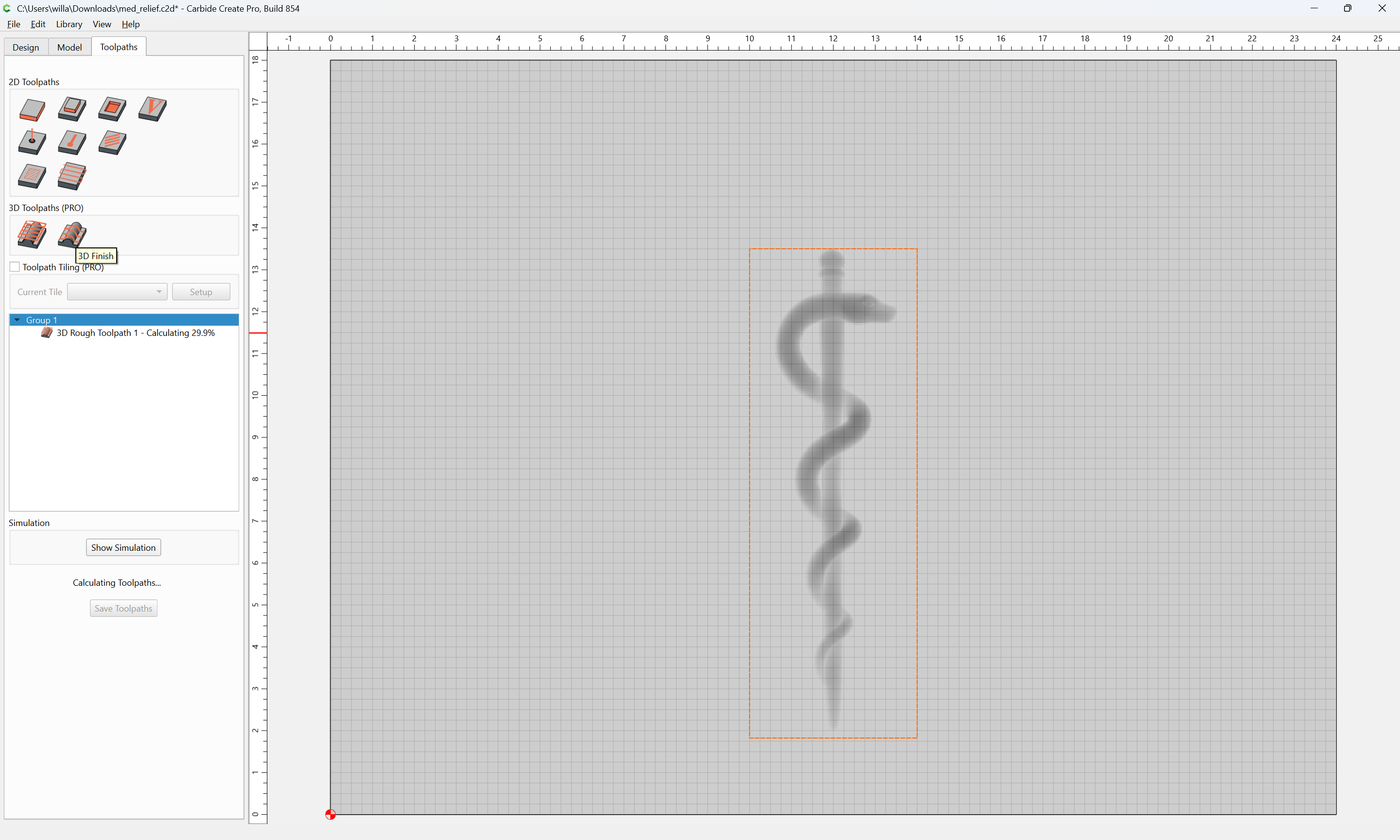

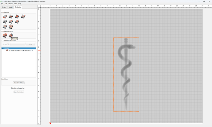

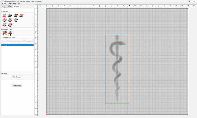

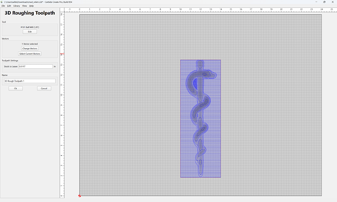

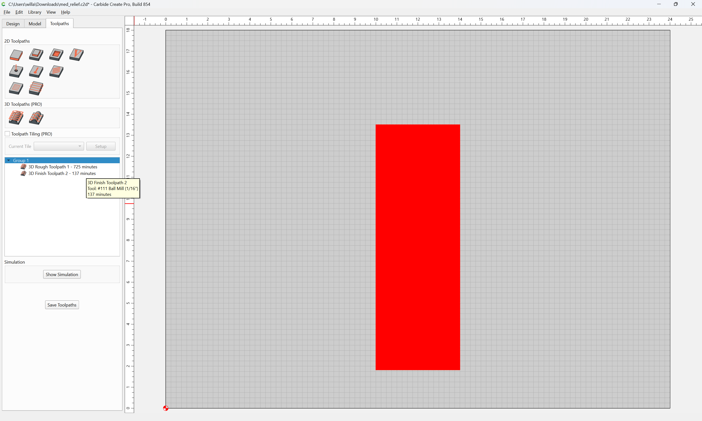

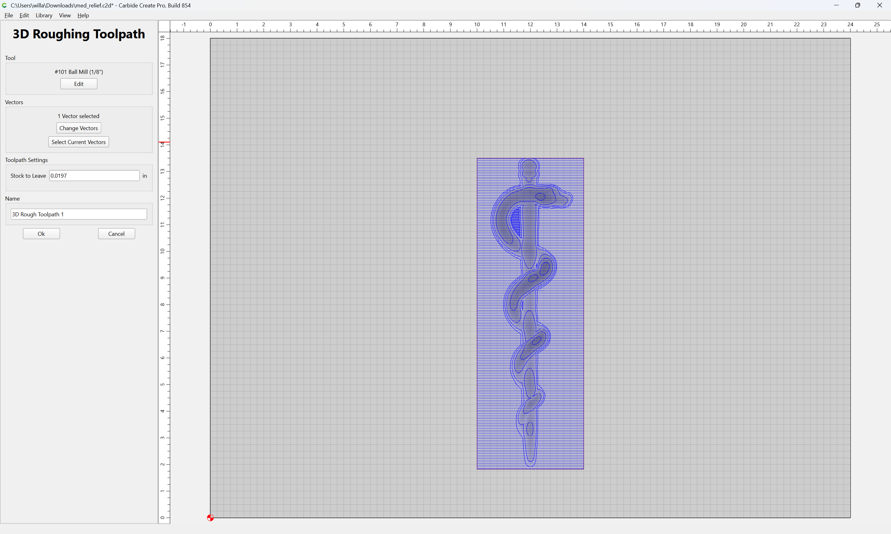

Then create suitable toolpaths:
See:
(note esp. that you should not have a 3D Finishing toolpath w/o an associated 3D Roughing toolpath)
