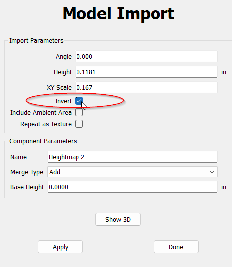

If you’re importing an image, you can invert it…
If you’re building it, you can subtract rather than add.
But with tjs new version of CC i can’t invert.

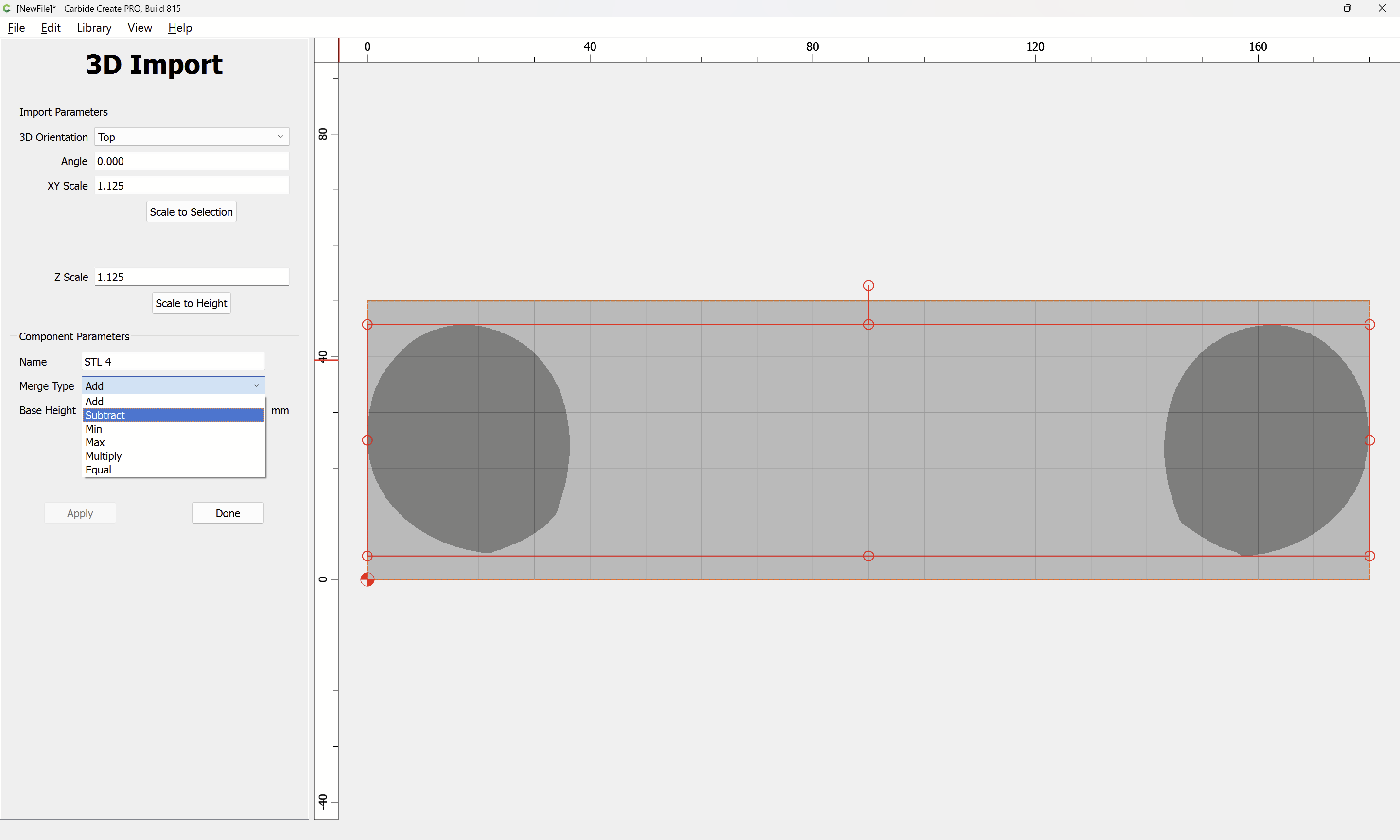

As noted, only a pixel image import can be inverted — if you have a 3D model which you wish to remove from a design, subtract it instead.

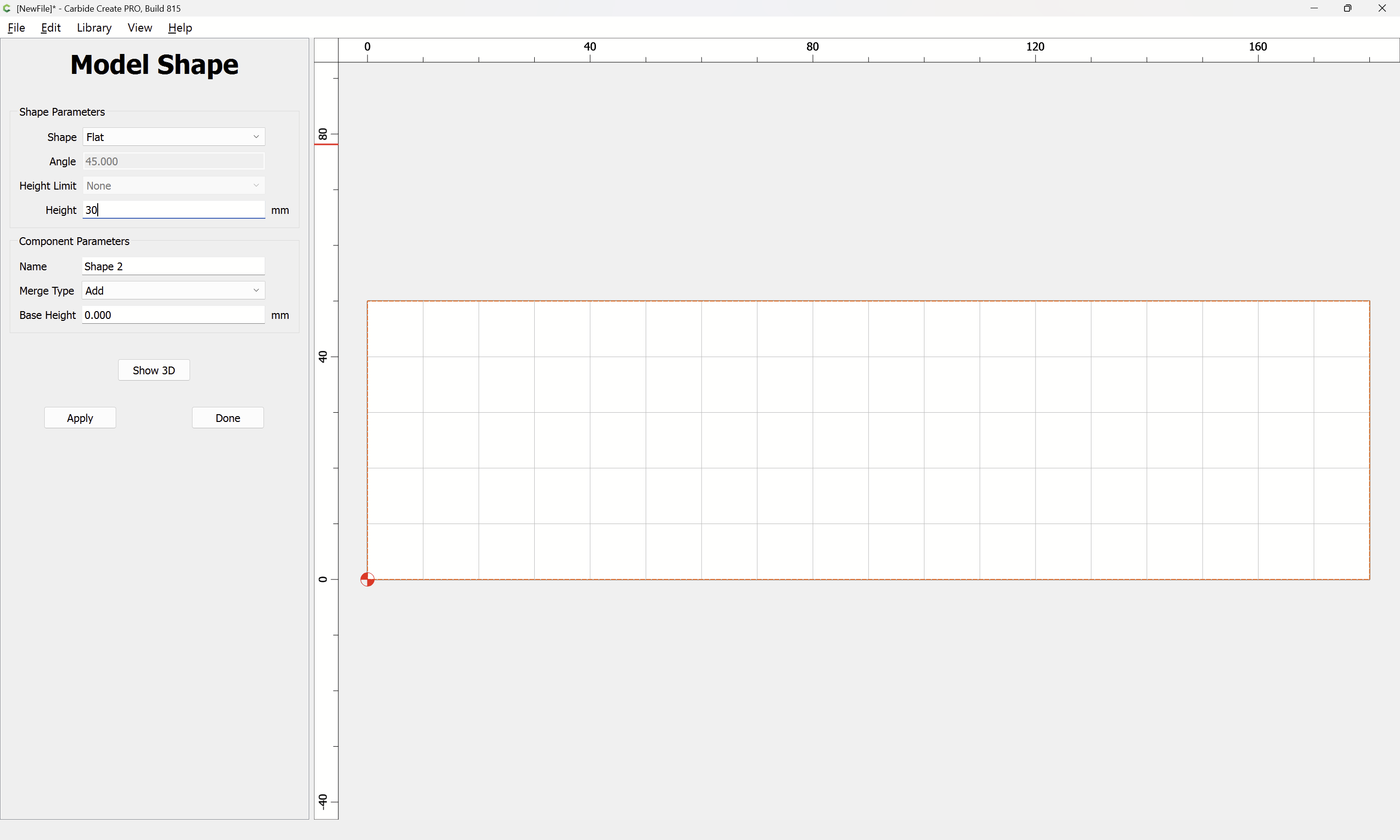

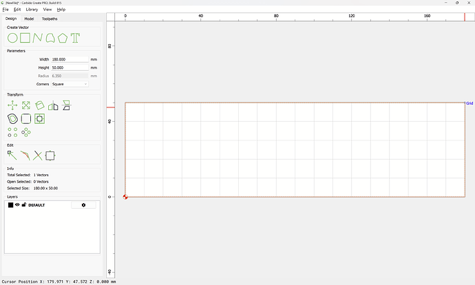

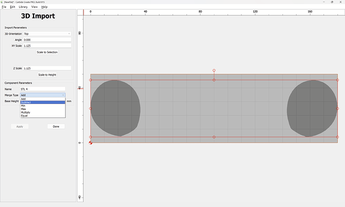

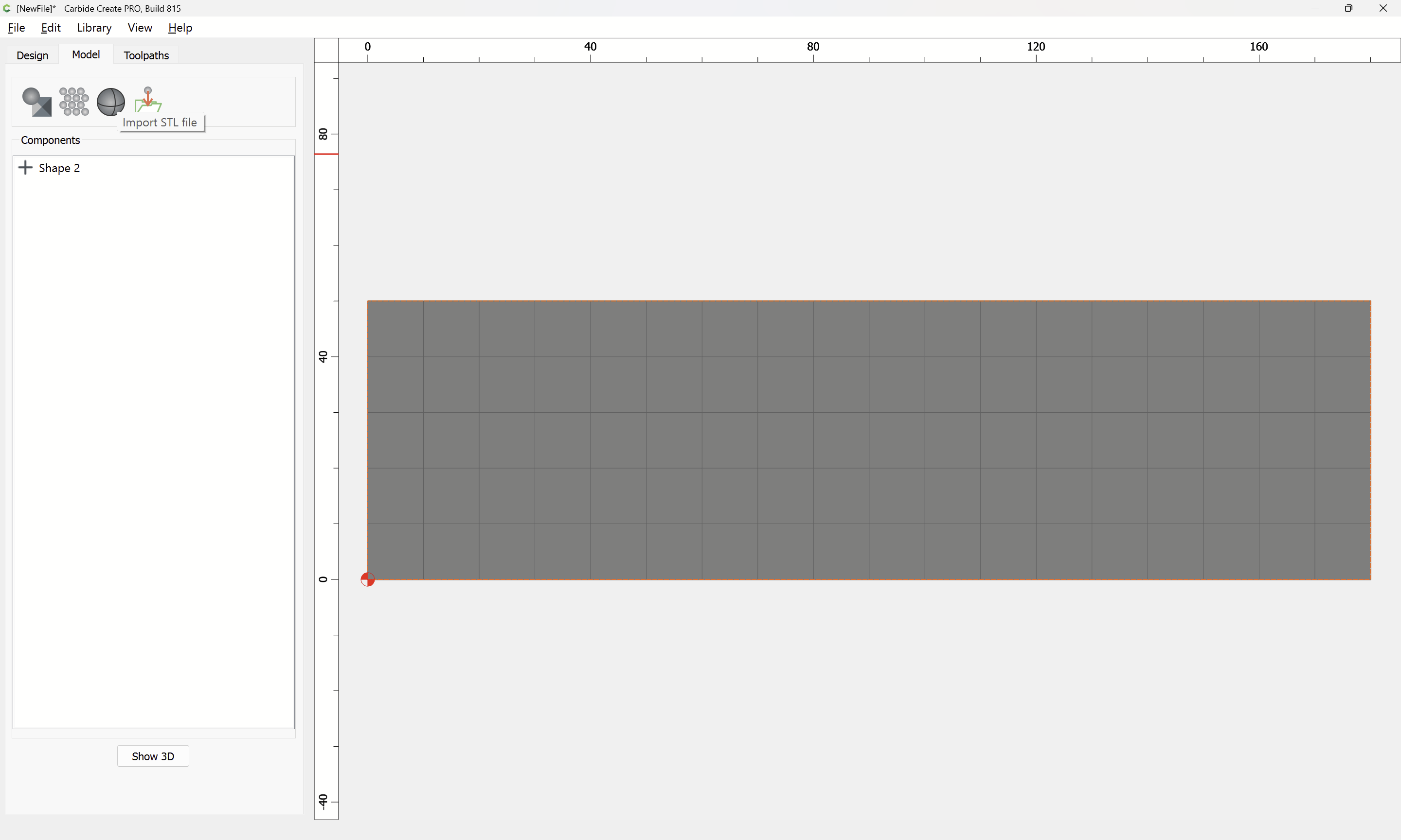

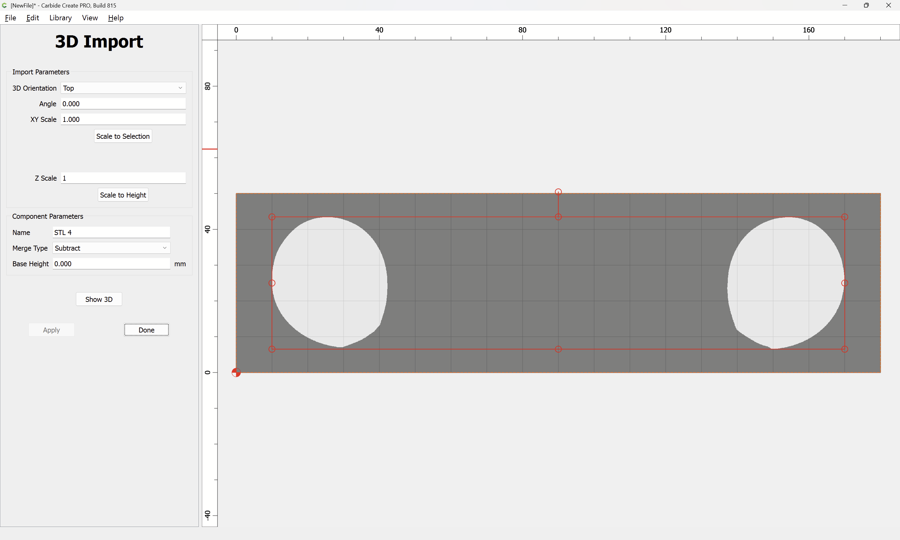

You need something to subtract from.
Build a flat component the height of your stock, then import the STL and subtract it.
WillAdams
(William Adams (Carbide 3D))
May 9, 2025, 10:04pm
15
@Tod1d has it aright.

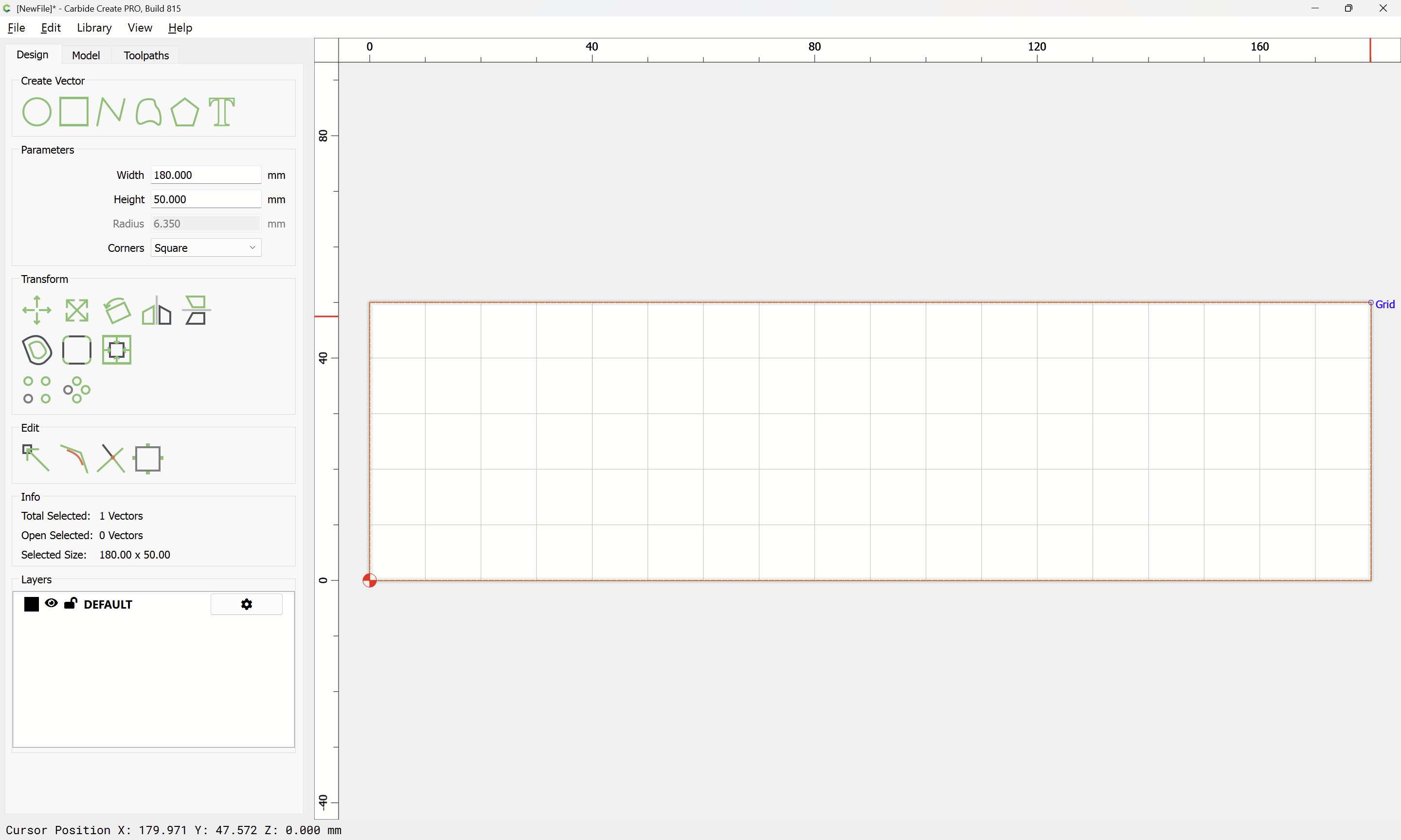

Given a rectangle:

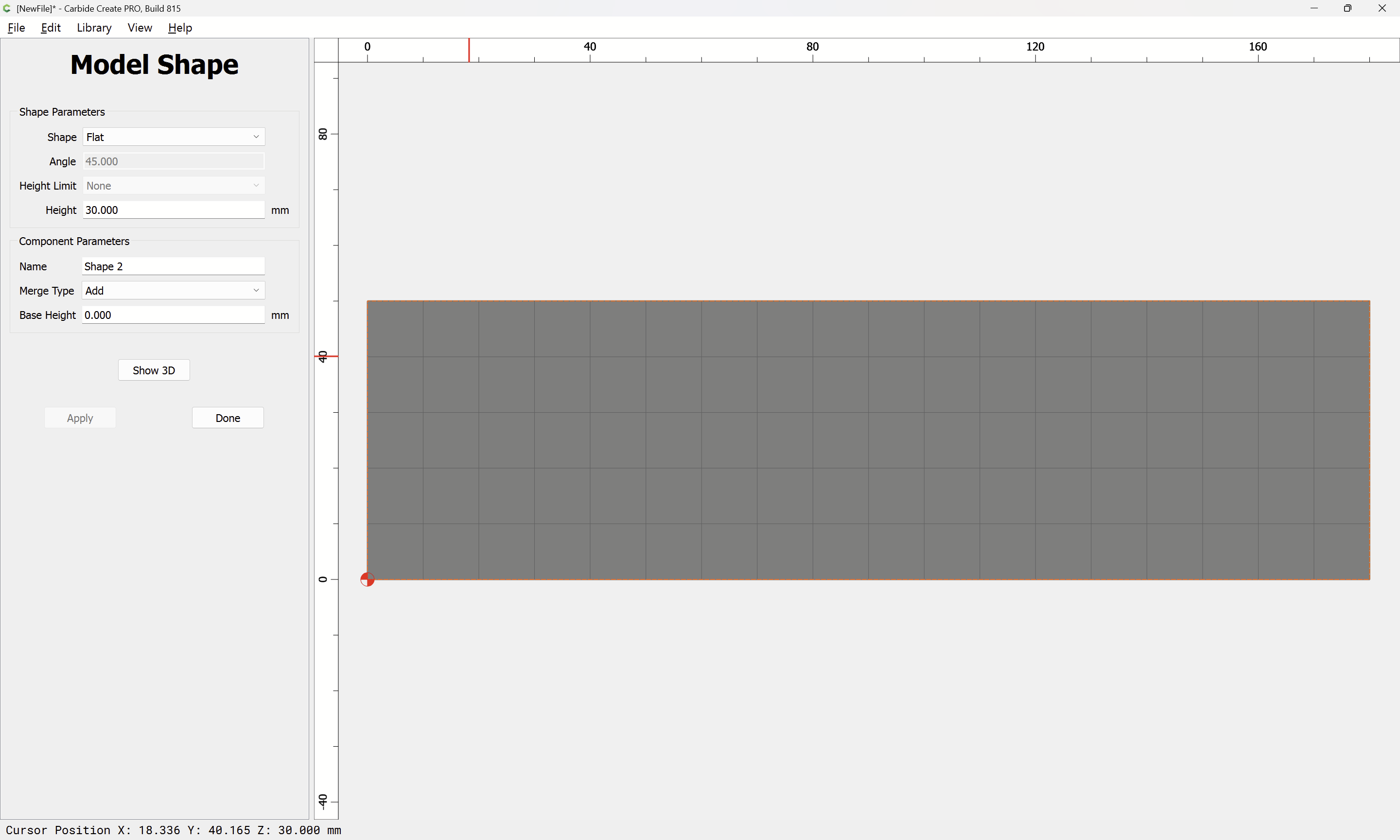

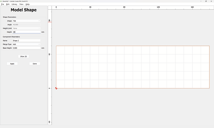

Modeled to a thickness greater than the model:
Apply

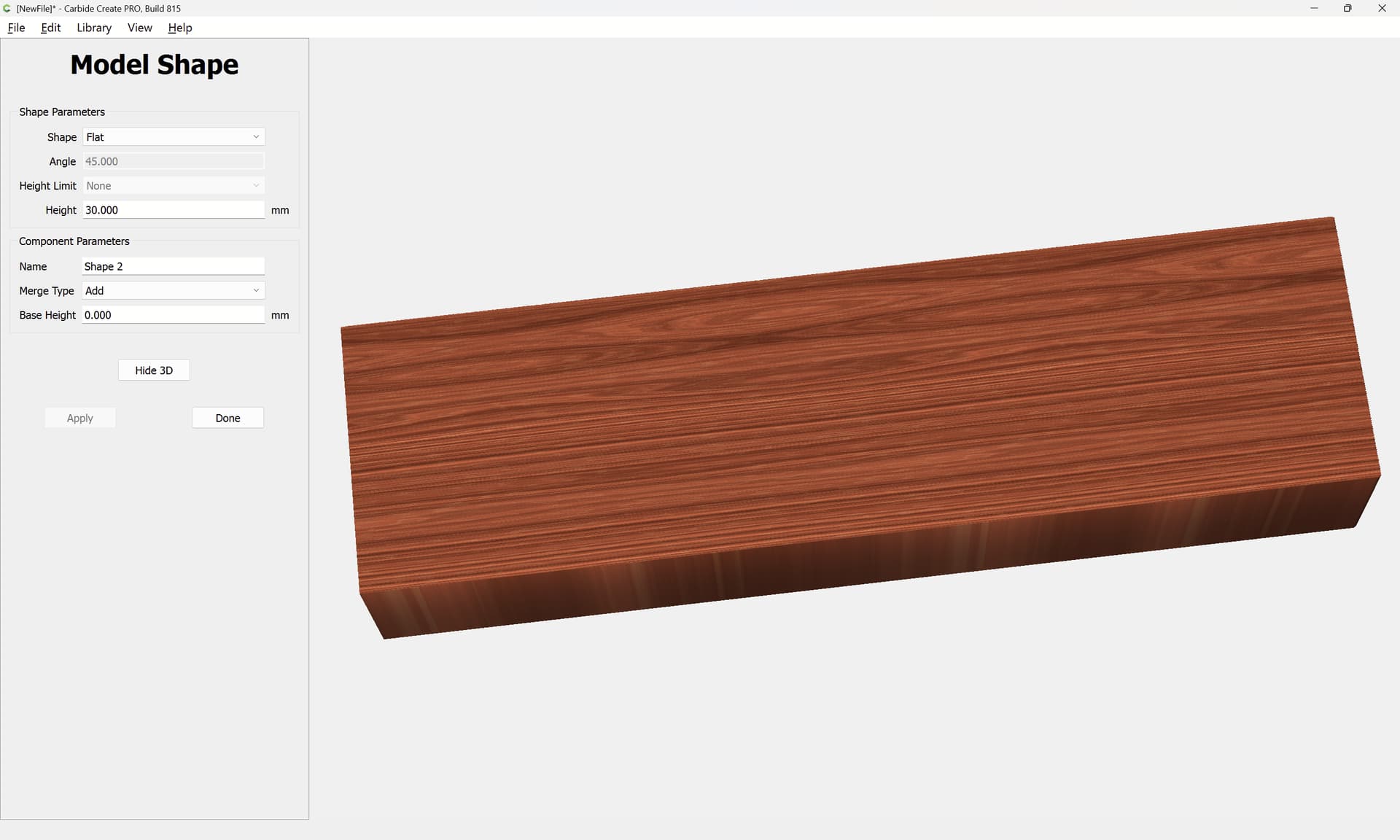

Show 3D

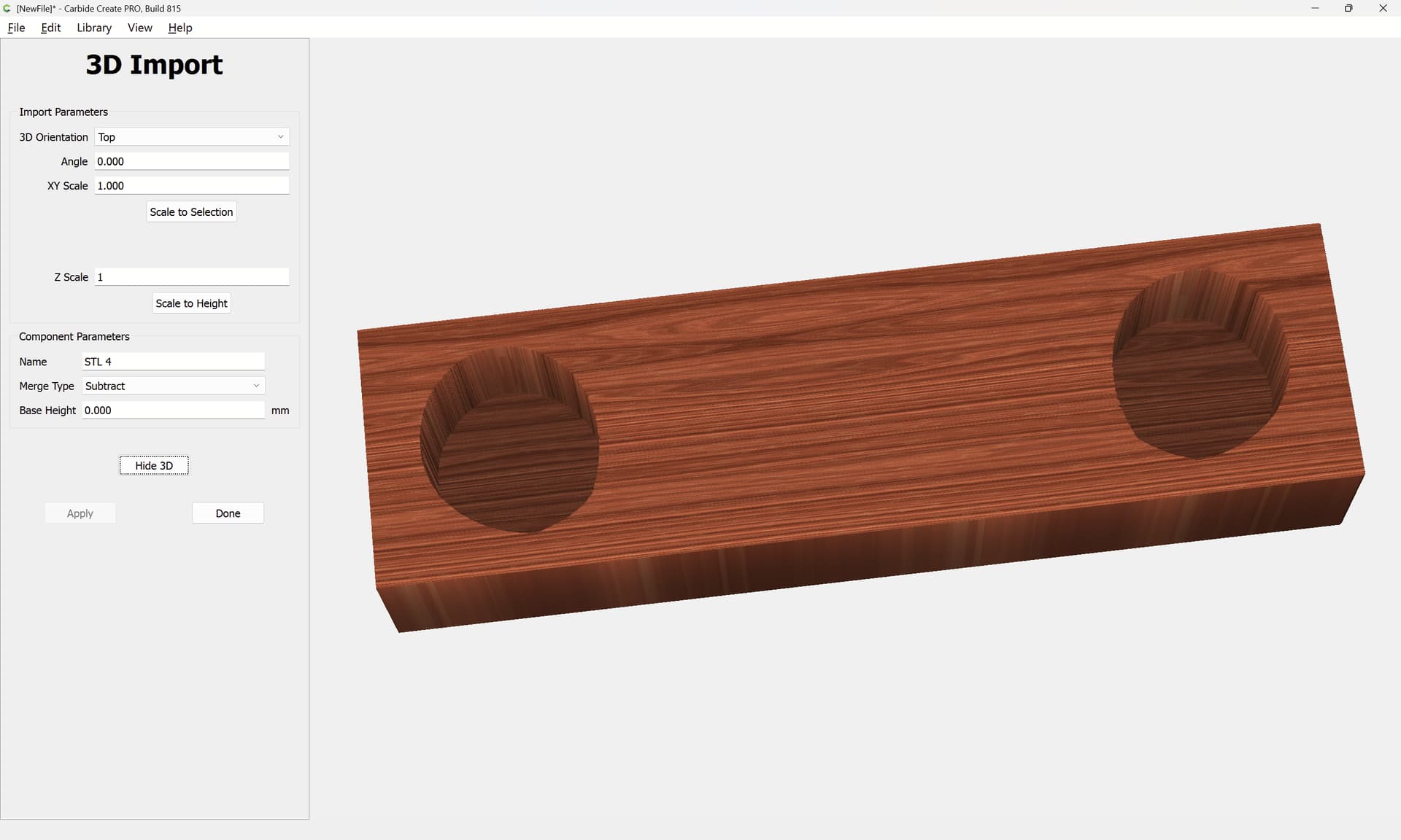

The STL may then be subtracted from it:
