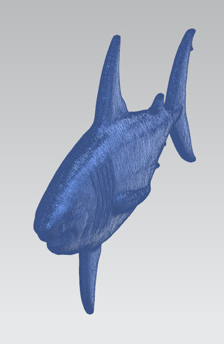

I am attaching a picture of the type of 3D sculpture that I would like to make.

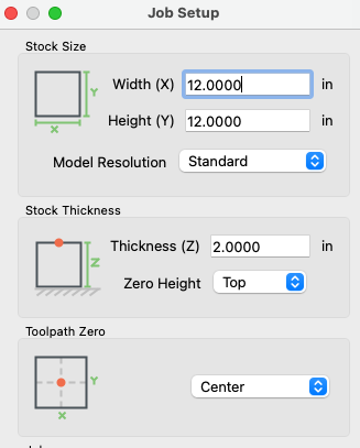

I am trying to use Carbide Create Pro v8 to carve a 3D sculpture by using the Shapeoko 5 Pro to do flip machining.
Assume my stock is a total of 2" thick.

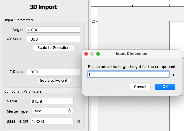

One side of the shark (Side A) will be carved using Carbide Create Pro v8 to a height of 1" with a base height of 1".
QUESTION 1: Do I need to add a shape component in addition to the STL file? If so, what purpose does it serve?

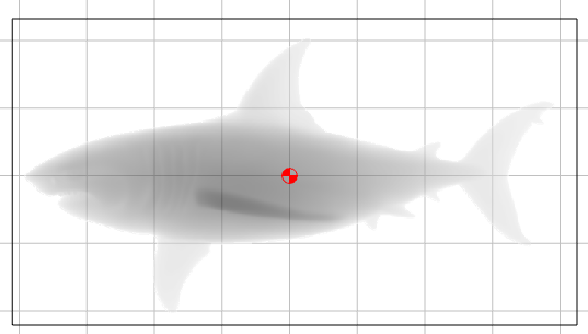

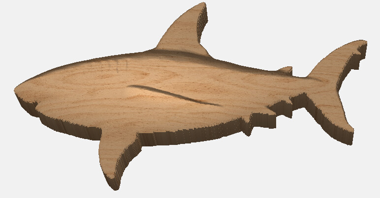

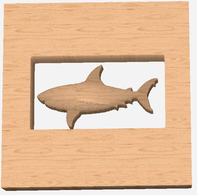

After I create a 3D Rough Toolpath and a 3D Finish Toolpath, I get the following image simulation:
QUESTION 2: Why does the immediate area around the shark appear totally cut through? Shouldn’t I have a 1" base that will be used to carve the flip side?

Assuming the final width of the shark will be 2", then you want to import it at 2" height.
Then make a 1" - radius of cutter base and use the Max merge type. The base should be a bit larger than the shark so it stops the cutter from going all the way through.
Then on the flip side, do the same thing with the STL reversed.
You may want to model tabs to hold it in place for the flip side cut.
This all assumes the parting line is right at 1". If the shark is on a bit of an angle then the base for the first cut will need to be lower.

OK, so the raw STLs are 7.835" x 4.0818" x 0.5182"
They do have a flat parting line, so you’re good there.
The whole thing, both sides together look kinda skinny

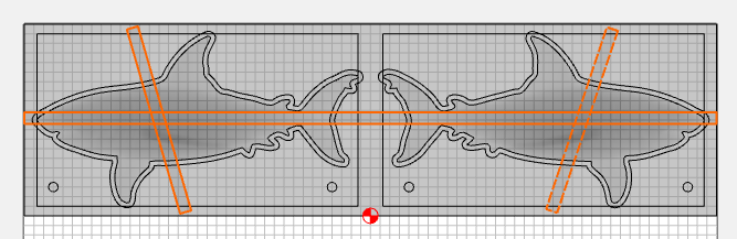

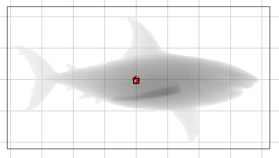

I would do it this way. Start with a workpiece a little bigger. Say 9 x 5
Make a 9 x 5 rectangle for the base.
Make a rectangle your 8.35 x 4.5 and make a full size base & import the STL at 1" height
Create a base component 0.875 thick, and import the STL at 1" with a 0.125" base.
In this one I used a 18 x 10 workpiece, a 18 x 5 base, and two 8.35 x 4.5 rectangles to import the STL. With the zero in the center I can use the same physical corner for my XY zero when I flip it. And I can program the toolpaths in the same part.

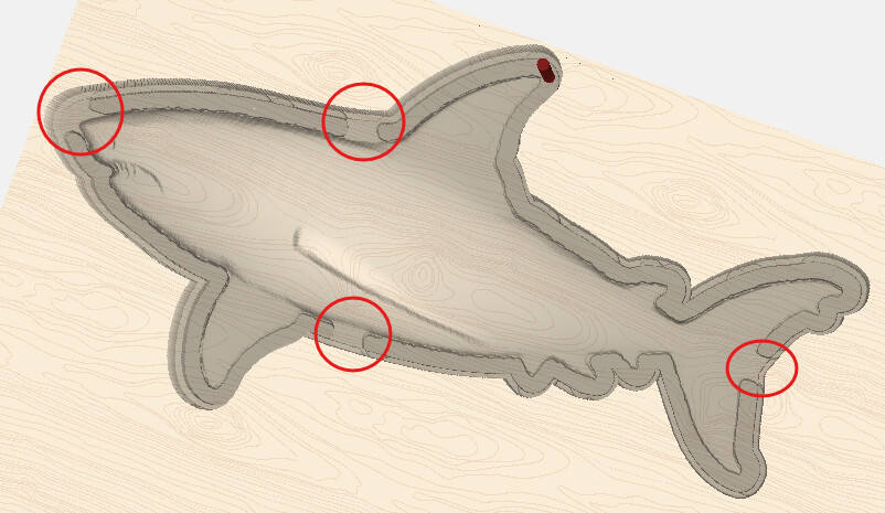

[edit] I added tabs to the model so it won’t fall out.

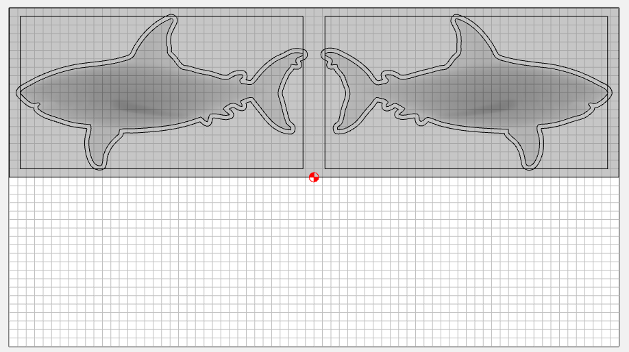

In your .c2d file, you include both sides of the shark. Wouldn’t you want one shark side per file so the flip side is positioned at the same location?

Your modeling includes “tabs”, but when I run your tool paths, I don’t see them. Can you give me more detail on the tab tool paths?

I imported the STLs into NX, then rotated the left side around to put them together. They import at nominal size, then you can scale them if you want.
You can do it in separate files with the zero at lower left on both. You have to be very conscientious with your flip. The way I layed it out, you cut the right side with a lower left zero to a known square corner. When you flip it left → right, that physical corner on the stock is now in the lower right. If you zero from the same physical corner, and your stock is aligned & square, the alignment should be very close.
After you add the components for the shark, right-click on the component and “Create Outline Vectors”. Leave the value at 0 and it will trace the bottom of that vector. Then you can offset that vector to get your 3D toolpath boundary.
For a 3D model, I added the tabs as part of the model. The height is 1.125, and the centerline is at 1", so the overall height of the tab from both sides is 0.250"
