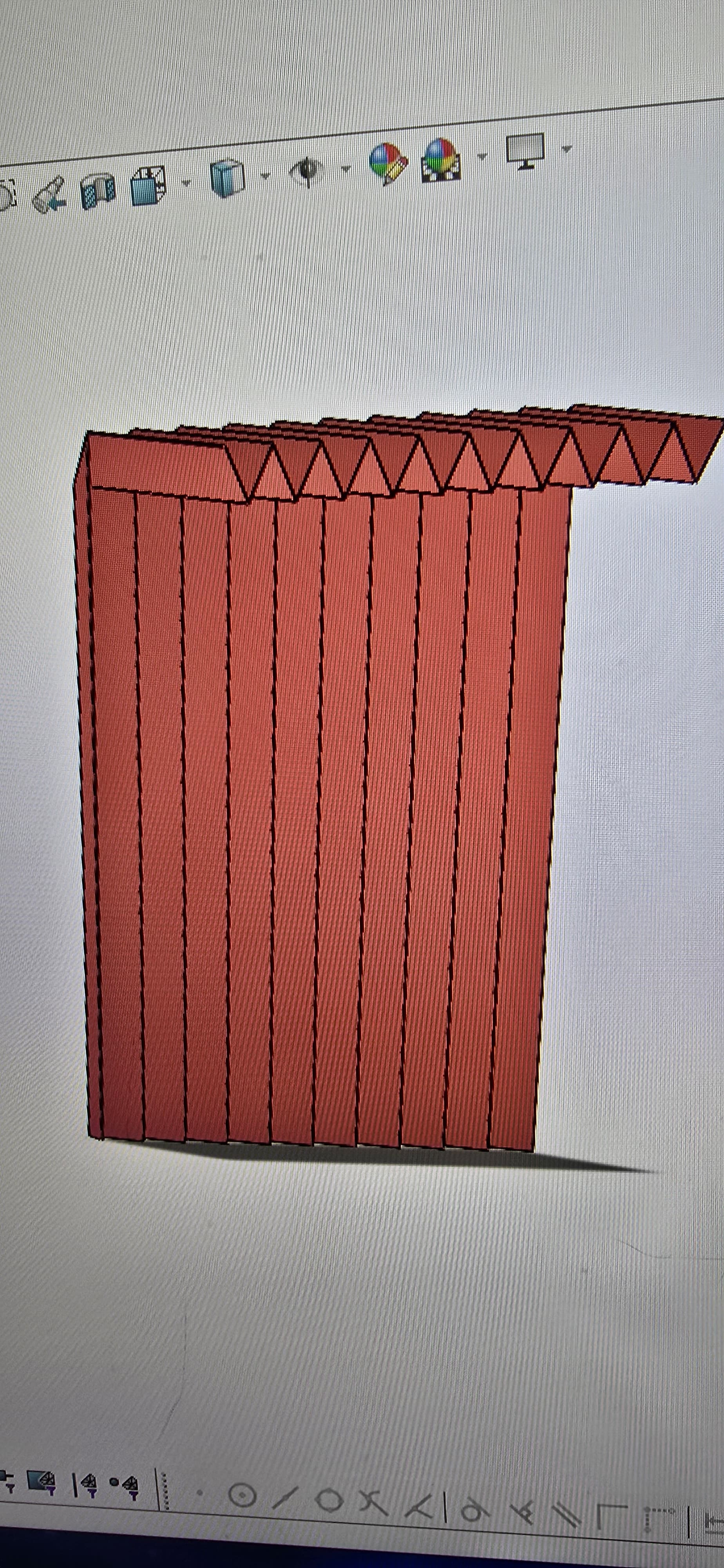

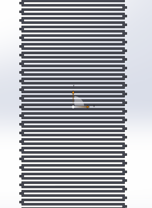

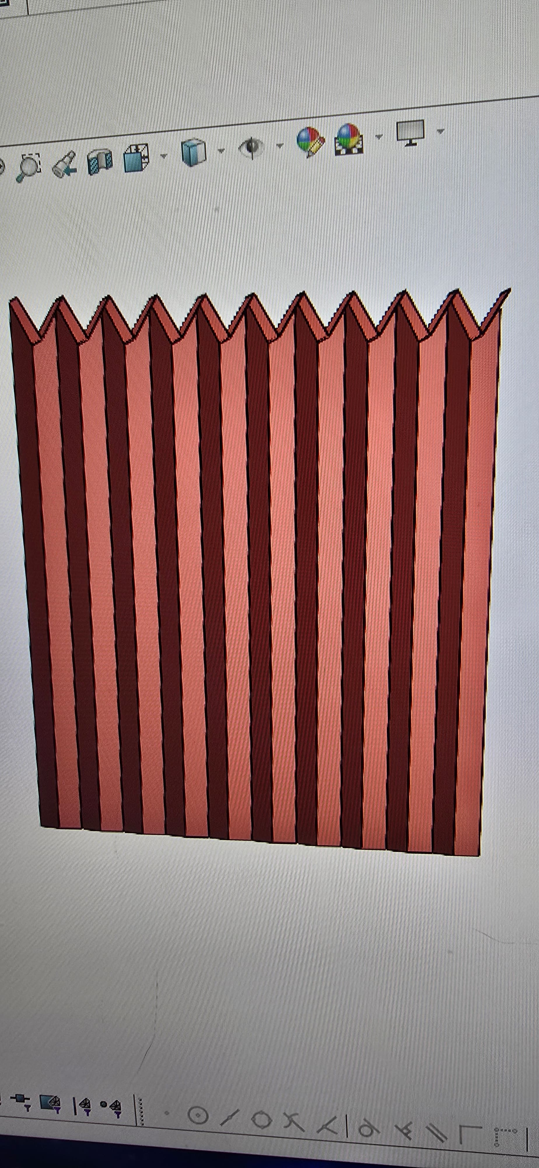

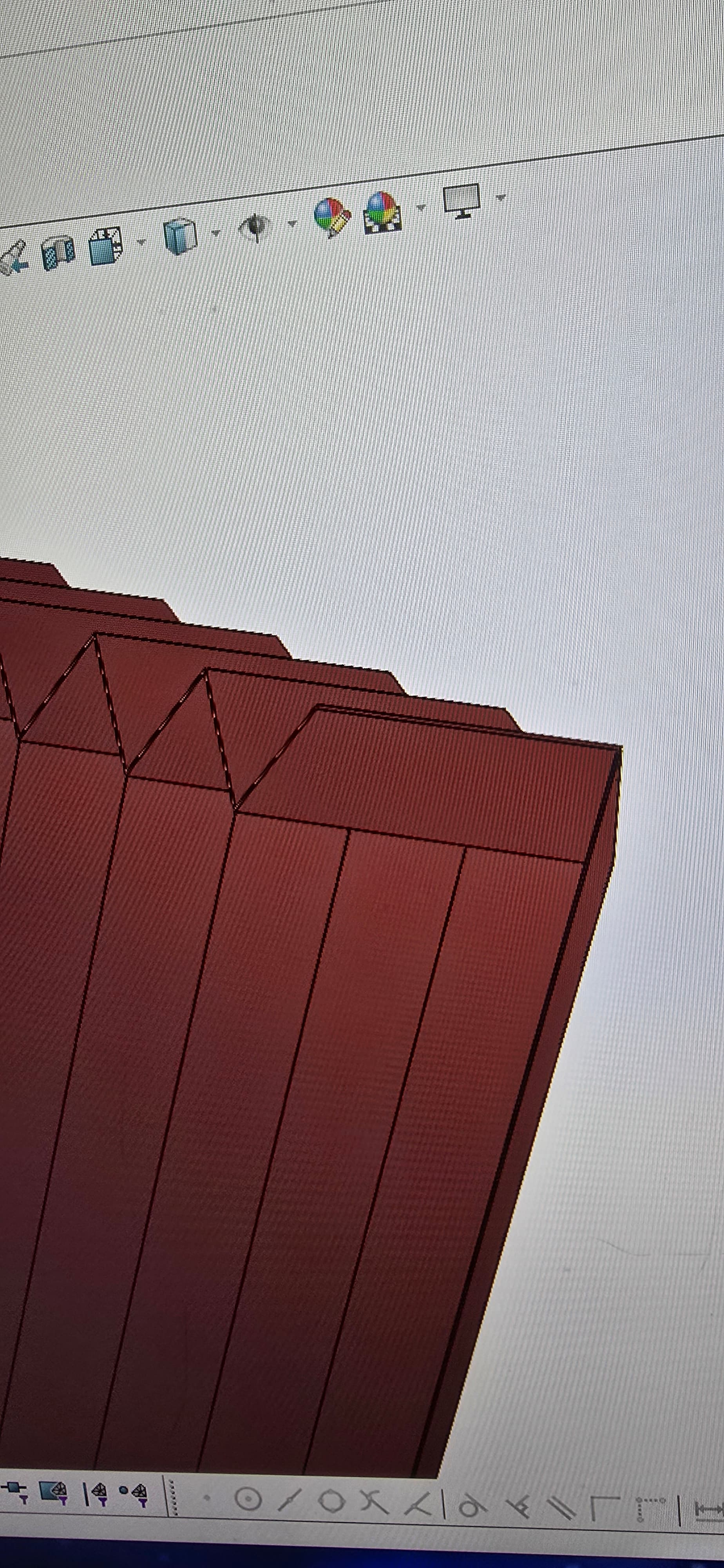

Okay. That was easier than I thought it would be to get this demo made.
that’s some damn fine modeling, one other trick was modeling it in a relaxed state with .2or .4mm distance between folds to make layer height not an issue as there was alot of mixing and issues people went through during prototyping.

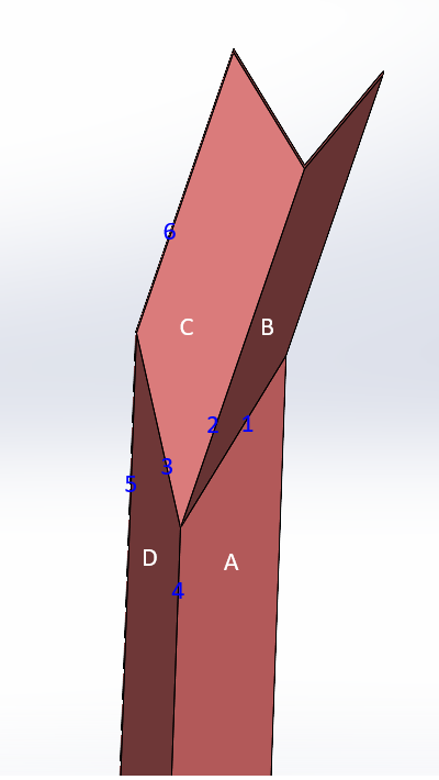

Thanks! Flattening it is a bit more difficult (as you and others have already found out) because I keep attaching the wrong seams to the wrong panels. I need to just look at the demo and get some paper and just sketch each layer.
I thought I got close, but discovered I attached a seam that should not have been attached to a panel side, and now I am back to layer 2 of 8 or 9 again.

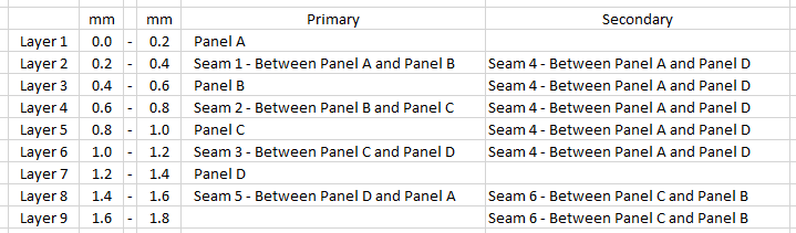

Okay, I think this is the level-by-level layup. We’ll see shortly.

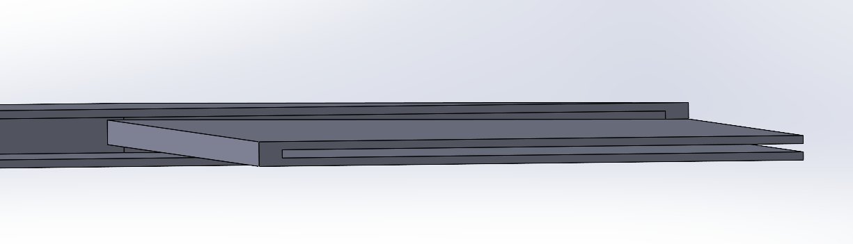

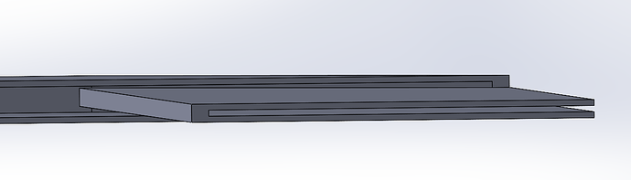

Here is a single unit of the pretty - but useless for printing - bellows model.
And here is how I think the layer-by-layer stackup should go.

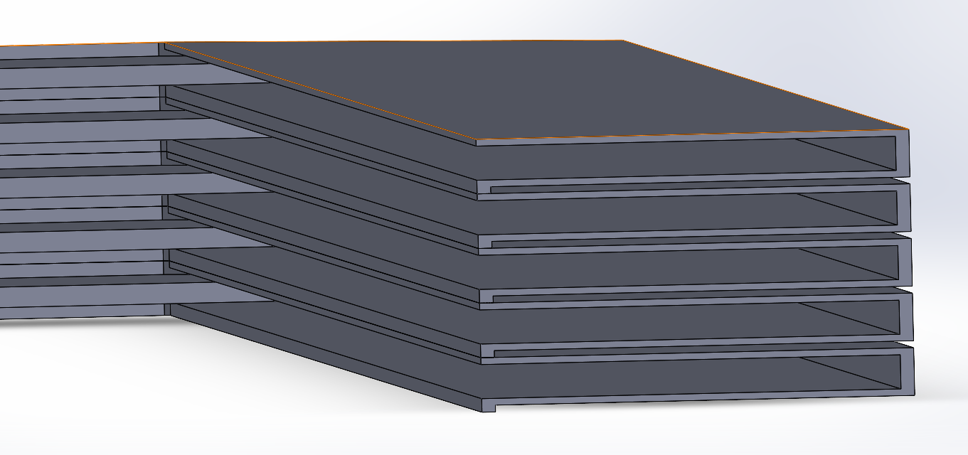

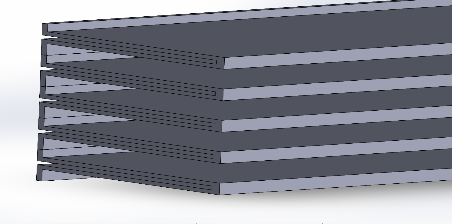

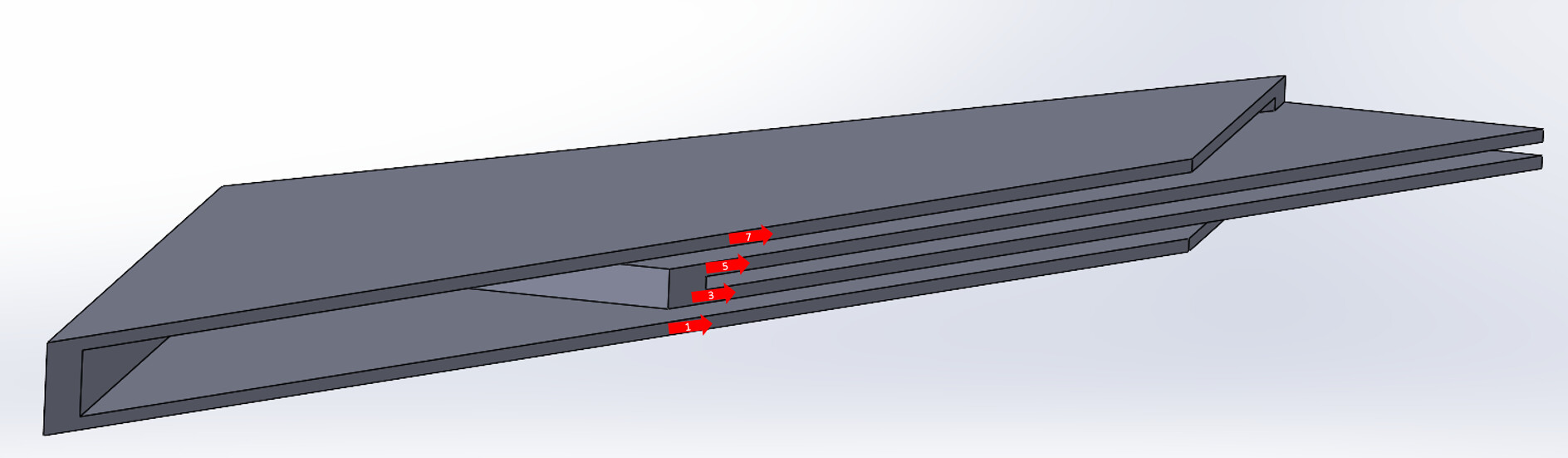

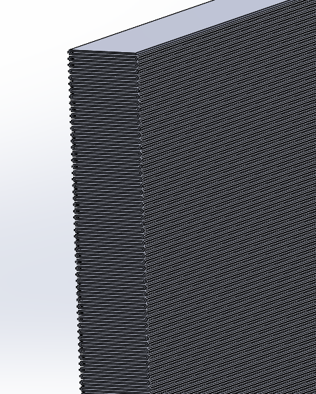

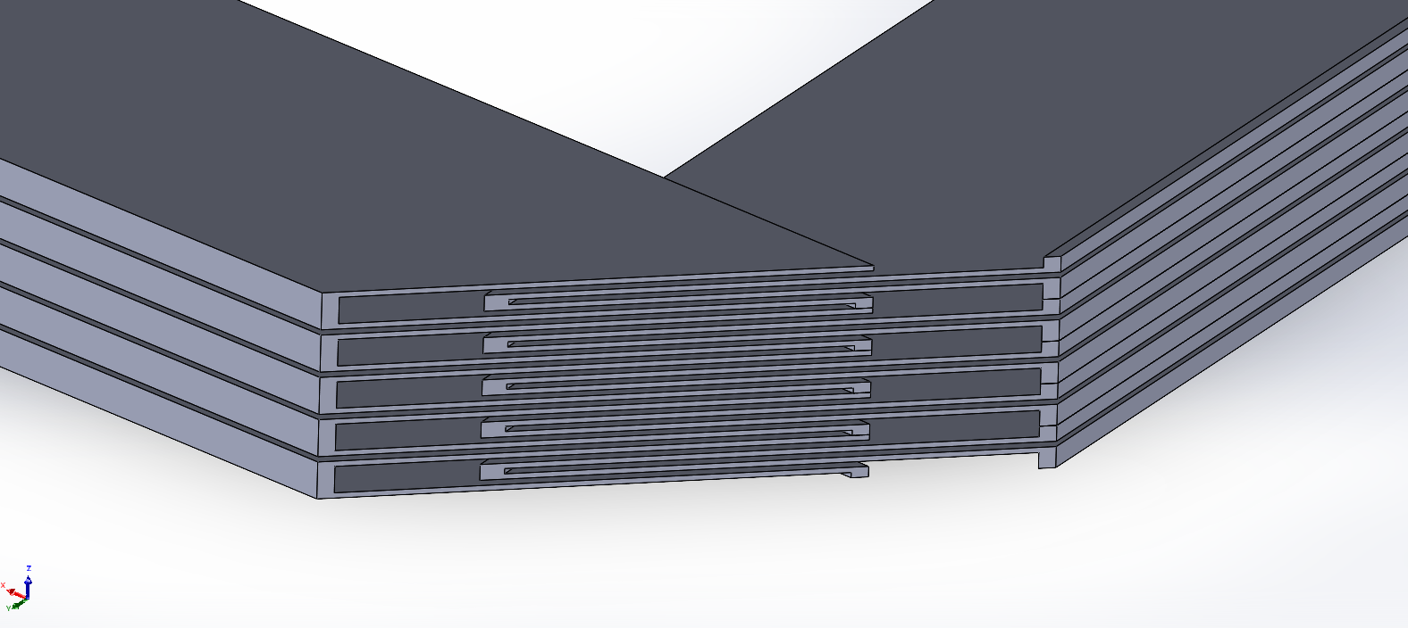

Okay, it’s difficult to see all the layers, and see the whole thing, so here come the zoomed screenshots and cross sections.

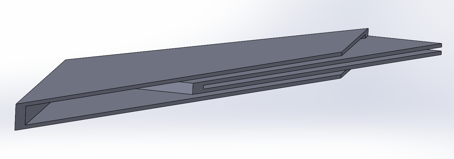

Here is a cut view of the corner, with all of the overlapping layers.
Here are the numbered layers for reference.
I still need to add layers 8 and 9, but figured I’d post this. Those two layers are only needed for attaching this undividual unit to the one next in the array of them, but not needed for printing just this one.

Had to add a few “hinge” strips to the first couple of layers, and I think I have the TPU portion done. Now, I just need to create the model with the PLA supports, since I don’t trust the slicer to make them properly for me.
