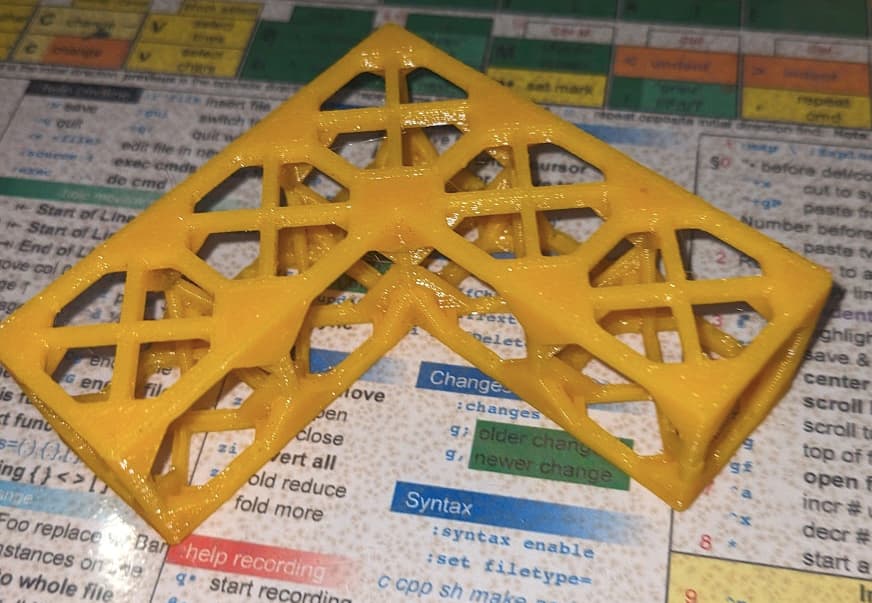

Like I said, I’m still pretty new to CNC and I’ve mainly used the CA glue / blue tape method for holding down work pieces. What I have done in the past with symmetrical stock is to make a low-profille angle bracket either with clamps and t-nuts or with an angled L-shape or similar plastic piece.
For instance, I had to make one a bit higher and I made this small “strut” bracket on my Ender. I then aligned it with the t-slot and used it to fix a circular piece I was working on. I used a corner XYZ probe to get the X0 and Y0 and took the Z0 off the piece. I just used the known dimensions of the strut to calculate the zeros. (I did not design the strut – it’s a library – I just wanted to conserve filament).
I include the rectangular opening in my designs and center of the rectangle is zero. When I cut the rectangle I record its center in machine coordinates.
