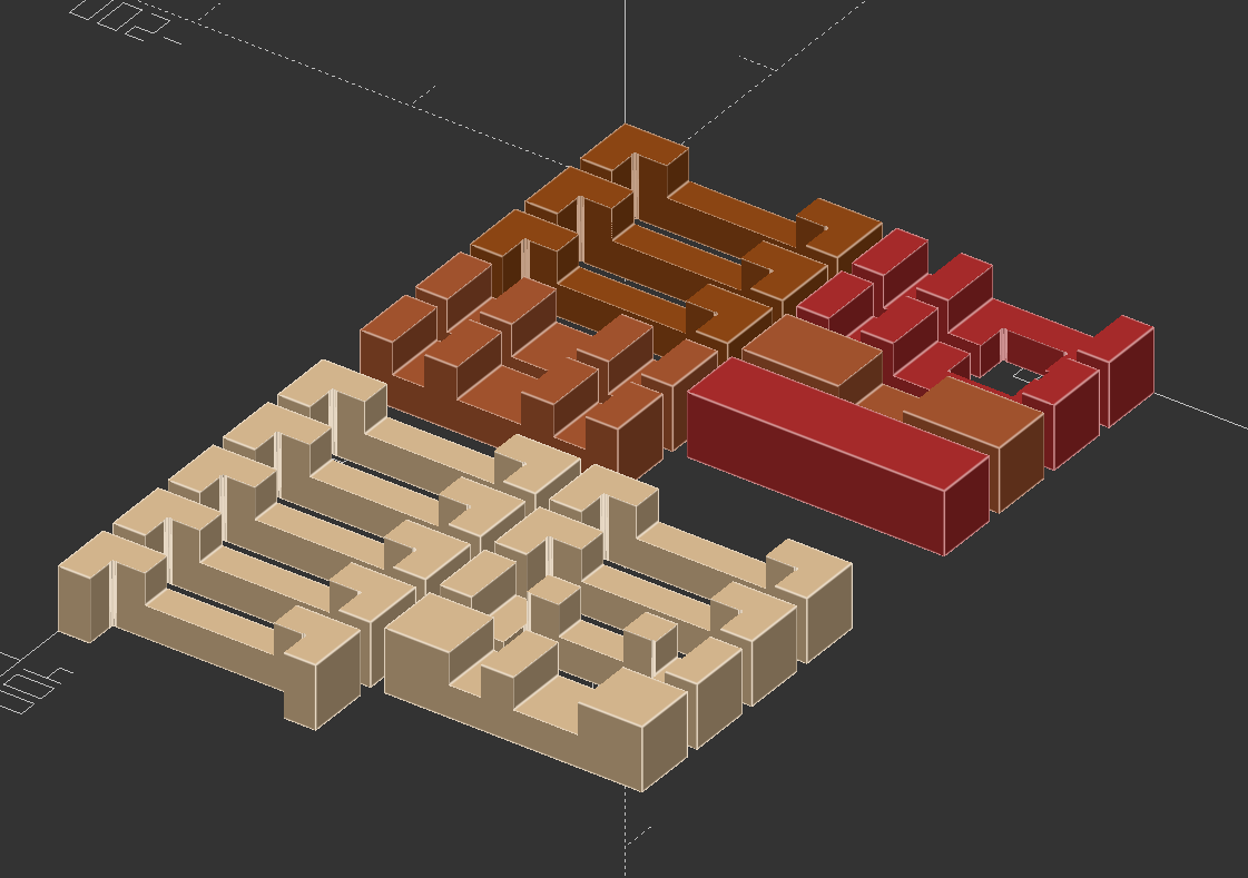

At this point, I have the parts drawn but I have not added any tolerance to the notches. Here’s a screenshot of the “Orion” 18 piece puzzle. Originally, I wanted to try this on the 3018 but I got busy with lfe and other projects.
You can seen there are a few parts that can be cut in one pass and a few that need rotation. I left this project about a year and a half ago and I’m not sure where I was with the double-checking.
I will definitely look at the tolerances since you ran into issues with the finished parts.
EDIT: It looks like I have some primitive “dog bone” functionality in my code for the corners. You can see that in a few pieces shown in the image.

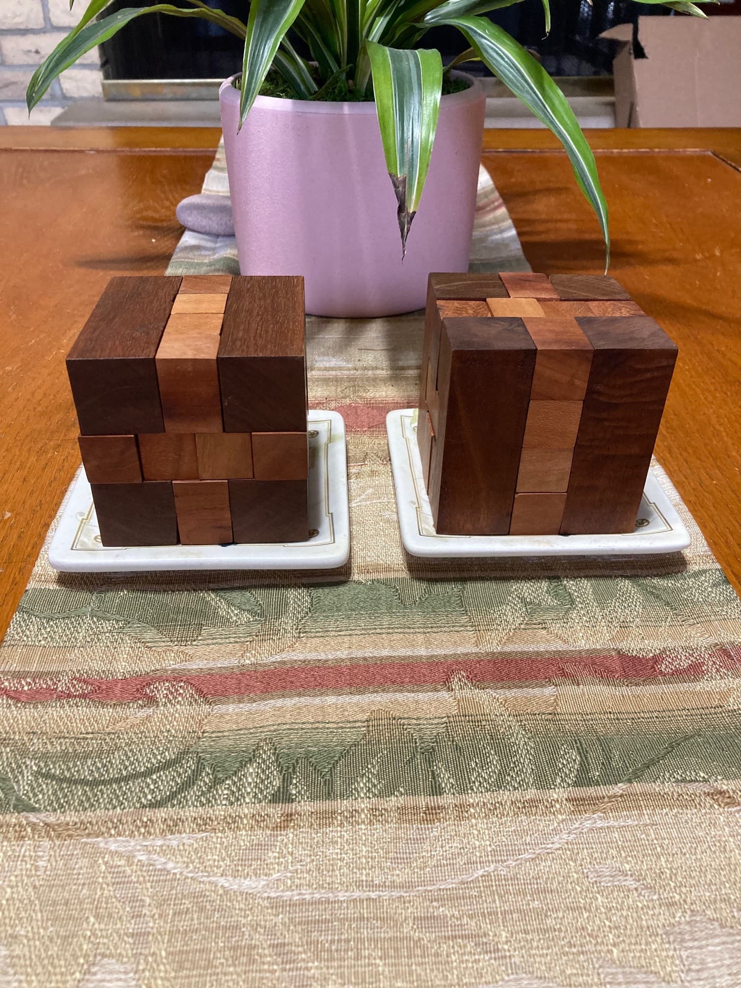

Two 12 piece burr puzzles, 3.125 inch cubes in walnut/black cherry. Mineral oil finish. Not done on CNC. I really like the wood combination and the size. To automate these on the CNC would be fantastic.
Do you have specifications for all the pieces of the 12 piece burr cube? I really like the cube style but I can’t find a cube version in my searches.

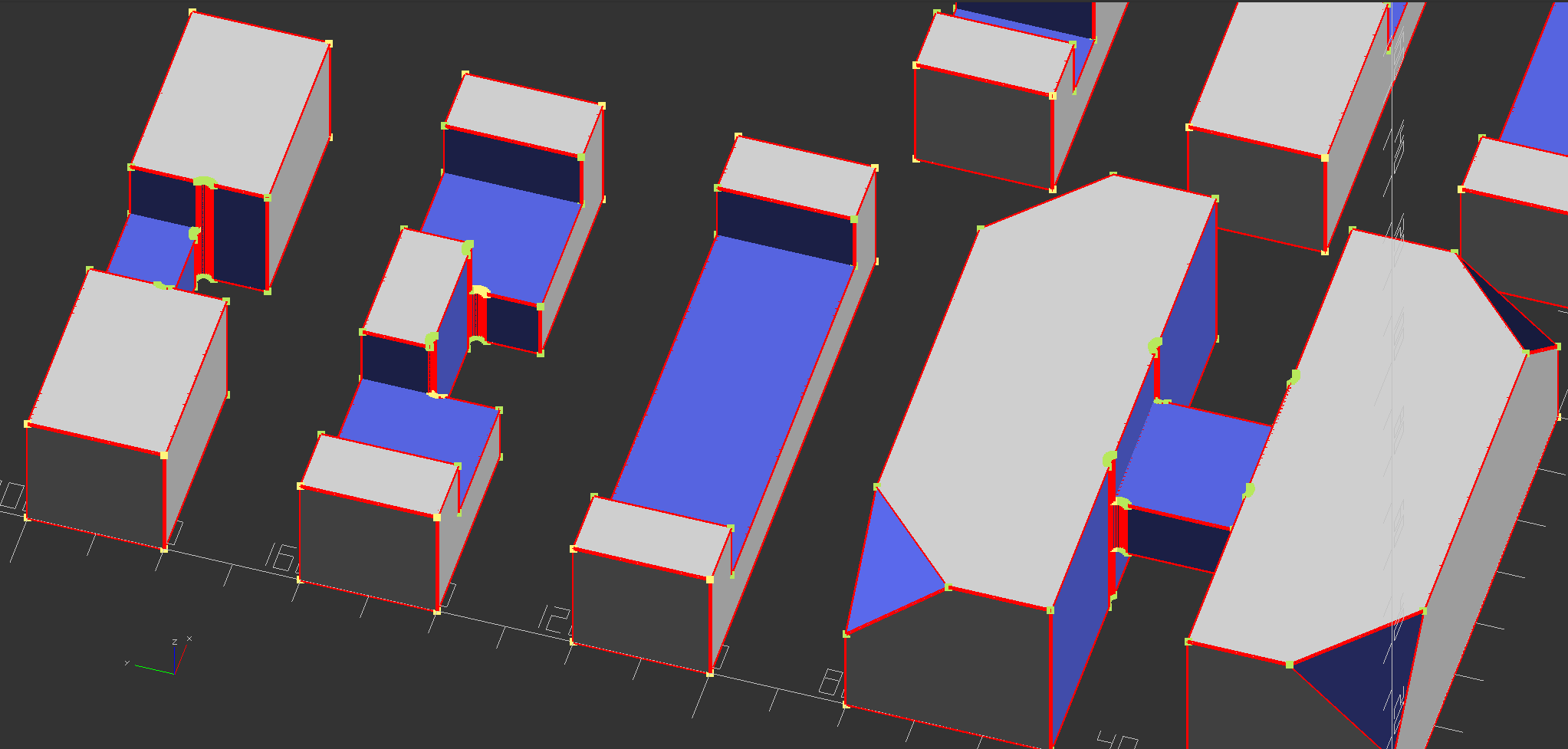

This is what I have so far, I did this early this morning for the seven pieces.
I don’t see how to avoid the dogbones on pieces 1, 3 and 4. This looks crude but it lines up, the rendering isn’t great in OpenSCAD:

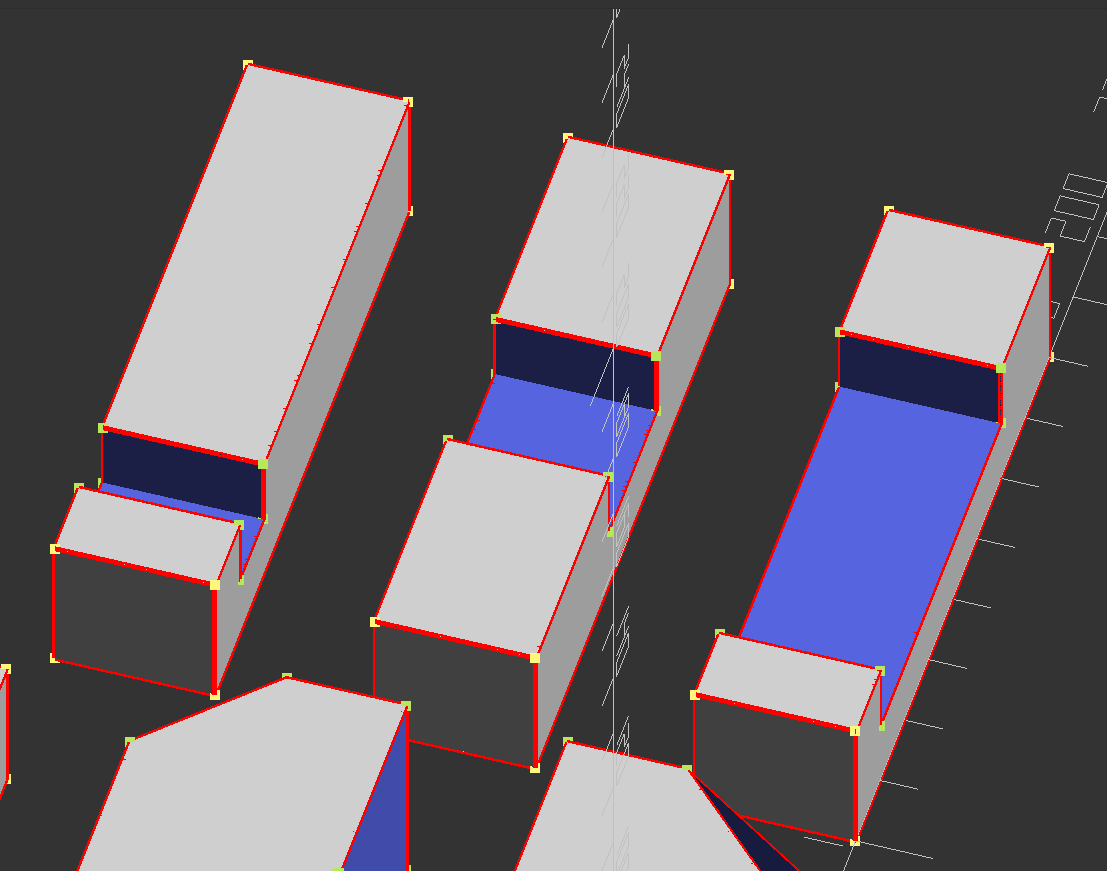

And this is pieces 5 through 7:
I am pretty sure you need the dogbones in the inside corners, otherwise the bit won’t clear the corner and it will round it. Basically it’s a circle with the diameter as the bit size and its center on the inside corner. In these I did a 3.175.
Another thing to consider is the length of the bit, and the smaller ones probably won’t reach that far. I have a lot of tiny bits from my 3018 setup but I doubt they’ll reach 20mm without the shank getting in the way. :frowning:

Re-orient and re-cut the parts as necessary so as to get the requisite sharp interior angles?
That would seem to be the raison d’être of the fixture shown above.
Yes, I’m seeing it now, a couple of 90 degree rotations would take care of that. C`est vrai.
