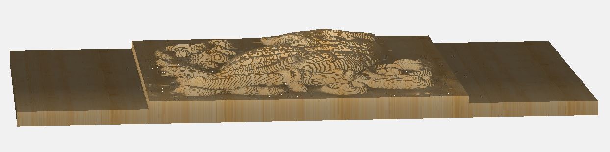

Hello all, so I have imported this stl that I purchased from etsy, Made the necessary changes to fit my stock. However, when viewing the 3d preview my stock has 2 layers cut.
Question: How do I prevent the cut on both sides of my image rendering a flat surface with the 3d image prevailing on top?
v/r

Probably what you want to do is to import the STL alone (I’m guessing it includes the base area) then add the additional geometry around it to get an even base.
This sort of thing was discussed recently at:
