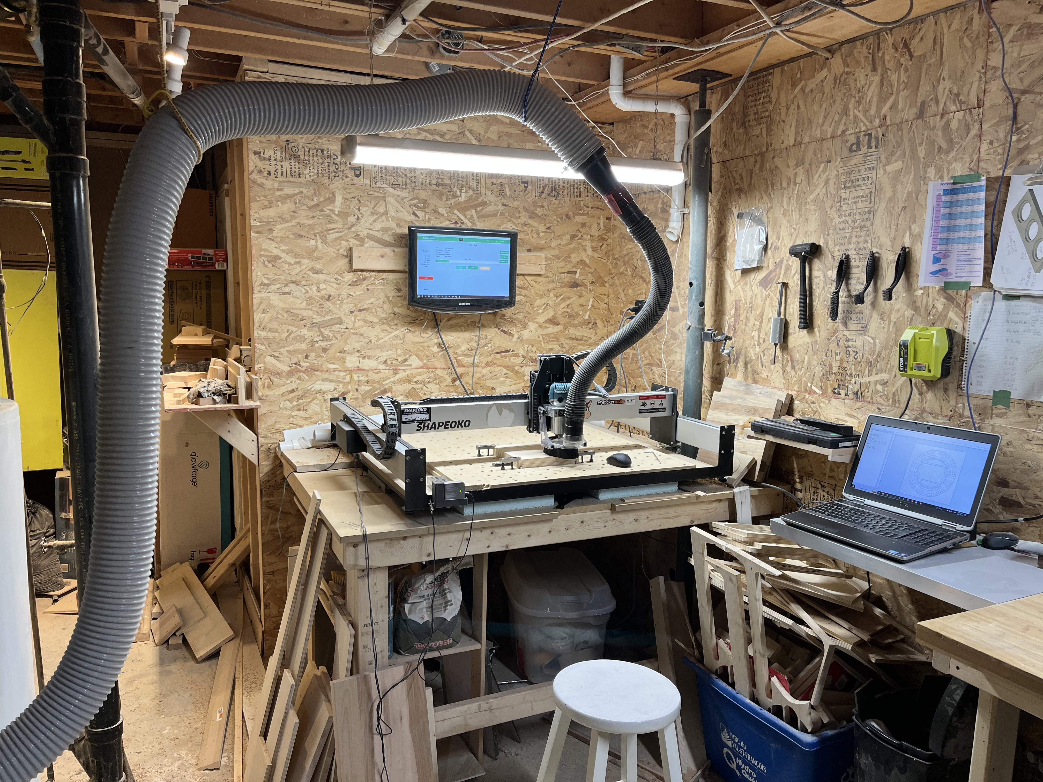

I have an SO3 XXL. Here is my setup. Notice that from the dust boot I have a straight piece of dust extraction hose. This is a rigid piece and the diving platform has enough room for the dust collection host to get to the 4 corners. I think my system works because of the rigid hose coming up from the dust shoe.
