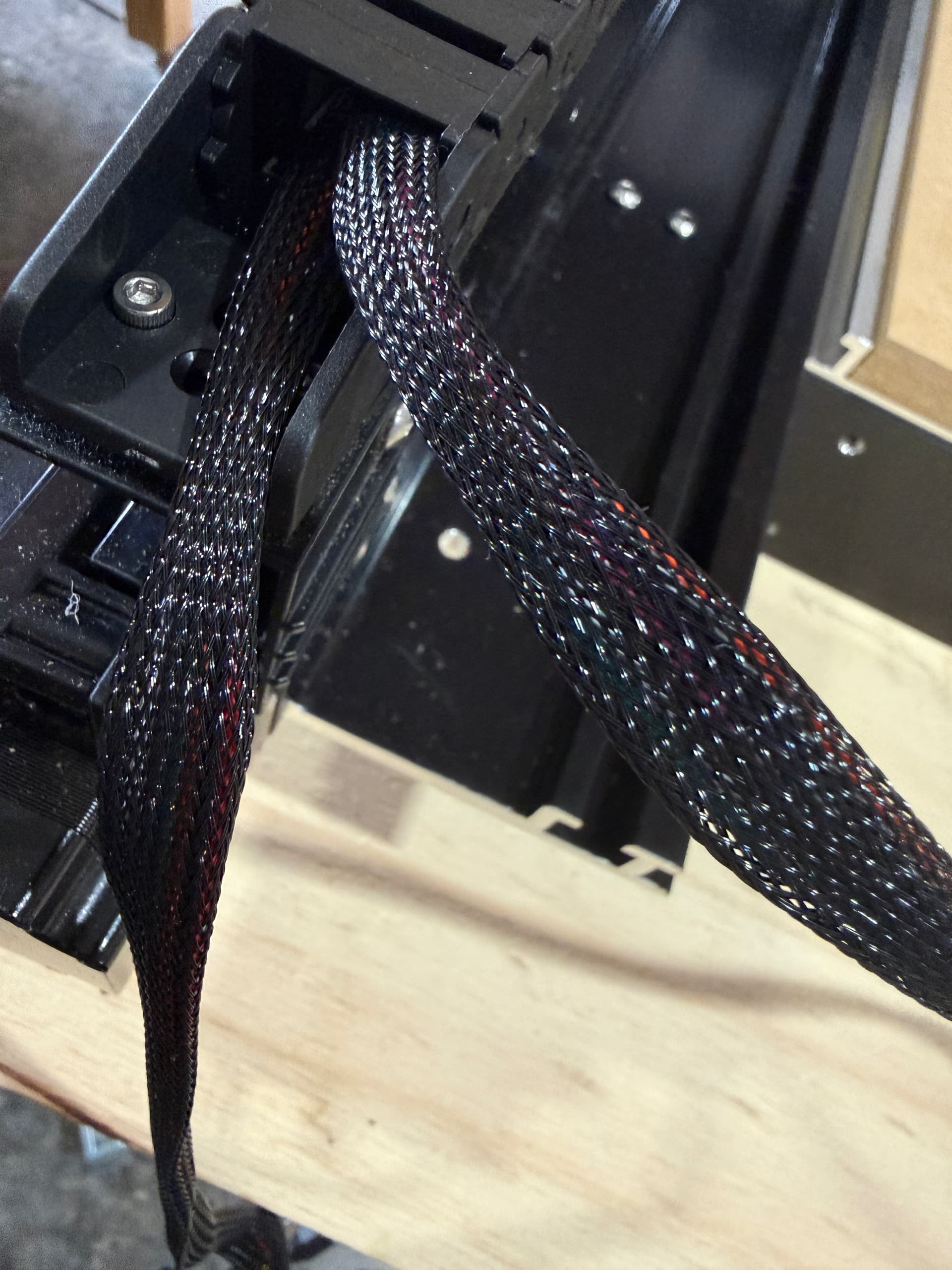

The wiring I received is all encased in braiding (pics attached) that I don’t see on any of the videos and it, frankly, has me pretty confused right now. I just don’t see how the wiring in that braiding would even fit in the wiring holder that affixes to the back rail. I’m afraid, I’m going to run out of assembly time before I can even use any of the 30 minute sessions in the 60 days. I might be missing something and just not understanding it.

Edit: I did have the loom, just have not looked at it in a year!!
The loom provided was not on my 5 Pro I put together a year ago. C3D continues to improve their products and this would be an upgrade to mine. If you have trouble fitting the Y2 (left Y axis looking from the front of the machine) wire with the loom on it then just remove it and run thru the provided wire chase.
The harness really only goes together one way, if you need some more help I can provide some photos later today when I return to the machine. Send me a message and I’ll get back with you.
