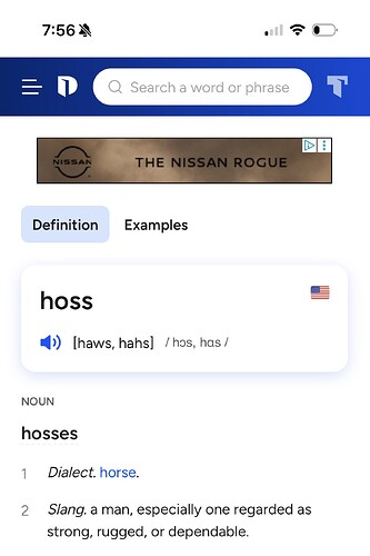

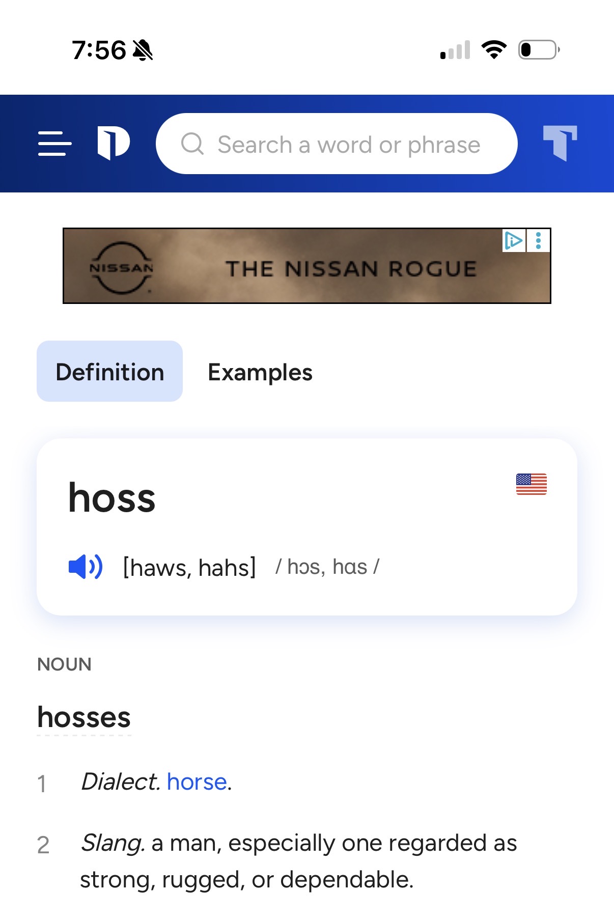

I don’t know what that is, but I hope it’s a good thing.
Yes. Not sure if the origin is from Bonanza or somewhere else.
