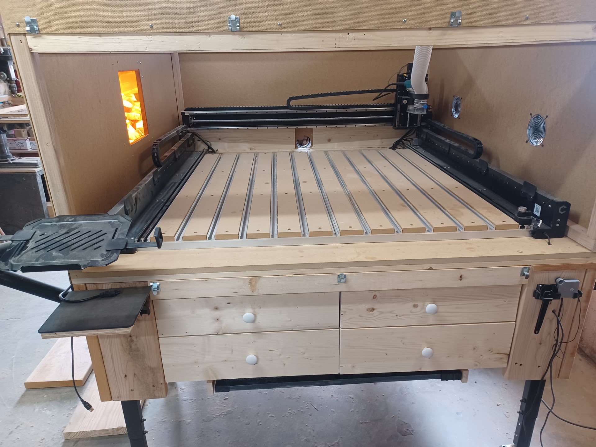

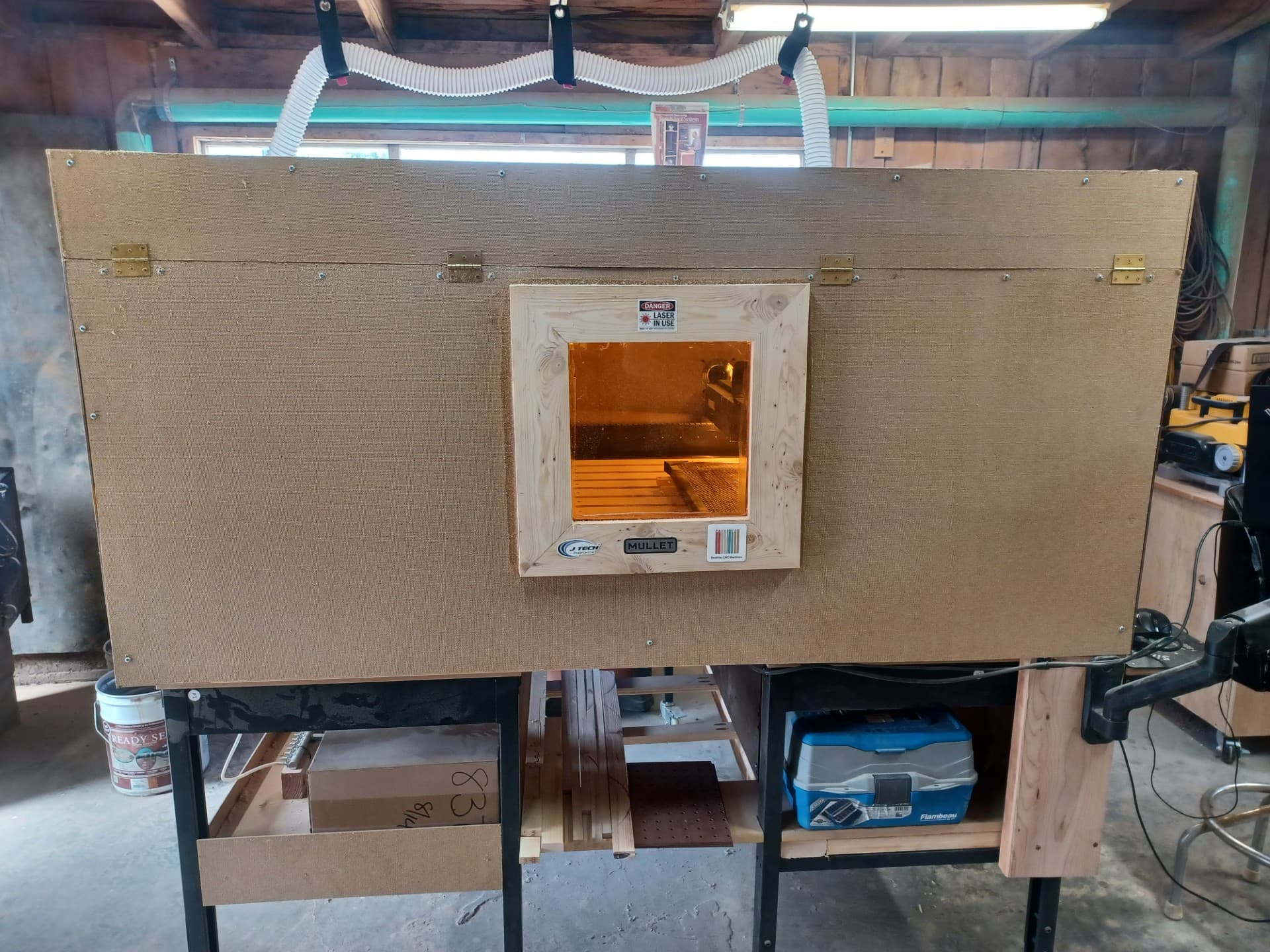

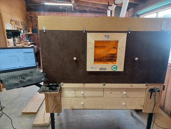

Finally have time to post pics of my 5 Pro 4x4 enclosure, I also attach a 24W JTech laser to the machine.

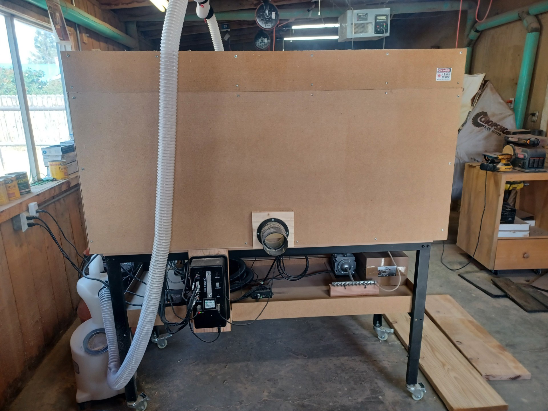

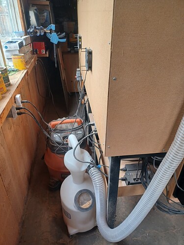

Nice enclosure, how do you like the Mullet cyclone?
I like it, hardly get anything into the shop vac
Thanks, I was wondering how well they worked. A few mixed reviews on in.
Curious how much this reduced overall noise.
Couldn’t really say, noise has never been that bad, compared to my old machines. When I run the router I leave the front panel off, but I always like to hear machine run so I can hear if something is wrong.
