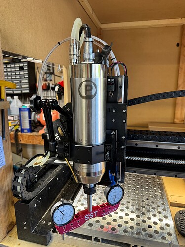

I would like to ask a few questions if you do not mind, It is because I have just obtained that spindle (80mm x 2.2kw from PwnCNC?) to go with my recently upgraded Z axis by way of the sturdier HDZ unit. Looking at the swirl marks, can you say what the deflection in the gantry/spindle was when you measured it? Do you think the marks are caused by a continuous fine oscillation in the spindle mounting, the X rail or both?
The spindle looks high in the mount but it clearly gives you a good Z height. I may very well be mistaken but can the spindle mount be located further up the Z axis plate? If so, would that have an effect on the tendency for the spindle to move in the mount? I suppose a proof of that concept would be to lower the spinle in the spindle mount and see what effect that has on your measured deflectiuons. In your opinion is the spindle movement front to back, side to side or both? Does the tooling type used have any affect on the floor finish markings?

Depending on the measured amount of your X rail deflection, i would probably wish to consider using formal cap heads rather than the supplied button headed allen bolts (possibly even use high tensile). Maybe recutting the bolt threads which, AFAICT, had enough meat on the extrusion to permit a larger bolt cross section through the extrusions and the endplates, I also toyed with the idea of adding 1/8" index pins to the ends of the extrusions and locating them in the endplates as square as possible.
Possibly adding an extended length spindle mount and or drilling more holes into the Z axis so the spindle mount could be mounted higher om the Z axis without losing any Z height available to the spindle. It could help control any oscillations in the spindle casing. Just a few thoughts FWiW. Please feel free to reject any or all of these thoughts.
