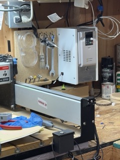

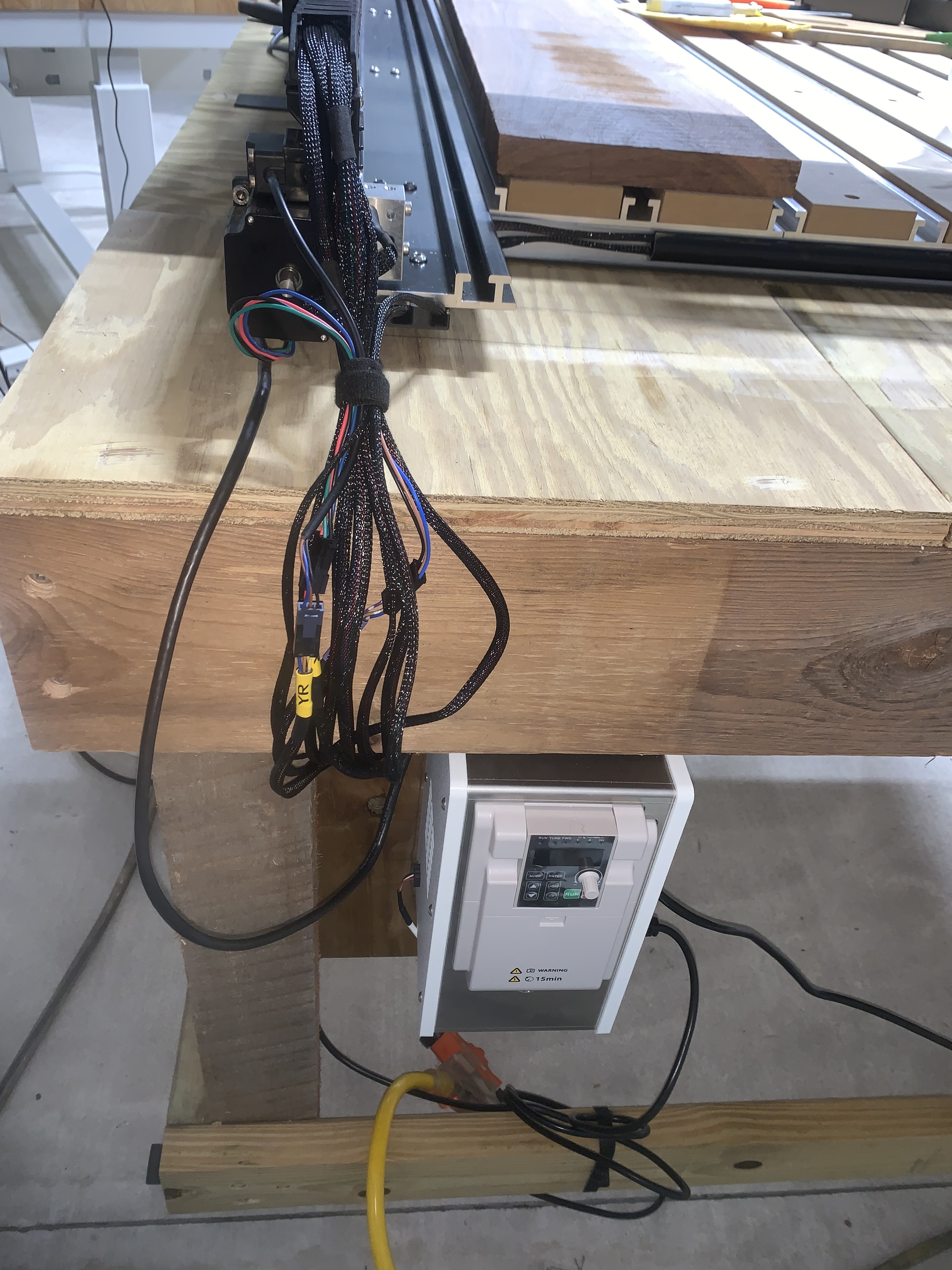

Does anyone have a picture of their 65mm VFD install? I am interested in seeing where the VFD unit is typically placed.

Usually folks bolt the box to the side of the table — mirror image of what I show for my electronics at:
Sorry, I misread the post. The VFD box is located at the back of my table close to the C3D controller. This will be moved up to the front left of the table once it goes into the wood shop. Hope this helps.
Thanks for that. Do you typically need access to the vfd control box or is it usually a turn it on and forget it type operation?

I mounted mine up high next to my S3. I can get to the Disable and power buttons easily from there and the VFD has air flow on all sides except the back.
Mine is underneath the back left side of the table and reaching under to turn it off was a pain. I have it on a dedicated circuit and the breaker is easier to reach so I flip that instead.
Mine has the “control” panel extendable with a cable. So I have that mounted to the front of the table. I really never do anything with it, but seeing the speed on there is nice.
