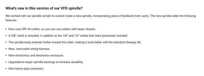

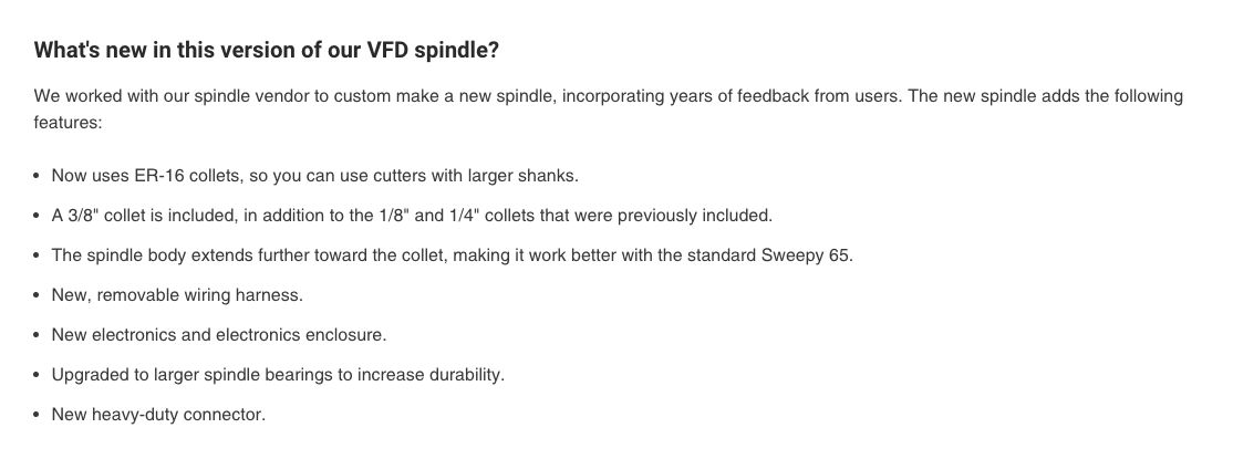

65mm from us now features access to 3/8" tooling. This will open a world of more rigid cutters to speed up projects.
1/2" tooling with the 80mm system is also truly enjoyable. But that does come with the chiller system and 220v requirements.
This is the first reference to a 3/8" collet on the 65 mm spindle.
Is anyone doing this ?
Just us. 65mm VFD Spindle Kit - 110V - Carbide 3D
Those are great updates!! When were those added? I didn’t see a blog post about it or anything.
I ordered my 4 pro last month or so and received the new spindle. It was quite a surprise!!
Do you have a link to the 3/8 collet ?
I just checked Maritool, they do not list a 3/8 collet .
Or you could just send me one :upside_down_face: for my older 65mm spindle
Edit: I now see you have changed the 65 mm spindle and controller box. The spindle now has a ER16 collet. Idk if the controller guts are the same.
@dakyleman That’s Top Secret Information. Consider yourself on Double Secret Probation…
Is there a spindle only trade in or price ?
Does the controller have to be replaced ?
Will the upgraded ER16 Spindle work with the older VFD?
Nice updates! 3/8" tooling is so nice to use and broader Sweepy compatibility is great!
I have been using a 5/16” and 8mm ER-11 collet/nut from Maritime, makes a difference for sure. There is just enough room inside the spindle (purchased Nov 2024) for these bits to clear the top of the collet by 3/16” if I remember correctly.
