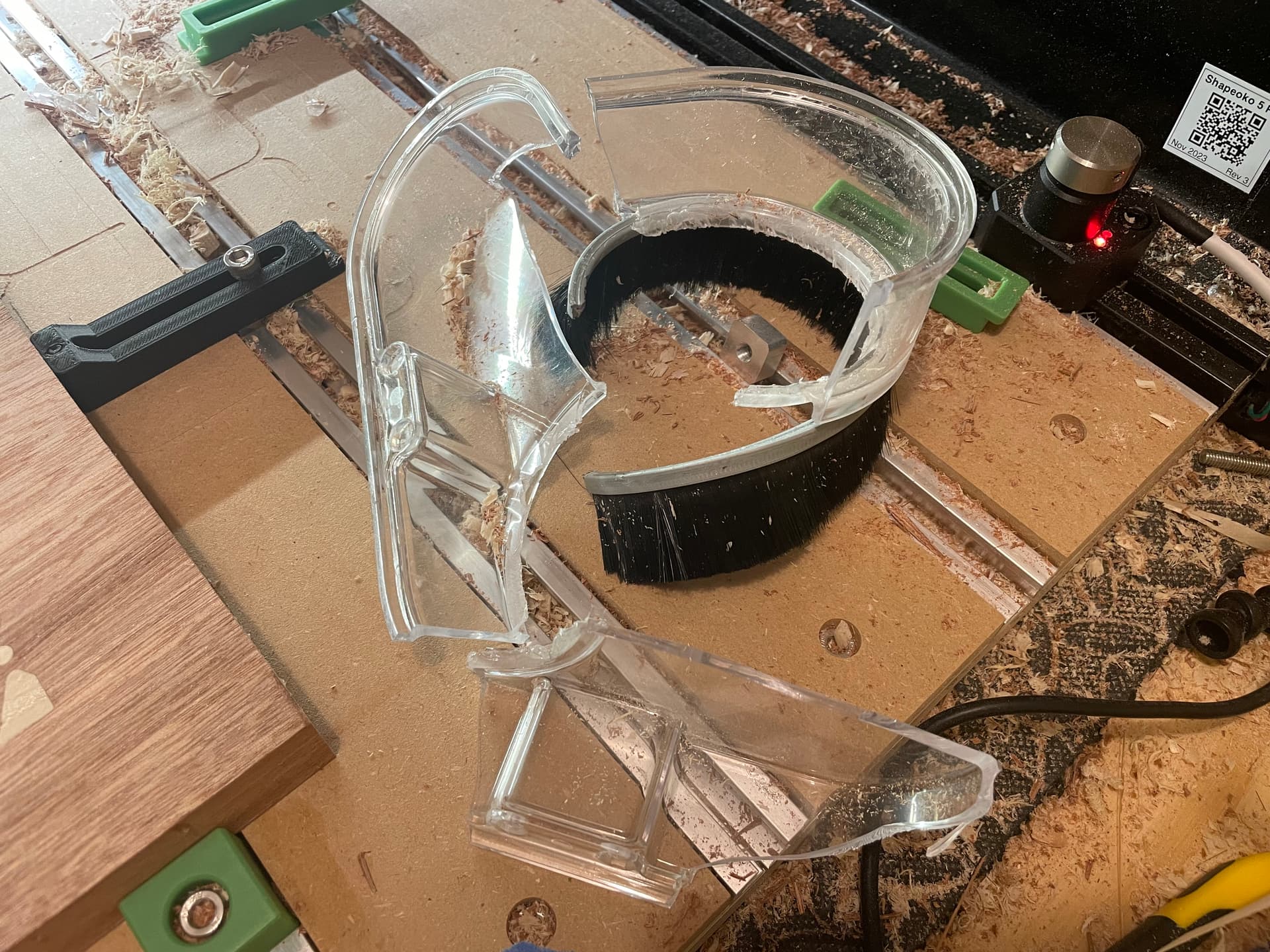

My shapeoko 5 annihilated my bristled sweepy used with my 80mm Carbide3D water-cooled spindle. I pressed pause to sort a hose blockage and the dust boot came loose. Your machine doesn’t stop the endmill when paused so it’s obliterated the dustboot.

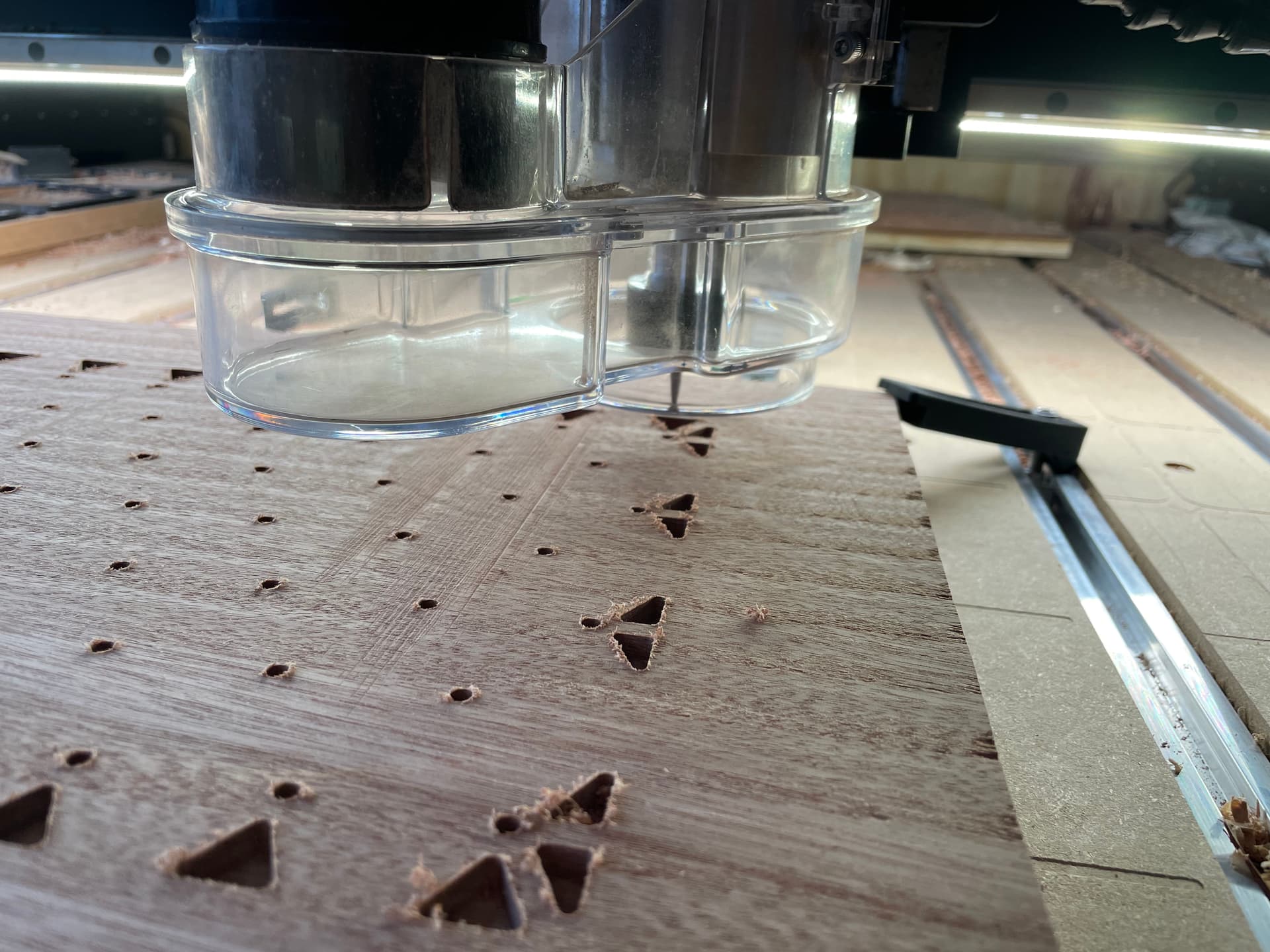

To illustrate the deeper nature of the sweepy i have compared to the product listing images in the kit link provided by the saleperson:

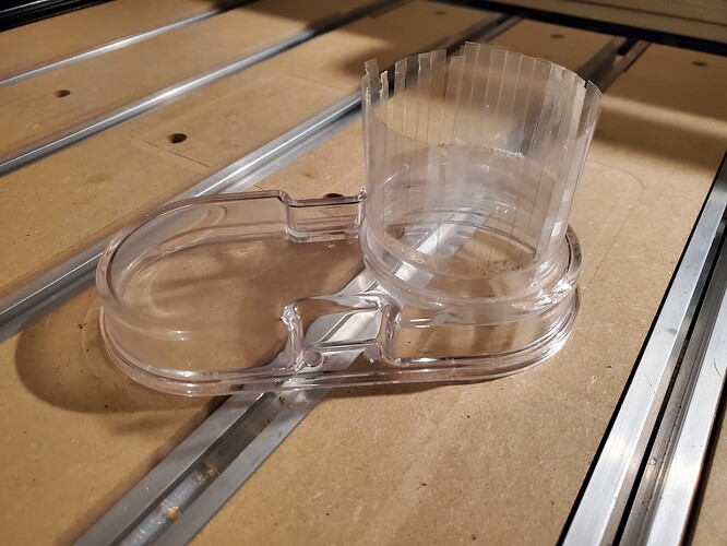

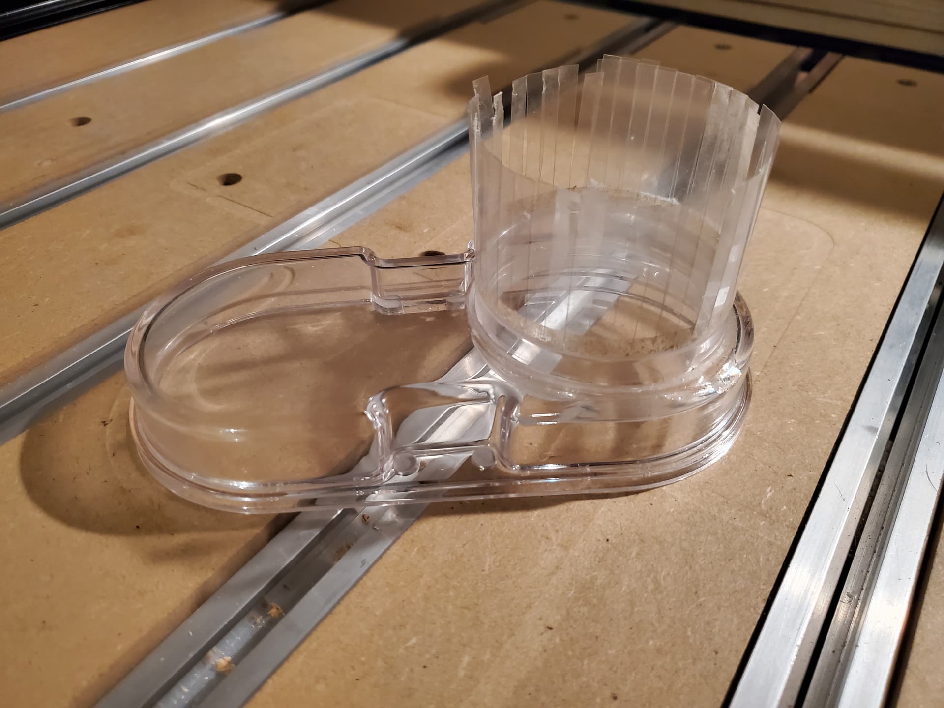

Have you considered modifying your “Winston” (as we call the brushless bottoms) to mount the brushes on? I did that a while back for one of mine using a round plastic storage case:

@tobwhy , those breaks look pretty clean without a lot of “chewing”. I’d be inclined to try to solvent-bond it back together. Here in the US the good wicking solvent is Weld-On 3, and I’m sure you have something equivalent in the UK. Or present it as a challenge to a local plastic model kit builder! :slight_smile: You have nothing to lose with those pieces at this point…
@tobwhy, to add to what @Randy wrote - you could also use hot staples after solvent welding it to give it more strength where it needs it.
Or use a gel consistency plastic solvent and apply it on and through strips of stainless steel mesh over the seams to reinforce them.
