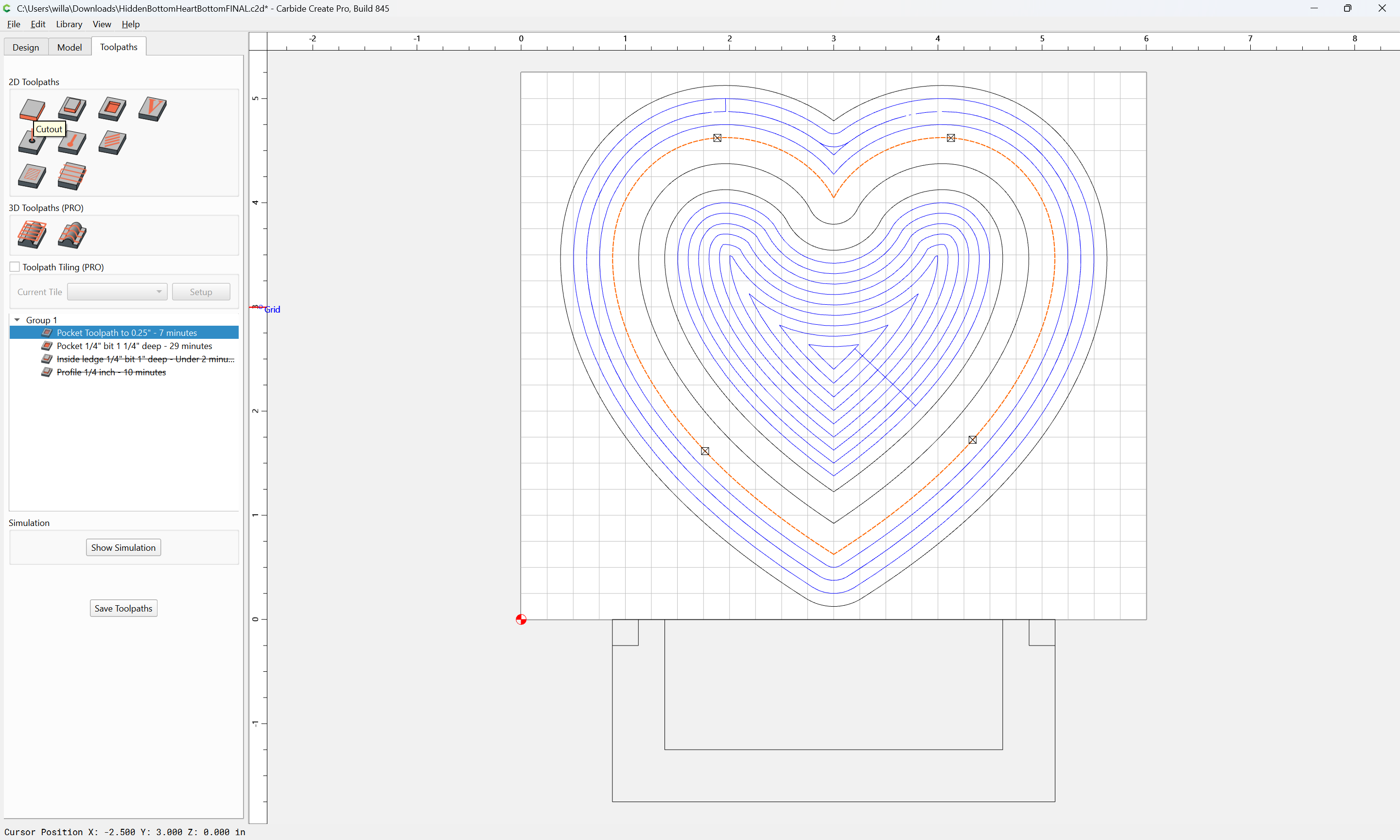

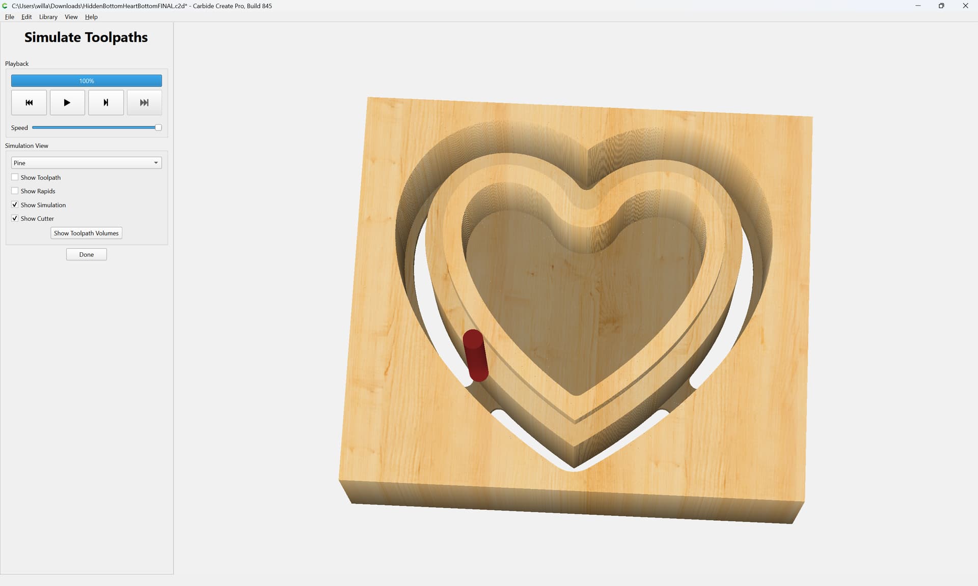

A box of 1 piece of stock, in 2 pieces, using 3 (or 4) pieces of geometry
as requested on support…

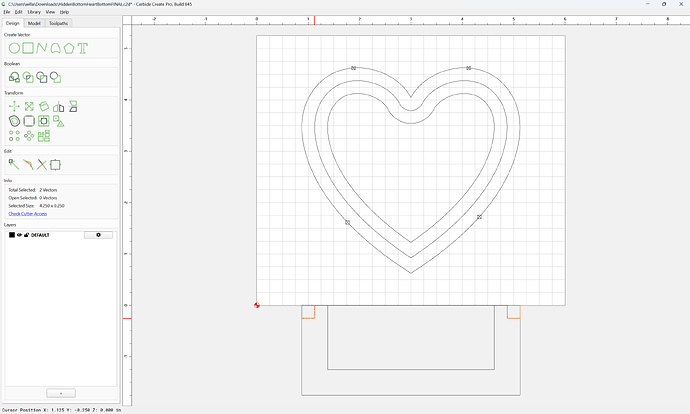

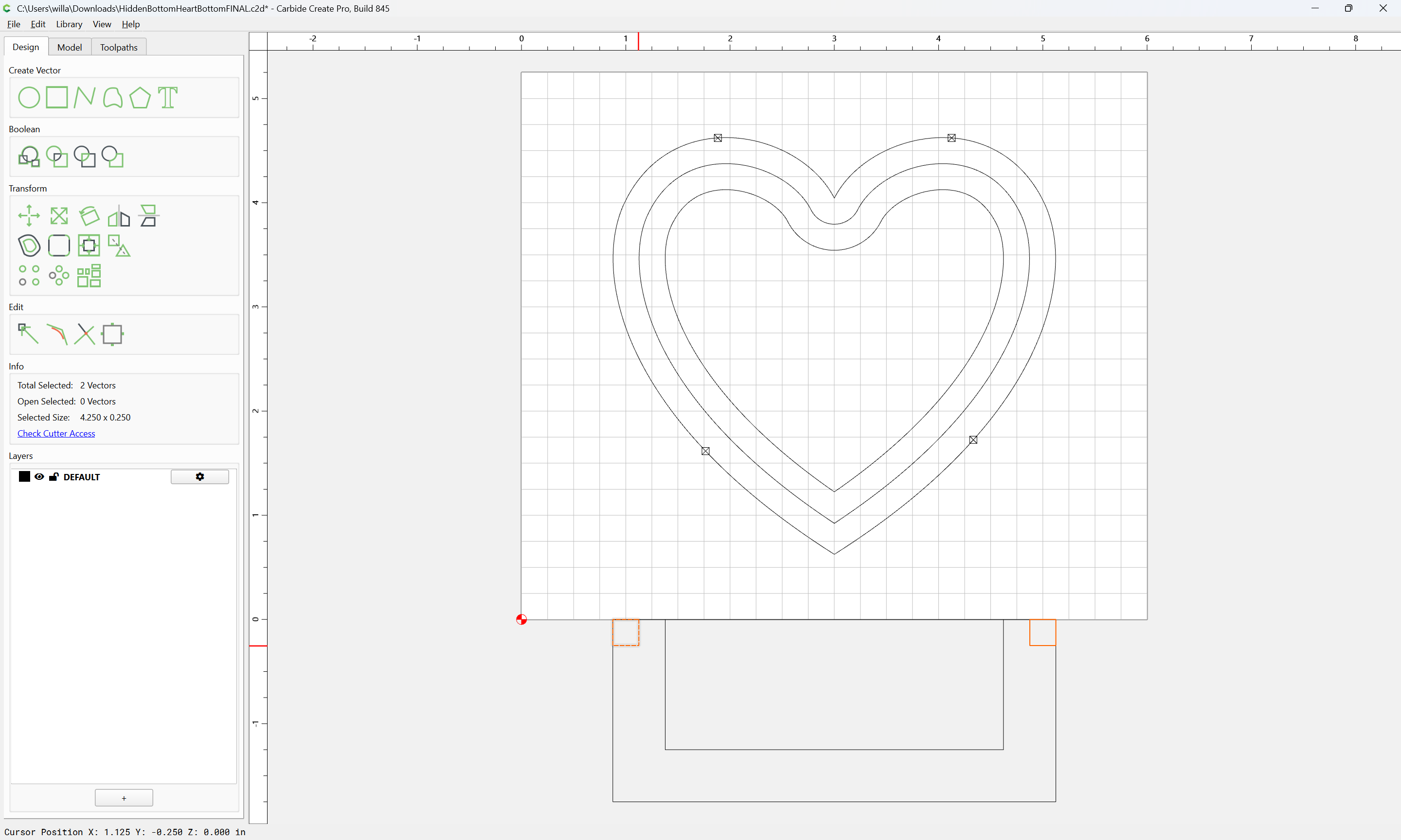

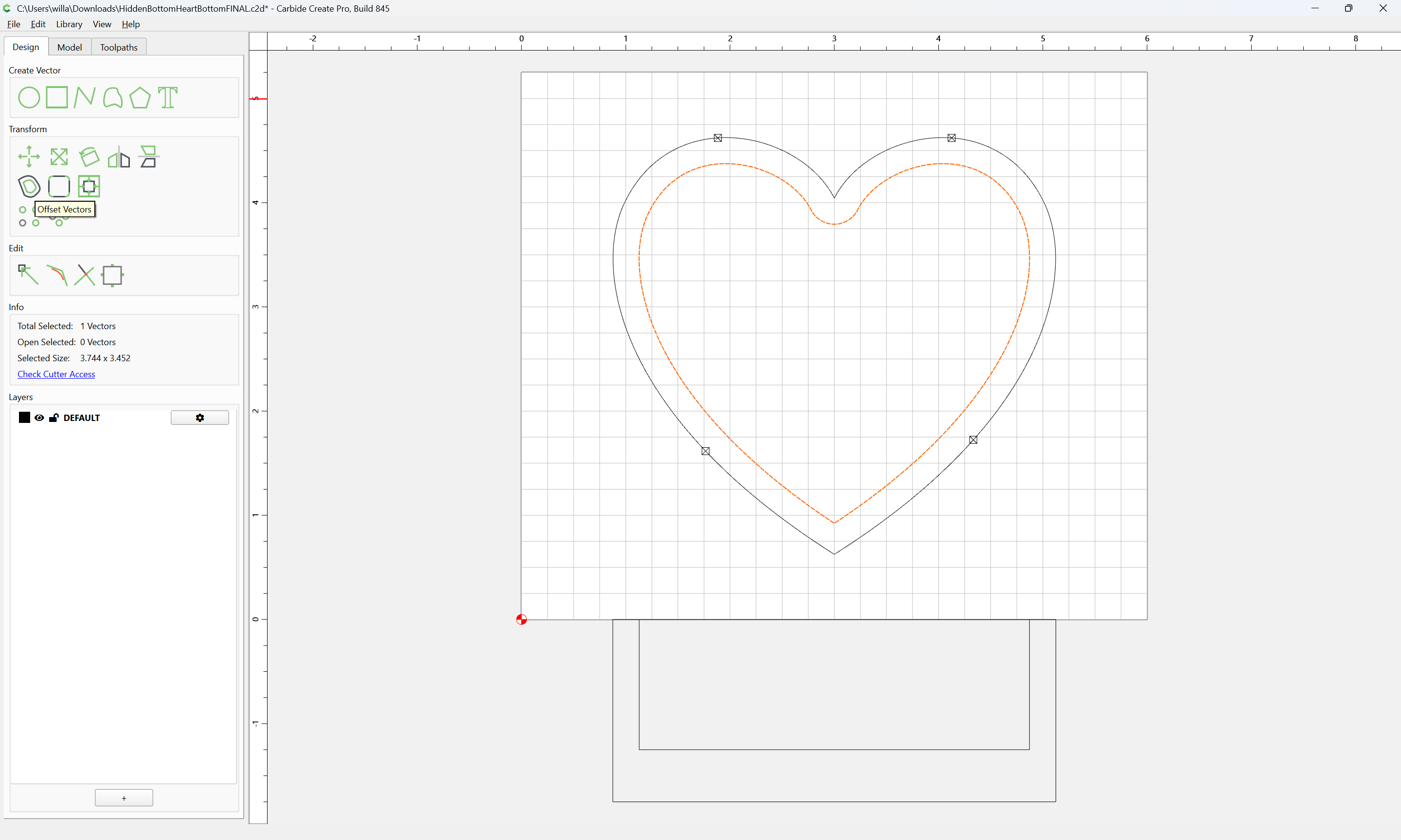

I’ve attached the code for a heart box I am making. I’m trying to make the lid that will sit down inside the heart on a ledge about 1/4" from the bottom.

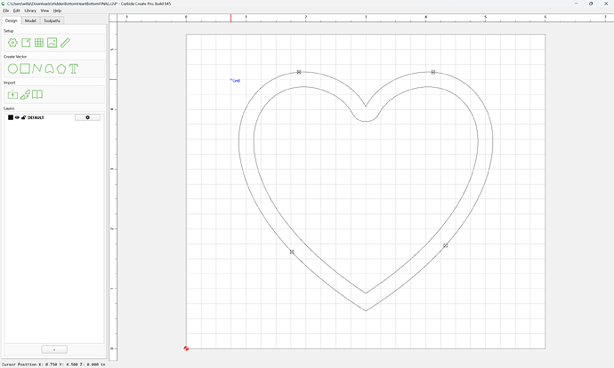

where the relevant geometry is:

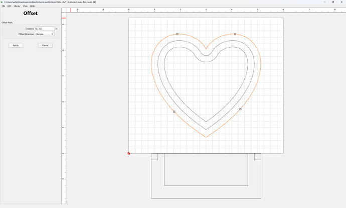

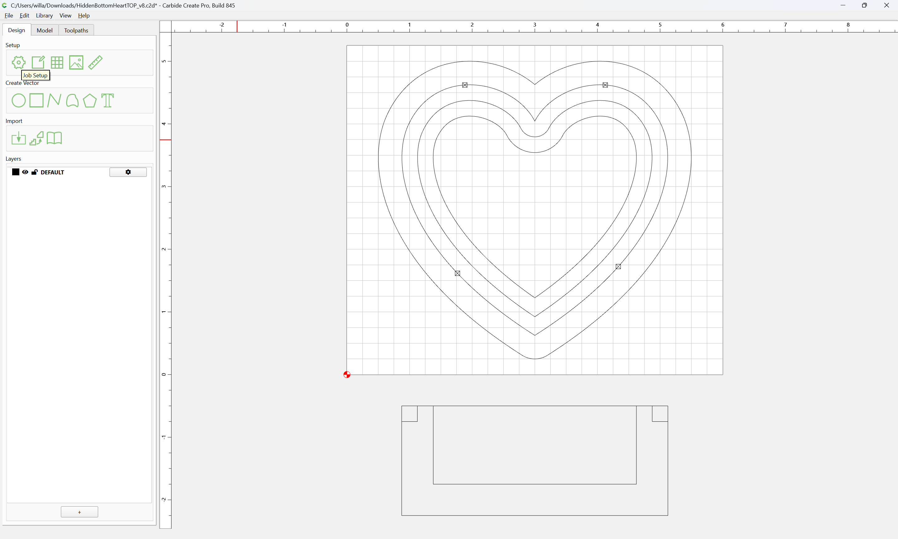

First thing to do is to draw up the current cut in profile:

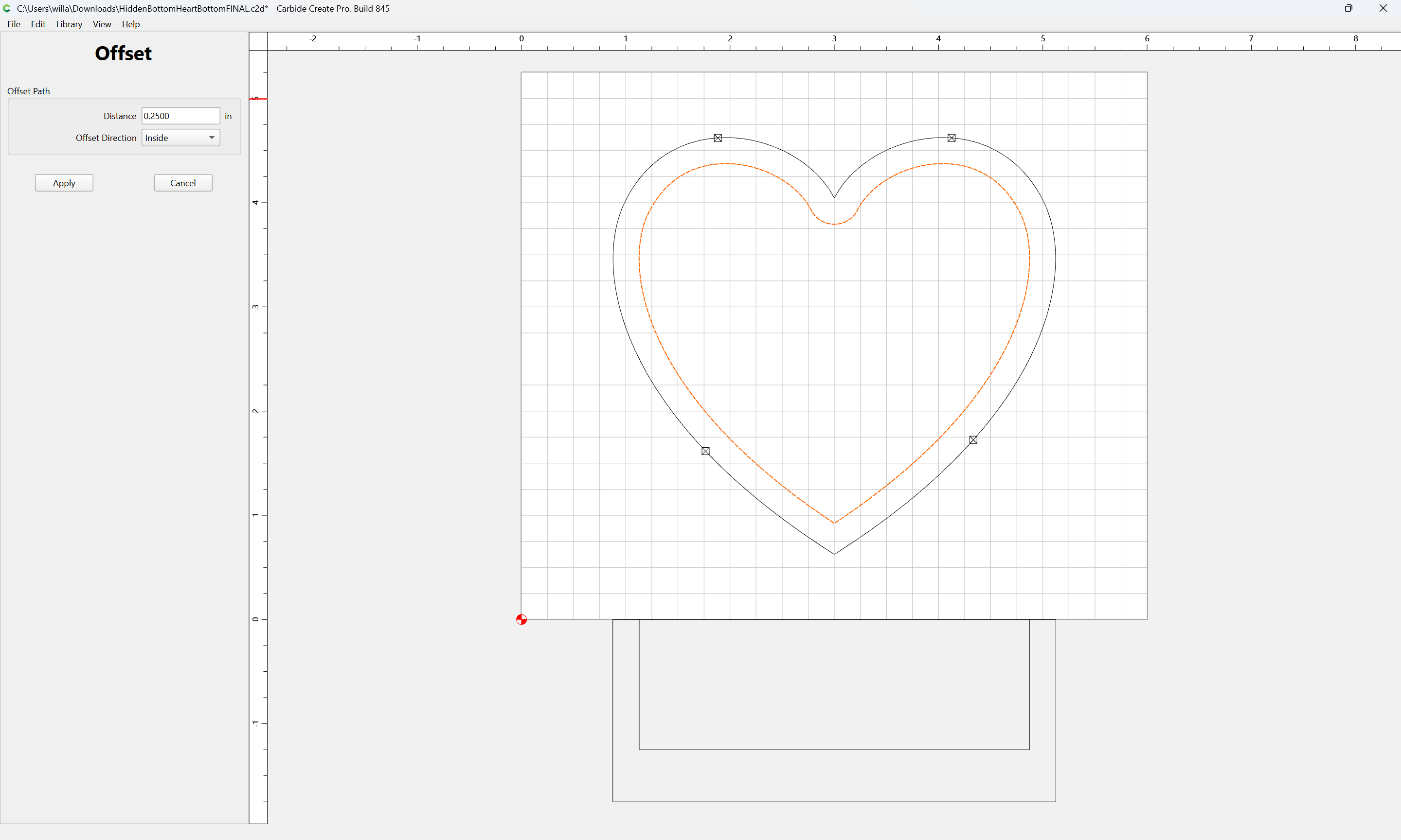

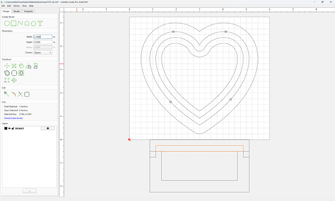

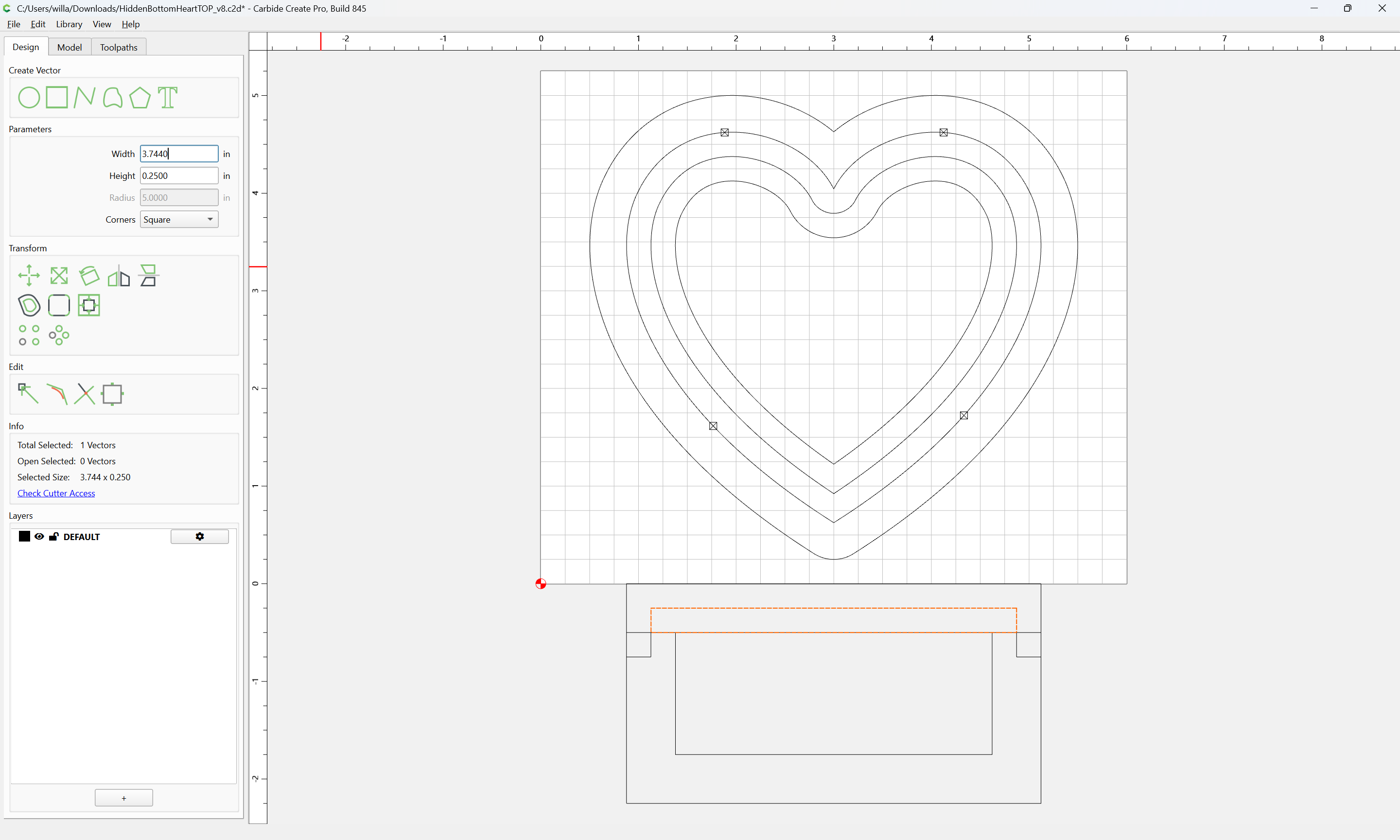

which leaves no ledge in the bottom, to add that, we inset by 0.25":

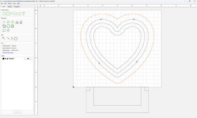

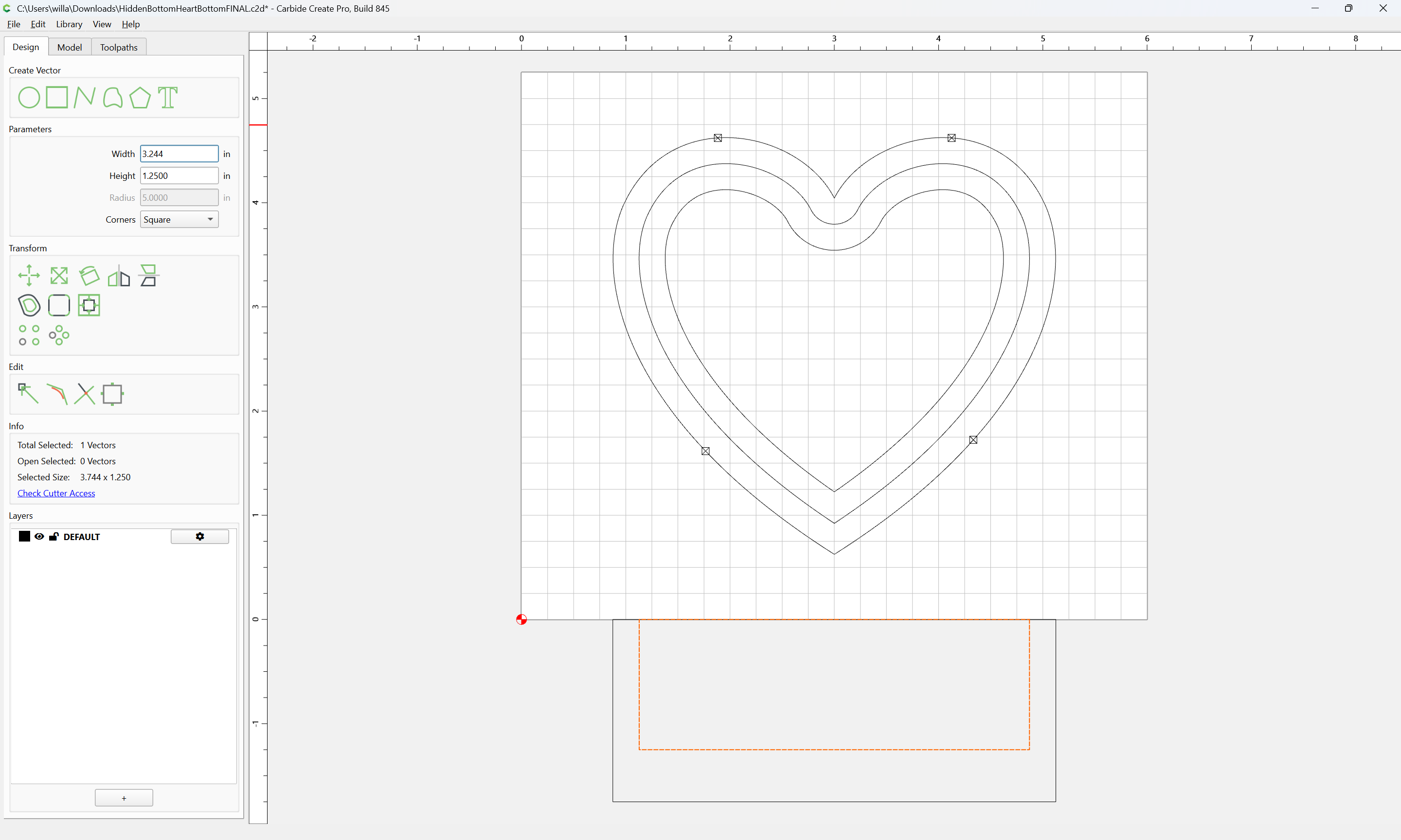

Apply

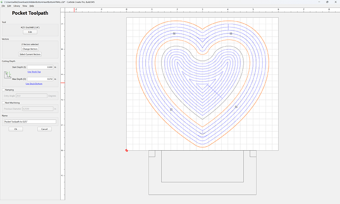

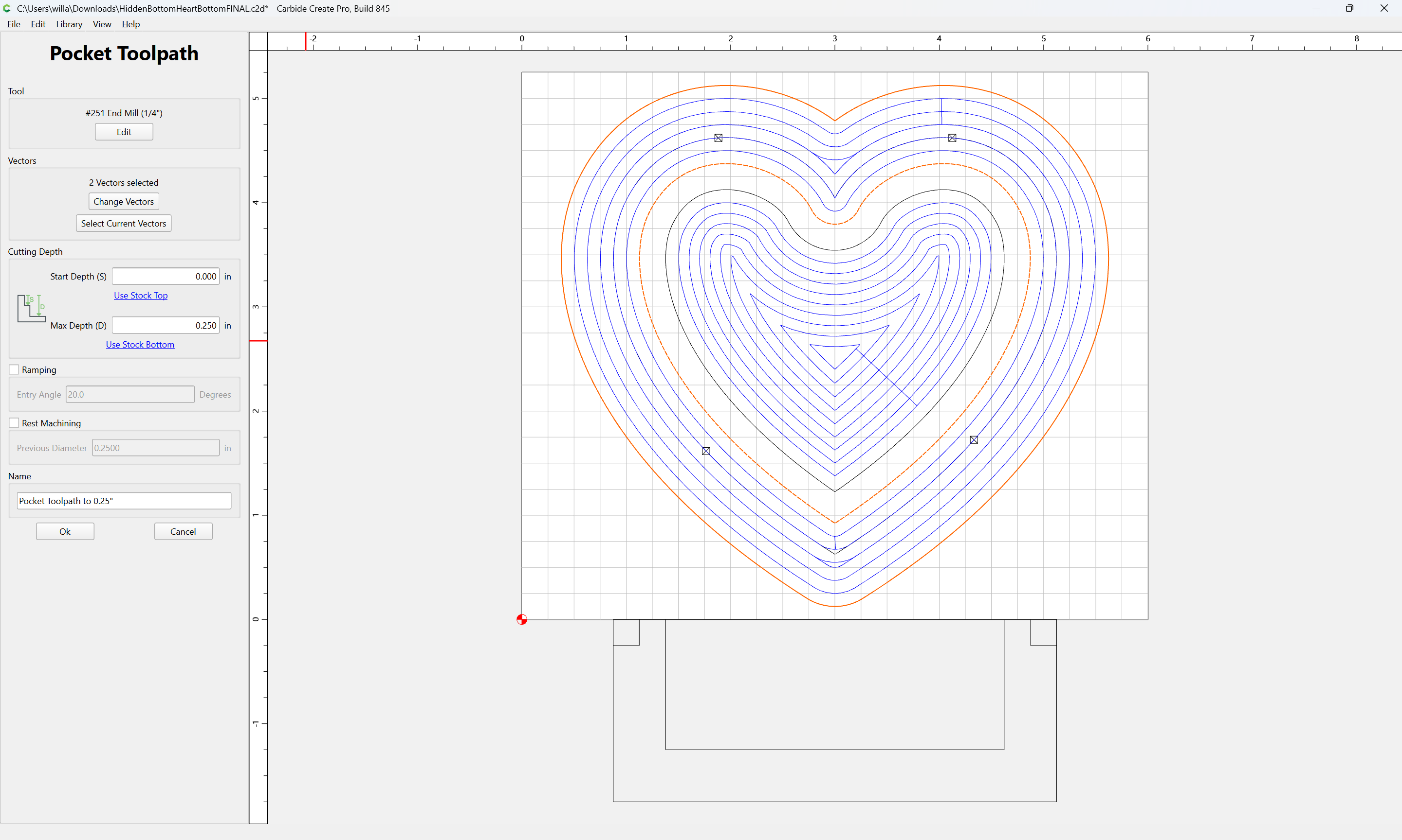

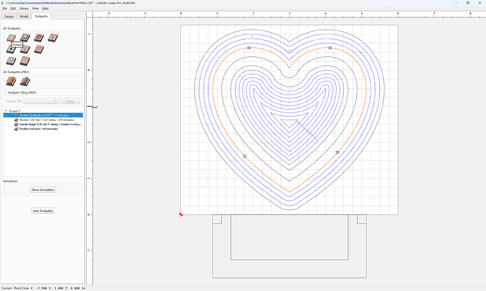

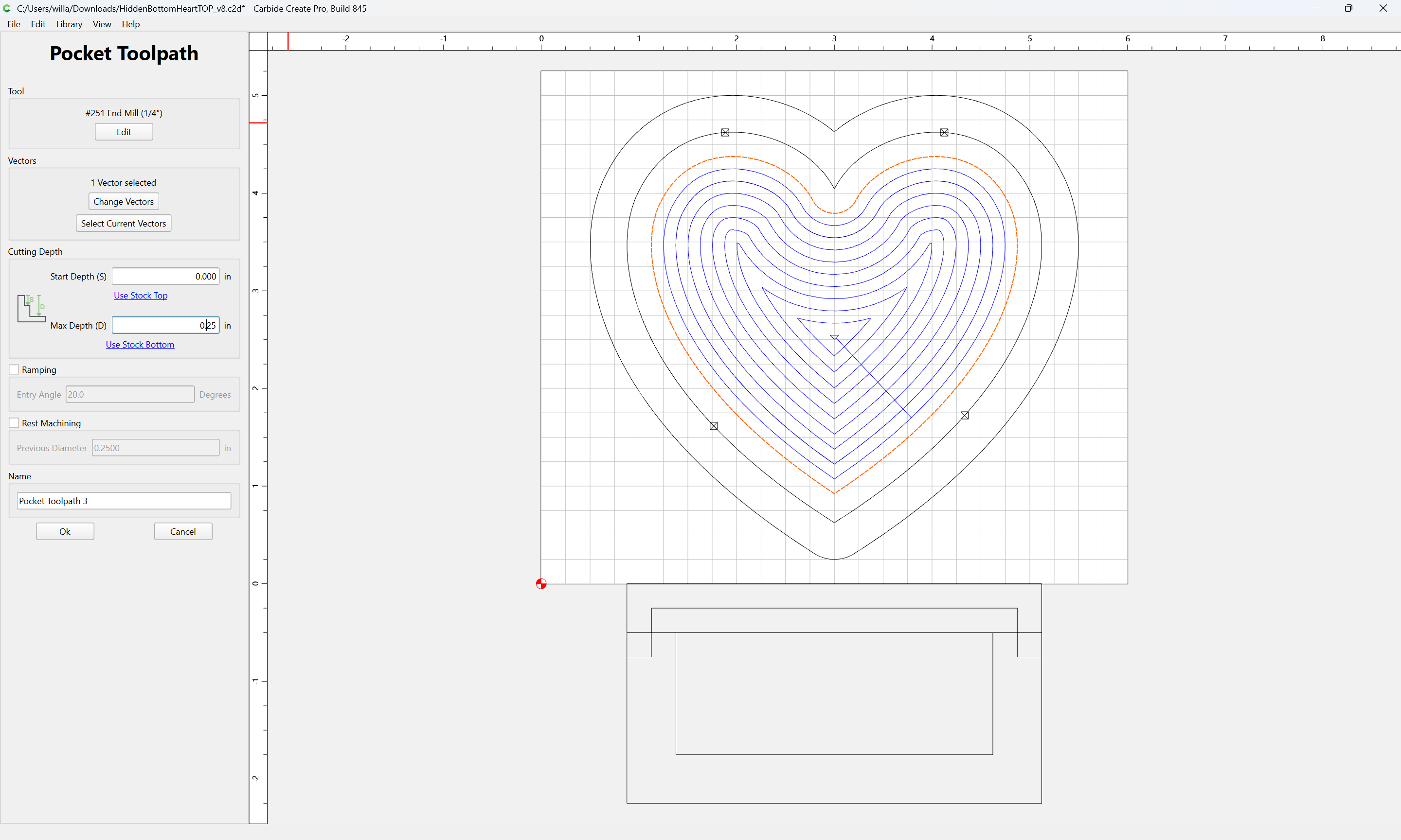

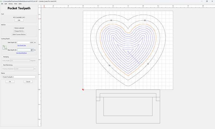

and transfer that width to the Pocket:

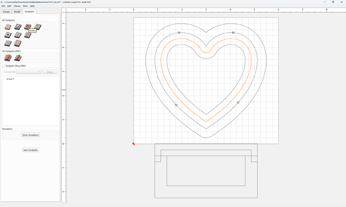

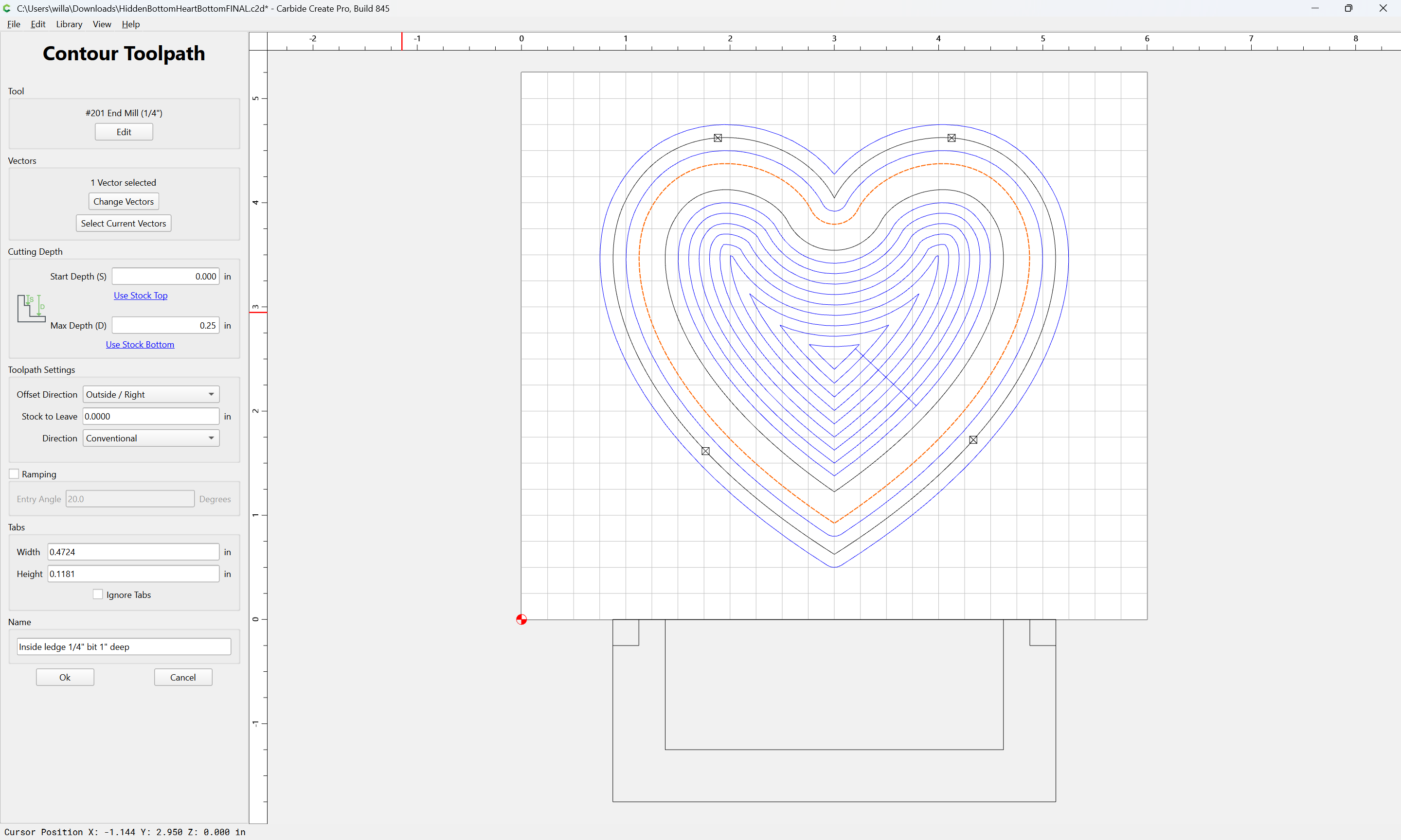

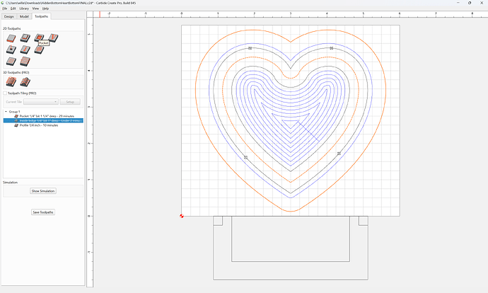

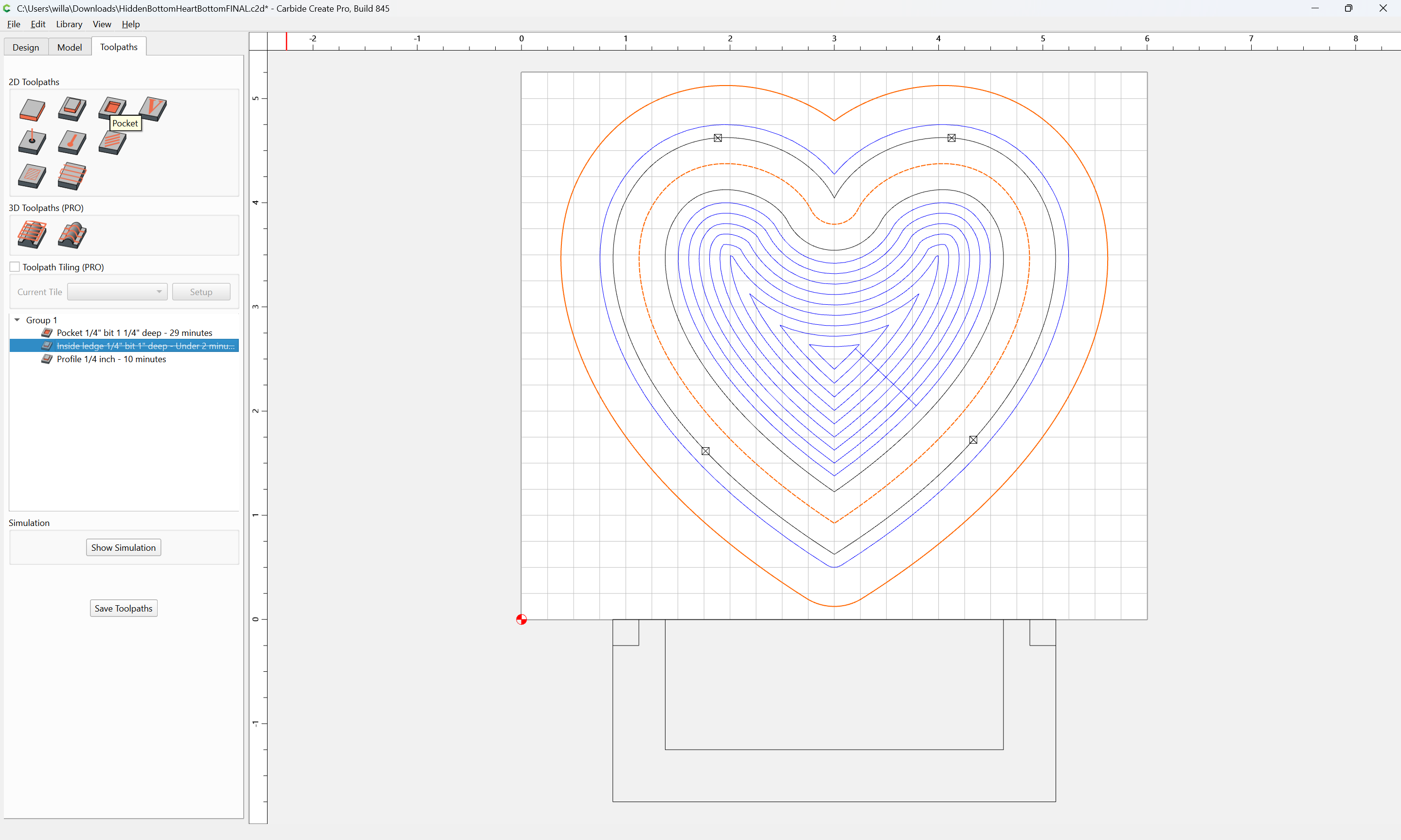

We then use the previous geometry to cut a pocket to a depth of 0.25" to create the ledge:

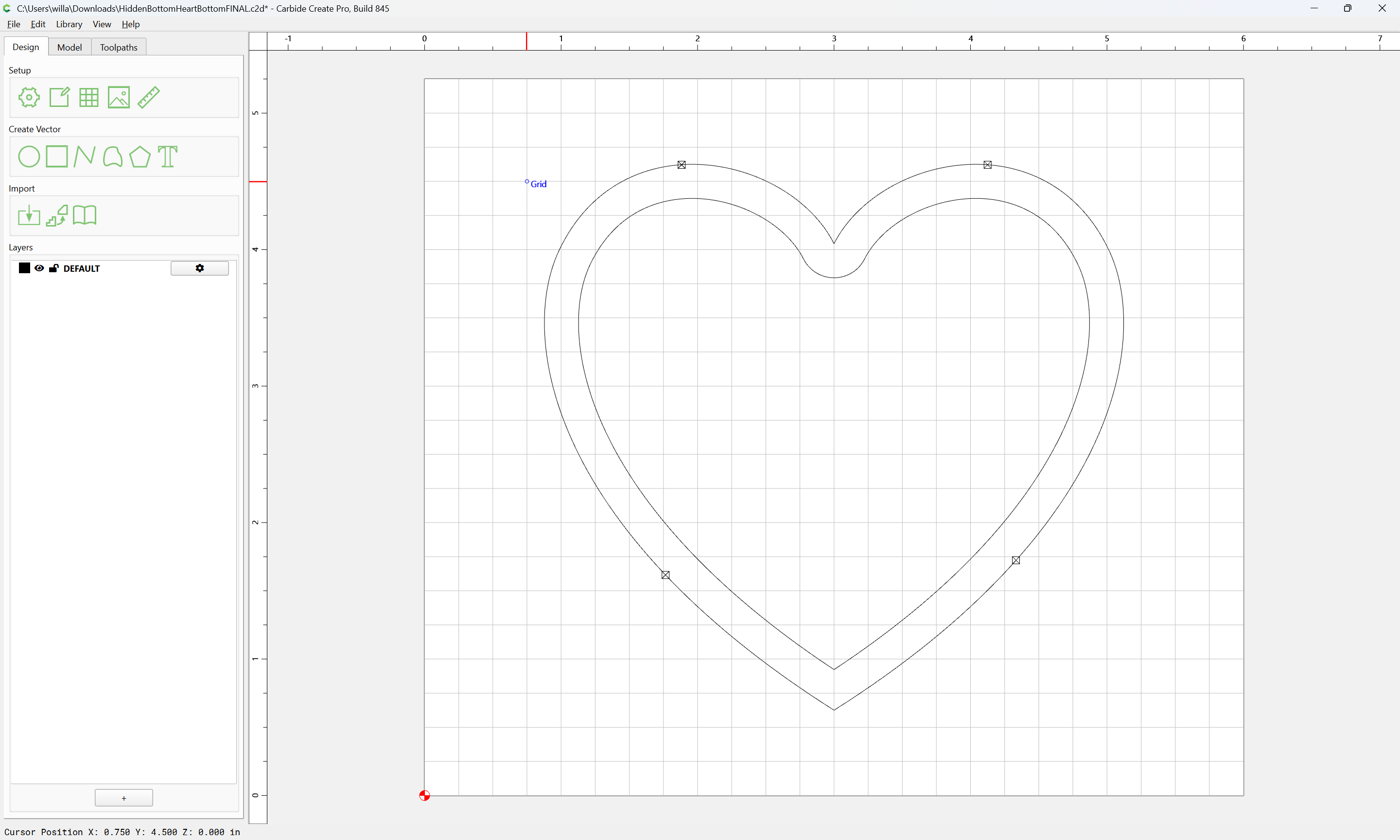

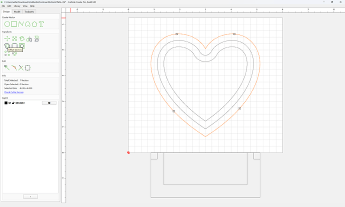

but this would probably be better/easier to visualize w/ a bit of offset geometry:
Apply

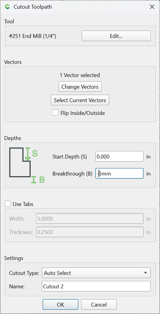

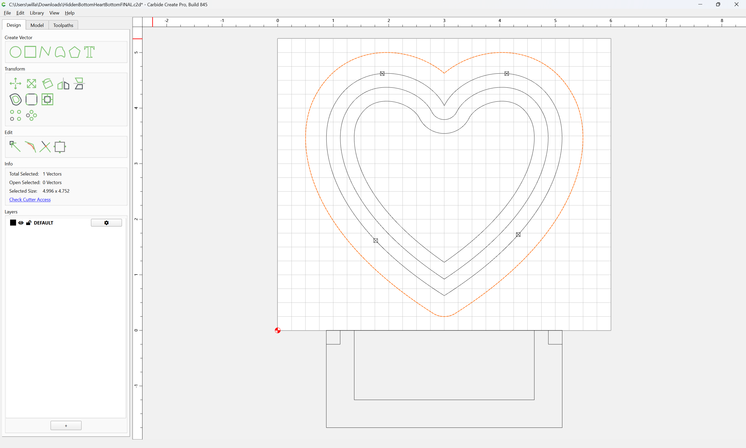

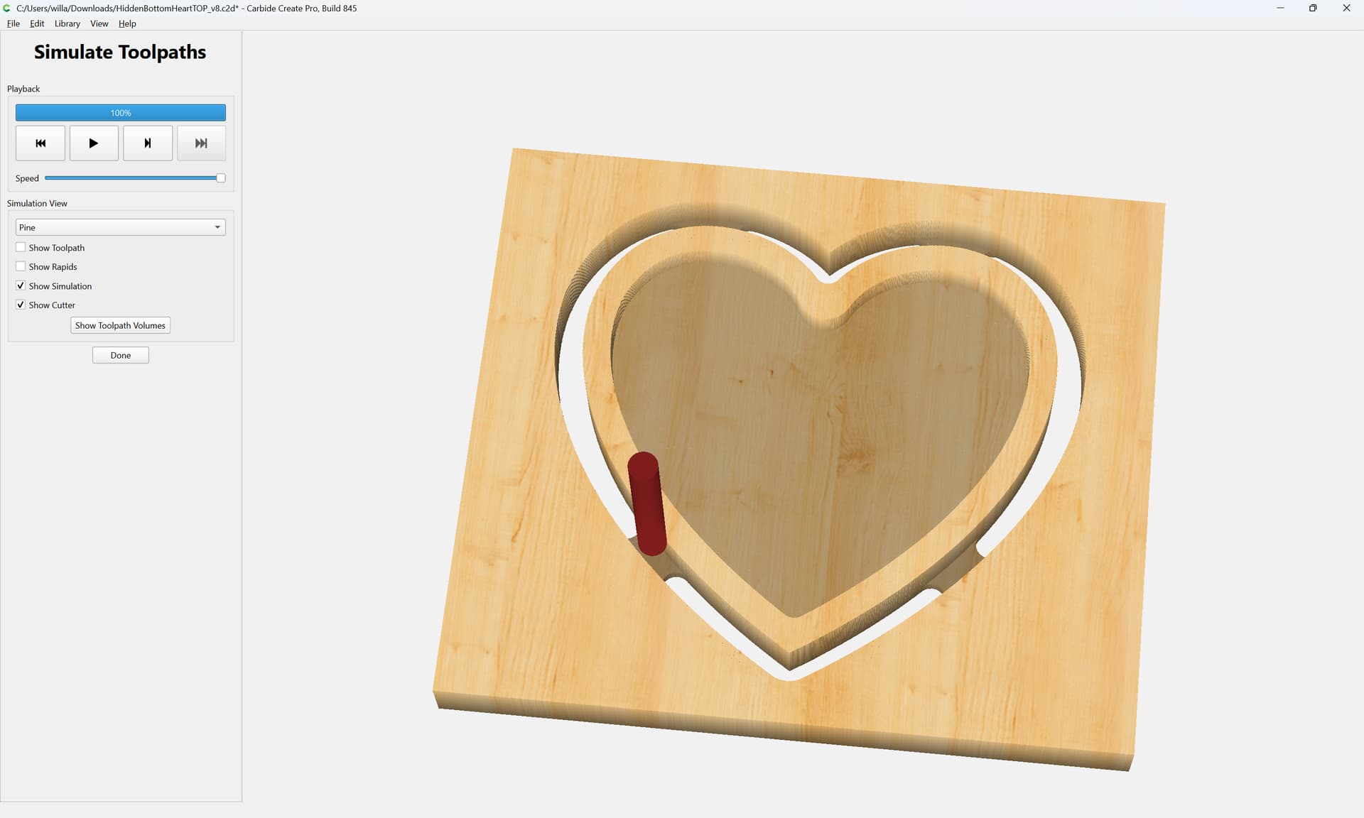

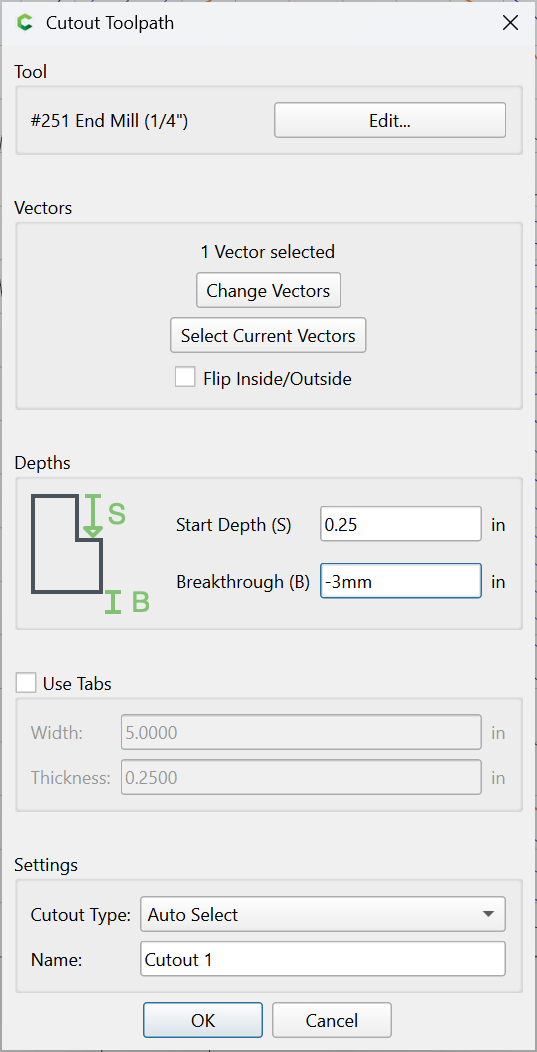

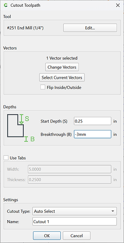

Note that the perimeter toolpath should be a Cutout:
which now previews as:

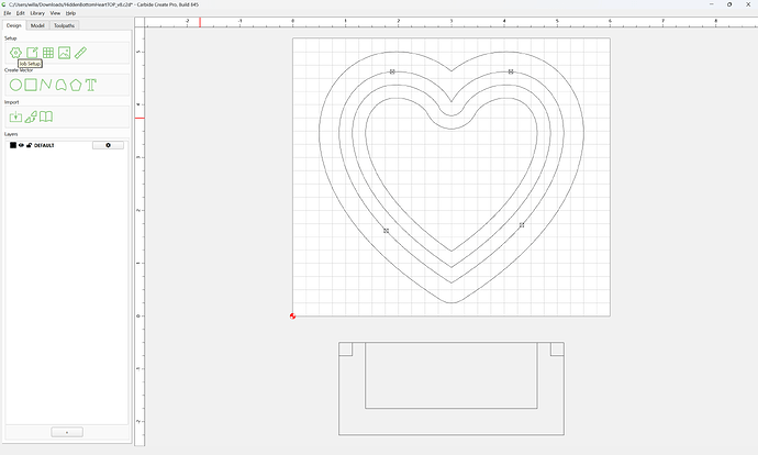

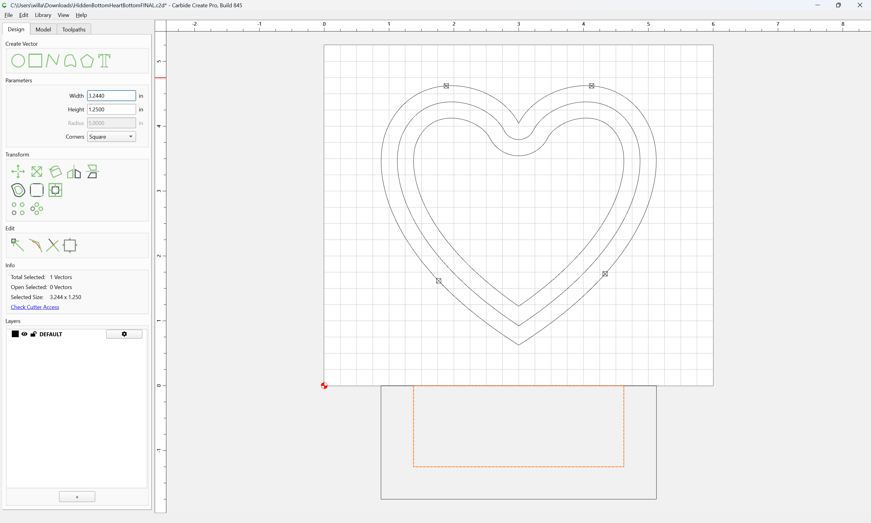

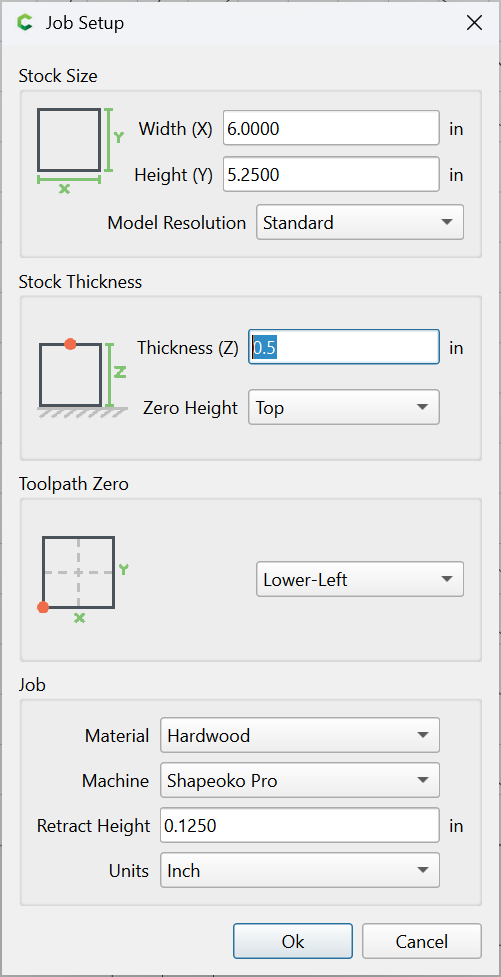

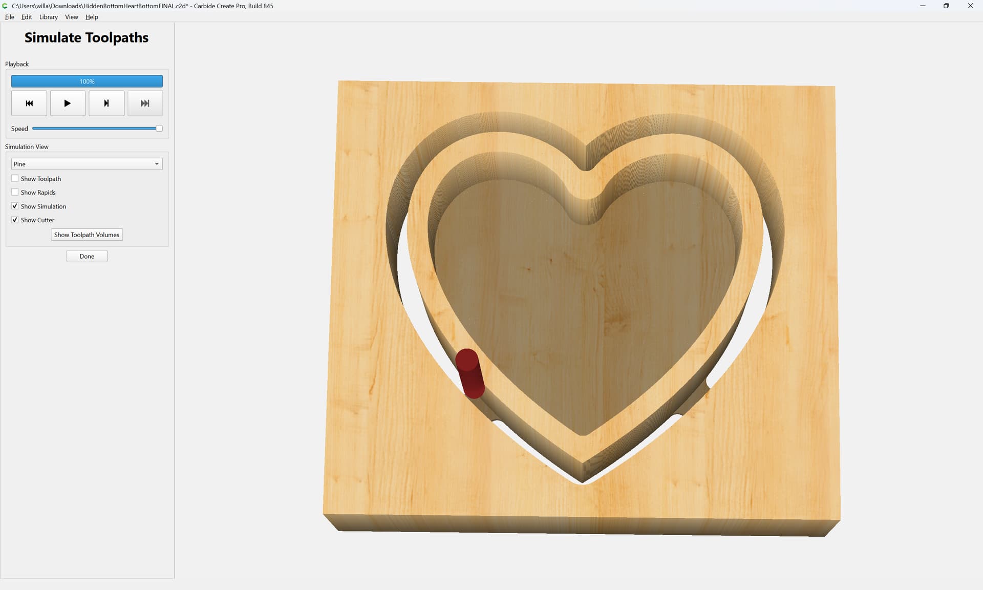

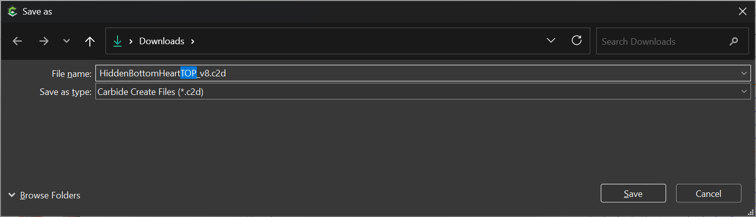

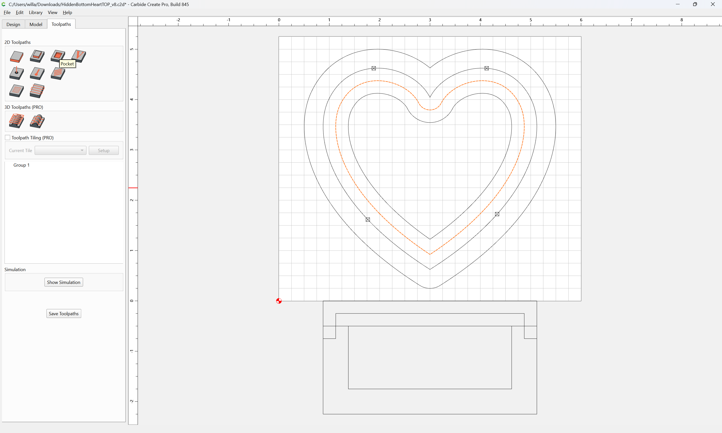

Making the lid simply requires a similar set of toolpaths, to a presumably thinner piece of stock. Since Carbide Create does not allow two different Stock Thicknesses in one file, we save and then File | Save As
delete all the toolpaths, go into Job Setup and set the desired thickness:

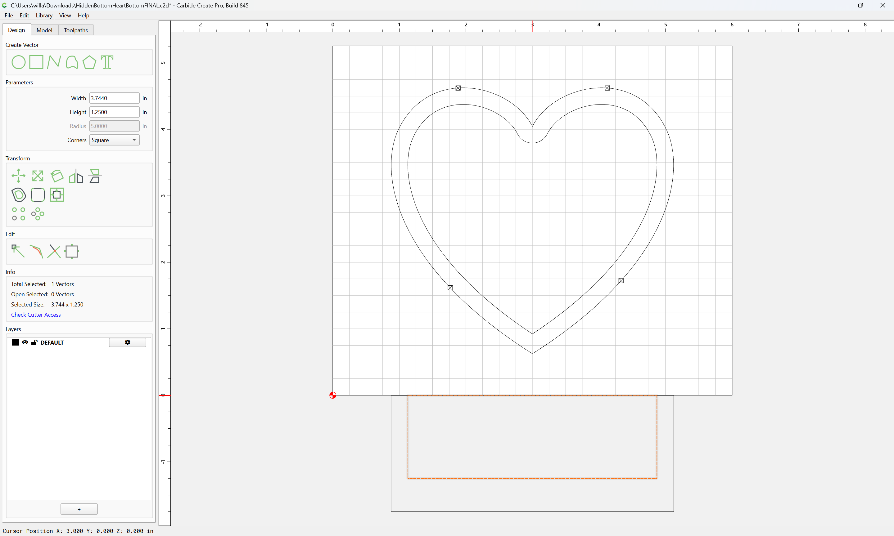

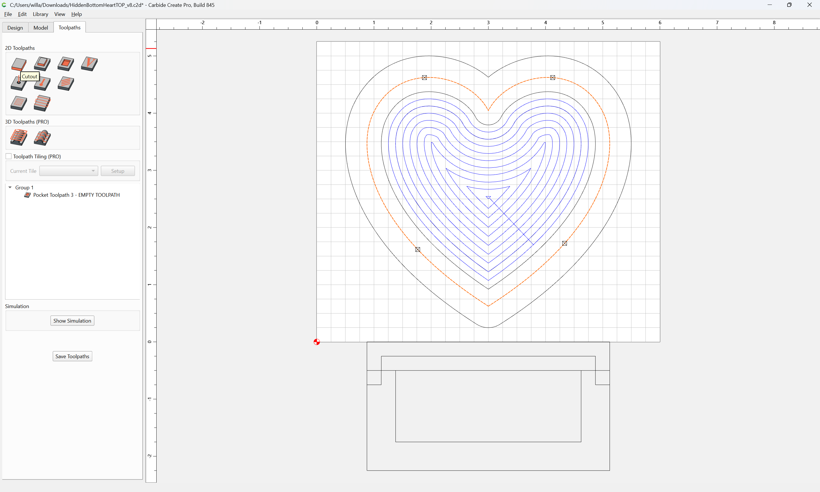

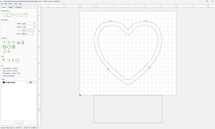

and then draw the desired profile for the lid

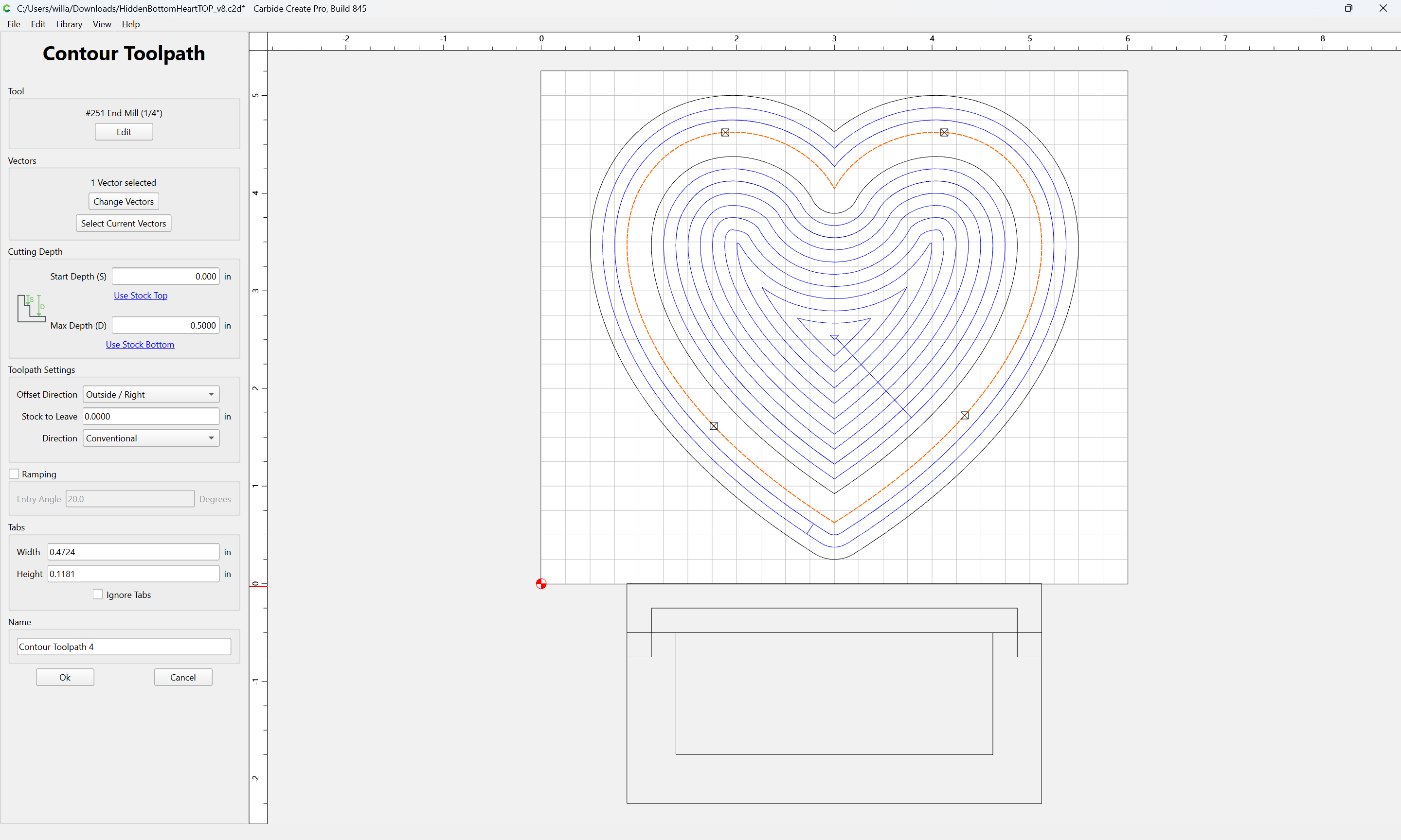

assigning a Pocket toolpath to the interior:

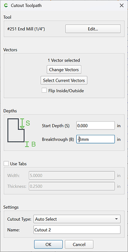

and a Cutout toolpath to the perimeter:

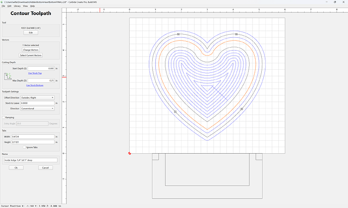

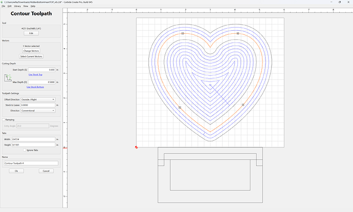

and then a final Contour to finish the cut:
