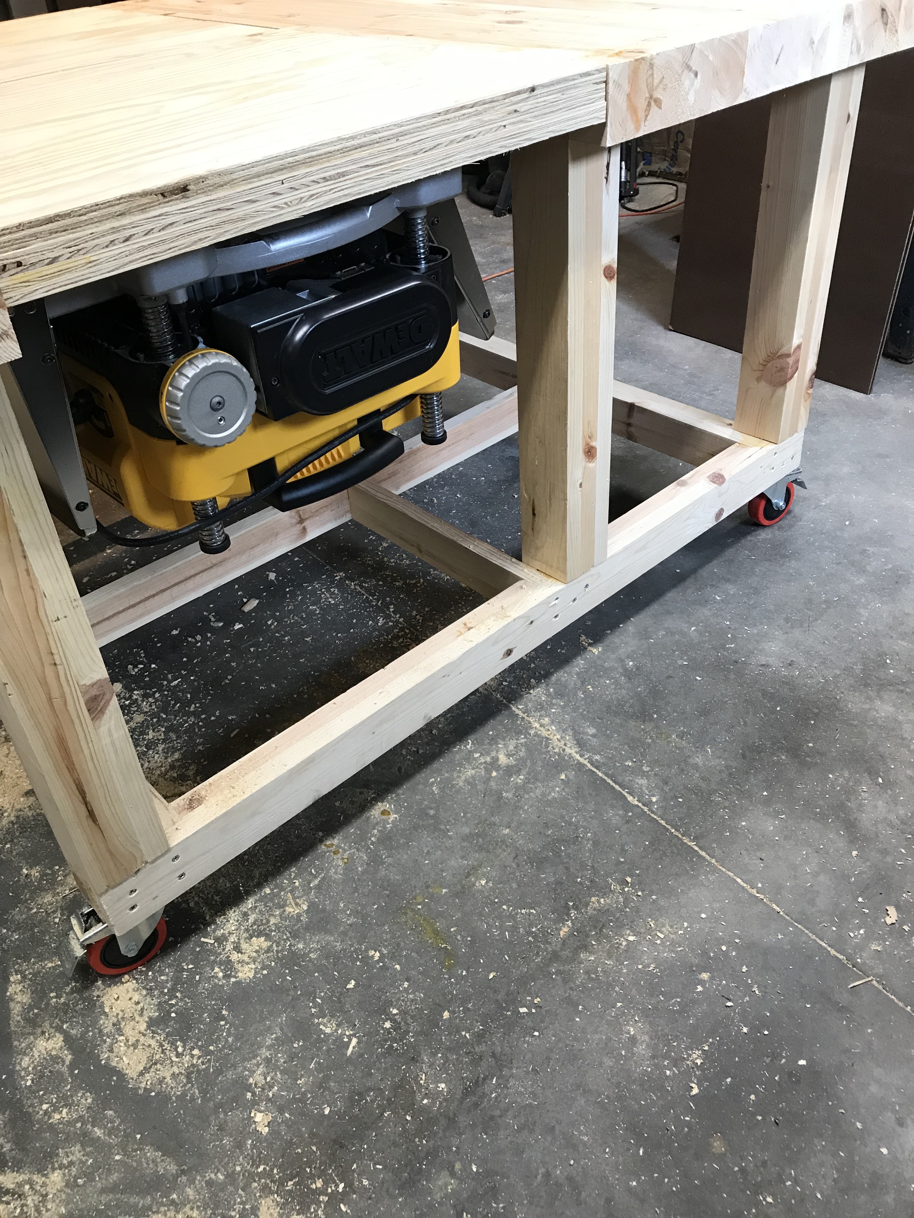

Thanks, this is some of the stuff I’ve been doing since I got mine this April. Have wanted to get a lot more done but I’ve had other things get priority (a new double flip top work bench to house my planer and scroll saw, and a new cabin loft bed for my youngest) but hopefully nothing else pops up so I can get some more practice in.
Again nice work. I have a pretty good size shop but have been those flip top type projects for years. I have the same Dewalt planner and it is heavy. So is the flipping of the planner hard to do or was you able to find the center of gravity to flip it.
Even though I have a large shop every tool in my shop is on wheels. It makes it much easier to move equipment around and clean. I used to have a regular 2 car garage so every thing was on wheels but bunched up and I would pull out what I needed to the center of the garage. So that made me play musical chairs with my equipment. Even though I have a larger shop now my equipment is still bunched up on one end and I roll the piece I need out and work with it then push it back to the coral.
Sorry took me so long to reply tried to last night and it said I had reached my limit of replies for being a new member and had to wait 20 hours.
The planer is definitely heavy, it isn’t too bad flipping it since the middle of the planer sits center of where the rod runs. It still takes a bit of muscle to turn it over but better than hauling it off the floor or shelf every time I need it. I don’t have a whole lot of room currently since I only have a 30’x24’ garage that needs to house at least 1 car and with winter coming fairly soon I would like to get my other car in the garage also (Fargo winters are hell)and my various wood working/hobby tools and various mechanic tools taking up space. That’s the main reason I did this bench and I have been looking at various ideas for adding supports for holding my table saw on the end of this one also when I need it kind of like the Paulk work bench has so that the bench is a good sized outfeed table.
I have the same planer and the weight is definitely and issue. I have made room for it under a cabinet and I’m planning on building a scissor lift table to bring it to the level of my tablesaw when I need to use it. I dread having to lift it so this will address the issue as I don’t have floor space in my shop for more flat surfaces.
Did you make up your own plans for the flip top or find some online? I have the same planer and was looking at doing something similar for that and my sander.
I used these plans https://www.gunflintdesigns.com/fliptop-workbench-part1
They are $15 but very detailed. I will mention if you follow that plan that on the cut list pay attention to the cuts for the backboard they were wrong on the cut list and I didn’t notice until I went to put it together. He also has some YouTube videos where he walks through some of the major things to help out.
