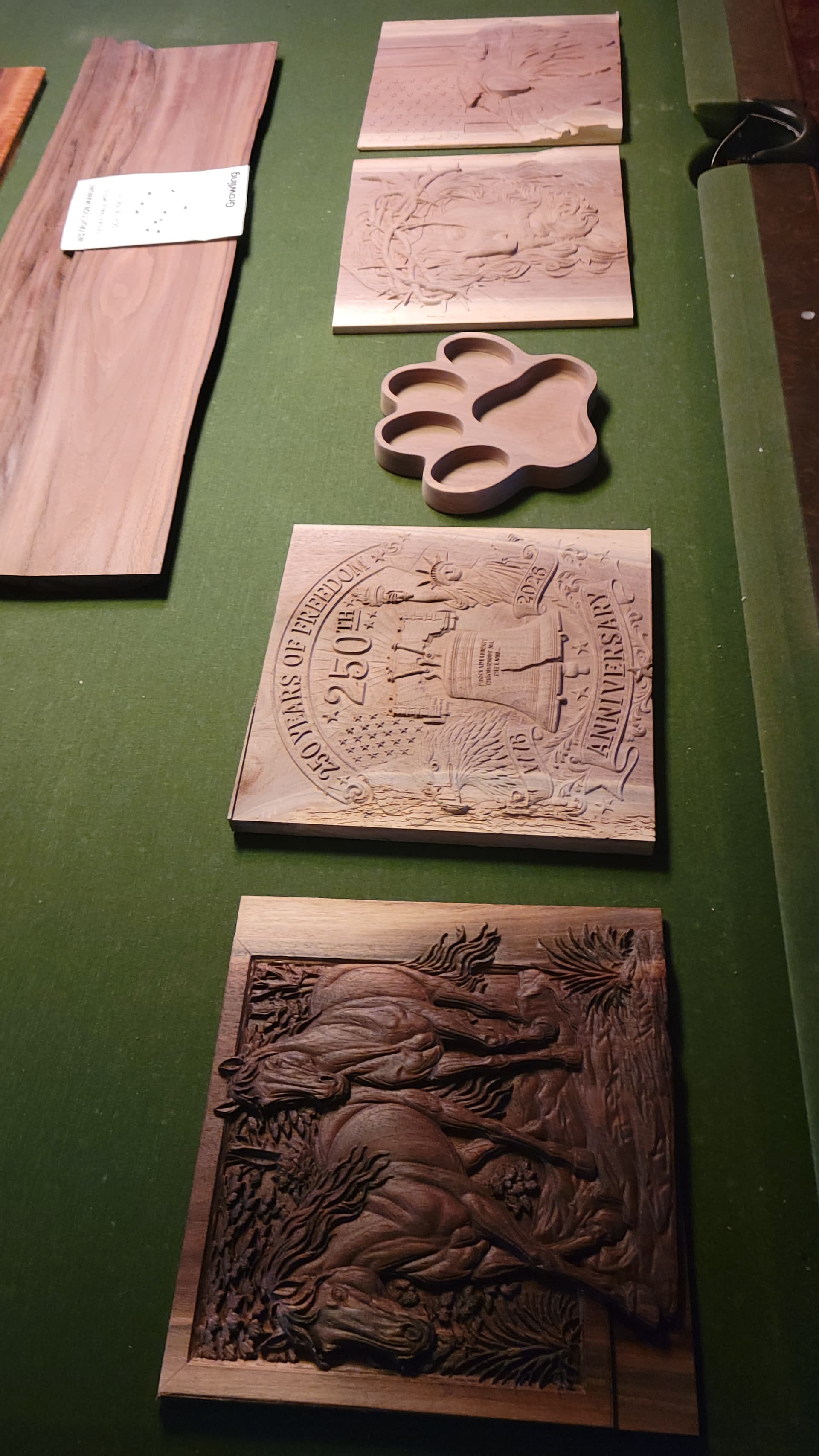

A few 3D projects on my Shapeoko 5.1 4x4

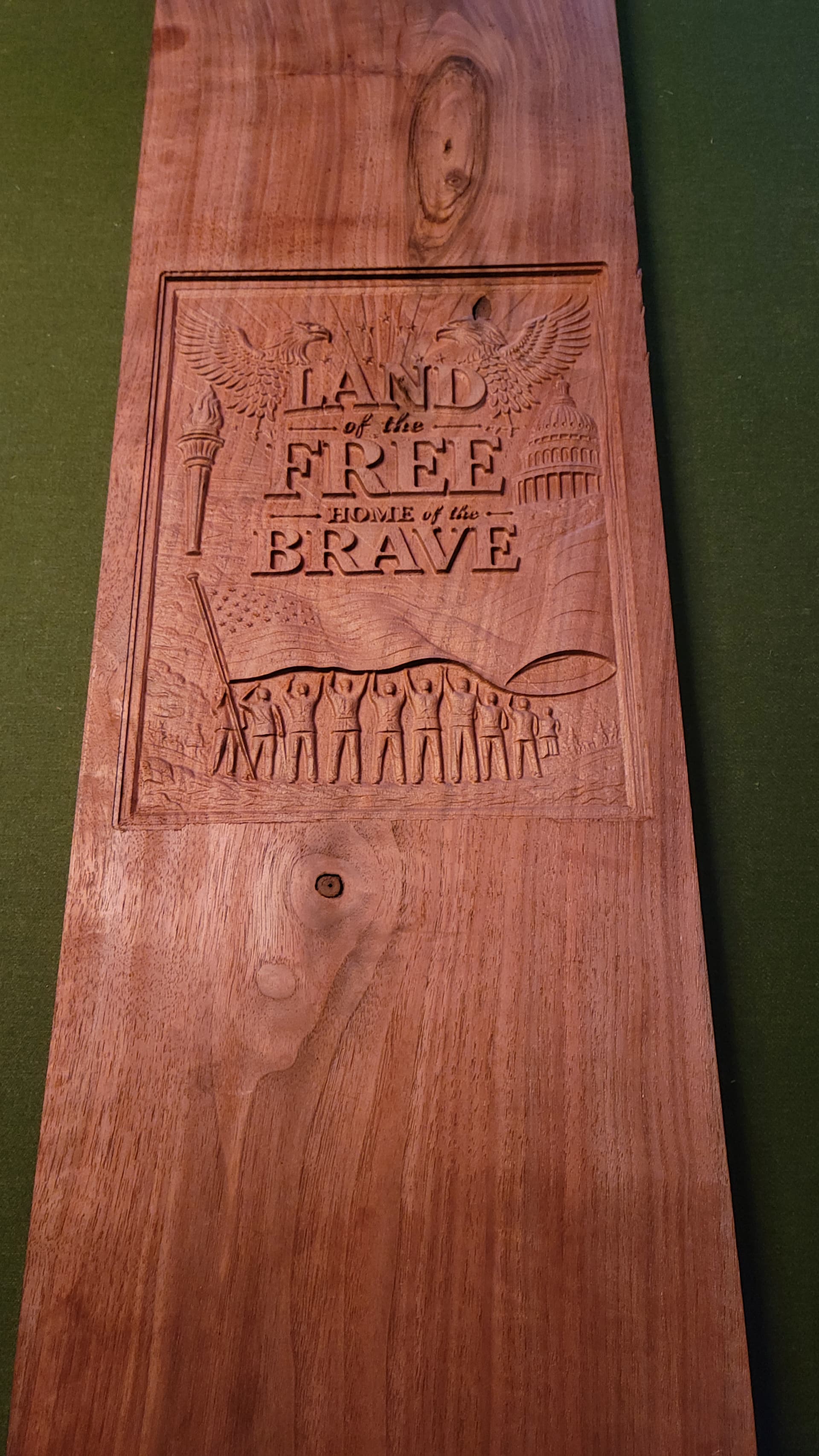

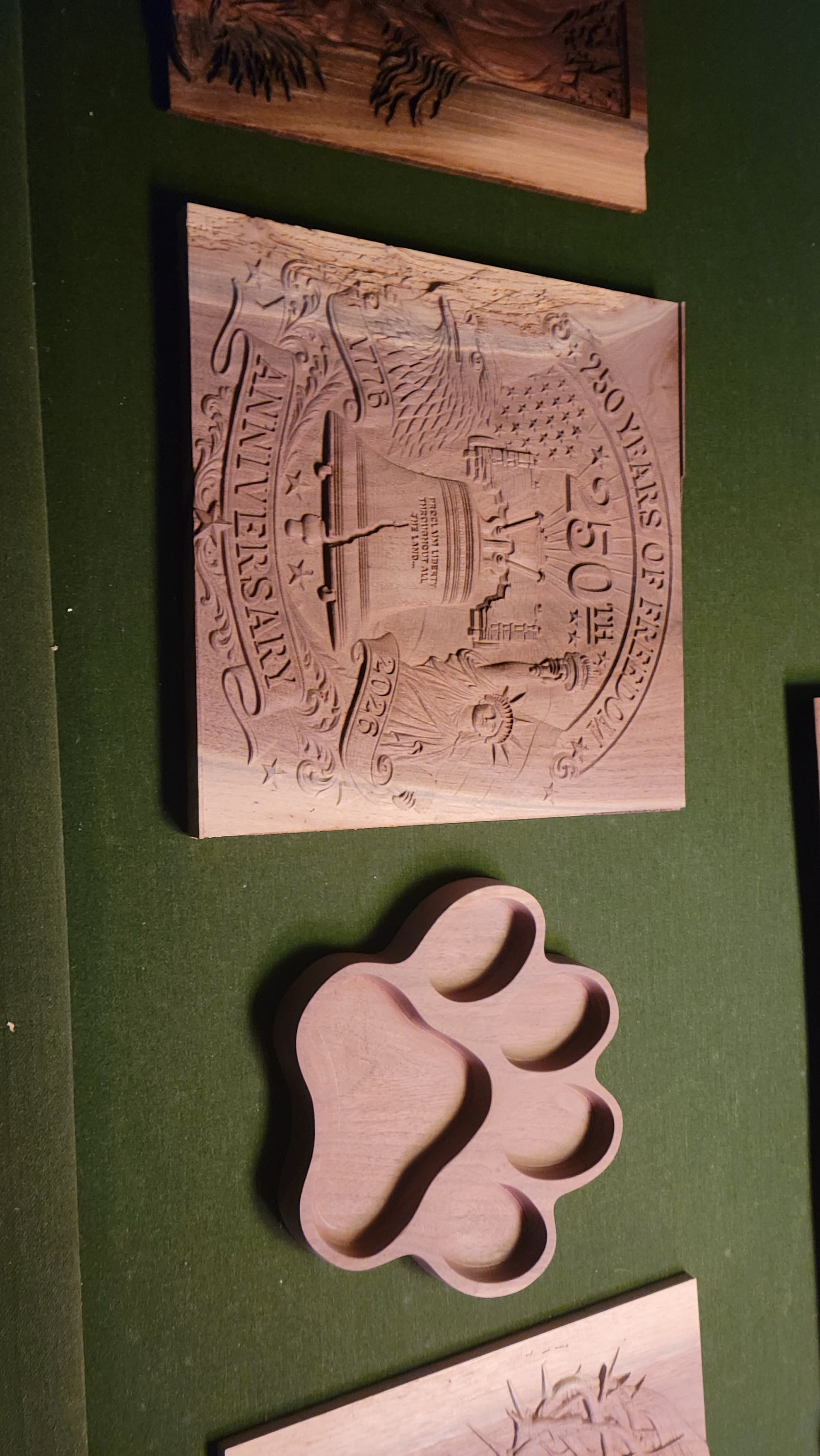

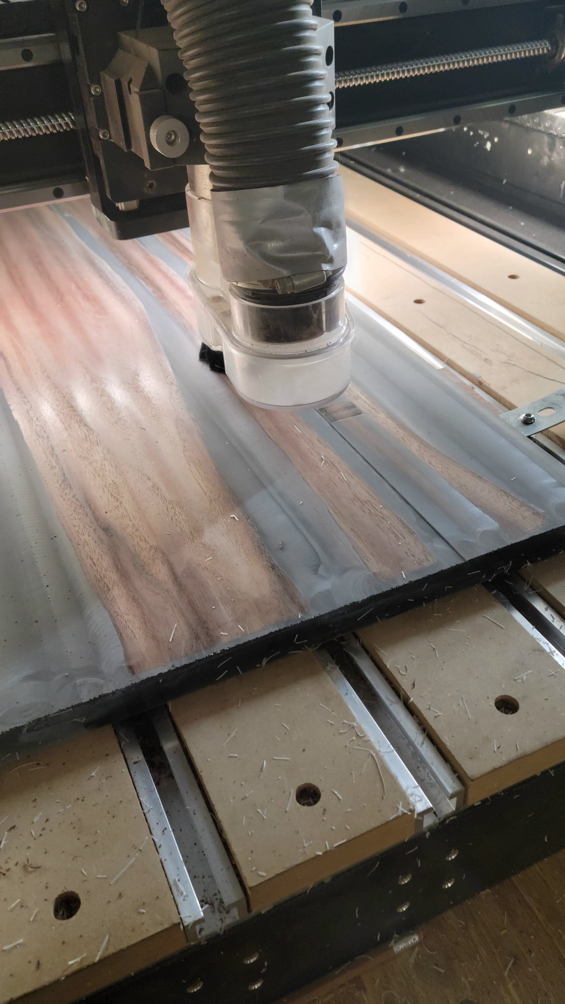

Just some 3D projects I’ve made in the last week using Carbide 3D pro software went very smooth cut rough pass with 1/4 inch 4 flute down cut end mill at 80 plunge and .100 depth cut at 18000 rpm at 150 in a min and finished with 1/32 tapered ball nose at 80 plunge and 180 in a min at 20000 rpm
