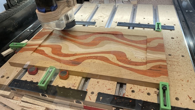

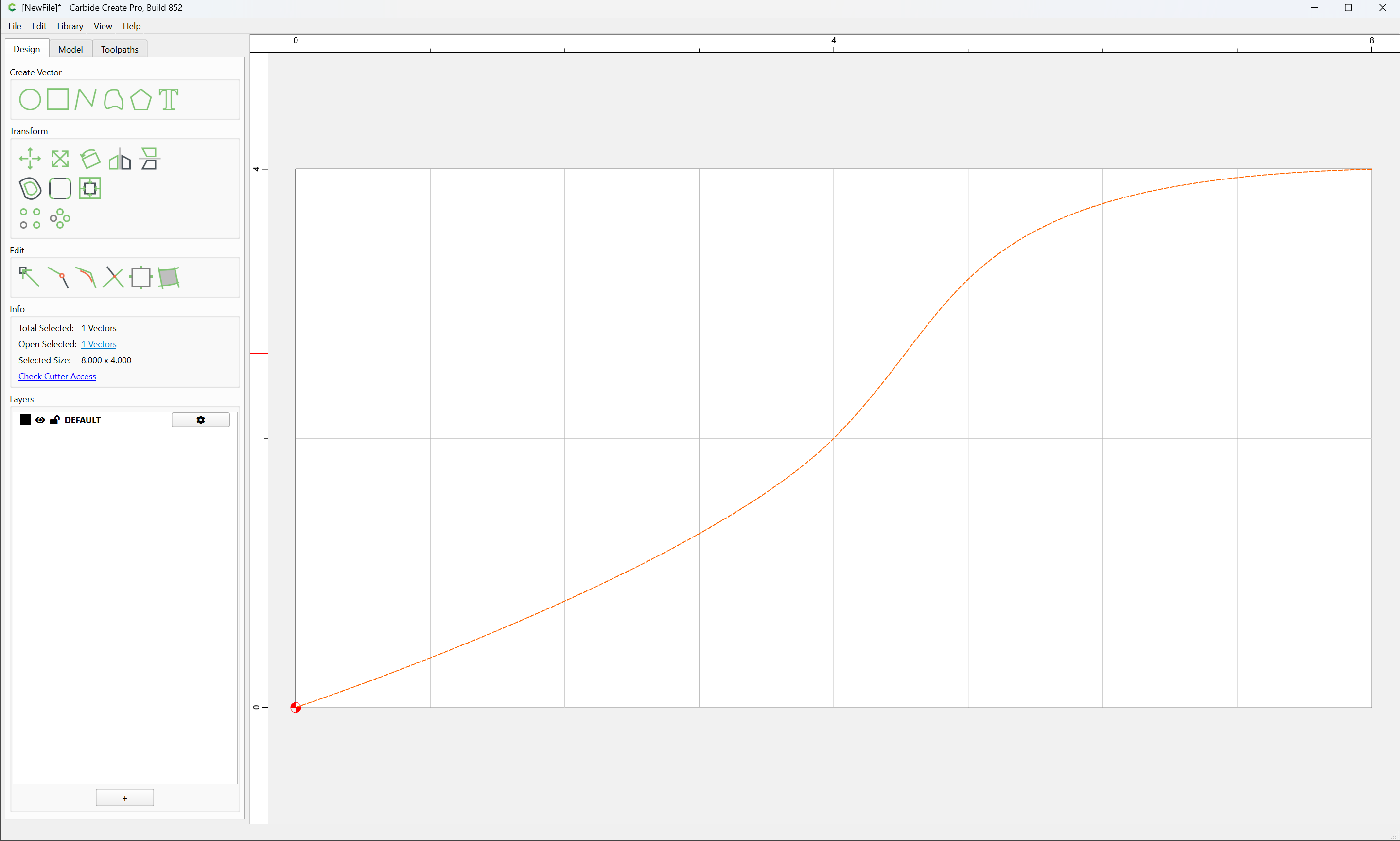

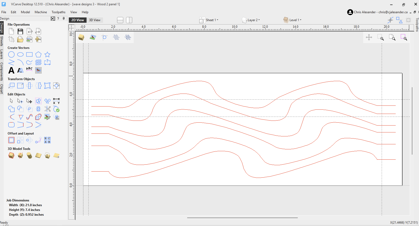

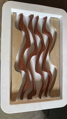

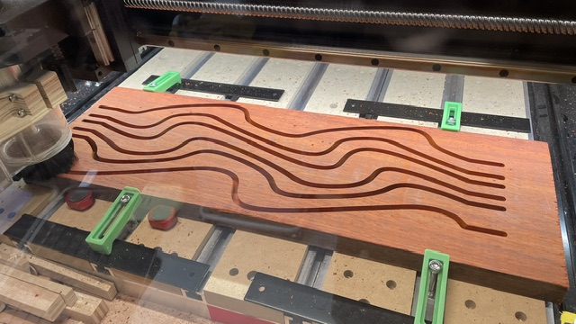

So I had an idea for another multi-wood design using curves. Gathered up 3 types of wood (African Teak, Paduk and Maple). Created the curves in VCarve.

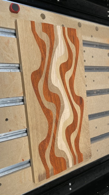

Then started the cutting on my Shapeoko 5.

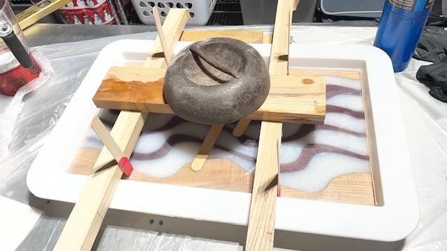

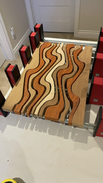

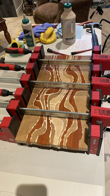

Then came the glue up to create a blank.

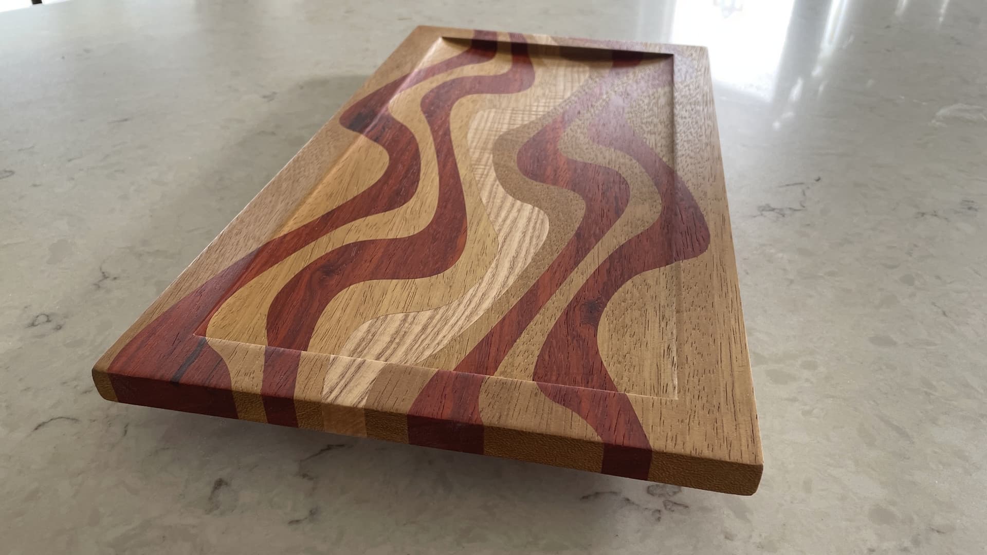

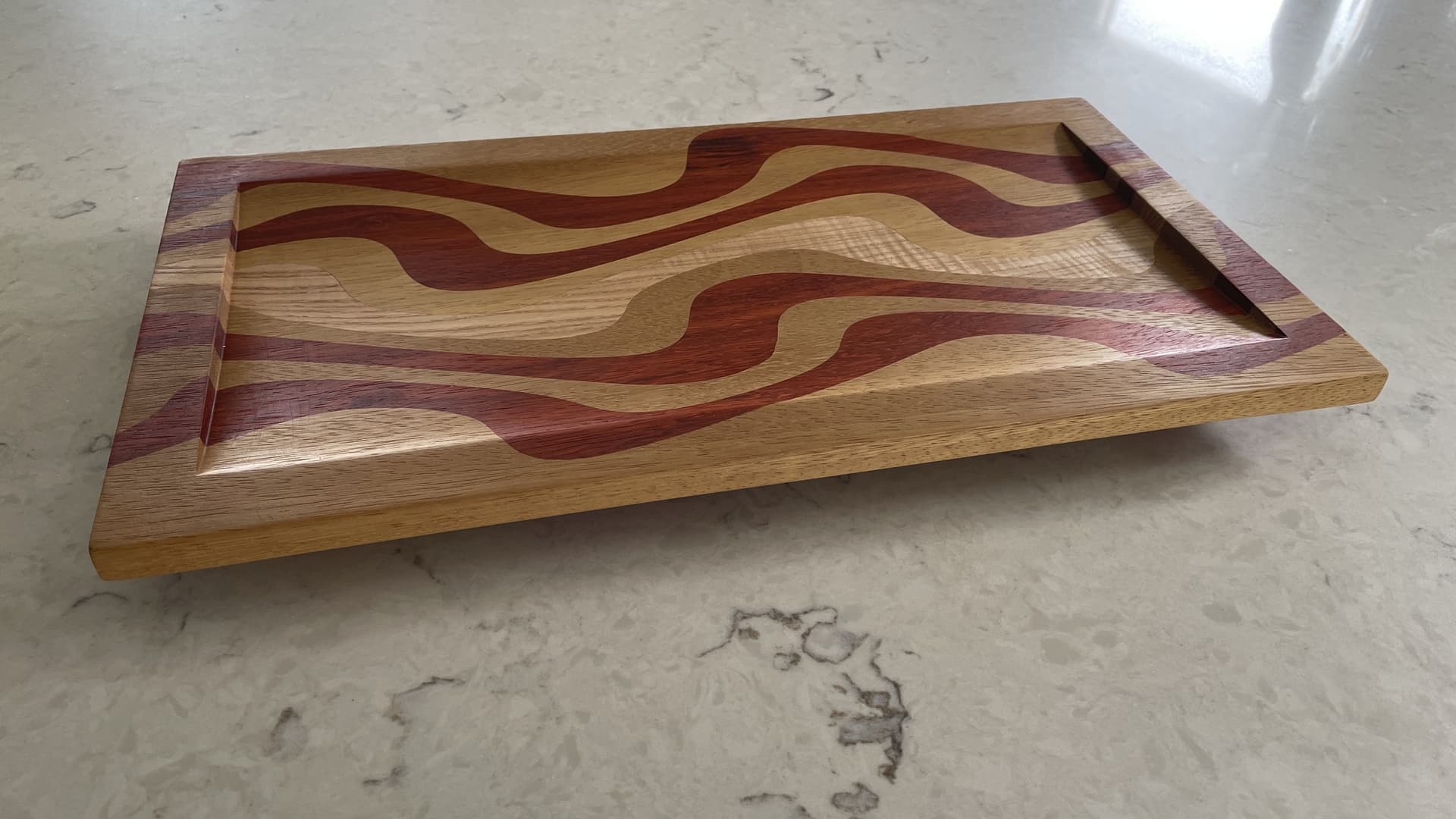

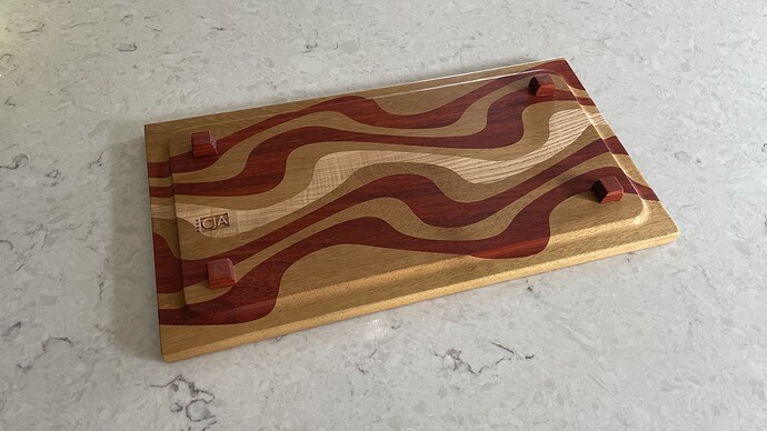

Once fully dried I moved to the final design of a serving tray.
Finished project with feet glued to the bottom.

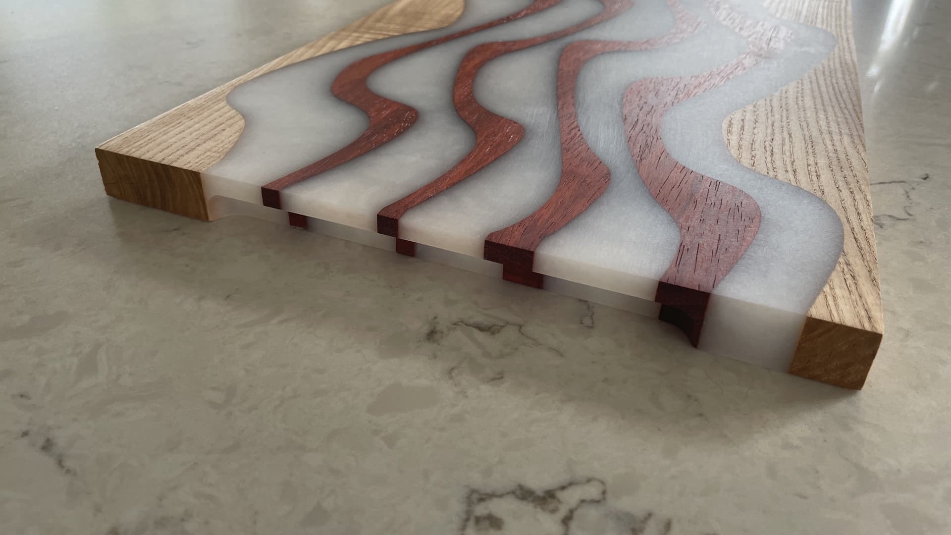

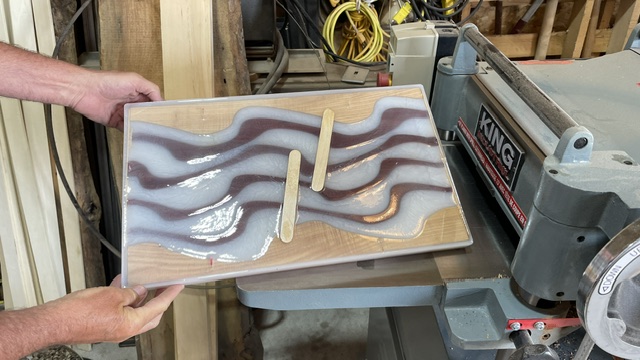

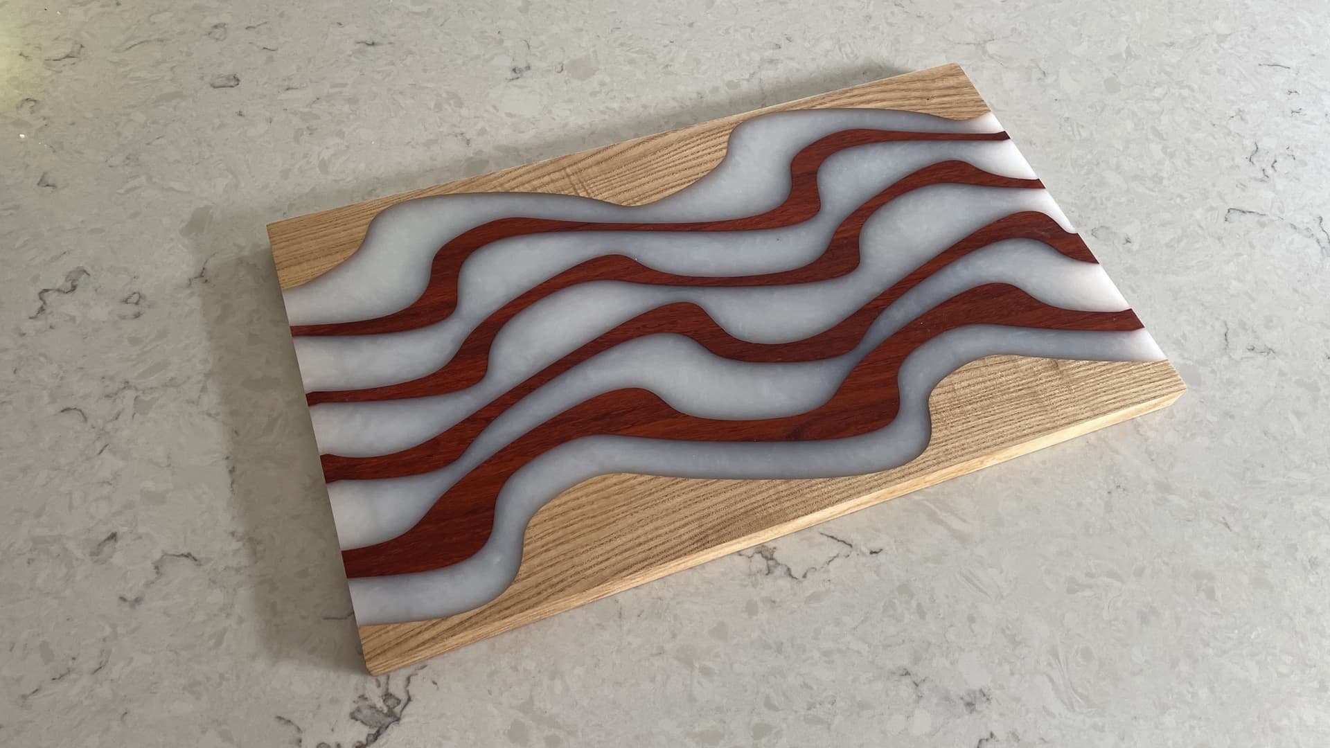

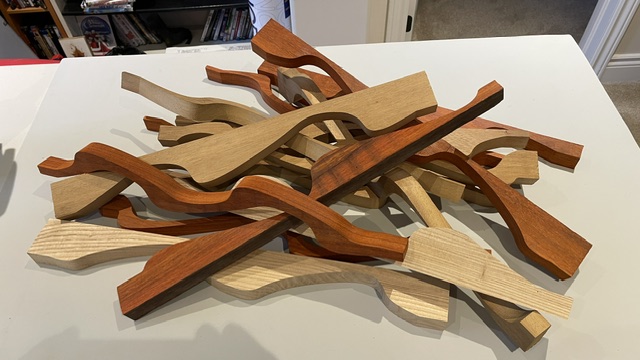

But then I realized, because each curve is cut individually, there was a lot “waste” opposite curves left over.
Then came my eureka moment. I’ve been experimenting with Resin lately, so …
On to the next project.

Great project, beautiful results. I don’t always succeed but I try to repurpose offcuts as you did when possible but it starts with the original design when laying out stock. There is a trade off with offcuts piling up however……
My solution for off-cuts was re-purposing some plastic storage carts which the kids had for their toys — combined two carts into a single stack — offcuts go into the top couple of bins roughly sorted by shape/size, then when I need a small bit for a project, as I sort, if the bin is so full as to make searching difficult, less-promising pieces are demoted to a lower bin.
This process repeats and the bottom bin, when full, goes out to either the fire pit or compost pile.
For larger parts, I’m hoping to set up an organized system where storage is set up for certain standard parts — any offcuts are stacked and after the project is done are re-cut to match a size in the storage bin and stowed
Thats using your head for something besides a hat rack. Nice. I have done a lot of epoxy resin in the past. However I find it a pain and have not done it in a while. Great use of “scraps”.

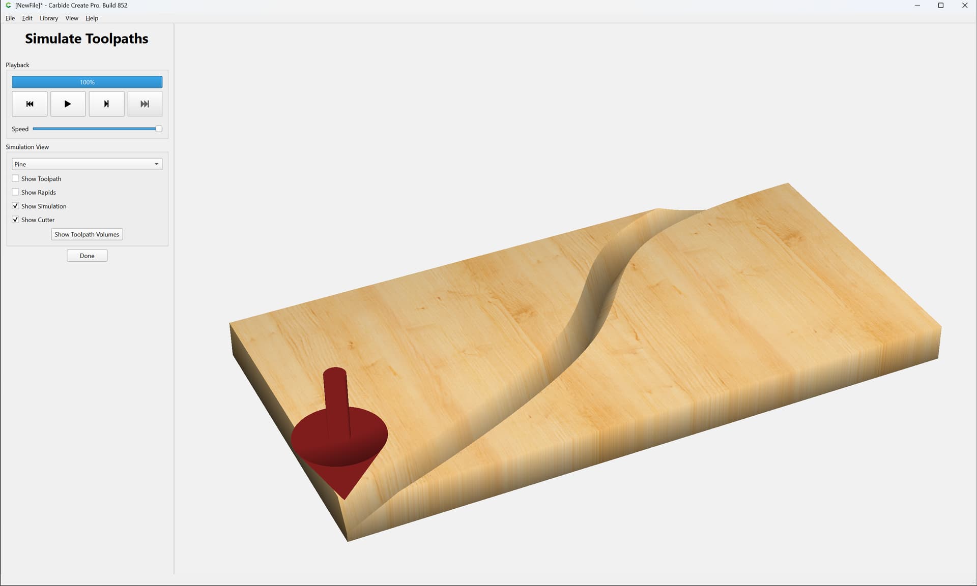

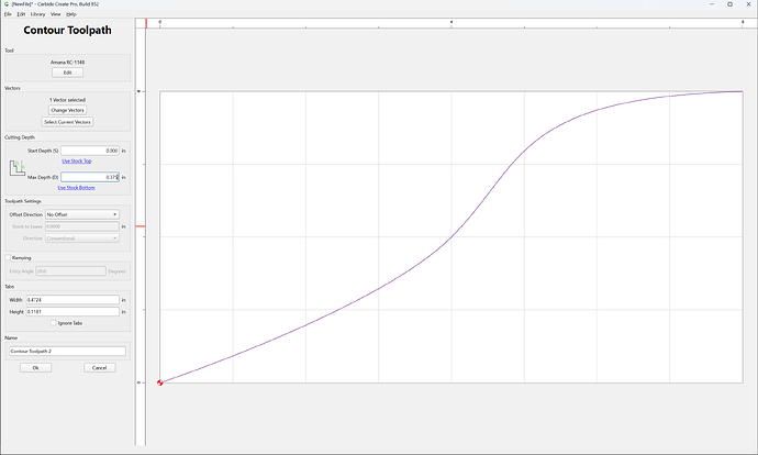

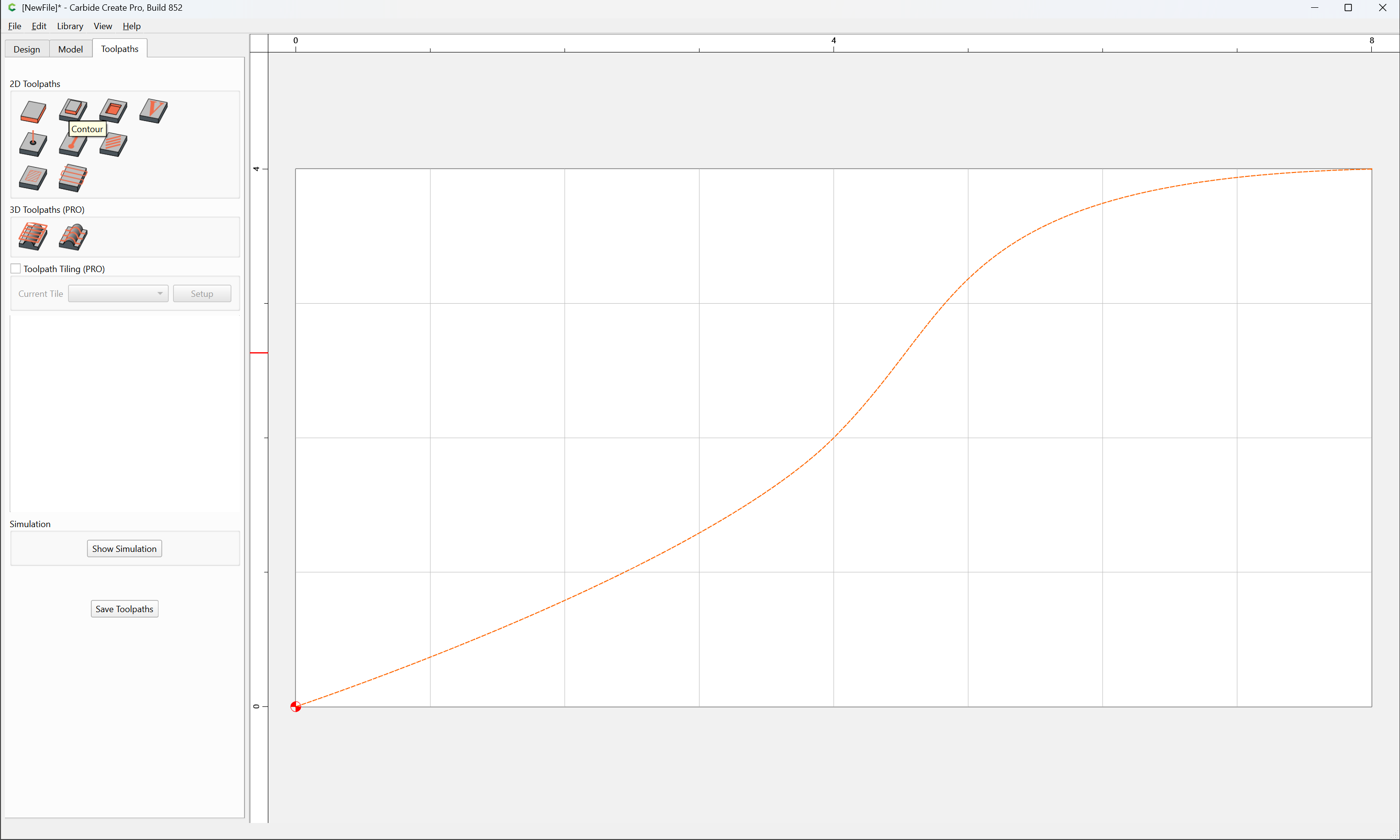

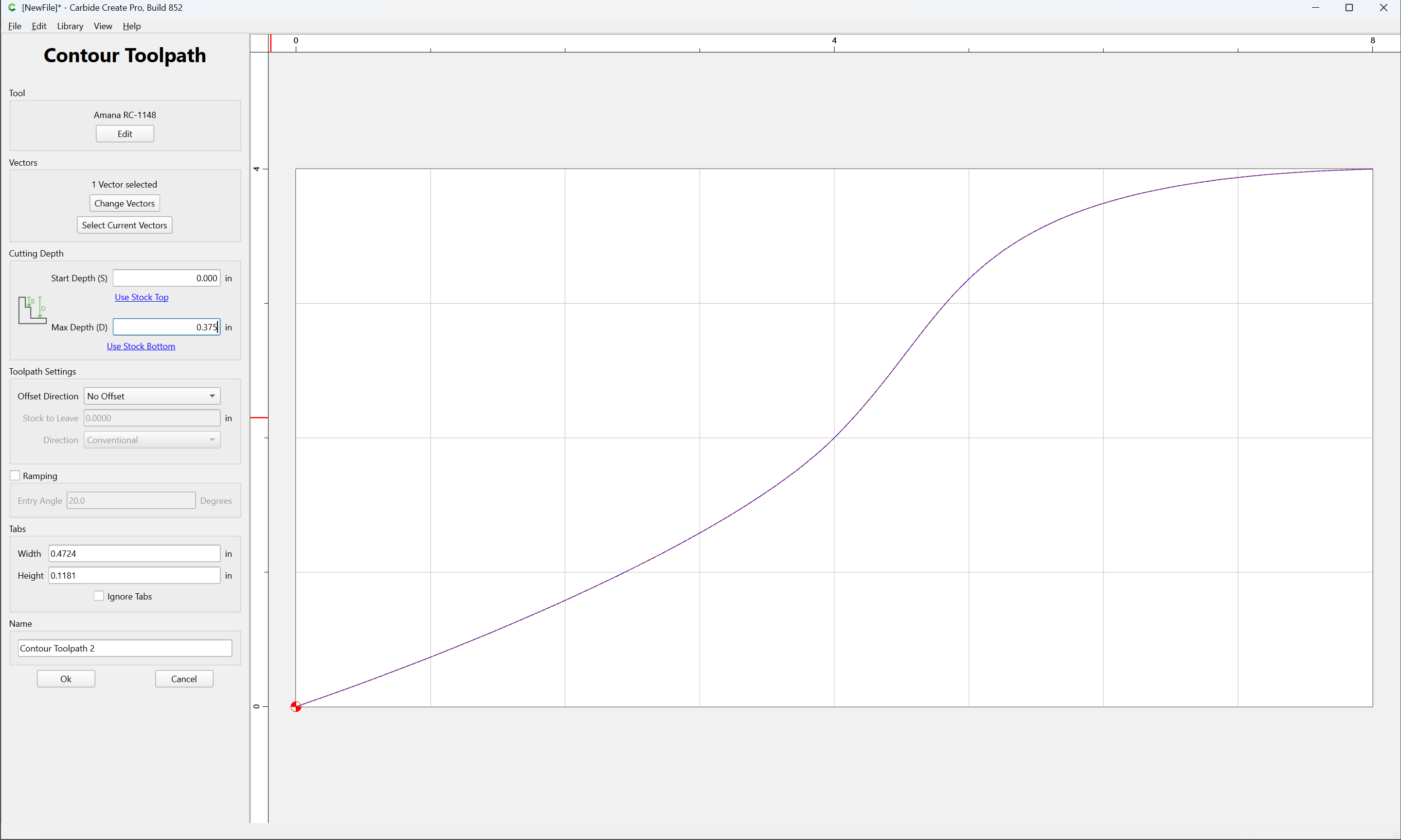

Looks awesome, can Carbide create also cut open line curves like that, or is that a V-Carve feature only?
Carbide Create can cut along a piece of geometry using a V tool to a specified depth:
I just did a test on both Carbide Create and Carbide Create Pro using a single curve I created. Used Contour and selected where I wanted to cut the line (outside/on). 1/4" bit through the stock seemed to work fine.
