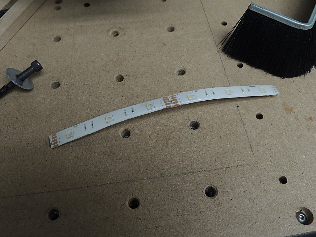

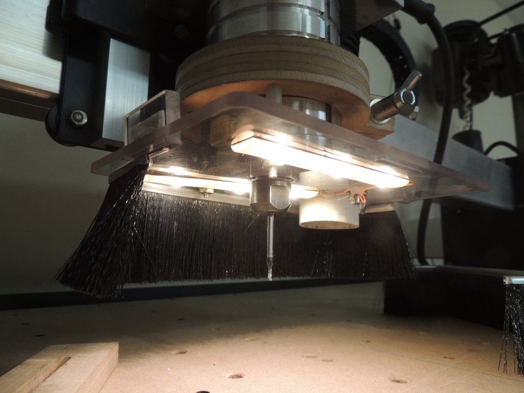

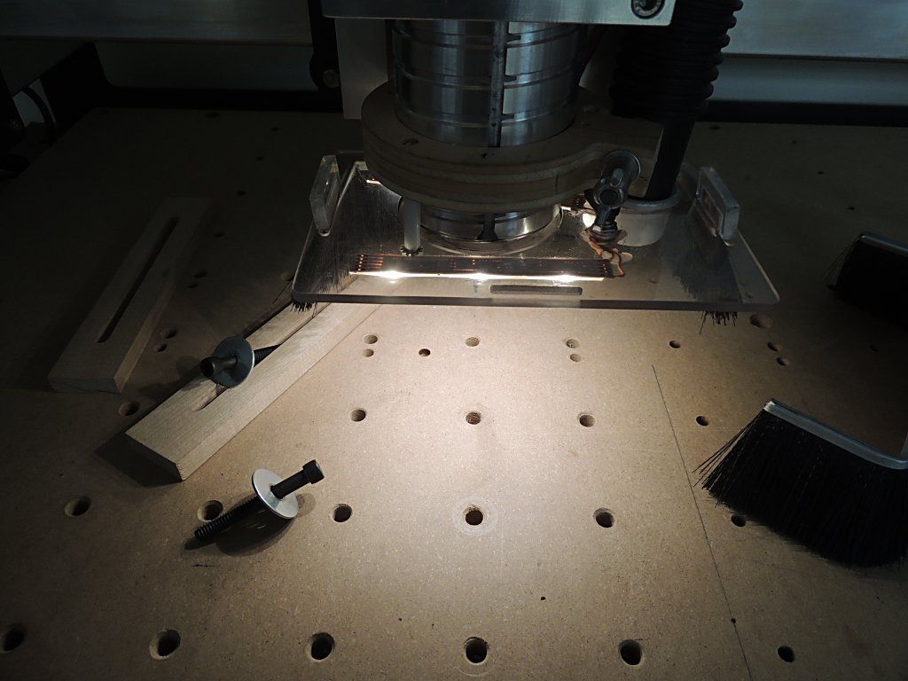

I installed LED tape lighting under my kitchen cabinets recently and I had a foot or so of leftover strip. It can be cut into 4" increments which was perfect to fit beneath my dust shoe. The strips operate on 12 volts, so I found a 12V power brick that was leftover from an old cordless telephone, I connected it to the cut strip and it worked perfectly (its a good thing I don’t throw everything away).

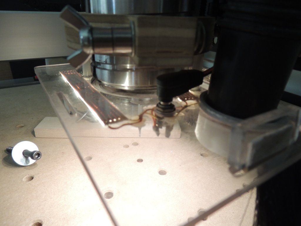

I installed a barrel jack onto the dust shoe plate, soldered wires in parallel from the LED strips to the jack, and adhered the strips to the plate. I wanted a plug and jack rather than hardwiring the LEDs because occasionally I remove the dust boot. I ran the cord for the power supply cord through the cable chain on the Shapeoko.
I have a switched AC power strip on the table next to the Shapeoko to which I plug in both the Shapeoko power supply and the 12V LED power supply. The switch on the power strip turns everything on and off, so the LED strips double as lighting to see what I’m cutting, and they also remind me that the machine is powered so that I don’t leave it on overnight.
