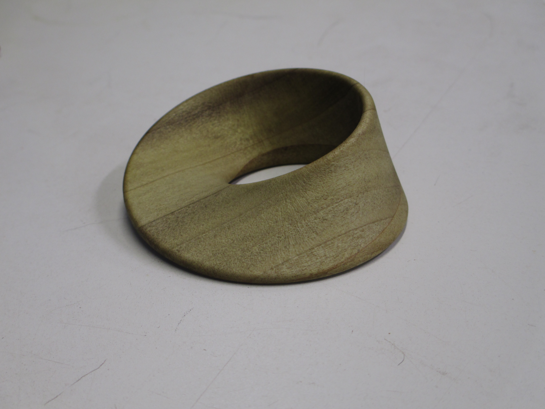

Done on a Nomad. I took a challenge, as “the only way to machine a Mobius strip is on a 5-axis, like those guys Make featured”.
Material: Poplar
Size: It will fit in a 70mmX70mmX25mm box
Thickness of strip: 3.5mm
Time: about 3 hours (could have been faster, but I reduced the tool engagement for reason of paranoia, for some operations. Probably didn’t need to…)

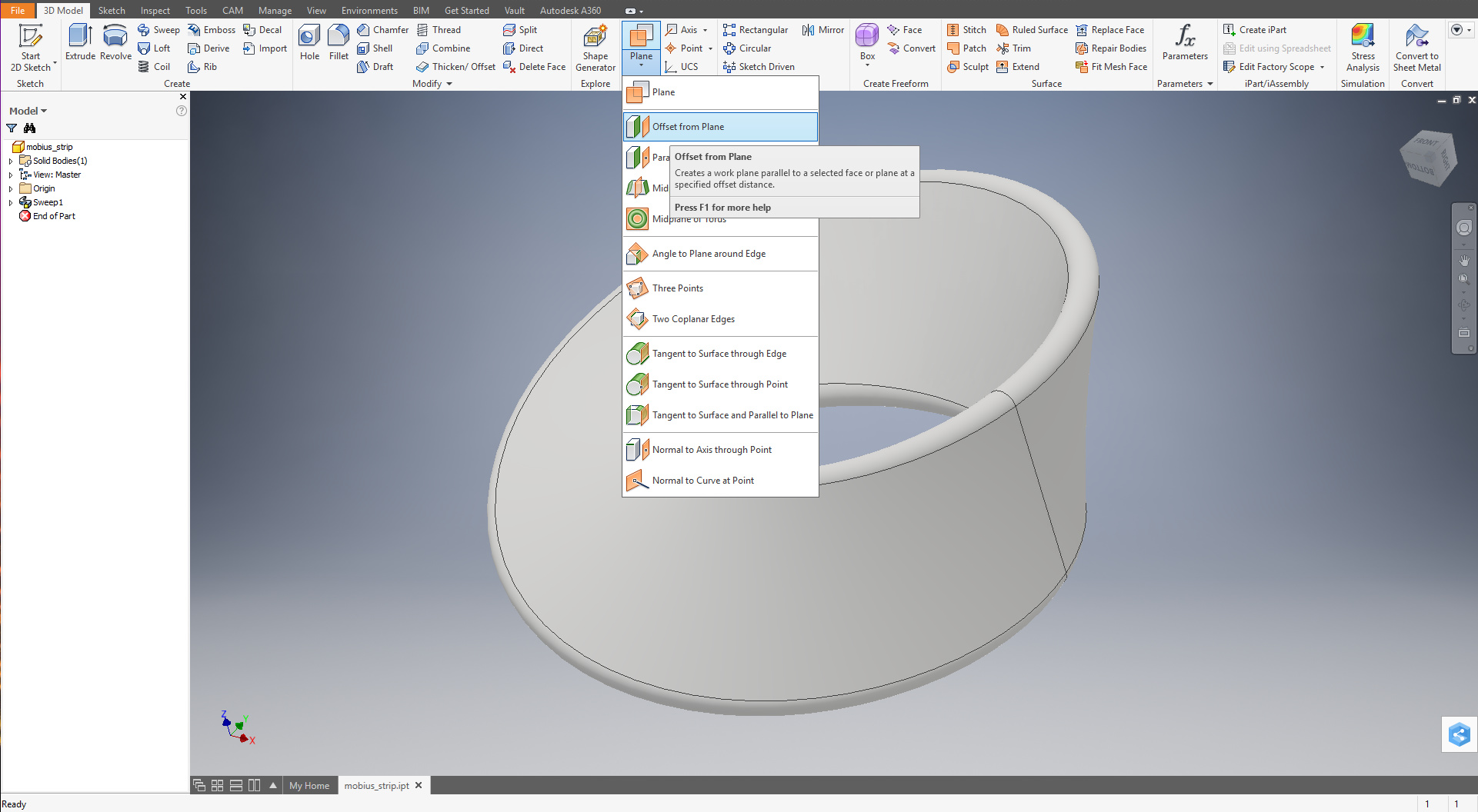

Now, to set up reference geometry so that the part can actually be made. First, a base plane:
The plane is parallel to the x-y plane (selected from the origin block), but at a distance of -13mm, so it is just below the final part.
And then a sketch is made on this plane to provide a reference point outside the body. This will be on the bed of the machine. It is not critical, but makes it easier later when magic happens.

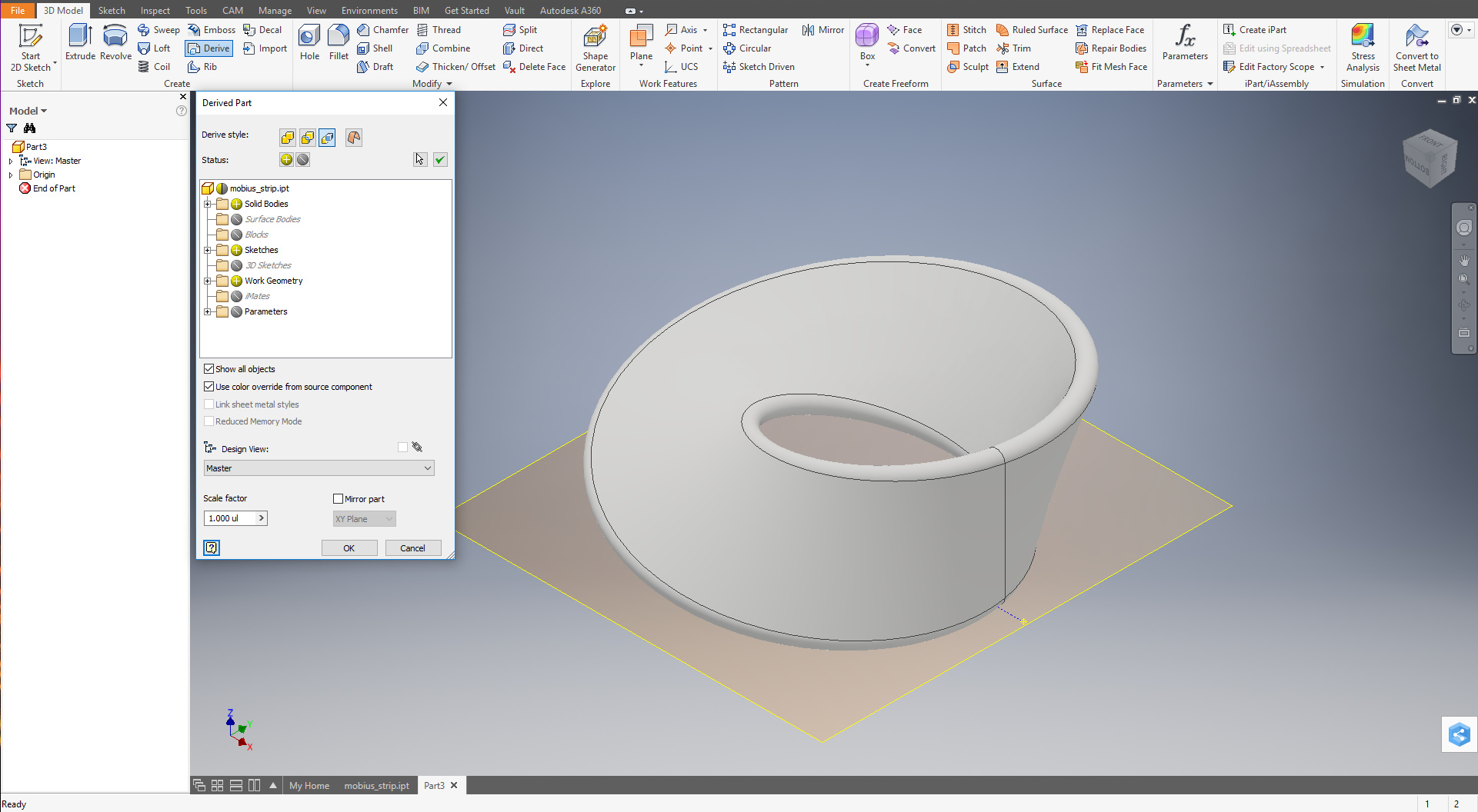

That acts as a support to machine the second side, and is why the base plane is there. Again, it can be done without the base plane and external reference, since the second side machining is done using the same reference frame as the support, but it makes the stock size a non-issue.
The support is done as a derived component. It inherits the coordinate frame and changes to the base component will reflect through automagically.
I select the base component, and make sure that sketches and geometry are included as well.

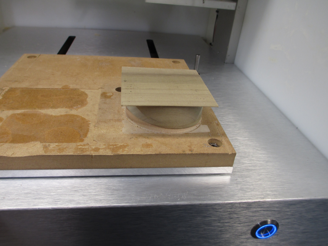

First setup:
Note that I left a skin (0.5mm) at the bottom. This did help stabilize the part during machining, but it is mostly for help in lining up when placing it on the fixture later.
Machining the fixture. The wood is from the scrap bucket.

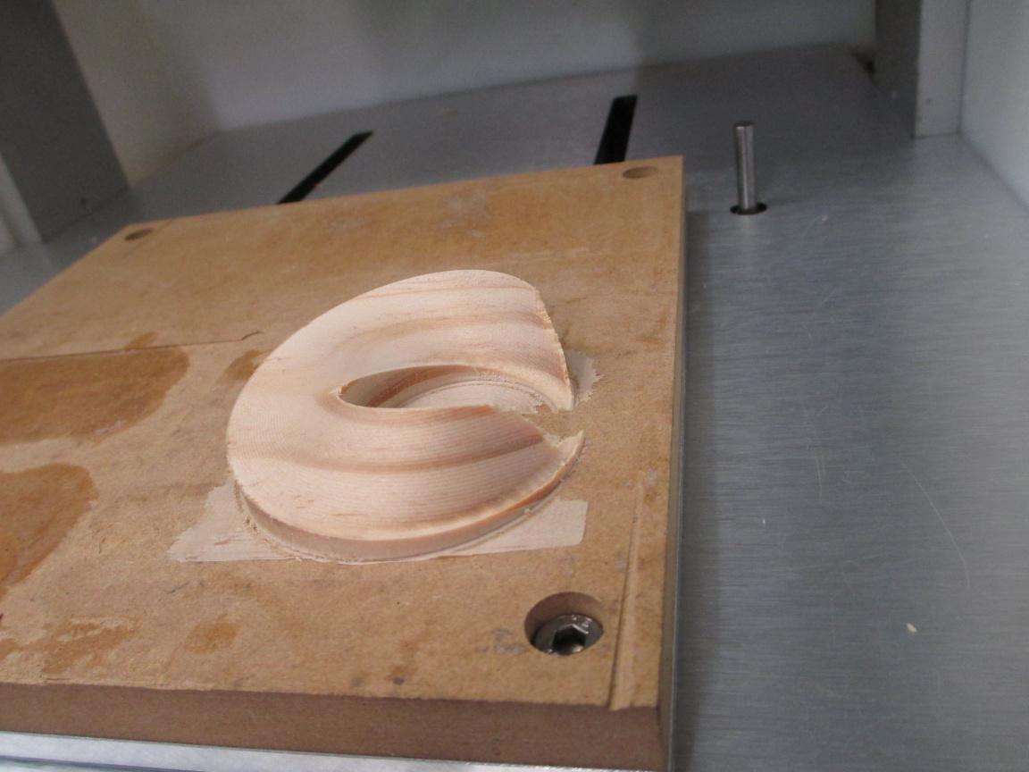

and mounting the part:
This is where the residual bas came in. I mounted the rough stock, then sized it. Then machined the form without moving it. This left the edges of the stock lined with the axes of the machine, and the axes of the model.
To mount it here, I used several small pieces of the 467MP, making about 1000mm^2. This is not a lot of area. To get the most out of it, ALL of the adhesive nees to be in good contact. Just dropping the fixture and wiggling it a little lets it find its home (the ‘hook’ at the bottom where the radius of the edge seats insures this… it is positively located for all degrees of freedom), but once the adhesive is there, adjustment is not possible.
I rehearsed the placement several timed, applied the adhesive, and set the part. Then, with a gauge pin in the collet, a scanned the spindle along the edge of the original material (I could have used an indicator in this case, but this was easier) and felt for constant clearance with a 0.5mm feeler. If not properly mounted, the clearance would change. It was constant to within 0.03mm both in x and in y travel, so I presumed a good mount.
Light pressure for a few minutes to get the adhesive fully tacked in and away I went… Before starting, I upped the z zero about 0.03mm and shifted the y zero as well to partly compensate for the adhesive. Due to the varying angles, this isn’t going to be perfect, but if it was that important, I would have offset the surface by 0.06mm in Inventor.
The skin was gone quickly. Much time cutting air, as I did not bother modelling the material that had been removed but the first setup. I could have done so, but it would have been more time to do that than the machining time saved. For a production job, yes. For a one off, no.

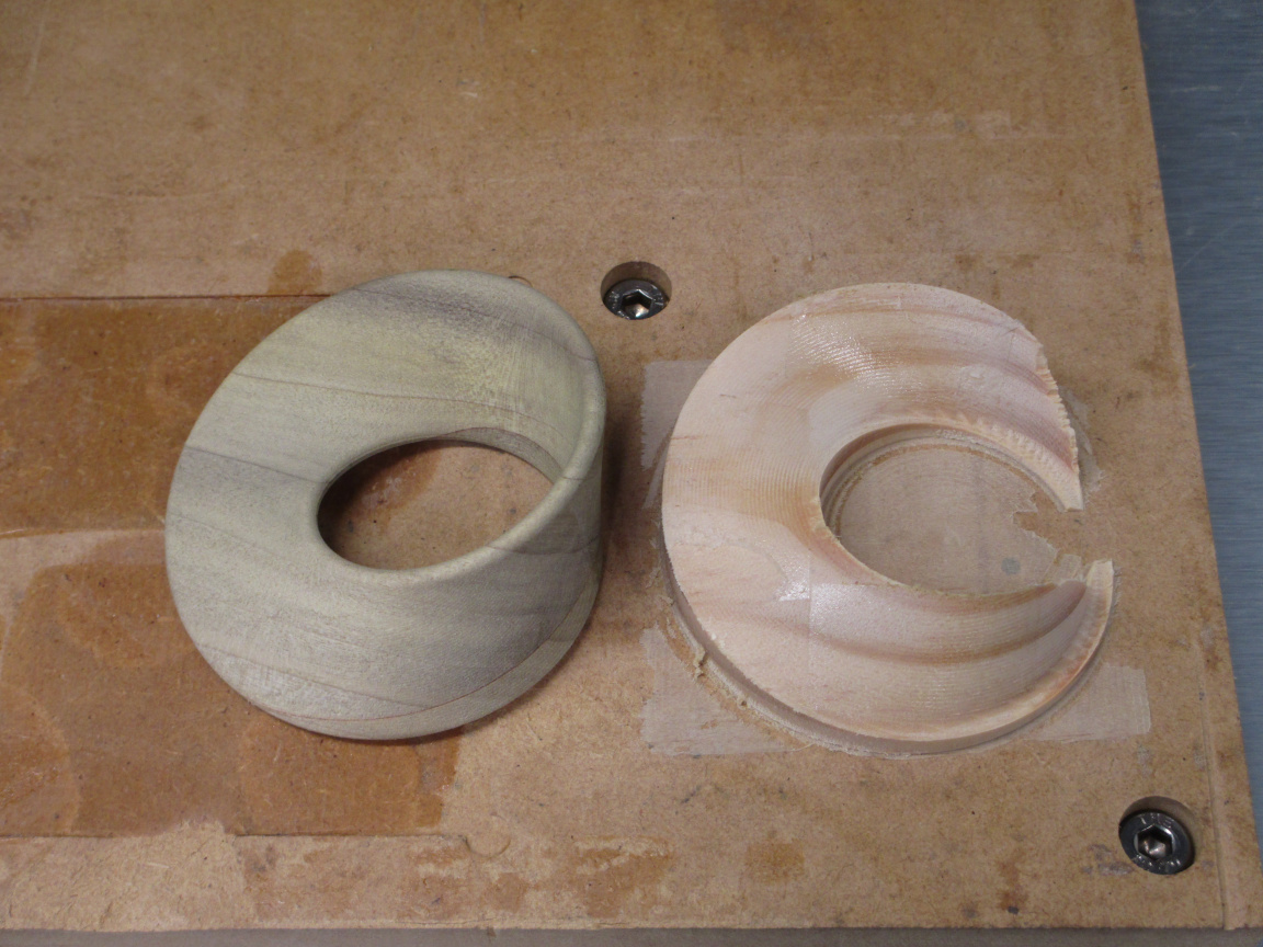

Removed from the fixture. Residue of the adhesive is visible on the fixture.
The fixture made a nice base once I cleaned up all of the chipping and smoothed the corners. You can see I hit the z-axis zero just about dead on, as it machined through the adhesive for the fixture, but didn’t mark the waste board.

After light sanding and applying finish: dip in shellac (1/2lb cut) to fill pores, several more coats wiped on, light sanding with 800 grit, and shot with 2 coats of lacquer. The shadow of the finish passes still shows from the right angle. Getting rid of this on poplar (a pretty soft wood) would require substantial sanding.
