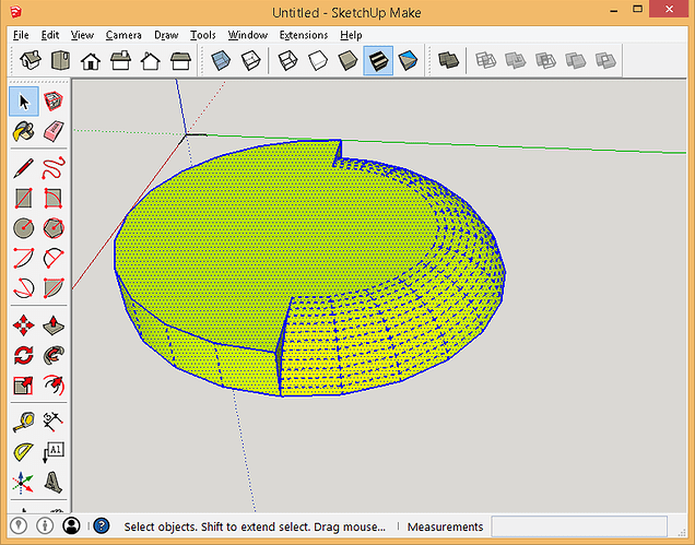

if you have an 1/8" endmill, this is a circle 2" around and 1/4" deep. The program starts in the CENTER of the work so when you home / set zero, set the zero on a piece of wood at least .28" deep and at least 1.25" all the way around the tool. It will be 1 inch circle all the way round the center. It is also going to be a flat half circle and a rounded top half.
Looks like this:
Here is the gcode file:
untitled.zip (6.5 KB)
With a 1/4" end mill this should make a 1 inch square that the top side is .125" deep and the front is at 0" deep.
