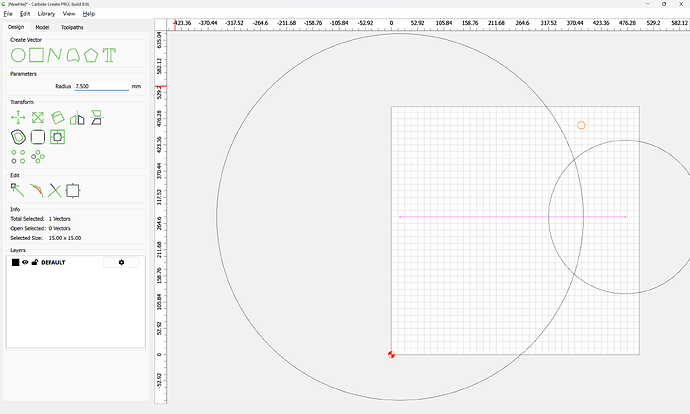

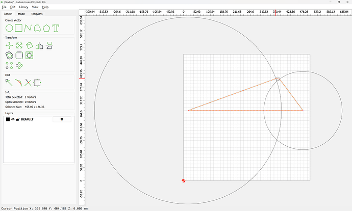

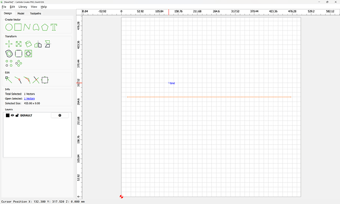

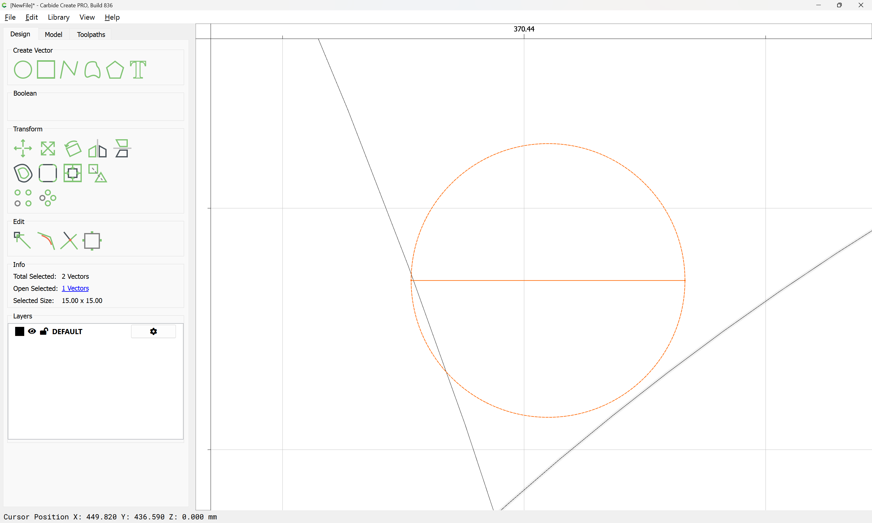

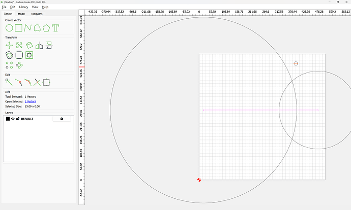

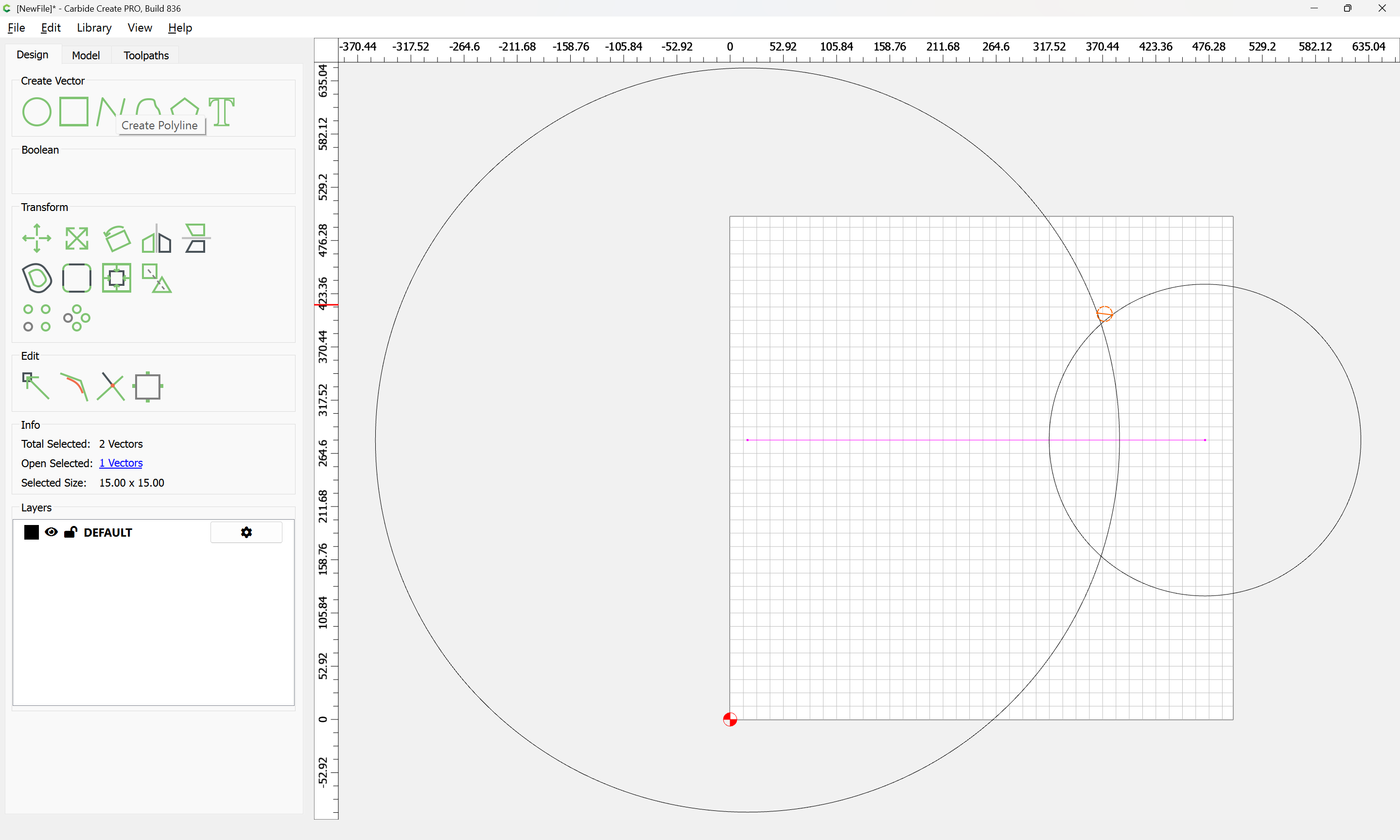

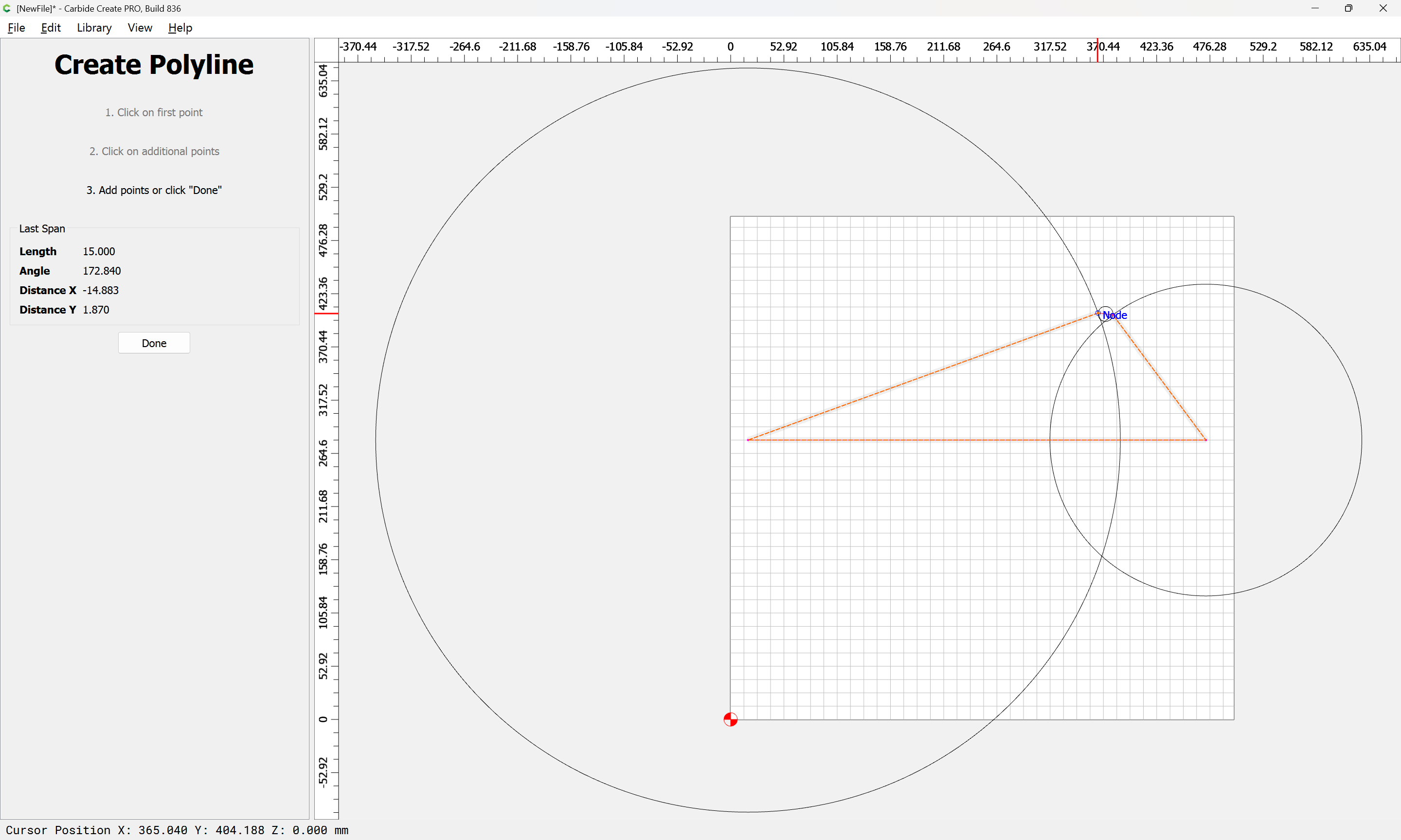

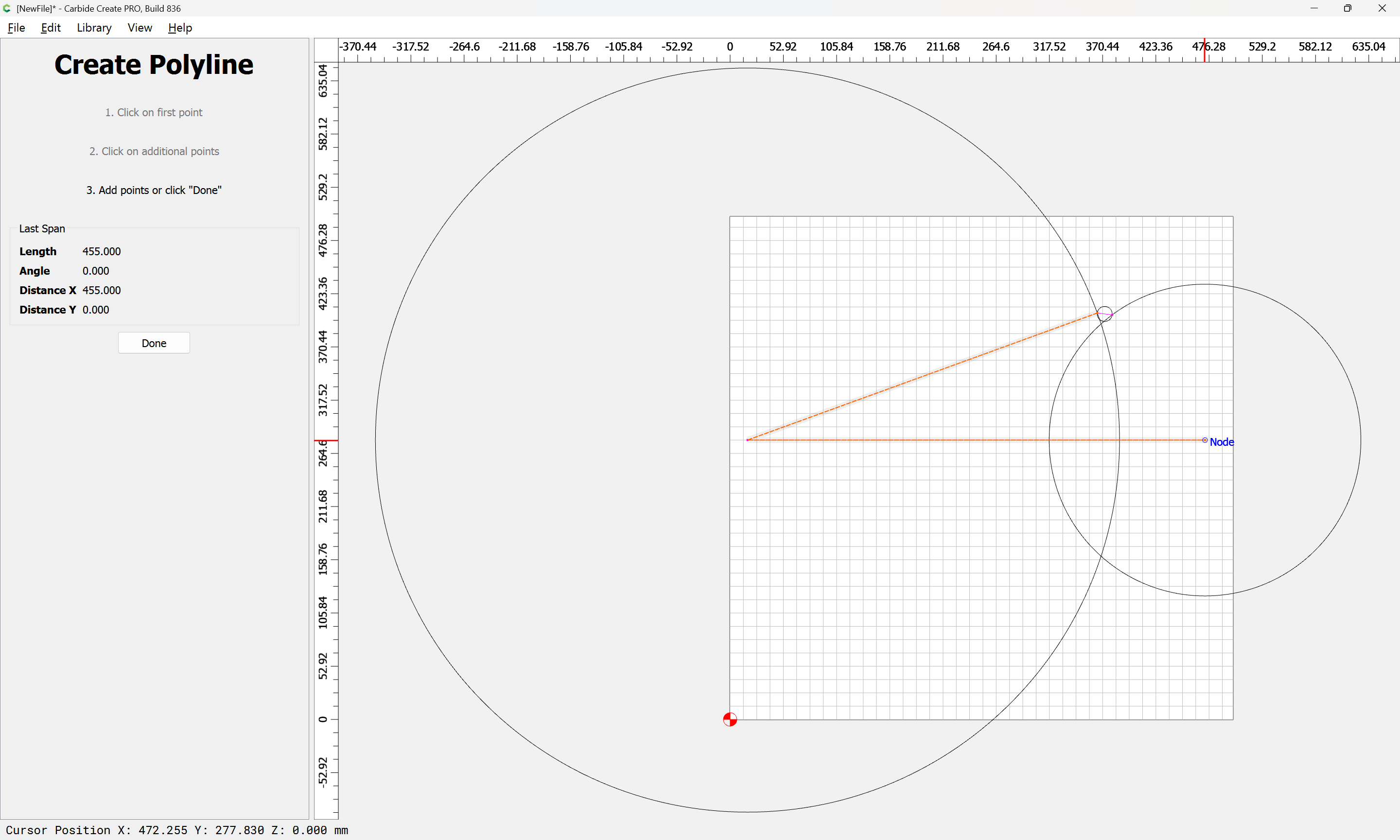

This is pretty easy to approximate in Carbide Create (or any other drawing program which will draw lines, circles, and compute intersections):
Draw the first line:
(done by drawing a horizontal line, then scaling it)

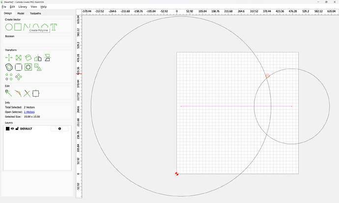

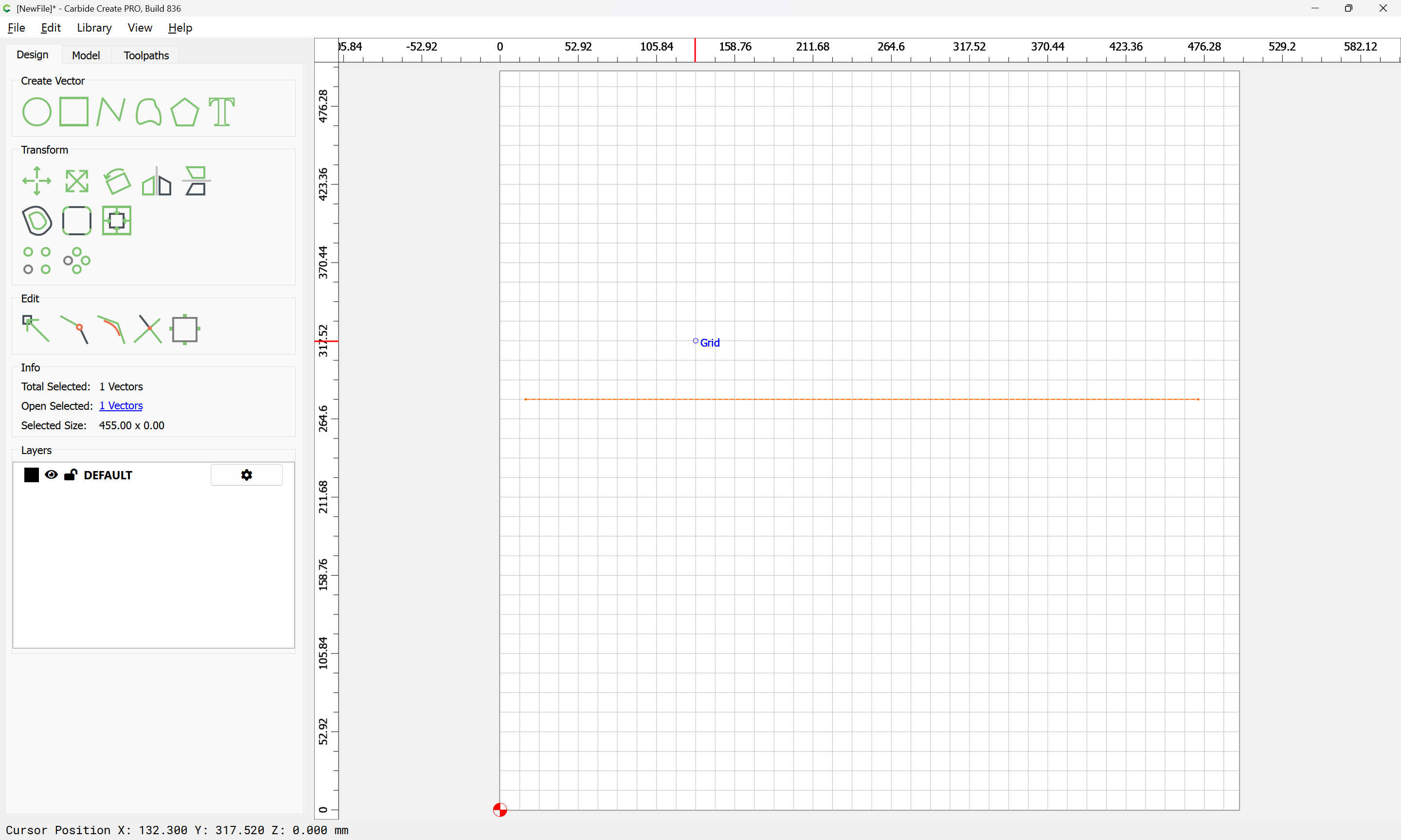

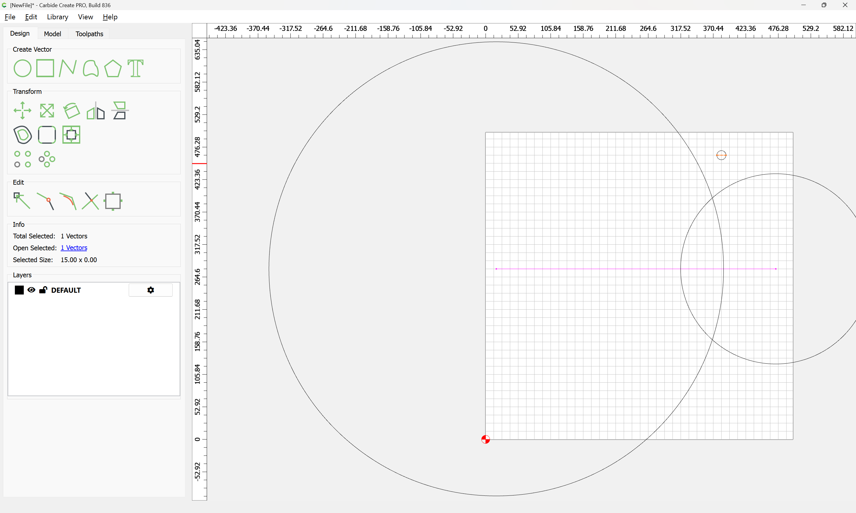

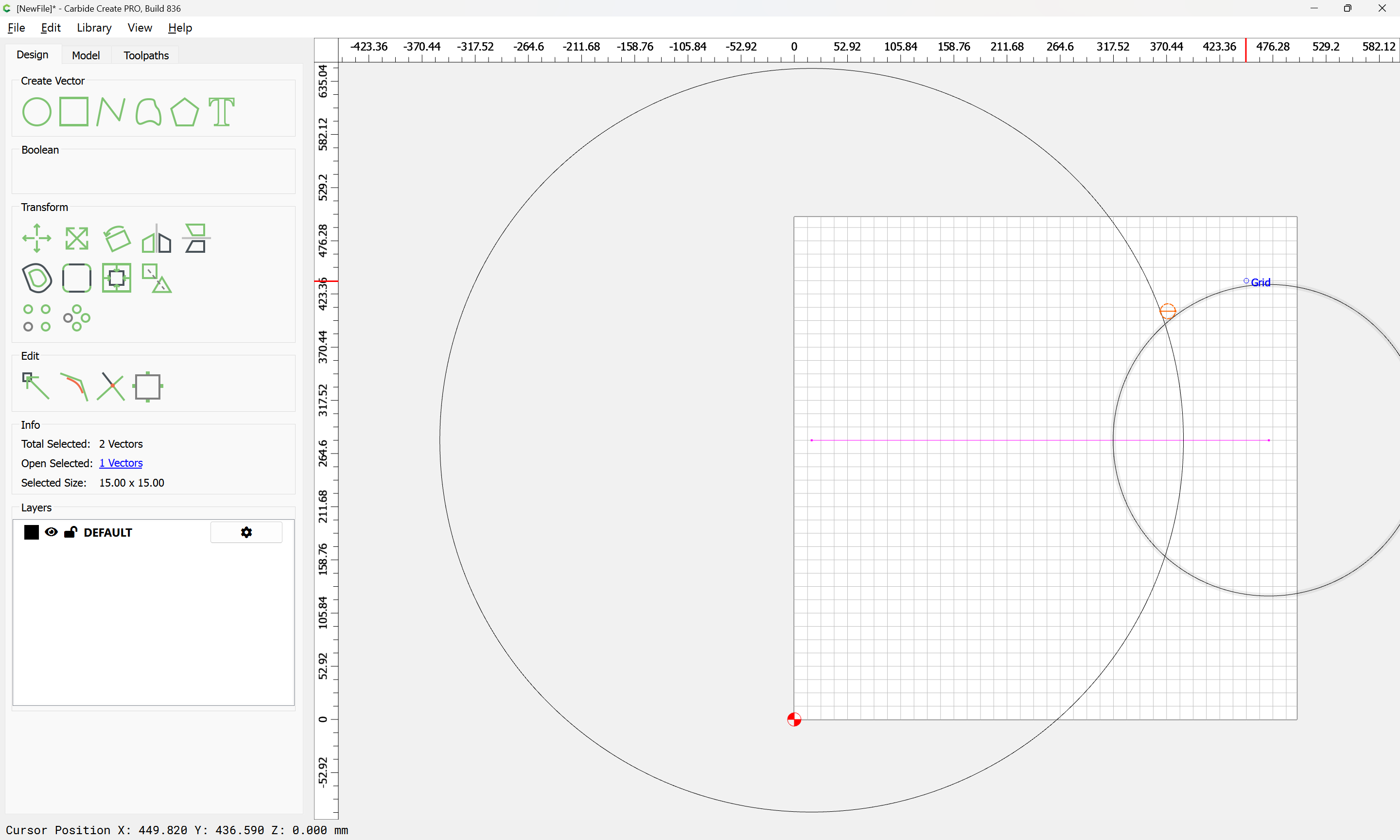

Then draw circles which have the next two lengths as radii centered on each end of the line:

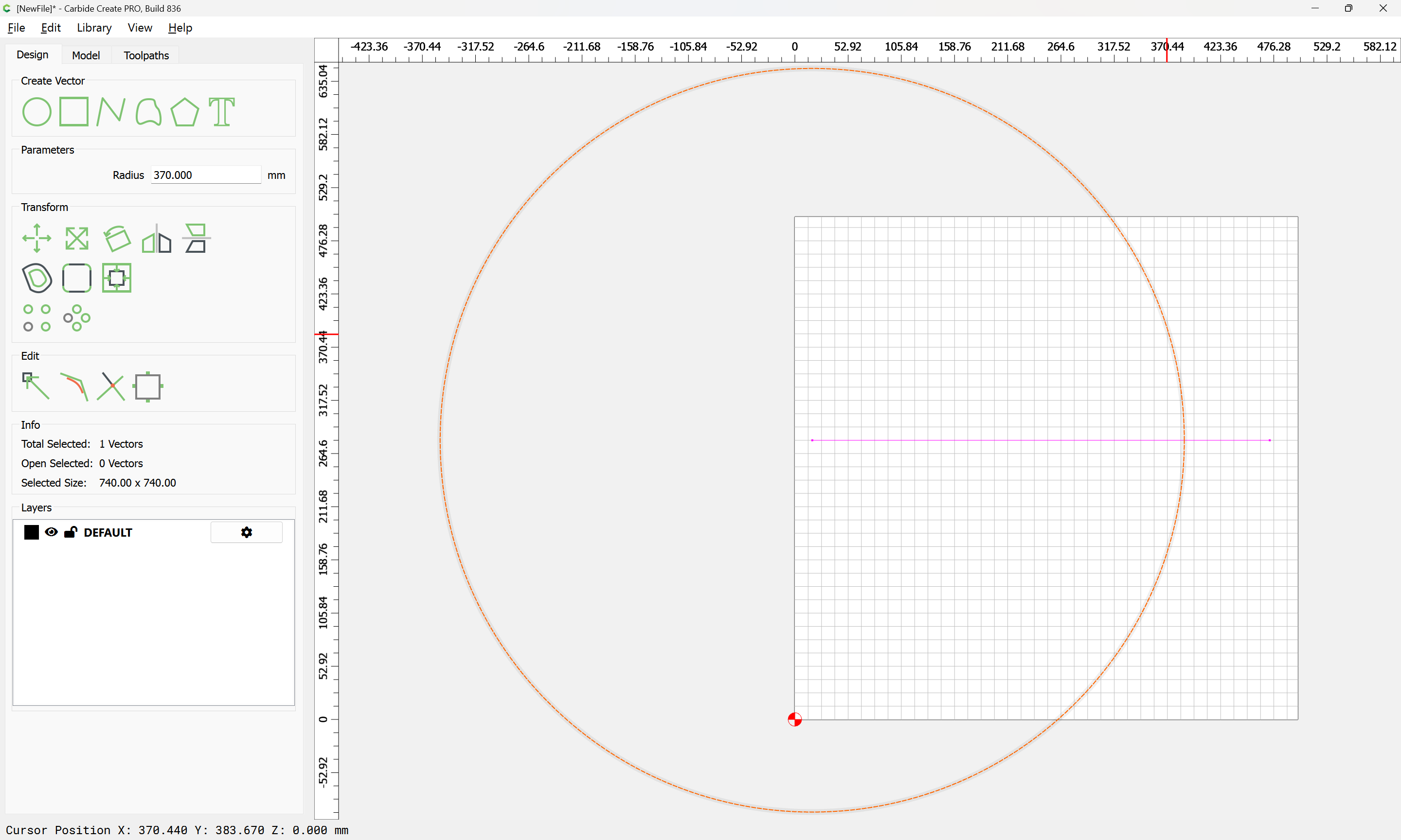

Then draw a circle with a diameter equal to that of the last line:
and draw a line through it:

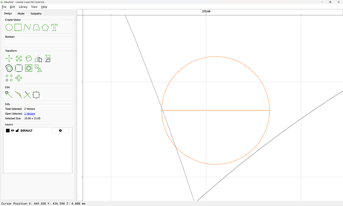

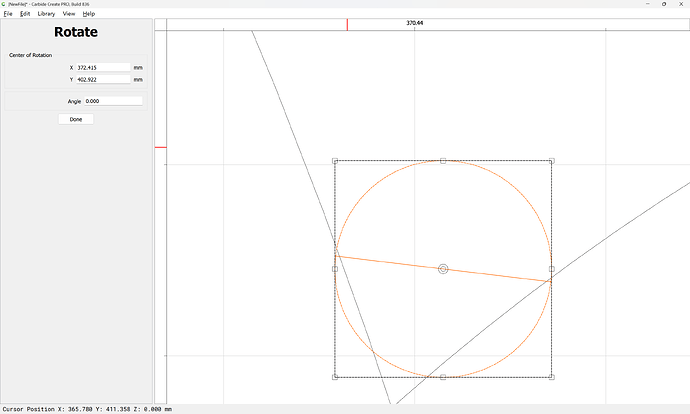

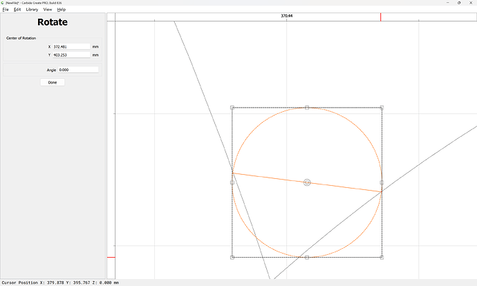

Select both and drag into approximate position:
zoom in:

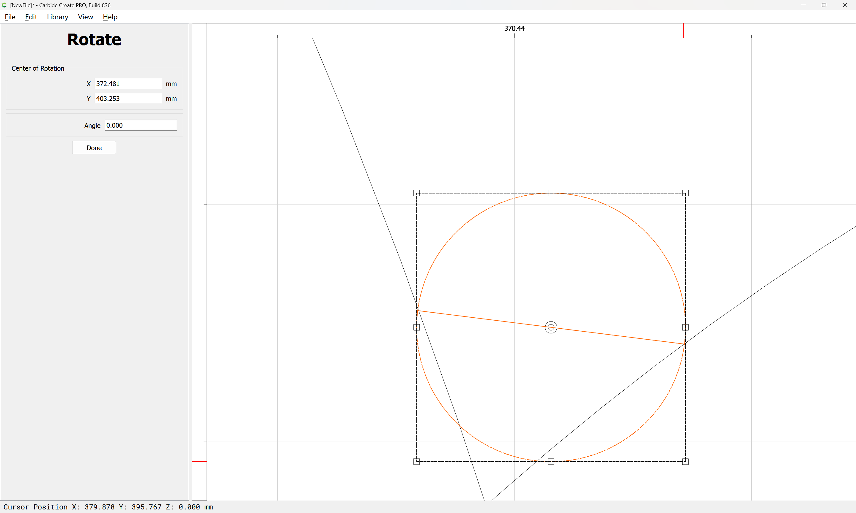

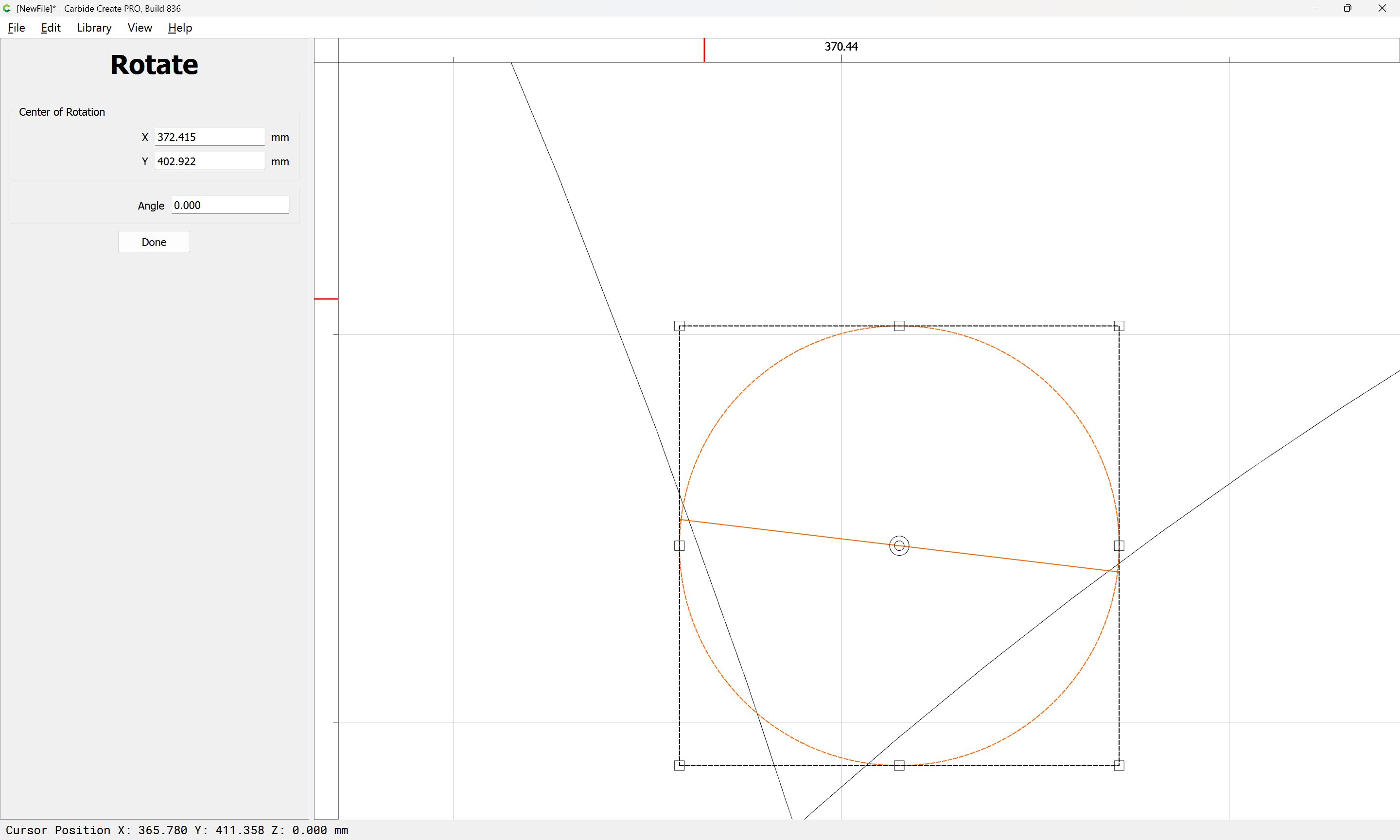

and adjust position and rotation until the ends of the inscribed lines just touch the two circles:

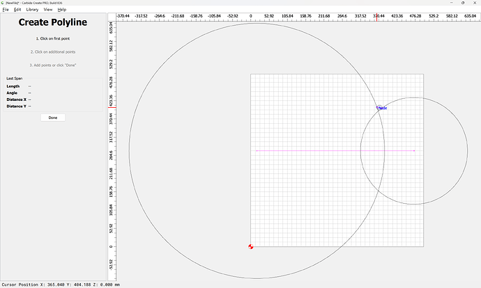

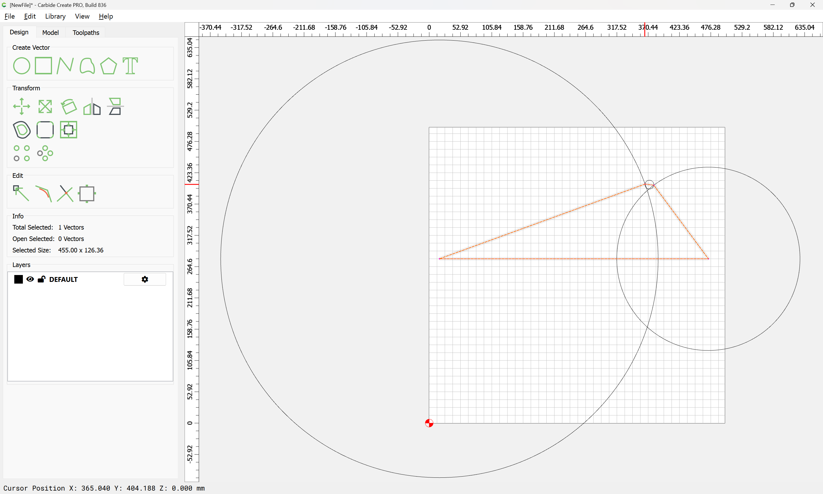

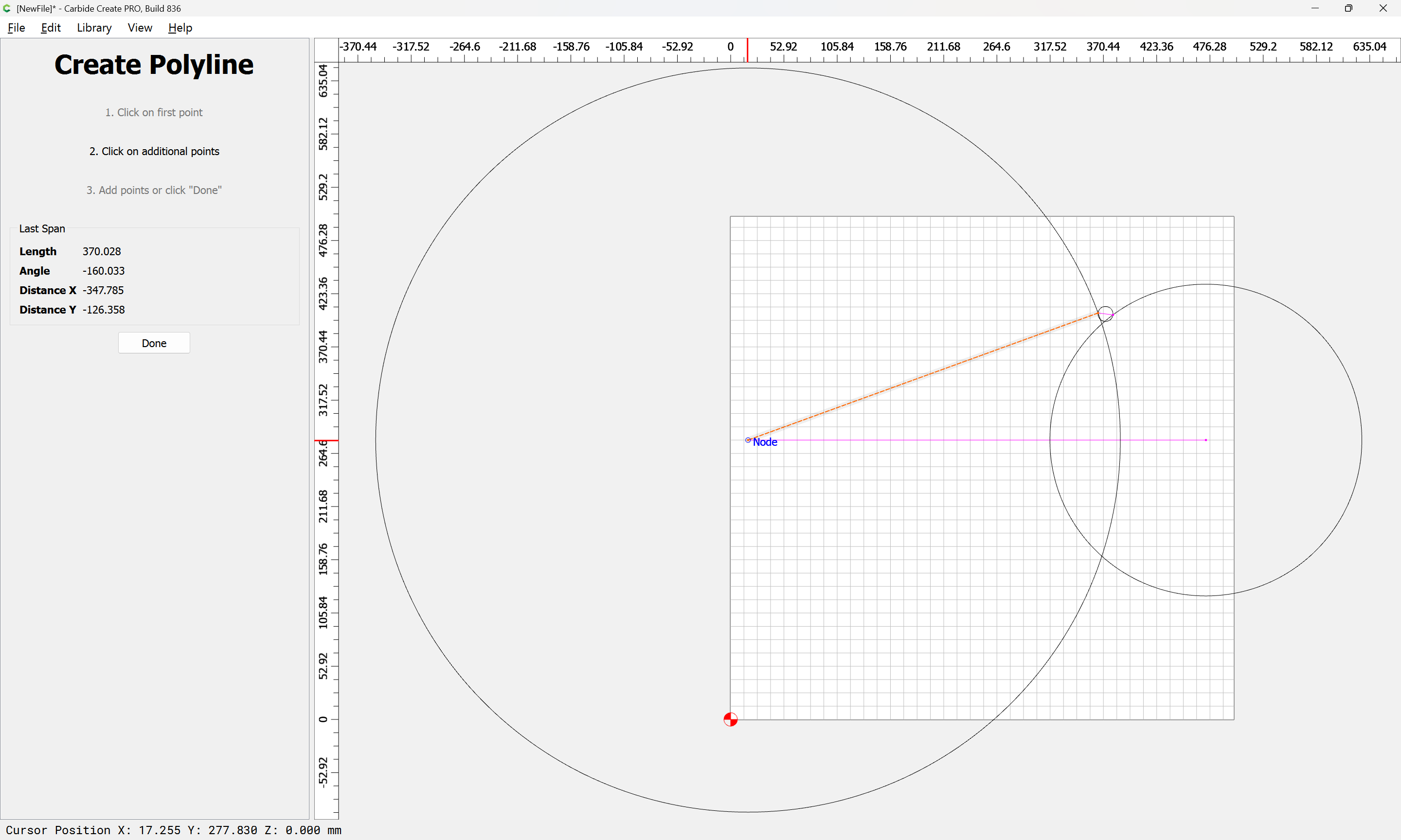

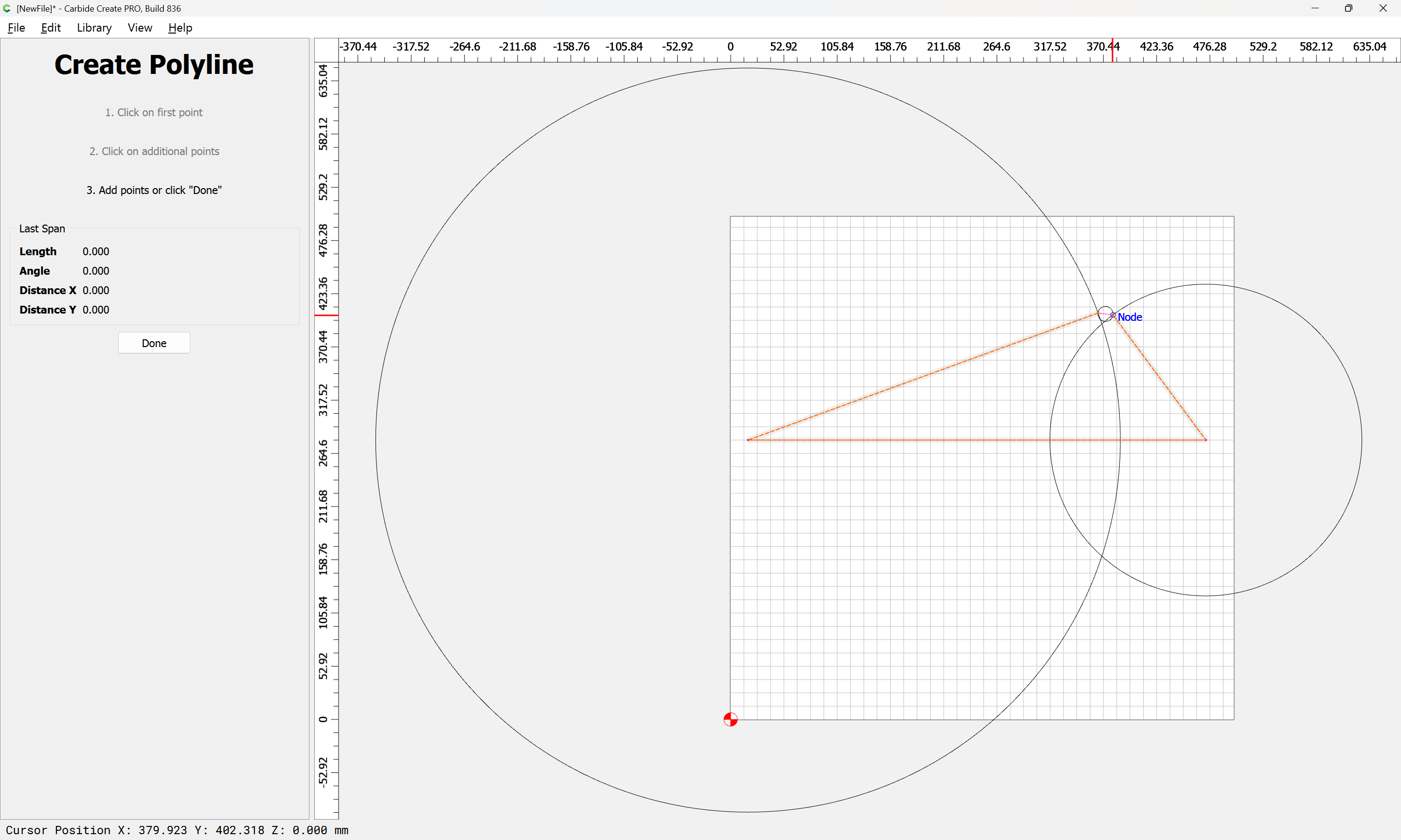

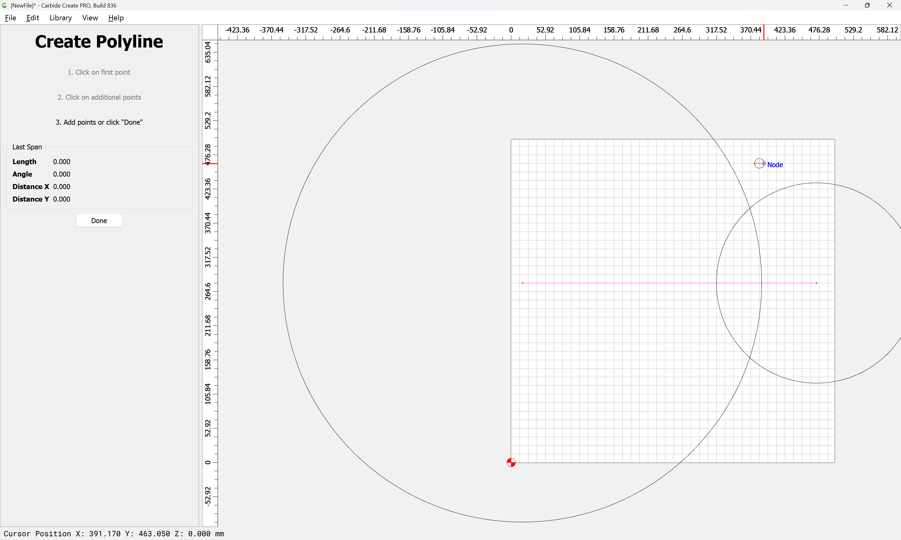

Use the Polyline tool to draw the desired figure, snapping on the endpoints of each line:
If desired, Trim Vectors could be used to tighten up measurements for the two inscribed lines.

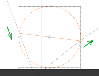

@WillAdams , you have admirably illustrated @DAH’s original point.
With the last line segment touching both adjacent circles, you can slide one end down and the other end up without losing contact with the circles…
I’m a mechanical engineer, for goodness’ sake, and forgot the basic principle of a four-bar linkage:nerd_face: So time for me to slink away in embarrassment… :face_with_open_eyes_and_hand_over_mouth:
