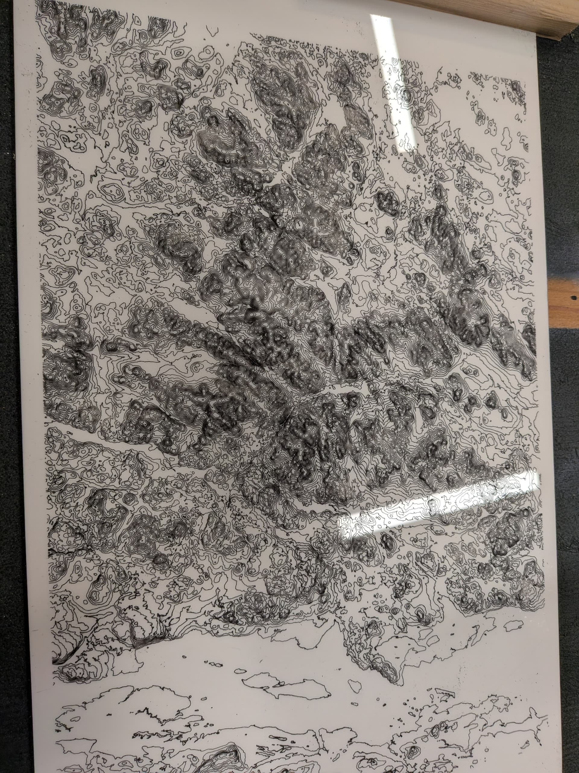

Acrylic Ink pouring on etched acylic
I am making topo maps using the Topomiller data.
As always I am putting too much detail for the given sheet size.
I tried to paint the grooves using regular acrylic paint ( thinned with water ).
The sheet is white and the paint is black. It worked ok, but I wiped some of the paint out of the grooves and got a grey tone and soften some edges.
I found there is acrylic ink. I was thinking of pouring the ink onto the sheet and wiping it off.
Has anyone tried this ?
Thanks
Ok, I tried it. I reduced the number of contours to some point. These are 40m high cuts.
I used a 9" speedball squeegee ( I am going to cut it in half ). The cleaning process is elbow grease with the squeegee for the best fill and smooth surface removal.
I initially did not press the ink into the grooves enough and used up a lot of paper towels.
I had gray areas and hot spots.
I went back and touched up medium size areas and found the technique. A shorter squeegee is better, allows more pressure. I used a 65 durometer squeegee, the recommended is 70 to 75.
I will probably go there.
Not a lot of paper towels. Some damp wiping.
