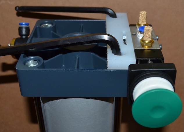

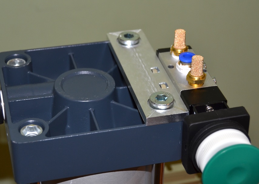

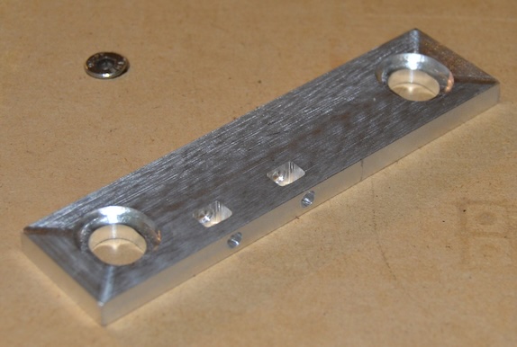

I made a bracket on the Nomad3 to mount a pushbutton valve to pneumatic actuator. This supports my build of a buster beagle 3d injector kit.

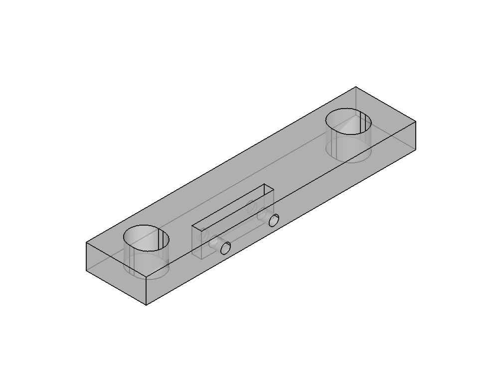

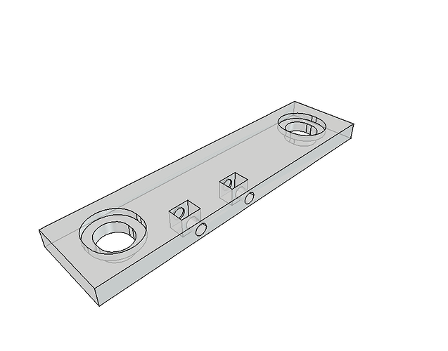

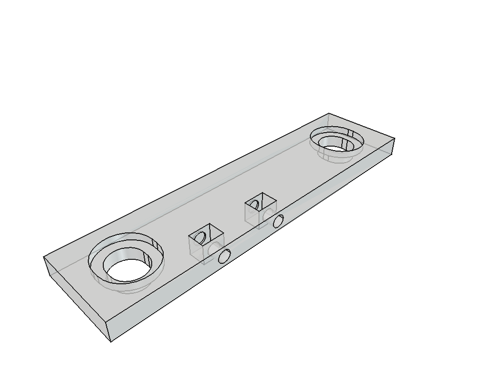

  • CAD/CAM with FreeCAD
  • Feeds/speeds from Carbide Create
  • Material: HDPE
If cut this again, the nuts will be held by smaller pockets.
Note: Hex drivers in photo will be replaced with M10 screws
