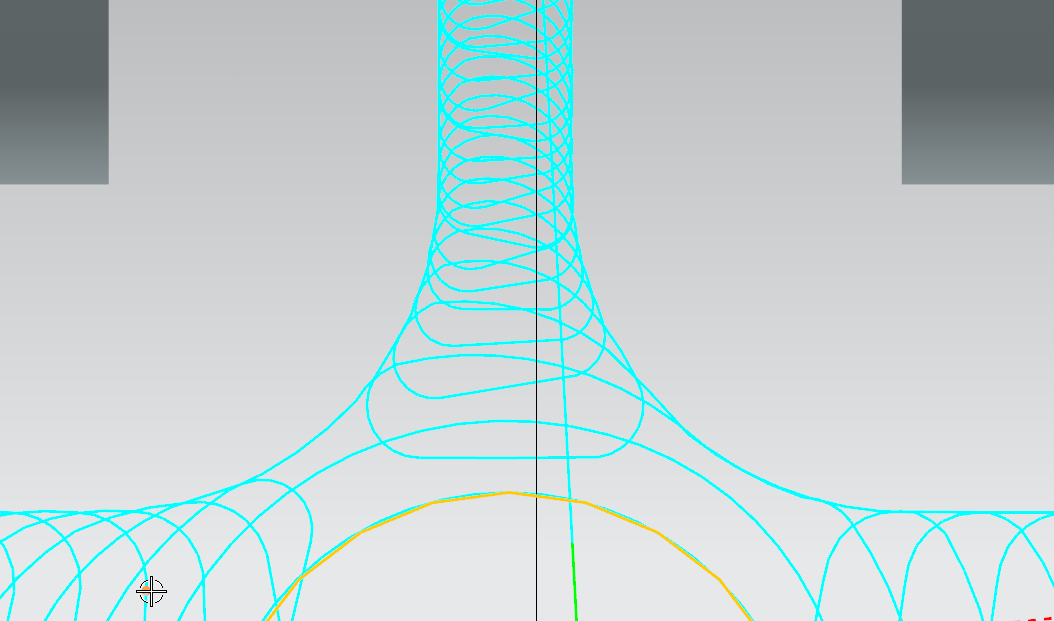

I’ve been exploring adaptive toolpaths in Fusion, having so far used Carbide Create 99% of the time. The default settings with the 3D adaptive toolpath seemed all too aggressive, especially the stepdown, so I also had a go with HSMAdvisor to evaluate doc, optimal load and feeds. C110 is arguably not a very good material to go to work with, being gummy and tough, but at this point I just want to try to figure out where I’m going wrong.
What I’m milling is a 30mm coin. The adaptive clearing seems rather straight forward, but I take it that’s where my first misunderstanding is. I tried with a #274Z, single flute cutter at 24k rpm, 41 in/min feed rate, around 10 in/min plunge, 0.0125 in optimal load, 0.035 in maximum stepdown, helix ramping 2 degrees. I’ve got a rather strong shopvac pulling air past the workpiece and end mill, so I figured that would help cool it.
About 1 minute into the operation, the mill broke clean off, during a rather mundane clearing after the second ramp. I figured I’d gone too fast, so I dialed it back to 20k rpm, 34in/min, same stepdown and optimal load, on the same coin. I believe this operation held on for a little bit longer, obviously having milled in thin air for most of the time, but that one snapped as well. No screaming, no particular warning, just milling along one moment, then broken in the exact same spot on the end mill in the next.
So I don’t really get why this is happening. According to HSMAdvisor (which I’ve seen that people here say isn’t suitable for the Nomad 3), there’s no major load on anything with these parameters. Is 20/24k rpm too fast with #274 and gummy C110? Am I not feeding fast enough, and causing work hardening?

Adaptive is meant for a decent size DOC, with a very small stepover and a higher feedrate.
My guess with that gummy copper is heat. Pause it after a minute or two & check the temp of the tool.
As soon as the smallest bit of copper sticks to the tool… snap!!!
If you can’t use coolant, try air blast. I don’t think vacuum/dust collection is going to draw the heat away quick enough.
Another possibility is the adaptive toolpath is not following the cardinal rule of “Never, Ever exceed the stepover!!”. Some older trochoidal & adaptive toolpaths will create corners that increase the engagement of the tool. The stress multiplies exponentially. An adaptive pattern should look something like this. no sharp corners, smooth transitions into the material, and never exceeding the set stepover.

I think I found part of the issue: Carbide Motion 635. The toolpaths were, in general, very jerky, but I thought it was part of the adaptive cycle.
I just upgraded to 636, and the jerky motions are all gone. I’d be unsurprised if this was what actually broke the three #274 mills: Jerky motion that put abrupt strain on them during what was meant to be smooth motion arcs.
I don’t think there was any change in how CM ingests toolpaths between 635 and 636. Something as minor as your computer installing updates in the background could cause that jerkiness, so I would check to make sure you have Smoothing enabled in Fusion. That makes the Gcode it produces more efficient to process.
