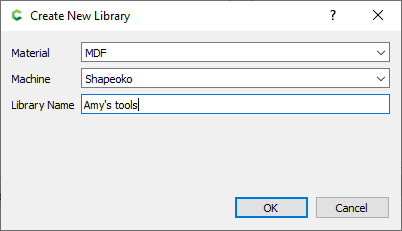

I am trying to add these bits to my library: https://www.amazon.com/gp/product/B073RK6F8N/ref=ppx_yo_dt_b_search_asin_title?ie=UTF8&psc=1
I have tried watching tutorials, but I do not have the add tool option or even duplicate (one you tube video I watched said to duplicate). Is there a new updated tutorial?
You first need to create a user library, using the “New Library” icon:

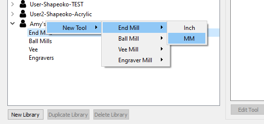

Tools is CC’s default database are organized by material, you may or may not want to do the same (I’m lazy and add all my custom tools in a single library)
You should then be able to right click on a category, to create a new tool:
